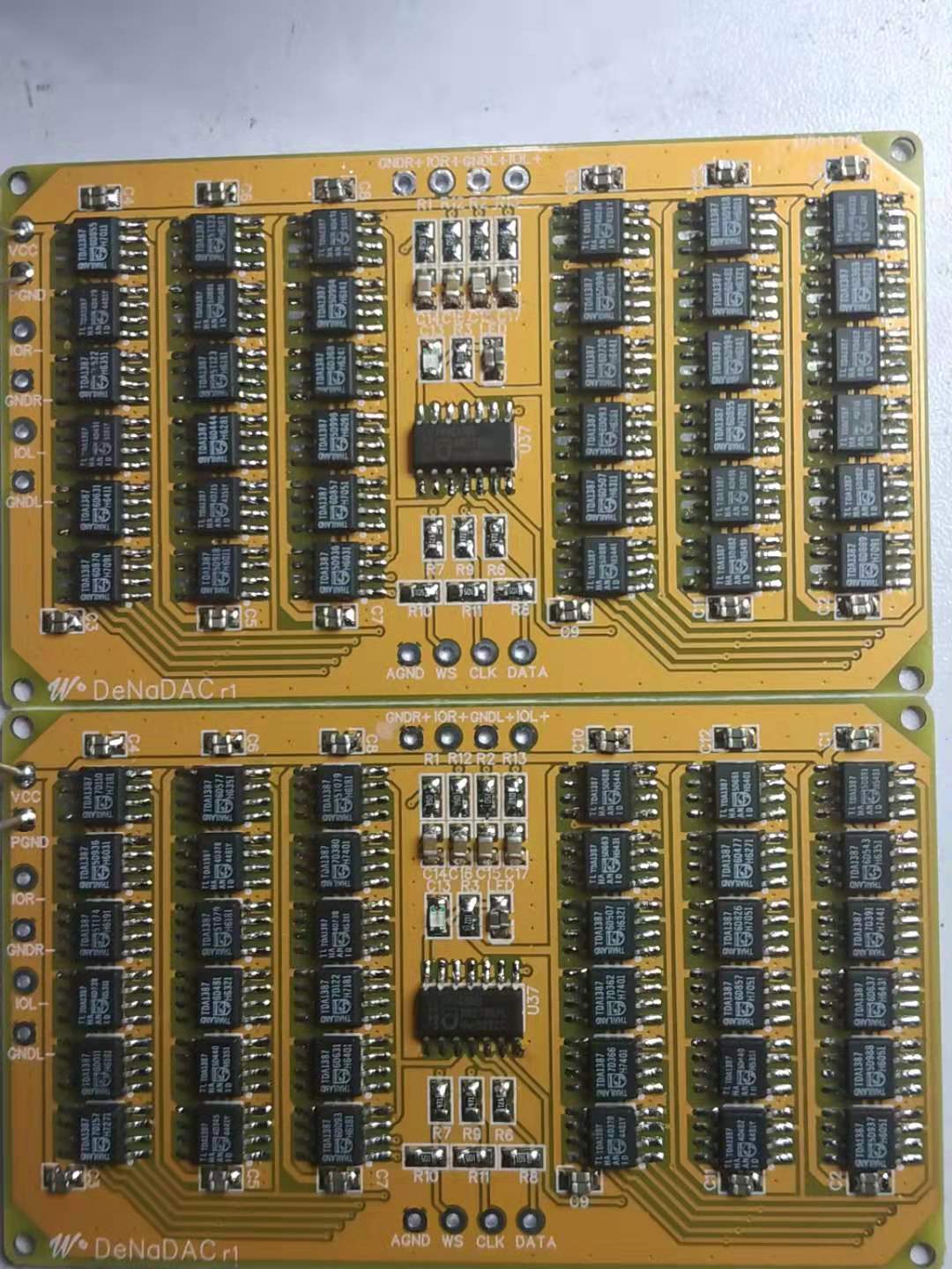

Four boards with the new layout have been now listened to and don't suffer from the low-level hiss the old layout does, which is good news. I was going to release the gerbers for that but in the meantime we decided to try out another experiment - using thicker copper to get a lower impedance, both to the supply rail and to the output pins of the DACs. When paralleling a large number of (over 100) chips the effective impedance the transformer presents is going below 100mohm hence the resistance of the tracks to the chips starts to become significant. A minor change was made to the layout for this 2oz copper experiment - the output pads are now more conveniently placed to connect twisted pairs to.

Just listened to the four boards in a stack which were built with the latest layout and 2oz copper. One chip was found to be broken amongst the 144 on those boards. Tracking a dud chip down isn't too difficult so long as the failure of the chip is such that the pin7 multiplying effect isn't also broken (which so far I haven't found). The faulty DAC normally gives its presence away when digital volume is set very low (below -50dB) and sounds like static breakthrough modulated by the music at a level which is louder than the music itself. Shorting each DAC's pin7 to 0V in turn eventually reveals which chip contributes the hash.
Since this new layout is now good to go, I've attached the gerbers and also the schematic. The RC network values on the schematic diagram are just place holders for now and depend on the characteristics of the transformers which are attached - the higher the step-up ratio, the lower the Rs and higher the Cs.

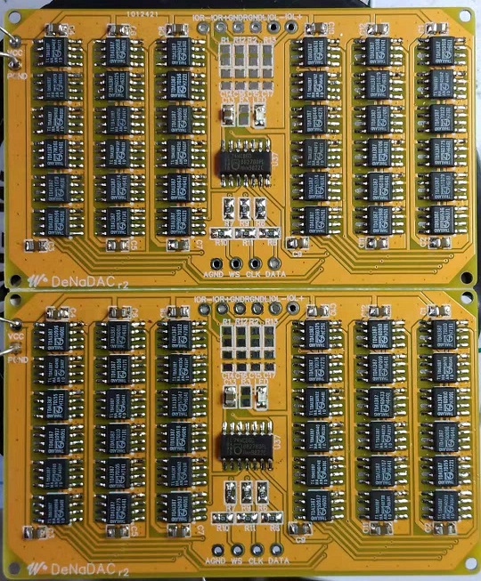

Here's a pic to whet your appetites - those of you who yearn for DAC chip counts into 3 figures that is. This is a stack of 8 PCBs - the original layout PCBs - so the total number of chips is 288. I built the stack as an experiment to see how low a supply voltage a TDA1387 could tolerate and still deliver untarnished audio. Turns out, around 2V or about 1V below its datasheet minimum. (That can't be useful with passive I/V though as there's no output compliance to speak of then.) Lots of chips in parallel are needed when running such low supplies as the output current scales with supply voltage. Hence the 8 board stack. The advantage of lower supply voltage is much lower operating power - power scales as (supply voltage)^2.

@abraxalito. Did you test a single board with 96/196kHz sample rate? Do it make sense to populate every second DAC chip and double number of boards for such application? I think of using empty space for extra decoupling.

So far no, I haven't tested at 96k or 192k, just at 88k2. A little higher current draw compared to 44k1. I will have a play at higher rates just to see what happens though. Why do you want extra decoupling incidentally? You can slap extra ceramics across the top of the chips if you're so inclined but I can't see the benefit.

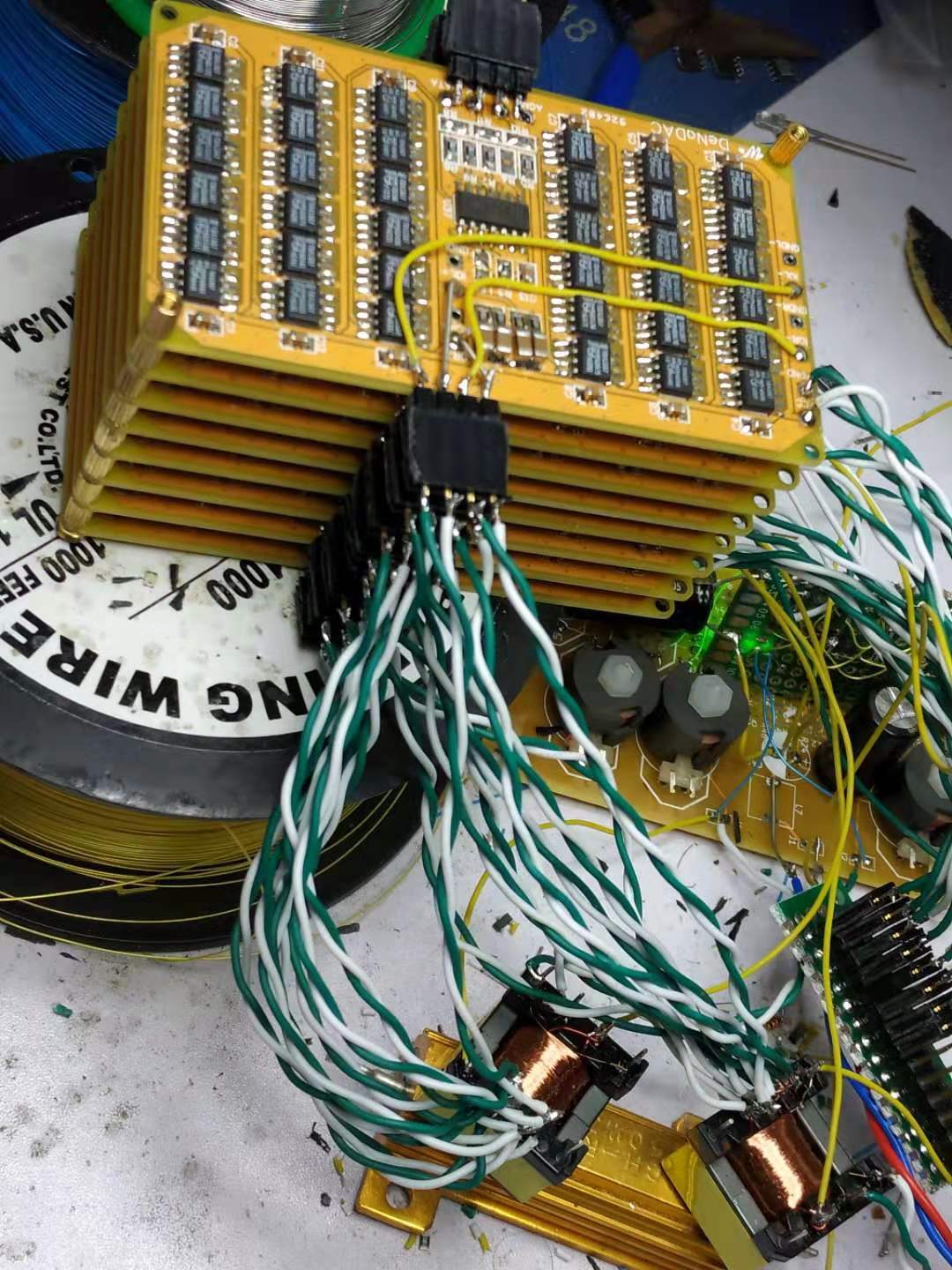

I've increased the height of the board stack from 8 to 10 boards now, for a grand total of 360 chips. Its working fine, sounding awesome at just 2.1V. I had a supercap board lying around so I've connected that to the supply, it has 61 * 10F EDLCs on it. Didn't notice any improvement in sound when I brought it in so I figure heroics on the supply is only of marginal benefit. But can't hurt for extra bragging rights as supercaps have a certain 'cachet' 😛

Actually I was thinking about larger film or electrolyte caps, one per two (or four) DAC chips, depends how it will fit. It is more effective in removing medium and high frequency components when placed close to the chip than a one large battery of supercaps on the PSU.So far no, I haven't tested at 96k or 192k, just at 88k2. A little higher current draw compared to 44k1. I will have a play at higher rates just to see what happens though. Why do you want extra decoupling incidentally? You can slap extra ceramics across the top of the chips if you're so inclined but I can't see the benefit.
96k sample rate support is important for decoding 48kHz (or 96kHz material), so please do... While I do belong to those who claim that getting higher is not beneficial for SQ, it looks like that 24-bit audio data stream come on the expense of a higher clock rate, our clock chip must keep going. If 16/192kHz works fine, then 24/96kHz should work as well. Padding irrelevant information is wasting of bandwith, but in some cases we have no control.
As for lowering Vcc even further, I didn't even think about, this is shocking, maybe I am thinking to conservative. 🙂
BTW, I walked out immediately after posting and now can't delete dupe, sorry.
I ran a very quick test - 96k worked fine at 2.1V but 192k was hissy. So I upped the supply to 2.5V and tried again - success @192k. I would guess that 192k was running at 32bits per sample (since that's what my AK4113 S/PDIF input chip spits out) - presumably 384k/16bits would also work fine at 2.5V.

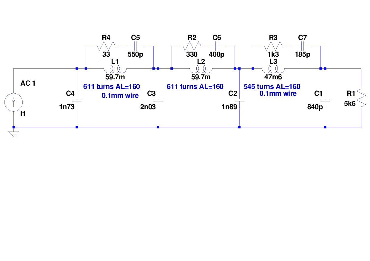

Experimental filter
In the world of NOS DACs, unfiltered (or very lightly, first-order filtered) outputs seems to be the norm. However with my engineering background unfiltered hasn't sat well with my instincts and I've often wondered if NOS wouldn't get even better with closer-to-textbook filtering. I used a 5th order filter for lingDAC, PhiDAC has a 3rd order filter as does the first prototype of this 'GrossDAC'. When I looked on my 'scope at the output with a sine stimulus though, even with lingDAC's two-inductor filter, the higher frequencies appear rather messy. There aren't any 'stair-steps' visible of course but there is apparent modulation by image frequencies.
In order to get a visibly clean output on a 'scope, it seems a 7th order filter is required. Here's an example filter and output - I even figured out how to get a screendump from my 'scope (its menu is all in Chinese).
