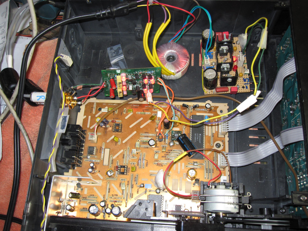

Here's a pic to whet your appetites...

I've been spending the last few days exploring how much distortion the transformers generate - the result is that at low frequencies and high levels there is quite a lot. By 'a lot' I mean up to a few percent (below -30dB). This is fairly normal for transformers - the distortion they generate in the main depends on the flux level in the core, which gets to be the highest at the lowest frequency and the highest level (because flux is the integral of voltage). In my design it turns out this isn't the primary source of distortion, this took a fair bit of head-scratching to figure out though with 20/20 hindsight its obvious. There's distortion because the transformer (here I'm talking about the one between DAC and filter) isn't feeding into a very low impedance, rather it sees the I/V resistor at low frequencies and that's 5k6. So one solution is to reduce the I/V resistor - this does in practice work well but means changing the transformer ratio or alternatively adding more DACs to bring the output level back up again.
I've decided to change the transformers so that the design does still work with just a single 36 DAC board - this has put a delay in the project. The distortion isn't as bad in practice as the figures make it look for various reasons - the main one being that a 20Hz sine at full level is extremely unusual in real-world music - distortion drops as level goes down and also drops as the frequency rises. So bass is the most 'at risk' from the peturbations of transformers. Those who fear distortion most can reduce it by adding more DAC boards and swapping out the EP17s for something bigger - I've been experimenting with EE35s for this and I guess will report back on my findings after Xmas.
