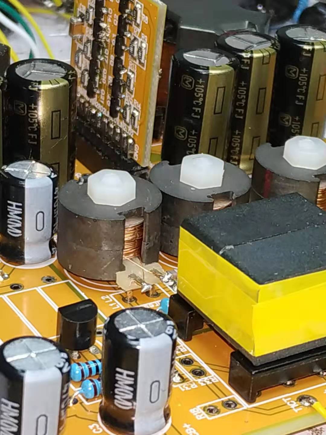

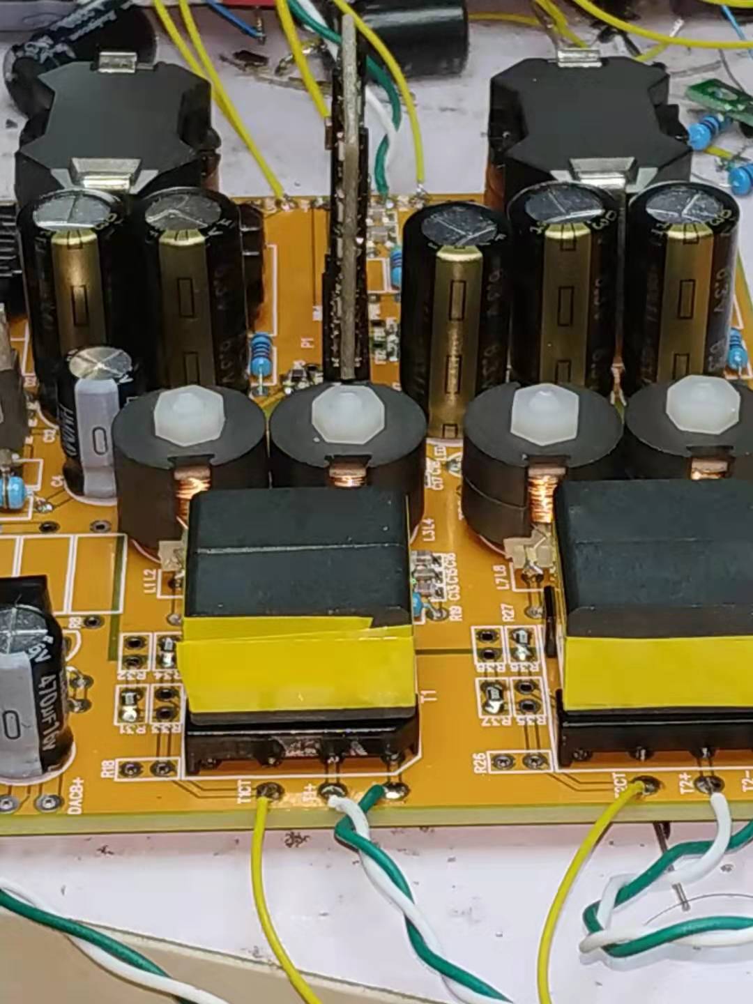

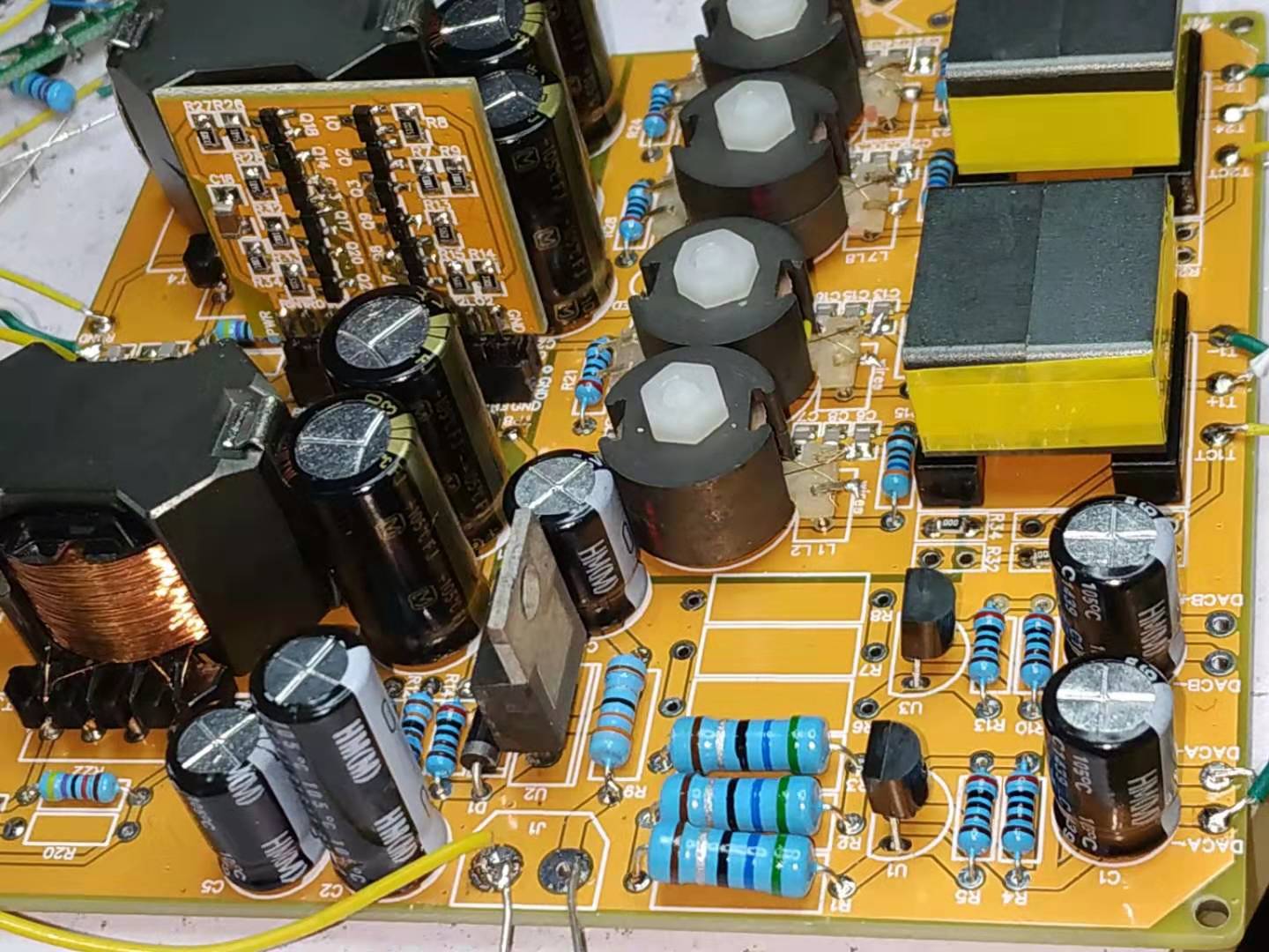

Looks good, toots. Am I on the list to receive samples?We received the re-spin of the PCB today, first build is taking shape.

I'm working on the BOMs, albeit fairly slowly. Also I've been doing measurements of THD at various (low) frequencies and different levels.
There's going to be more than one BOM because there are going to be two basic variants of this DAC - Q-grossDAC and H-grossDAC. Q stands for 'quarter' meaning 36 DAC chips in total. H stands for 'half' which is 72 DACs. At first I thought I'd use different transformer ratios between these two but having made some distortion measurements I figured it would be better to use the extra 36 DACs to reduce the measured THD, this is achieved by lowering the I/V resistor's value (2k in the Q-gross, 910R in H-gross). Saves on transformer SKUs which is a nice benefit too. The main PCB has two shunt regulators (TL431) to feed two DAC boards, on Q-grossDAC one of these is left unpopulated. Current consumption for Q-gross is about 350mA and for H-gross about 600mA from 9V.
As regards distortion measurements, at 20Hz and full level distortion gets up to almost 1% on Q-grossDAC, about 3dB less on H-grossDAC. This is primarily 3rd order (2nds get cancelled due to the balanced topology) from the EP17 transformers. At 160Hz and above it seems likely that the DACs might be responsible for more distortion than the trafos, THD falls below -80dB. Measurements at lower signal levels seem quite encouraging, perhaps distortion gets reduced through paralleling in the same manner as with TDA1543 though I'd expect weighting errors to be more systemic than random with continuous calibration DACs.
Sound quality-wise I've no complaints at all, the sense of ambience/air this beastie delivers is something I don't think I've heard from any other DAC I've spent time with. There's a feeling of acoustic envelopment on placing my new HD6XXs over my head which leads to not wanting to take them off 🙂

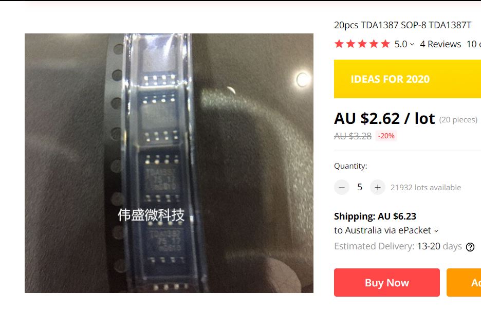

Which package format for the chips will you be using on the PCB? (Sorry its probably been mentioned somewhere)
SOIC-8 is the only package style I've come across for these DACs (TDA1387T). The circuit concept can be used with other Iout DACs though, although its doubtful that any provide anywhere near as many mA/$ at 1387s do.
For future development I have some 12bit DACs lined up which do deliver about as many mA/$ as 1387s but they need a CPU to marshall their inputs so that a paralleled array (of 16 chips) gives 16bit performance.

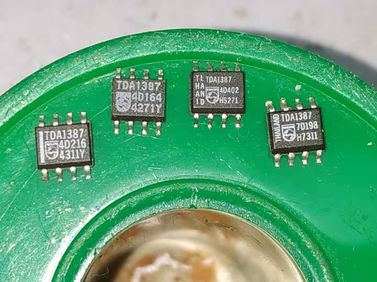

SOIC-8/SOP-8/SO-8 all the same to me. On the surface those look fine just I've never seen any TDA1387s in real-life which didn't have the 'Philips' logo on them. Price looks reasonable.
It appears they have blanked out the logo on the photos rather than the chips being blank themselves. They're cheap enough to give them a go anyway.
