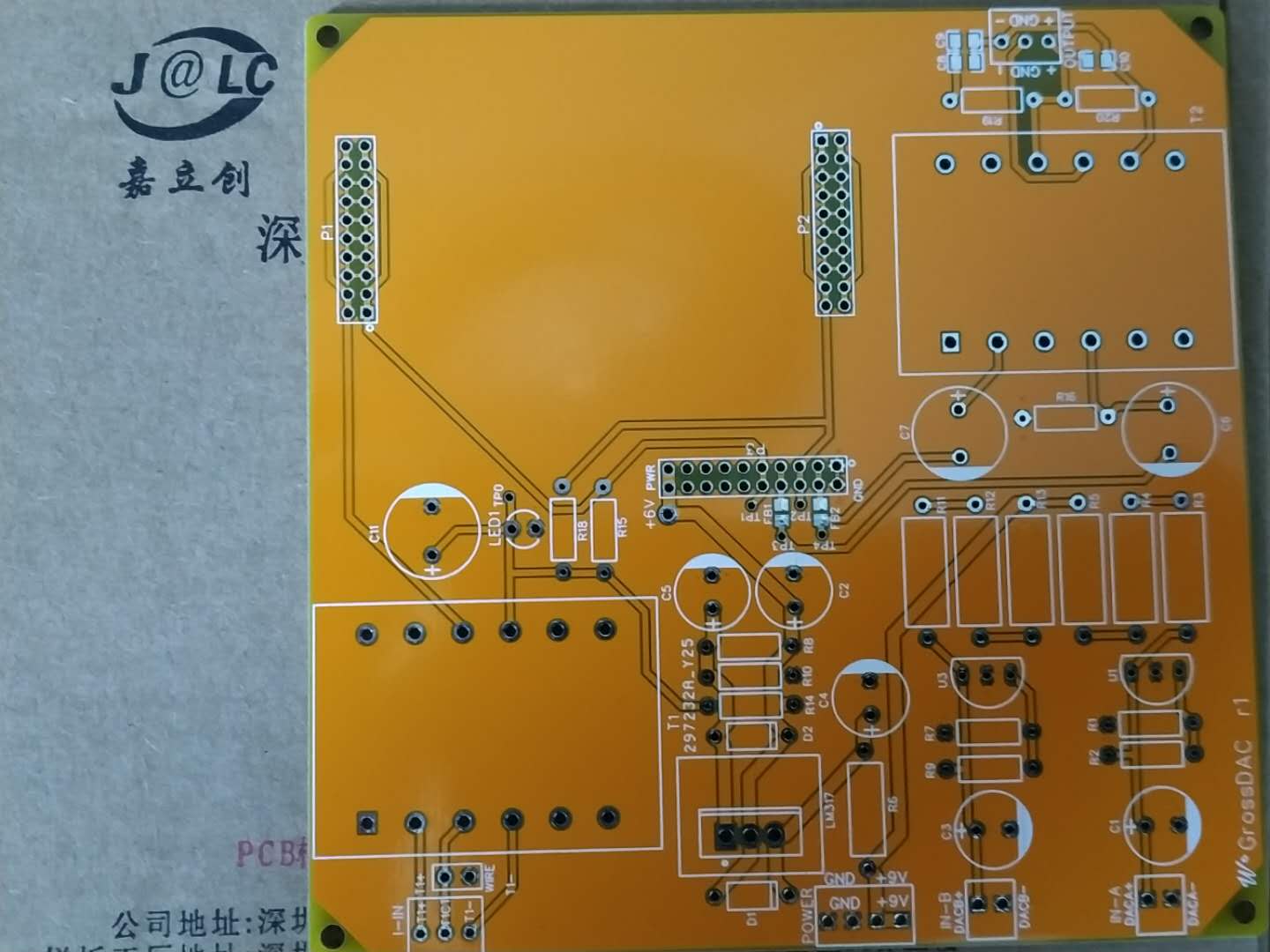

Update
We've created an r1 PCB now which incorporates quite a few changes.
First the PCB is now mono, so two are needed to build a stereo DAC. Space ran out incorporating all the mods. EP17 trafos have been ditched in exchange for EE35s which are much bulkier. But it means lower distortion in the LF region which was a major weakness of the first prototype.
Second the filter is now a pluggable item so can be 3rd/5th/7th or 9th order, using the same PCBs as for PhiDAC hex. The component values need to change so PhiDAC filters can't be used directly (the working impedances are different) but at least we won't need to create any new PCBs for GrossDAC filters.
Lastly with two PCBs there are going to be four power supplies available so a full gross DAC can be built, using four DAC PCBs.

Hi Richard,
Finally getting the time to look at this build again and I've some questions regarding the transformers if you don't mind.
The inductors L1-L8 are shown as pairs on the schematic:
Do I need 2 windings in parallel on the P14 cores, or just a single winding? And am I correct that the target inductance is 27mH total between the pins?
Is the mentioned 6+6t : ~4000t generally right for the EP17 input transformers on a halfGross? This would be CT primary and CT secondary.
And I have the output RM10s as single primary, CT secondary 1:2?
Does any of this look right? This will be my first winding task above 14 turns 😱

I came up with a way to get fewer turns on the transformer - add the CT later with thinner wire. Here I have 6+6 T for the primary (0.62mm) and there's enough room left for 4000T of wire for the secondary (0.05mm). This gives an impedance ratio of ~111k meaning an 11k I/V resistor on the secondary represents 0.1ohm to the DAC array. Initial listening indicates a slight improvement in LF - the price is the need for a lot more DAC chips - at least 128.
