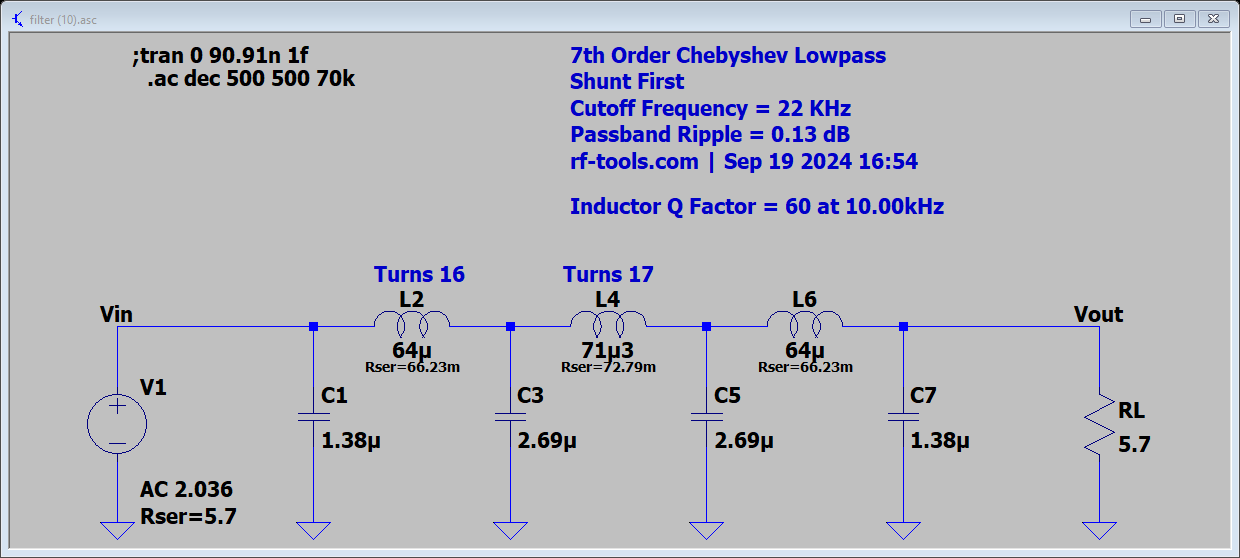

From a quick fiddle in LTspice, the P14 inductors are 12mH for a half-gross version and the I/V resistors 910ohm. With AL160 cores the right amount of damping is given by using 0.07mm dia wire (274 turns) which gives an ESR in the region of 28ohm.

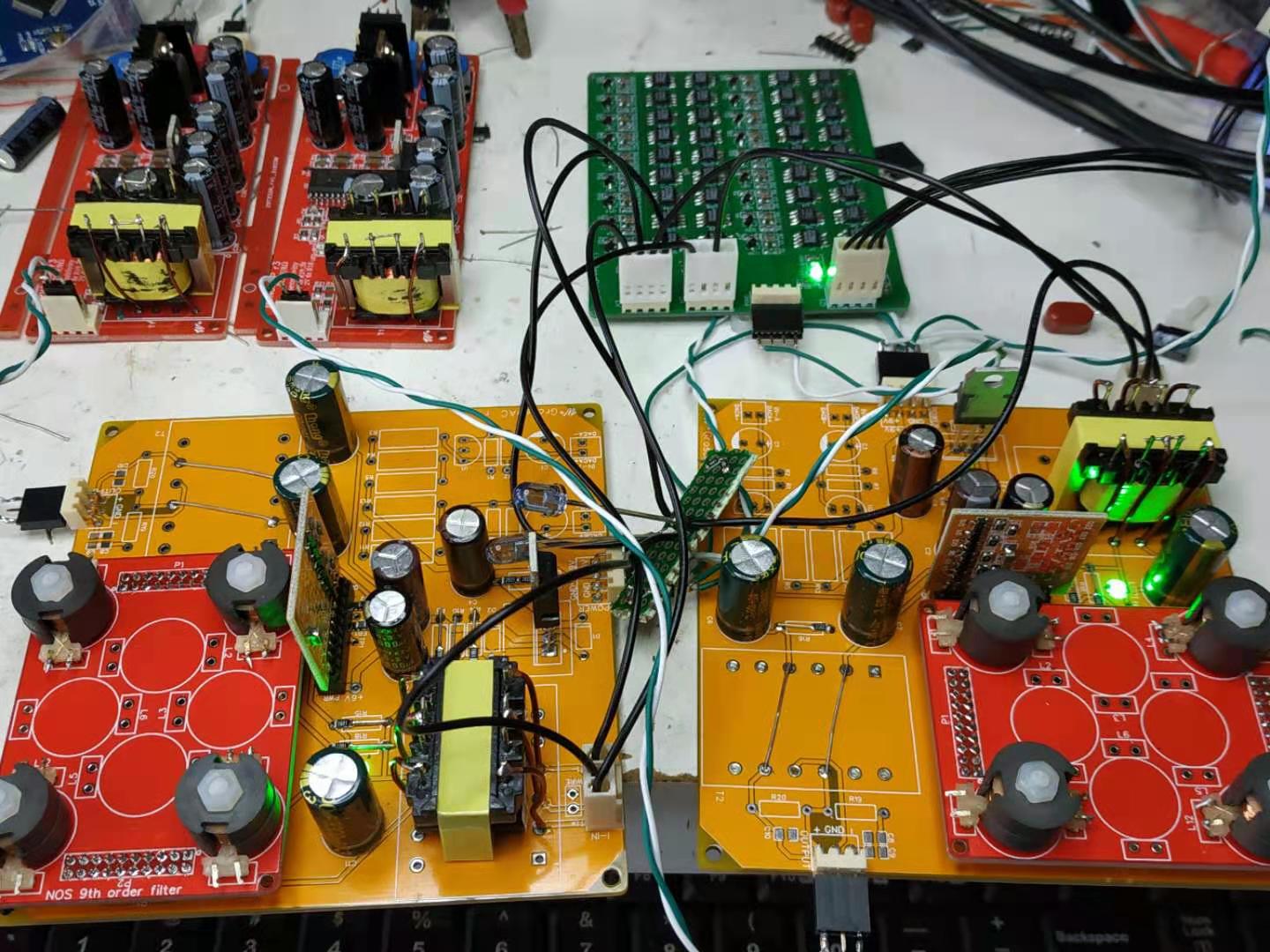

2nd generation GrossDAC
The last few days I've been working on improving the original GrossDAC design - there's a new DAC board where individual shunt regs are used per pair of DAC chips. And on the I/V filter board I'm experimenting with an off-the-shelf transformer.
In this first prototype the output transformer isn't needed as its feeding my monoAMPs which come already equipped with input trafos. The filter boards are 5th order but I'm using up some prototype 9th order boards which for some obscure reason I have too many of.
The eagle-eyed may notice a small green prototype board in the middle - this comes with two IR LEDs to provide a mid-point bias for the centre tapped trafos. I'm running the DAC offset current through the transformer at the moment which may turn out not to be optimum.

Here's the 2nd prototype DAC board for the design that has the place holder name 'DenaDAC'. The hand-wired interface PCB at the back holds 8 current sources (4 up, 4 down) and 4 MOSFETs to cascode the DAC outputs and give the potential for a big voltage swing.

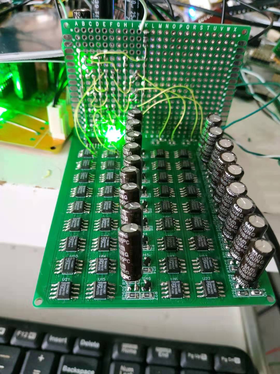

The updated 36 DAC board (with cascode FETs included) is being built. This one uses multiple paralleled FETs to spread the load (since the FETs are those tiny SOT-23s) then in theory I should be able to go above the 18V output swing I achieved on the earlier prototype. Whether that'll result in a gain in SQ is what this experiment is all about 🙂
Can't usefully go any higher than 36 chips on a single board as we've reached the maximum cheap board size with this one (10*10cm). Still the capability exists to wire a couple of these in parallel.... I'm not at present planning going beyond 36V swing as I don't have thin enough wire for the primary of the trafo for that so an extra board allows the I/V resistor to scale down in value.

Since this new layout is now good to go, I've attached the gerbers and also the schematic. The RC network values on the schematic diagram are just place holders for now and depend on the characteristics of the transformers which are attached - the higher the step-up ratio, the lower the Rs and higher the Cs.

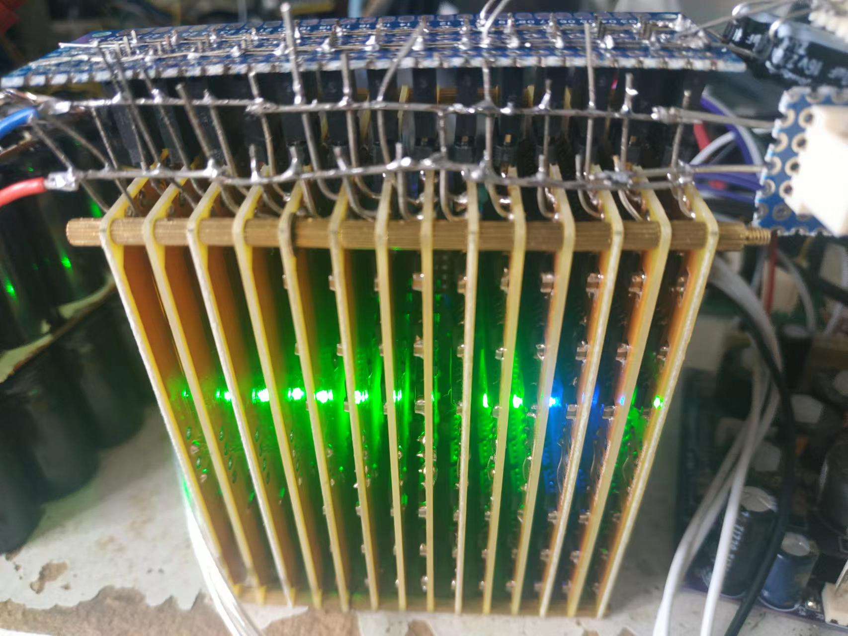

Looking through some of my many boxes of boards from old projects, I discovered I had rather a lot of the original 36-chip DAC boards stuffed full of TDA1387s. I could feel they all wanted to be playing music music together rather than gathering dust so I decided to revive the project and this time aim a bit higher. The target is 1000 DAC chips in a single DAC so I've decided to call it 'kiloDAC' (or kDAC for short).
Since there are 36 TDA1387s on a single board this target calls for a stack of boards 28 high, but I'm going to make it a balanced DAC so there will be two mono towers each of 14 boards. The power supply requirements are helped considerably by building a dual-mono DAC - since each chip draws around 5mA, a 500-chip stack will pull 2.5A which is within the remit of a 3A LDO like LM1085. It'll need a fairly substantial heatsink though, I plan to feed the LDOs with buck regs to minimize their heat generation. Since in the last iteration the trafos generated too much LF distortion, they're out now, just simple passive I/V will be the order of the day, preceded by a 7th order filter. I plan to include a software 2X upsampler which makes the reconstruction filter design that much less onerous.
With so much current (0.5A peak) going into the I/V resistors they'll need to be specially selected ones, I'll do a search on Taobao to see if there are any fancy ones in low enough values. I figure the I/V resistors will need to be in the region of 6ohms so we might need several in parallel.
Here's one of the 14-board stacks undergoing evaluation. If I decide to run them at their max 5.5V supply probably I'll need a slowish fan to circulate the air.
Here's my first attempt at a filter - the I/V resistor is 5.7ohm to fit the need for an integer number of turns on the inductors. They're being wound on P18 ferrite cores. Note since the filter's terminated on both input and output the effective I/V resistance is half of 5.7ohm. I originally thought I'd need to go to air-cored inductors due to the high current involved but air-cored inductors need to be huge to get high enough Q - low Q inductors give drooping frequency response at higher frequencies. So ferrites it is for now, with dual windings to make terminating the wire ends a bit easier. Cap values are rather impractical for them to be made up out of NP0 100nFs which have been my staple for filters up until now. Larger NP0s have become available (220nF and even 470nF) but they work out much more expensive per uF. So on order are some MKPs (film caps) from Taobao.
Well, back to Earth, with so many chips aren't your afraid of delays due to chips being so far apart?
Patience must be your second name, 1000 DAC chips, bloody hell!
Good to see you again Claude! I was half-expecting you to ask why, after such a long silence in respect of TDA1387, I'd returned to it once more.😎
Delays of propagation are going to be in the realm of nS so quite small in the scheme of things where one sample is 22,000nS. I'm packing the chips as close together as I can while allowing a little bit of air to flow having been bitten by the heating issue in the 'Stack DAC' project a couple of years back. The chips I'd mainly soldered in years gone past, I only had to solder up 4 new boards to reach 1008 chips.
