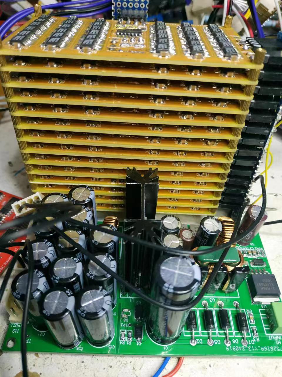

I've now relieved the bench supply of its duty and have two dedicated hybrid supply boards powering the two channels of the DAC. The board looks a bit complex because there are two regulators - a buck, followed by a linear LDO and each stage has a dedicated LC filter. One 24VAC wallwart is sufficient to power both channels - although the total current demand is over 4A the voltage is only about 3.6V at present. To get up to the full DAC voltage I think I'm going to need two more PSU boards to spread out the heat somewhat as the LDOs are already pretty toasty as it is.

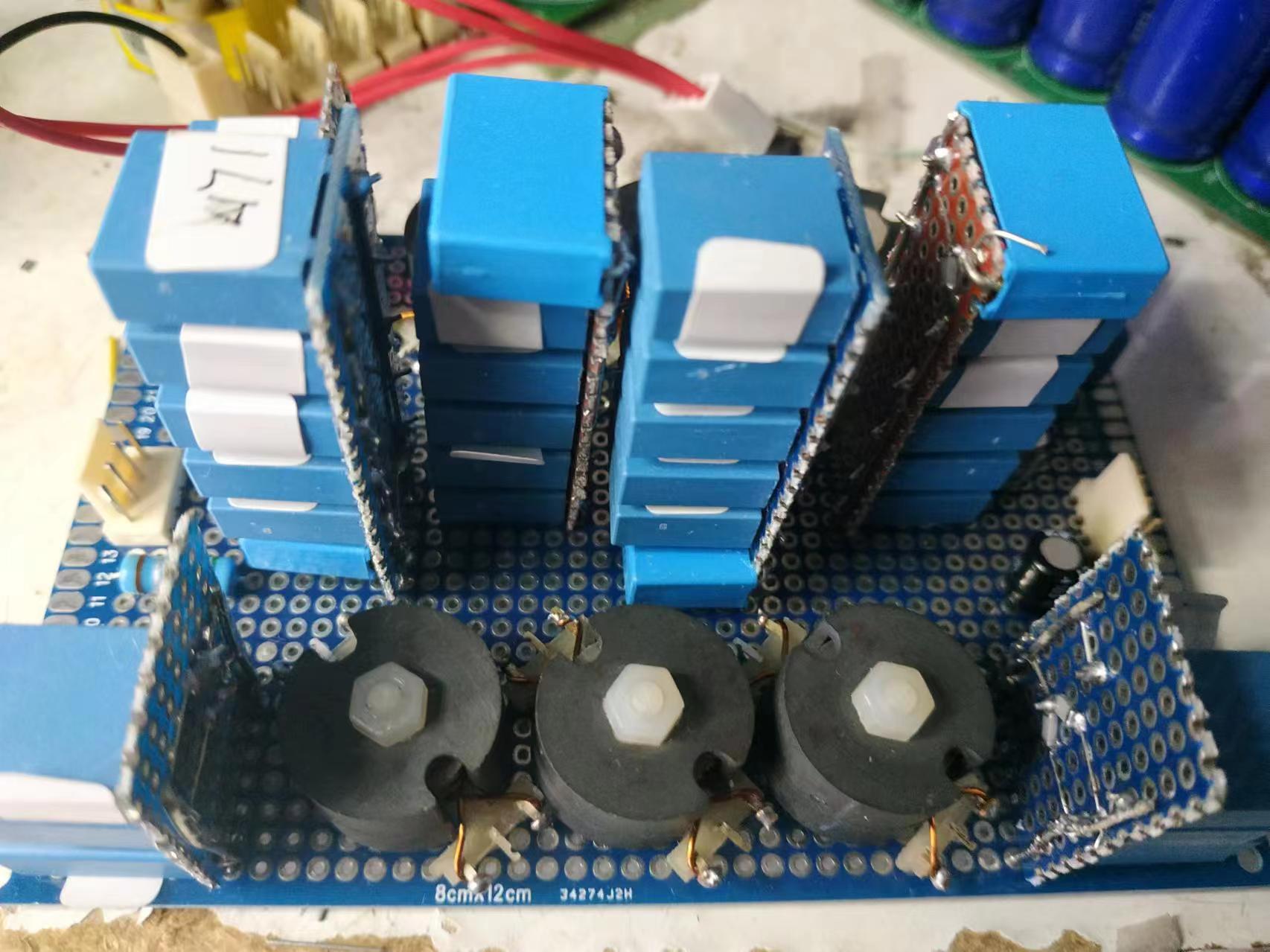

Here's the prototype implementation of the balanced filter schematic above with the various MKP caps we sourced from TB. I've used a few NP0s to bring the capacitance values up to the target values. The build seemed to take an age - the inductors were very fiddly to get right - for the next one its going to be a PCB to save some wiring time.

Filter PCBs had an error - we got the physical size of the P18 inductors wrong. Got around that by mounting a few of the caps on the reverse side of the board so they didn't clash. Still quite a lengthy build process selecting all the cap values by hand.

Heat is a significant issue here - not just from the towers of DAC chips but also from the PSUs feeding them. Things are hot but not crazy-hot sitting on my bench but eventually this is going to have to live in a case where the ambient air is warmer. I've been experimenting with a LDO regulator which performs better than the LD1085 I started out with, which has a drop-out voltage in the region of 1V. I'd like to get the drop-out for the linear reg below 0.5V so that I can run at higher current and not need to find a bigger heatsink. The DAC towers I'm rearranging to have the boards vertical rather than horizontal to try to take advantage of natural convection.
