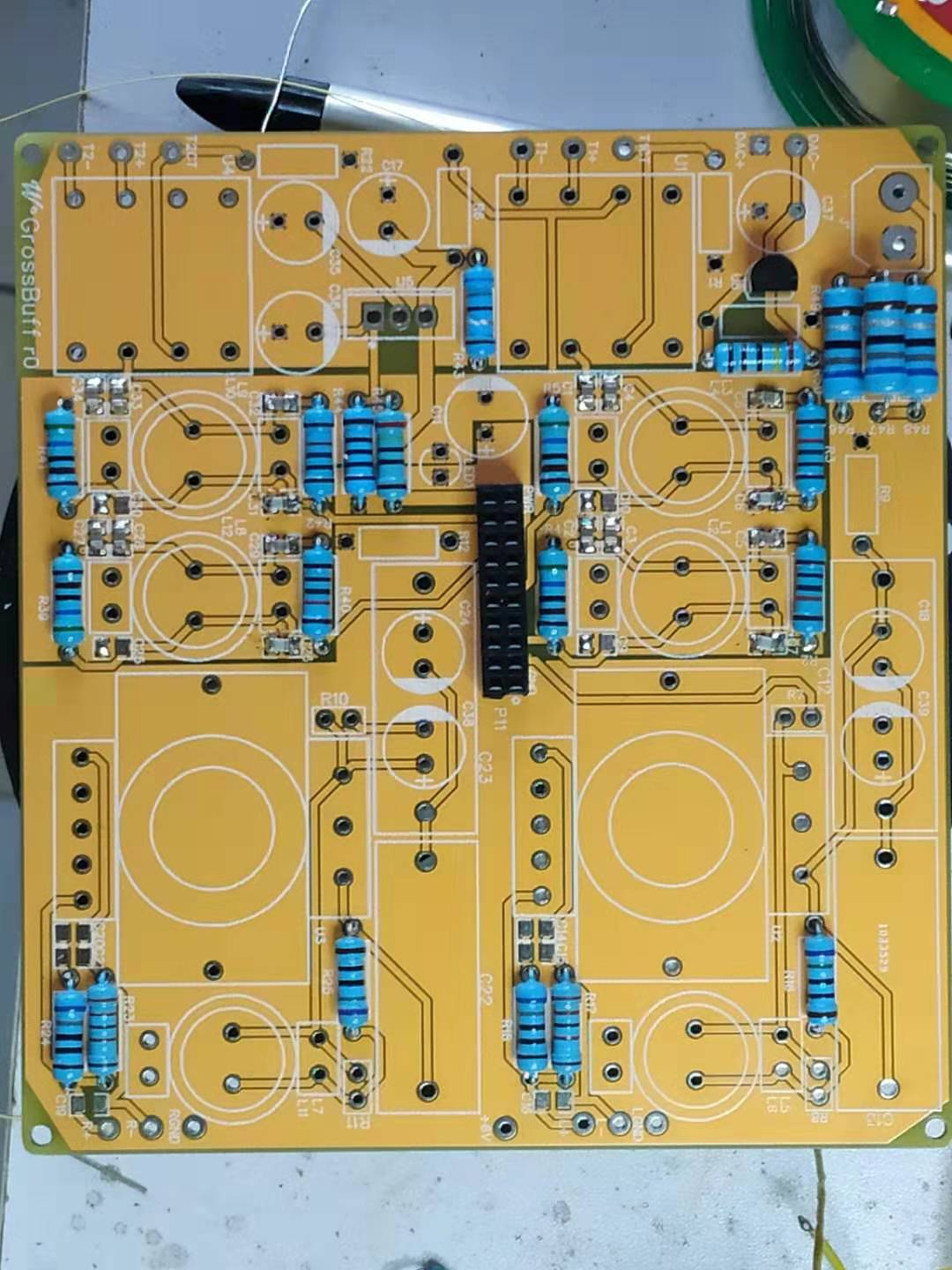

PCBs are in!
Brief progress update - first PCBs for the analog board and the plug-in buffers have arrived so I'll be doing build over the next couple of days and collecting all the PCB errors together for the re-spin. Plus working on the BOM.
Here's a picture of the first assembled buffer plug-ins, they use a 2mm pitch connector as the gap between the rows of pins corresponds closely with the thickness of a typical PCB. When I have a built-up analog board I'll photograph that too.

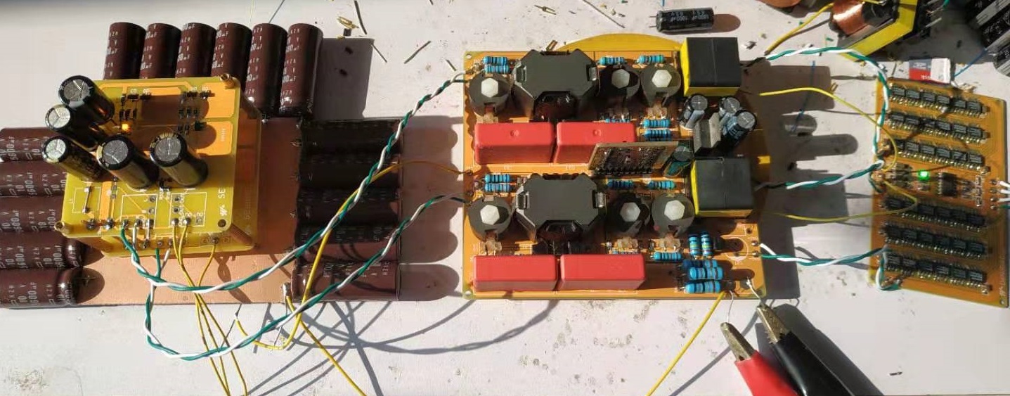

The analog board starts to take shape - I ordered 0.5W resistors, thinking they were the standard ones as in the Western world but on Taobao they turn out to be a bit over-sized. So next time I know, order 0.25W to get the standard ones! Next up - wind some inductors. The PCB gives a choice of inductors - either hand-wound (gapped P14 cores sourced locally) or commercial ones from Bourns (Mouser).
Haha no, only a handful of them for reading bus routes. When I said 'ordered' I give my orders to my wife and she works out the best and cheapest seller to fulfill it 🙂
So far no PPS but perhaps in future I'll give them a whirl. Only NP0 on this PCB as far as SMD caps go, plus four very large leaded film caps to go on at the end.
Ask wify to get some pps for the analog side of the dac, you may like it imho. While capacitance values znd precision involve to forgett it in precise filter needs...Higher size case may stop you for inductance but the trade off worths it after a listening...most of the time. Sumo can confirm as well...
Wow designs your pcbs !!!!! bravo. Having said that, women are really really good with intricate stuff, no two ways about it Richard.
Great feeling ya Richard. Btw that filter network, though in calculation & theory it works but I do suspect it will hinder SQ more then it helps.
Which filter network do you mean? The CLC filter between the transformer output and the buffers?
Power supply Richard. Go look at EC thread last few post. Max suggested a balun filter. I tried that out & it works very well. Important is to use 1 mm enamel wire to wind. So far its the most effective filter that I've tried.
Cheers
Cheers
Sorry, you mean I have a power supply filter? Or that I need one? I did see @Maxlorenz adding a filter to his ECD DAC - I've experimented with CM chokes for quite a long time but they're only needed to deal with grounding loops. There isn't a grounding loop in my current setup. Even if there was the potential for one, the transformers defeat it.
Yes asking u to try that. I use CM before as well but never like it. Some how Max suggestion works. I made mine out of a 50mm OD powder coat ferrite ring. Started out as curiosity but results surprised me.
If you're getting improvements from a CM choke then try isolation transformers next, the result may well surprise you further.
