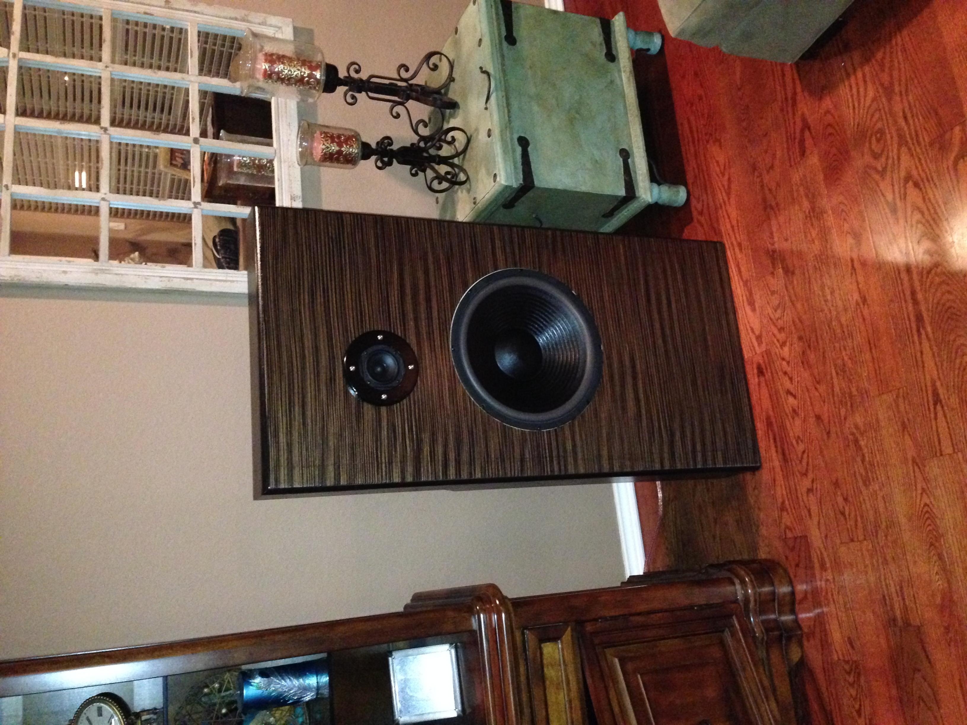

Just Finished my Ultra!
I just finished my Ultra build and they sound good, but I have noticed that the mids and highs sound somewhat "congested". I have high hopes for these and think I just need to do a little tweaking to get them dialed in. I followed the latest information I could find for my build. the baffle has a 4 1/2" cutout for the Tymphany and the driver itself is mounted and recessed in a 1/2" piece of MDF that I have rounded over at the edge. The side wings are 6" at the bottom and curve into 4" at the top about 15" from the top of the baffle. The only physical mod I made was to put a 4" piece of plywood spanning the width of the baffle at the top, connecting the two wings. The crossover was built to spec using a 7.5ohm resister on the mid/tweeter. I used Clarity Caps throughout. The resisters are Parts Express 2% audio grade resisters. Any suggestions would be appreciated to tweak this for better sound. I included a photo.
Nicely done! What is the finish and veneer?
I'd say you need to look at the tweeter trap first, work with the resistor. Did you do a trap on the woofer? The GRS can benefit from a trap. You don't want it talking up where the Vifa is suppose to take over.
I used ebony wood veneer on the baffle and painted the wings and trim black and then used a clear finishing wax over the paint. The veneer was sanded to 400 grit and the given 5 coats of General Finishes gloss Arm-R-Seal. I lightly sanded with 400 grit between each coat.
As far as the sound is concerned I only had a couple minutes to test them out and I think it was a bad recording. I let them play all day at low volume while I was at work and then tried a few other CD's in the evening and they sounded much better with no congestion.
A couple of questions though: Would it make much, if any difference if I switched out the Parts Express resisters for Mills? And if i wanted the mids/high to be more forward would I lower the final resister on the tweeter side? I think it called for an 8ohm and I used a 7.5ohm?
Brookhart, I swapped out the 8ohm resistor yesterday in the tweeter trap to a 6.5ohm. It brought up the highs and mids but too much for my tastes. The highs became a little harsh for my ears. I'm going to experiment with a 7.0 and 7.5ohm resistor to find the right balance. My room is all concrete block as I live in a hurricane zone so I get strong reflections. Your room shape and construction will have a lot of effect on the final sound. I spent hours moving these things around to find the sweet spot for my room. I think I'm there finally. Those Ebony veeners are beautiful.
