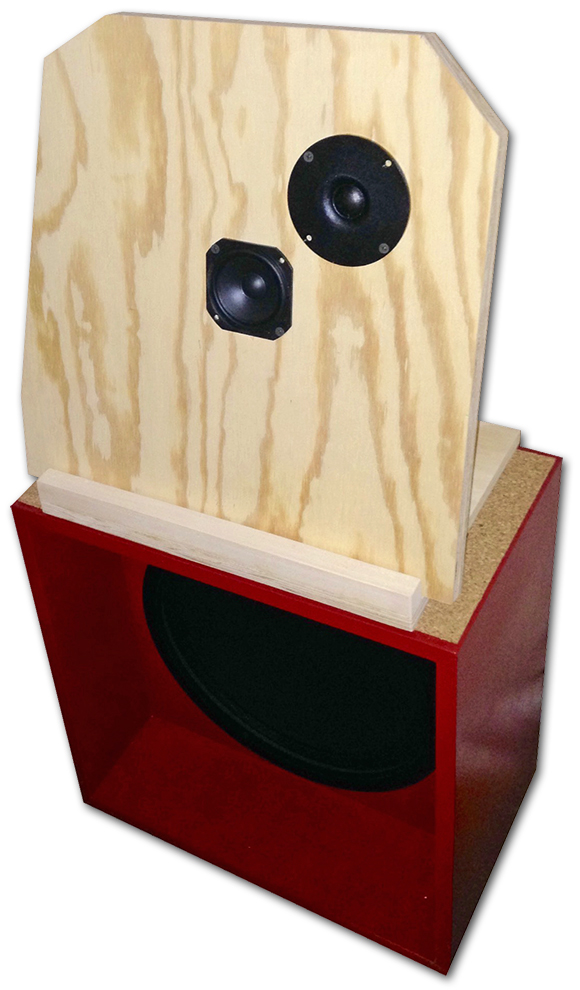

It has been clear in this thread since we started using the open back tweeter that you need to shape the back of the baffle to open up room for the driver to breath. Don't leave it stuck in a tunnel. Of course you don't want to rear mount the Vifa on a thick baffle, that just makes a tunnel in front of the driver. What may be harder to understand is that you can make a sub-baffle of thinner stock for the Vifa and mount that thin baffle in a hole cut into the main baffle. That can be easier, and often better, than cutting away around the back of the Vifa.
If your router skills are good enough and your baffle plywood strong, you can cut away a large opening from the back, leaving just enough thickness to mount the Vifa.
Using a thin enough sub-baffle, say 1/8" or 3/16" (somewhere around 3mm) then mounting the Vifa to the rear of that is possible. As to how much the diffraction from rear mounting is better or worse than the diffraction from the front mounted frame is going to be hard to determine. I doubt anyone here has done systematic tests. When front mounting with no inset, I like some felt around the tweeter.
Also you have mis-quoted me a bit.

How about beefing up the "sub frame" to allow a Pure Audio style "modular" solution, with the Vifa (Tymphany) in a thinner baffle and have that butted up against 3/4" thick baffle for the woofer and perhaps the top extent of the entire speaker? Of course done with an offset on the thin baffle to make up the difference, so the baffle face is as smooth a surface as possible.
Would this work? Due to prices of material it might actually lower the cost a bit more as well.
Given a full 3/4" thick baffle, would a half inch round over be sufficient to give the Vifa "breathing room" or does more material need to be removed for optimum results?

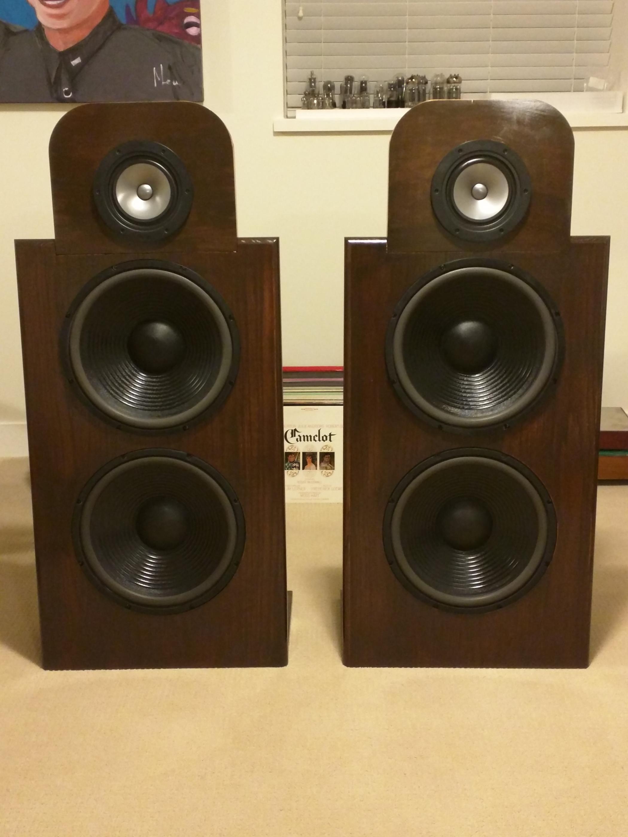

I built something similar but totally different. One thing for sure, I am a fan of open baffle using full range drivers and 15" woofers. I like the simplicity of a single baffle. Oceanw's project in post 1228 looks fantastic!
My project is here: https://speakerprojects.wordpress.com/2015/12/14/vifa-tc9-plus-helper-tweeter-on-open-baffle/

I lately look at the other pair of GRS sitting at the corner doing nothing and I can't stop the itch to make them work. I'm living with the ultra for almost 2years and thought I should give all those drivers a chance to perform. Therefore the ultra plus comes to mind. John is not going to release his commercial to the public and I have to try it out as a kind of experiment and wish I could have good result in some sort. I did Google for crossover point and asked advices from forum members. I have the speakers up running and tweaking at the moment. I'm smiling when writing this message.
Tell us what driver you are using up top, Albert.
Alpair 12?
Yes, It's Alpair 12
