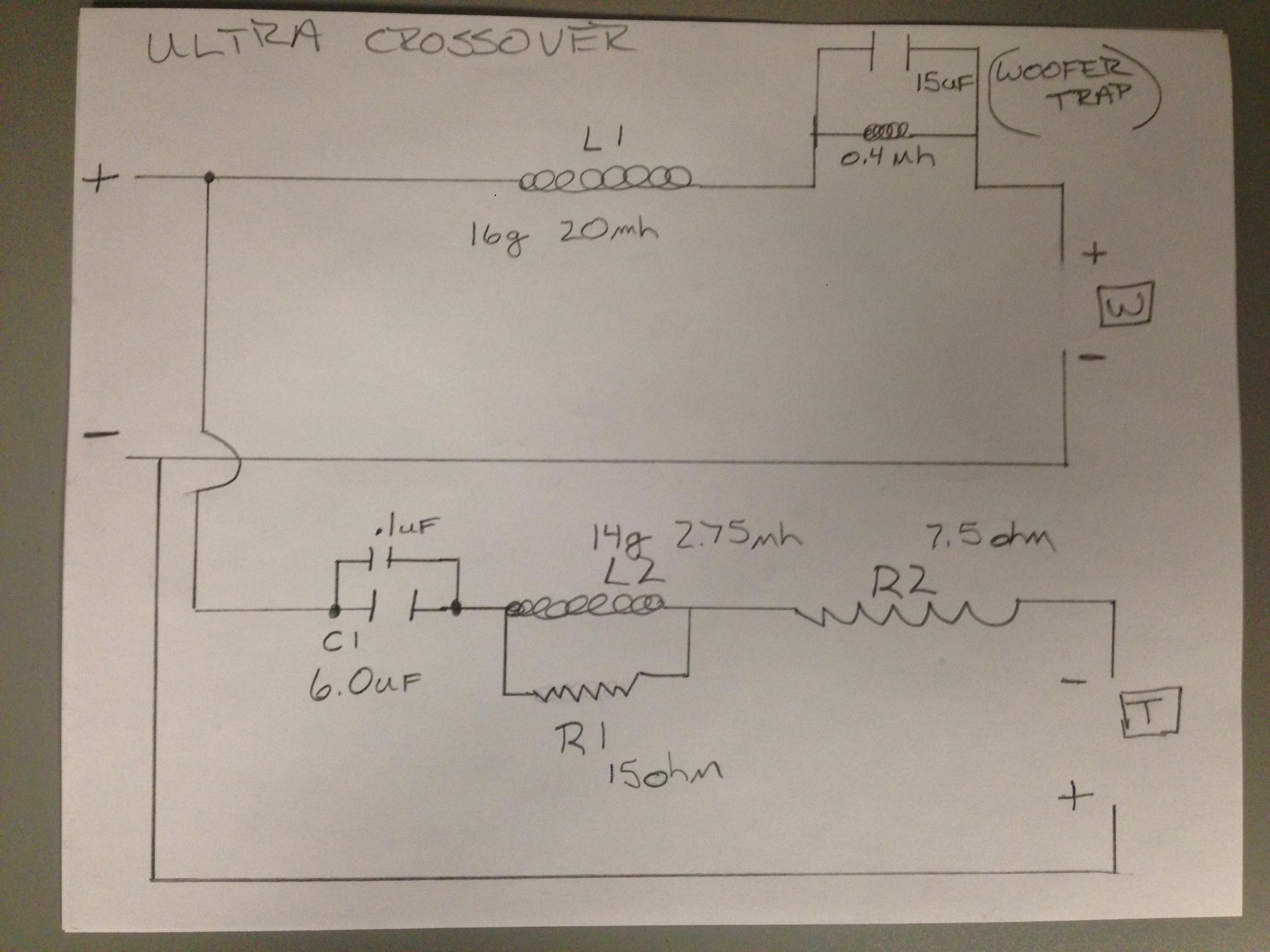

Does this crossover look right?
Please excuse my crude drawing, but does this crossover look correct? I have ordered the parts and want to make sure before any soldering starts. I put the value of the parts I am going to use on the drawing. After reading through the thread I decided to use a 7.5ohm resister on R2 so I have a little less attenuation on the high end. I hope to post a drawing of my planned speaker build later so it can be looked over prior to cutting any wood. Thanks everyone for your input.
That looks correct. I ended up with 8 ohm at R2
We're the high shrill sounding until you went to the 8ohm resister? Would you say you have a "live" sounding room? Just trying to get the right components. I thought I read somewhere where they had a laid back sound with the default crossover.
