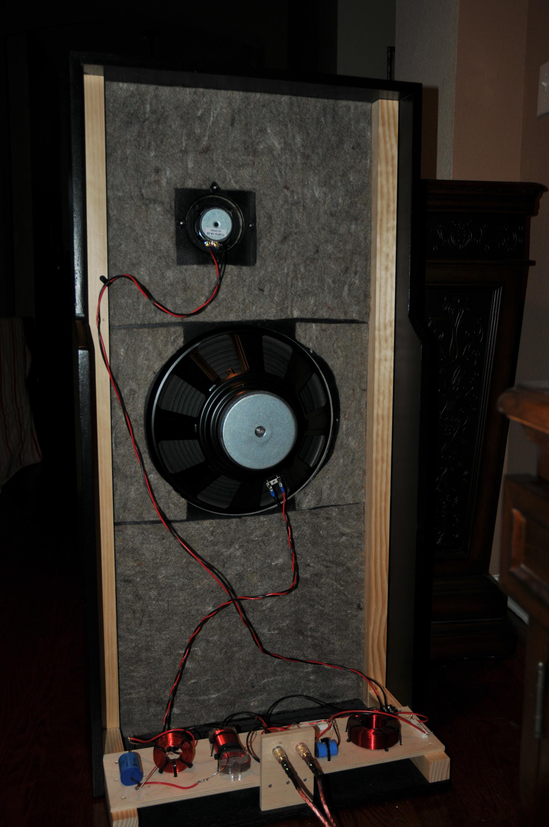

I have attached a few photos and I am still questioning my decision to put the cross brace at the top of the baffle. Should I cut that out? An easy fix with a jig saw if that will help to improve things.

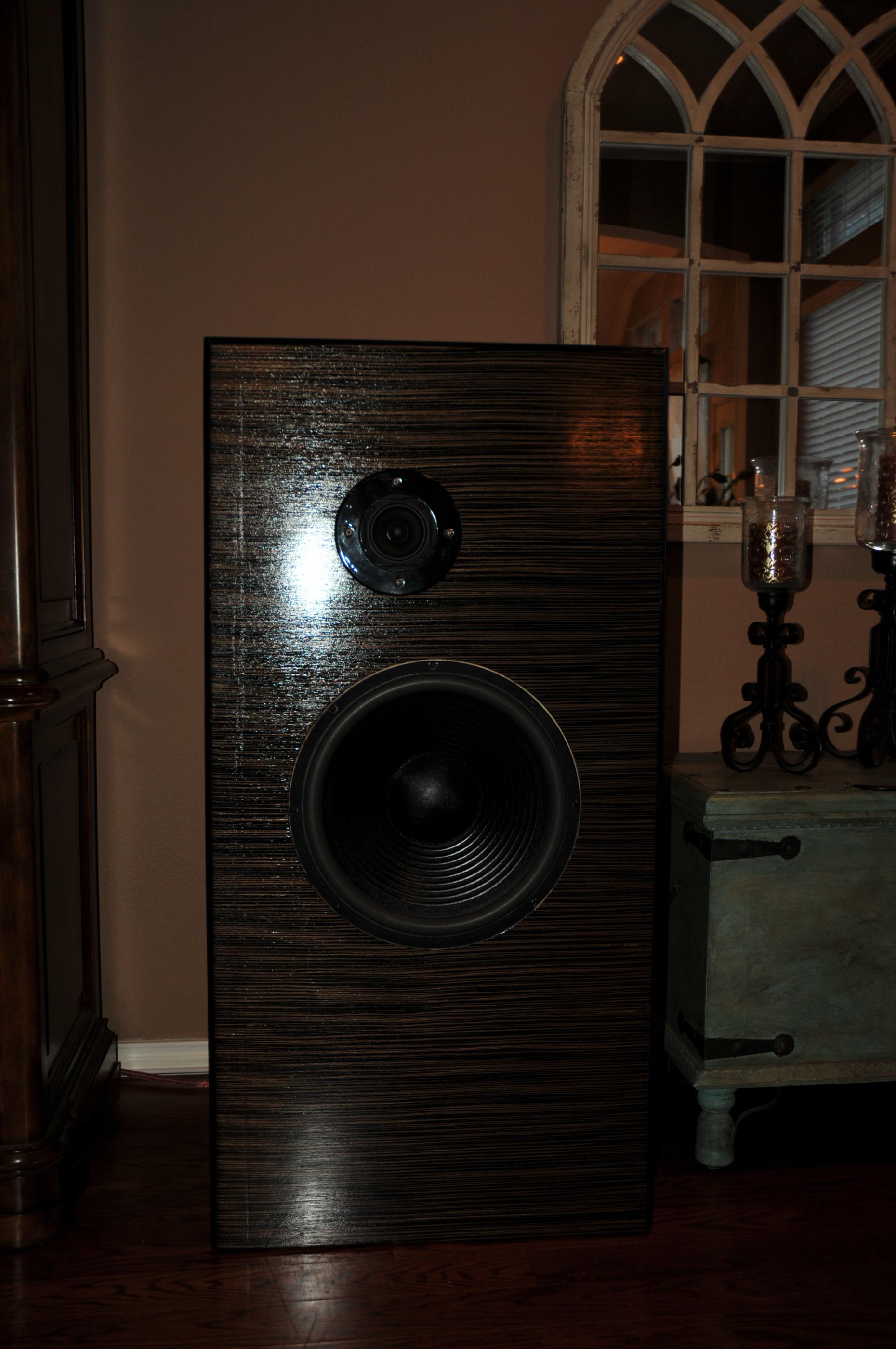

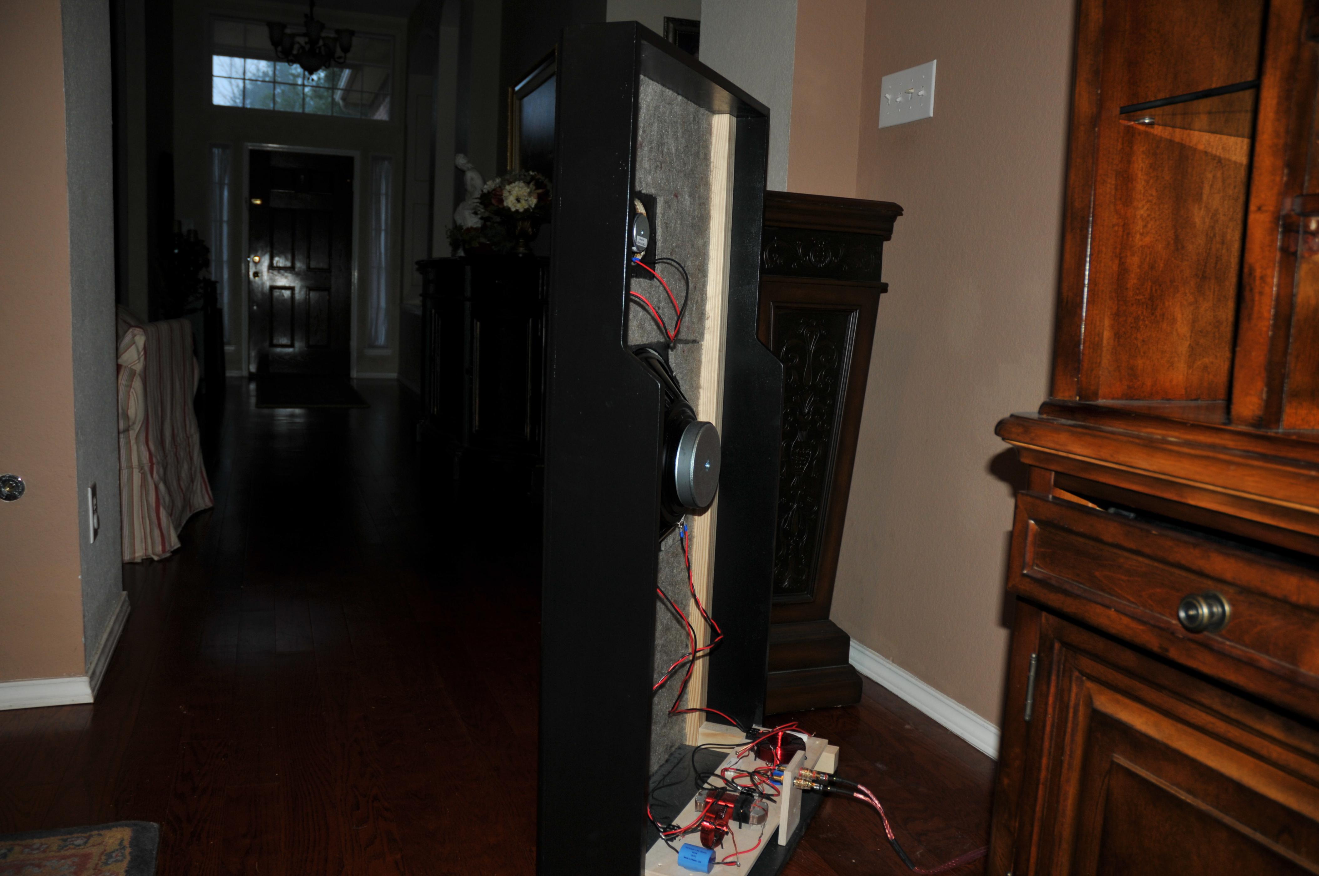

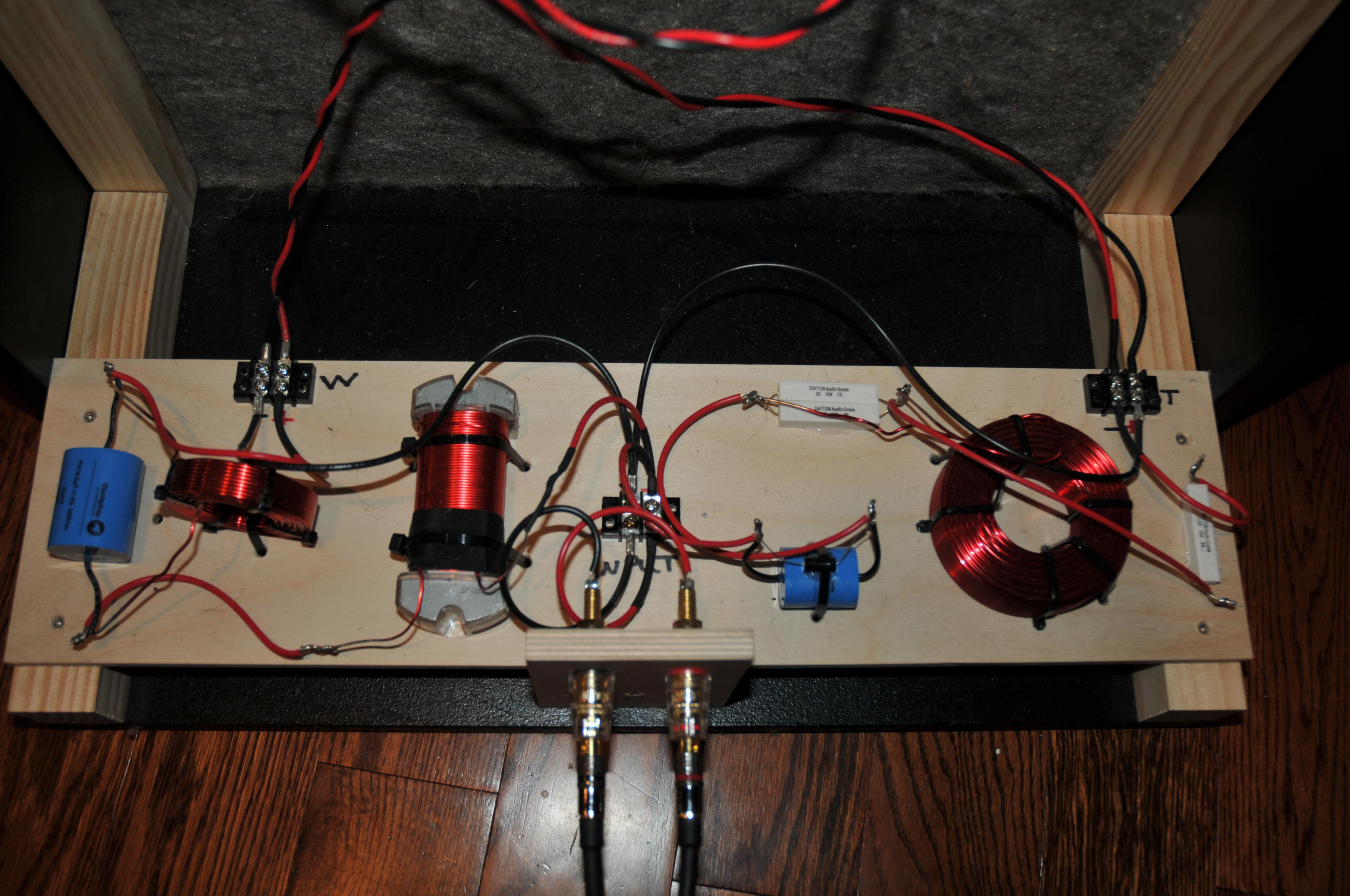

Here are the photos!
Here are the photos I spoke of.

Wasn't a CD player. I was playing through the crappy DAC in my phone. I don't play CD's much anymore. Mostly Vinyl and occasionally mp3 these days. As far as the wiring I'll let someone with more experience look that over. I'm new to this stuff. All I can say is that I haven't posted pictures of my wiring for a reason 🙂 Your's looks good next to my soldering skills.

Let's have a look at the crossover and talk about what each parts does. That can help you in understanding what happens when you make changes. And you should make some change to tune this to your room.
  • L1: is the big inductor on the woofer. It rolls off the top end of the woofer (a lot) making it more or less flat up to the point where the tweeter takes over.
  • C1: is the high pass filter for the tweeter. This cap blocks the bass from getting to the tweeter.
  • R2: This resistor lowers the overall level of the tweeter to match it to the woofer's level. It also changes the impedance of the tweeter circuit, which will affect how C1 works.
  • R1+L2: This is the tweeter trap. The inductor is a low pass filter, just like L1 on the woofer. It is a much smaller value, so it works at a higher frequency.
But why would you want a low pass filter on a tweeter? Seems odd. It's there for much the same reason it's on the woofer; to flatten the response. Otherwise the response rises too much as frequency increases. How much does it flatten? That's how we come to R1.
  • R1: This resistor partially bypasses the filter effect of L2. If it weren't there, the top end of the tweeter would be far too attenuated. R1 lets some highs and lows go around the L2 coil. By changing the value of R1, you change how much effect L2 has on the tweeter.
When adjusting the crossover, you generally leave L1 alone. It's the base of your bass. 😉
Adjusting the value of R2 will bring the overall level of the tweeter up and down (and slightly change the high pass frequency).
Adjusting the value of R1 will affect the tonality of the tweeter. It adjusts how much top end the tweeter has or does not have. Think of it as a hinge that tilts the response up or down. Lower resistance tilts UP, higher resistance tilts DOWN.
Once you are aware of what you are adjusting, it's time to listen for the changes. Hearing the difference between the level of the tweeter and its tonality can be difficult, but you'll learn by doing and listening.
If you really want to fine tune, you can put variable resistances in place of R1 and R2 and fine tune to your heart's content.
You might try something around a 30 ohm pot for R1 and 12 ohms for R2.
Using one leg of an L-Pad can work if you don't find the power potentiometers.
I hope that clears things up a little and can help guide you in your adjustments and tweaking.

The woofer trap is not shown above because it's optional. It does go in the woofer leg.
The trap is two parts; a 15uF cap and a 0.40mH coil in parallel. Connect this pair in series between L1 and the woofer.
This trap creates a sharp, deep null (or dip) at 2000 Hz. It mostly blocks that frequency from getting to the woofer, because the woofer is already very hot at 2K. That is typical for woofers this size.
Changing the values of either the cap or coil will shift the trap away from 2K. You should not need to adjust it.
