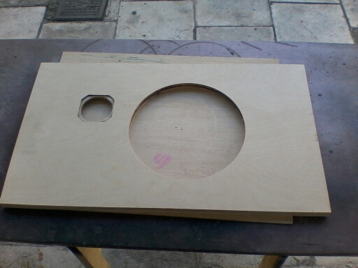

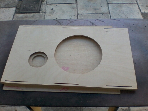

About Vifa. Is it critical to flash mount it ? It is not that easy to route it's shape.. Also, there is a flange in front of the chassis. Perhaps for positioning the unit at the back of it's supporting surface. What did you do with that ?
Hi Marinos, regarding surface vs flush mounting, have a look at:
Zaph|Audio

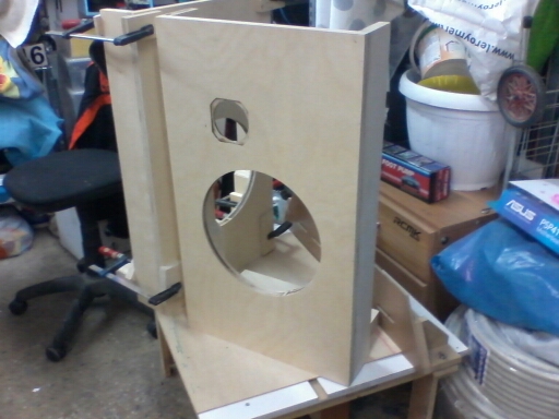

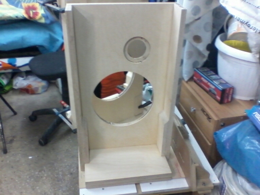

Woodworking is progressing ...
Material is plywood 21 mm thick. I preferred to have the baffle one piece and position the wings at the back. Recalculating accordingly, my baffle is 71 cm x 41,6 cm and the wings 71 cm x 8,9 cm.

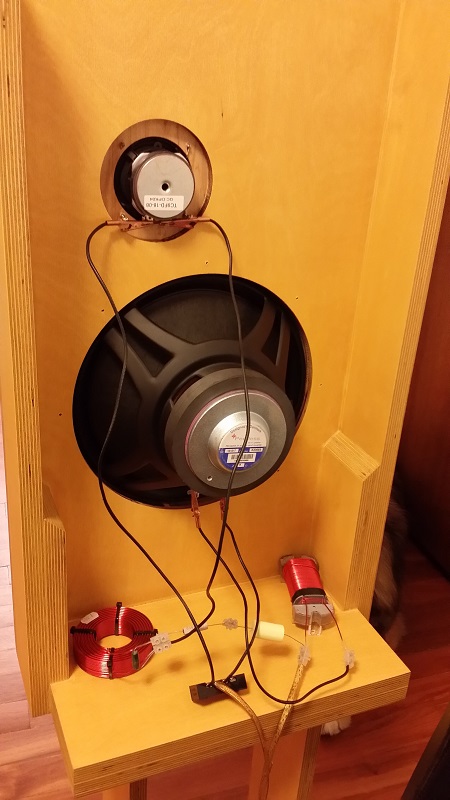

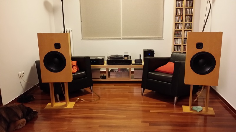

Here we are 🙂
SpongeBob meets Her Master's Voice.. Hahaha
+1 to satisfied Manzis builders. If you are thinking to start this project, do it. You will not be disappointed 😉
John and Pano, thanks for sharing and your support.
More details later..

Marinos... thank you for sharing your positive impression of the Manzanita. You have a lot of company who like this simple design. It has always been the goal to guide music lovers to build a simple speaker that.... for the effort and cost... can deliver a solid musical presentation. Enjoy!!
