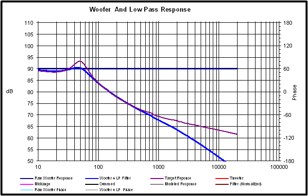

However, in post #99 MisterTwister suggested that instead of the big inductor in series with the Peerless it was possible to use a smaller inductor and a parallel resistor. In posts #101 and #102 Pano reported good results too. MisterTwister's suggestion seems interesting because the big inductor is so expensive, and it would be possible to spend the money on thicker wire. Is the idea still valid - and has anybody experimented with it - or is there some dark drawback that I haven't discovered?

I had forgotten all about that resistor trick. It's been awhile! The trade off is asking your amp to work harder, to deliver more current. If your amp is happy with it, why not? But sure to use a high wattage resistor.

One of my concerns before starting the project was how power greedy they really would be. But that concern was really put to shame. It is surprising how little they can make do with if you stay at reasonable listening levels, which I ususally do, so the power is not a big concern. As I don't own a simulation tool I would be happy if you were able to suggest component values as a starting point for experimentation (i.e. something to emulate the 20mH inductor - as far as I remember the one you suggested emulated a 12mH inductor).
You can trick the crossover by lowering the impedance of the woofer, thus needing a smaller inductor for the same crossover point. Below is a chart that shows the filter function using a 20mH inductor on the Peerless woofer (magenta) vs using a 12 mH inductor and 9R in parallel with the woofer. Very similar roll-off, with maybe a bit more damping in the L-R combo.
What's the trade off? Lower impedance. The impedance of the woofer + resistor doesn't rise back above 6 ohms until 1kHz. It hits a low of about 4 ohms. Not a problem by itself, but what happens when the Vifa is patched in? Where the woofer and the Vifa overlap, impedance may be very low. So low in that area that your amp may not like it.
Try it, but be aware of the impedance problem.

Magenta= 20mH series on Peerless woofer OB
Blue = 12 mH series + 9R across the Peerless
(NOTE: This is not the acoustic response, it's the low pass filter response)
