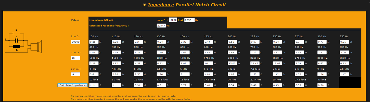

There is the option of adding a woofer trap in series with the woofer (coil - cap 15 uf & 0.40 mh in parallel with each other). I have never posted this as it is part of the commercial crossover and it does add to the build cost. This trap does clean the upper end of the woofer band pass.
Hope the above is helpful.
John

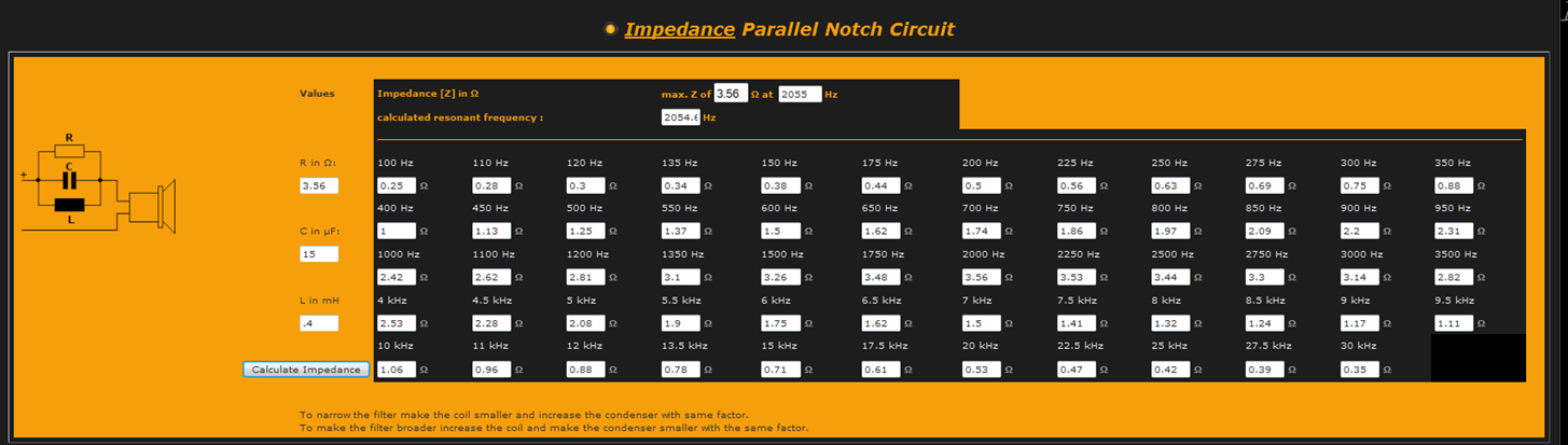

John - like this (see attached)? If so could you explain how this network works with the effective parallel notch filter network value of R being gigantic (i.e., it is an open circuit)?
From the mh-audio.nl - Home site, I input your C and L values (see attachment) with various resistor values up to 999,999 ohms. After playing with this calculator, I am confused with your lack of a resistor in your circuit.
The impedance calculator on this site shows the results of a 15uF, 0.4 mH, and two cases for "R" (999999 or as big as it would accept in calculator and 3.56 ohms). These are shown in the 2 attachments.
I guess I just don't understand and could use some education. Any insight into what is happening is very much appreciated.
gab
Parallel Notch Circuit
The main thing I was after is to set a resonate circuit at around 2K which is where both the 12 & 15 inch drivers break up. And that is what the two components do and with maximum attenuation assuming no parallel resistor. I do add in the crossover series resistances in the formula showing the speaker impedance to be about
8.8 ohms. And we save a $5.00 resistor doing it this way. And the broadness of the circuit also helps a little bit to tame the rising response of the woofer. The simple large 1st order inductor starts to lose it's effect around 1 KHz as the speakers natural impedance starts rising. Hope this info helps.
John
