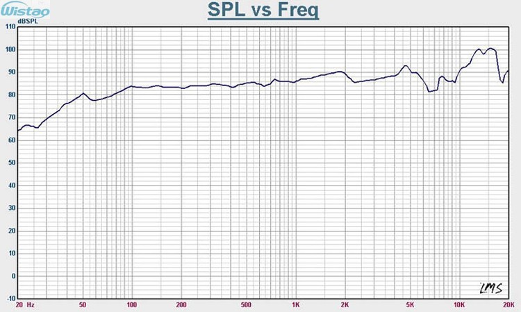

Ob project with Alpha 15a and aucharm 4 inch fr
Hi.I have a pair of nice sounding aucharm 4 inch full range driver.I wanna build an OB speaker with eminence alpha 15a. Which xo frequency do you recommend? Here is response of aucharm fr.They are 4 ohm drivers

There are quite a number of issues to deal with.... too many to make a crossover point recommendation at this time. Your 4" appears to have a 84 db or so sensitivity. The Emi 15 is around 10 db higher and has a large 10 db peak around 2Khz. And that's just the beginning of what one must deal with to end up with something listenable.
Need to know what your effective baffle width will be as that determines the true OB operating efficiency the Emi 15 will deliver.
Also, what is the FS & QTS of the 4"? Any off axis frequency response data available on the 4"? Knowing the Xmax would help too.

OK.... A bit suspicious of the T/S parameters... but will assume they are correct for now. Just don't know what you have until you actually measure...
With about 55 sq. CM of area and 2 mm X-max you will need to get out of this driver at around 700 hz or so assuming a 2nd order crossover slope. That would be a -6 db point. You can play it lower with a 4th order, (450 hz or so) but blending with a 15" with steep slopes (say 4th order or higher) is a difficult undertaking.
Do you have the 4" drivers and any way to verify the T/S parameters?

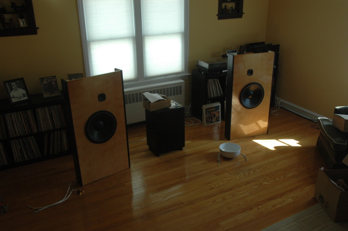

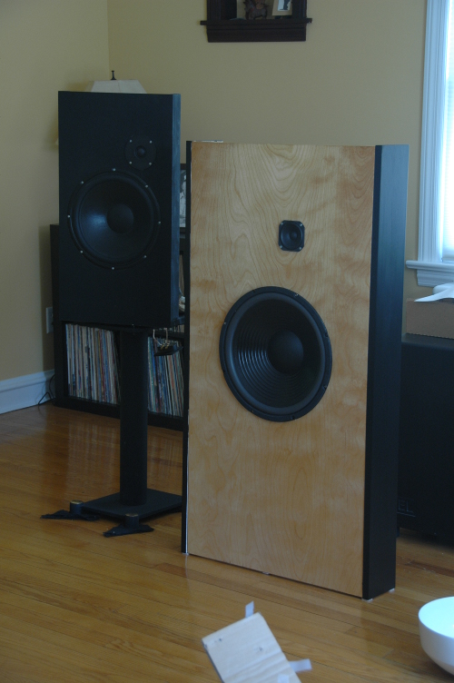

Another set of almost finished Ultras. Got them tacked together temporarily to listen to them before the heat rolled in for the Summer.
First off, they image like nobody's business. Instruments and vocalists just magically appear in between the baffles.
They do serious bass.
They show off system differences easily. Drop in a cleaner source/amp/preamp/etc and you will be rewarded big time.
The speakers have been broken in listening at a low (to moderate) level with a TDA3116 chip amp. The amp is putting out about 15 watts into 8 ohms with the current power supply. For Jazz, folk and pop/rock (at lower volumes) it's a great combo. Try to go loud or put something on that requires a lot of amplifier head room (orchestras, big bands, Squonk, etc.) and you'll want a *lot* more power. But for evening listening the small chip amp is wonderful and there is a real synergy between the amp and the speakers. It'll do serious justice to a jazz combo.
At this point they need to get their final finish coats applied to make them pretty and then they will be properly glued/braced together.
These are very fine sounding speakers. Don't let the ultra low cost part of it make you think otherwise.

Base plate
Donovas.... The base plate is shallow relative to the long wave lengths produced by the woofer and is far enough from the Vifa 3.5" not to mater. So the reflection potential is very low. The base plate does improve the structural integrity and offers a surface to mount the crossover components. And it adds a bit of weight at the bottom of the baffle improving stability. But you can build the Ultra with out it if you desire. Please let us know what you decide to do and good luck with the project!
Hi John,
Yes, I've tried the woofer trap but it was on green drivers in baffles that weren't glued down yet. It sounded like the trap improved the midrange but there were so many baffle resonances going on that it wasn't really a good test. When the baffles are together properly I'll do some listening with and without the trap and try to report how the sound changes.
The baffles are currently undergoing glue therapy. Hopefully the bottom pieces will be finished up later today so I can listen to them properly tonight.
There is truck bed liner for the back of them, too, but that will have to wait. I'm too impatient to put the liner on then wait several days or a week for the smell to subside before putting them back in the house.
Must. Have. Ultras.
Barry
