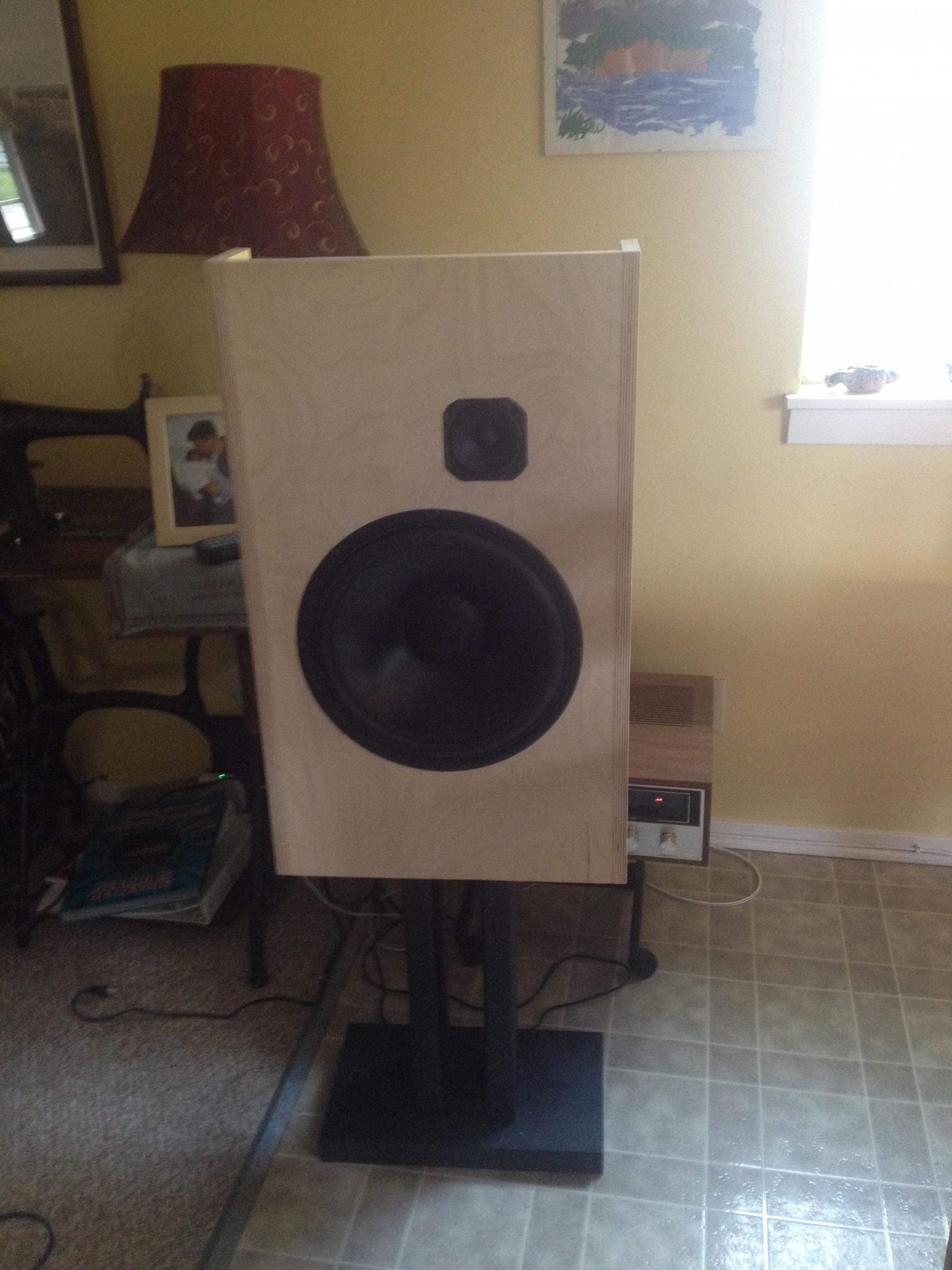

Manza 'birth'
I have my Manzas up and running. They are great sounding. I have found them to have a sweet spot with regards to type of music, quality of recording, and play volume. They didn't like my tube pre-amp as much as my solid state chain.
I'm going to play them for a while and let them "stretch their legs" so to speak. At the moment, I would like to rein in the beasts a bit. It's mostly bass that I'd like to dial back a bit. It is true that I don't have them in the optimal position for listening. They did rattle the house, not kidding!! Any advice on how to tame them... just a wee bit?
The Baltic birch baffle and wings are, as of yet, unfinished. I'm still trying to decide if I should simply coat that or put a veneer on top. I will post more pics of the back as I think I have a clean implementation of John's design (Thanks John!)
Again, many thanks to John B and all the helpful folks on this forum and thread. More pics to come.
Ryan
Ryan

Hello RKH
- you say that you want to "dial back the bass a bit" - are you sure that it isn't a room resonance you're hearing? (Especially that fact that they did "rattle the house" could point in that direction).
I think it was more my perception of the 'controlled' nature of the cone movement. I was no where near full volume and it seemed that the driver motion was extreme and the bass started to get a little ill-defined. It is true that I haven't spaced them in the listening room per the suggestions, so that is certainly part of it.
I will try the previous suggestion. It's not so much a reduction in bass as a bit of tightening of it.
Thanks,
Ryan
There are other things to try, as well. An amp with a higher damping factor has worked for me with this speaker and others. There isn't too far you can go, tho, considering the DCR of the big inductor.
A lot of content under the woofer Fs can also send it wobbling, so check that. But room placement is likely to make the biggest difference.
