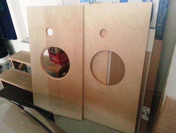

Ultra
My speakers are slowly coming. Hope to put them together in the coming weekend.
