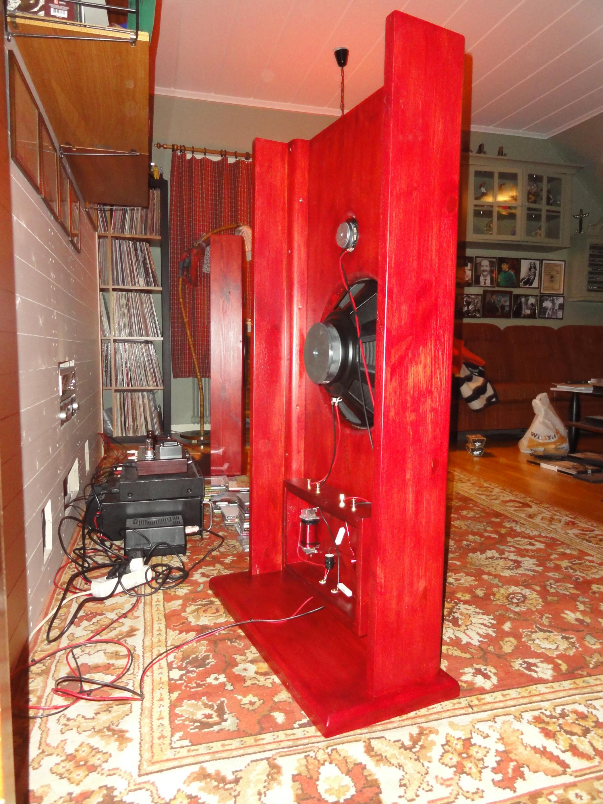

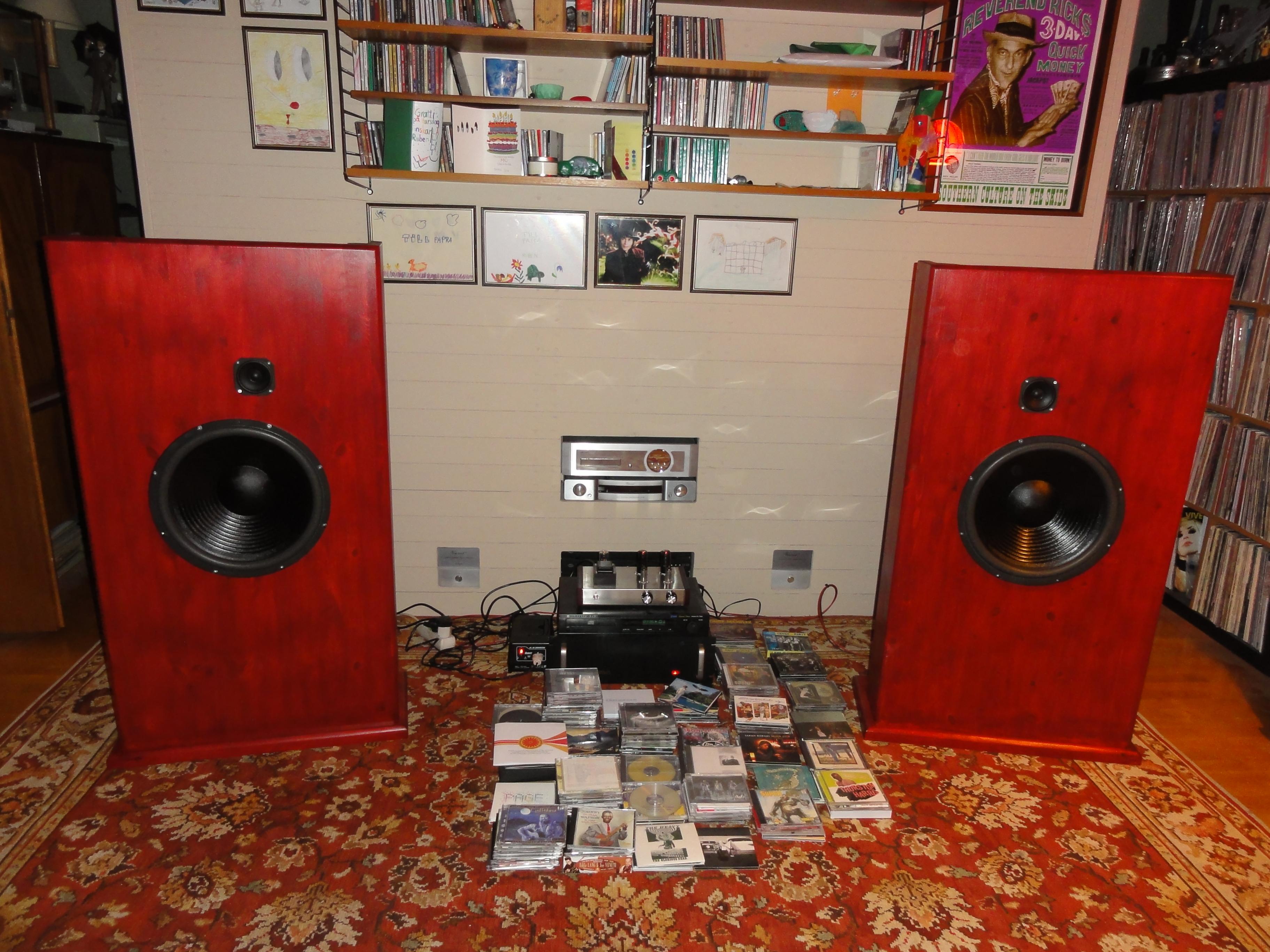

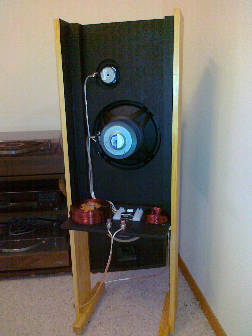

I have just now finished building my Manzanitas at long last, and I am now listening while the last coat of varnish dries. Very impressed first up with how good they sound, so clear etc etc etc compared to my old 3 way, base reflex corals. They look good too, even if I say so myself.
I have followed the recipe fairly closely (I started with C = 5u6 but have 6u and 6u2 on standby) but the main change was to use air cored inductors and 2mm wire.

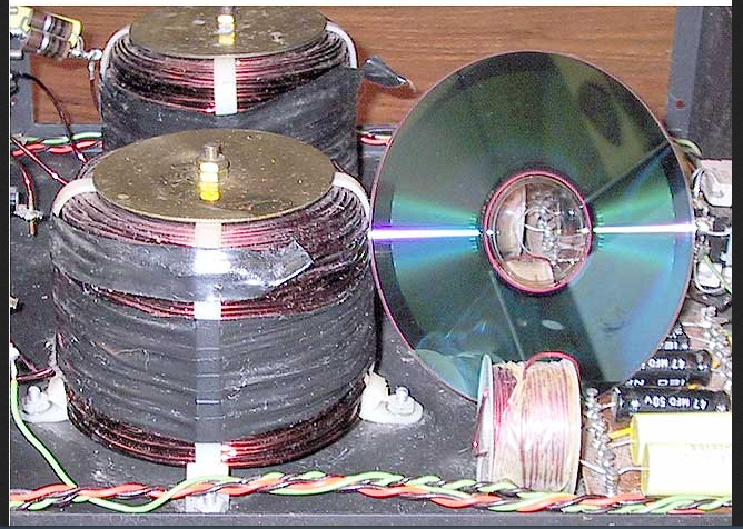

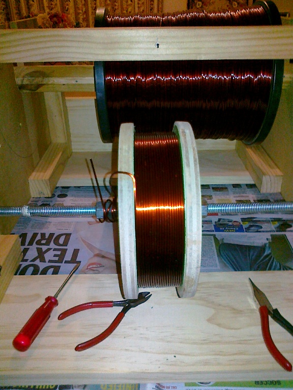

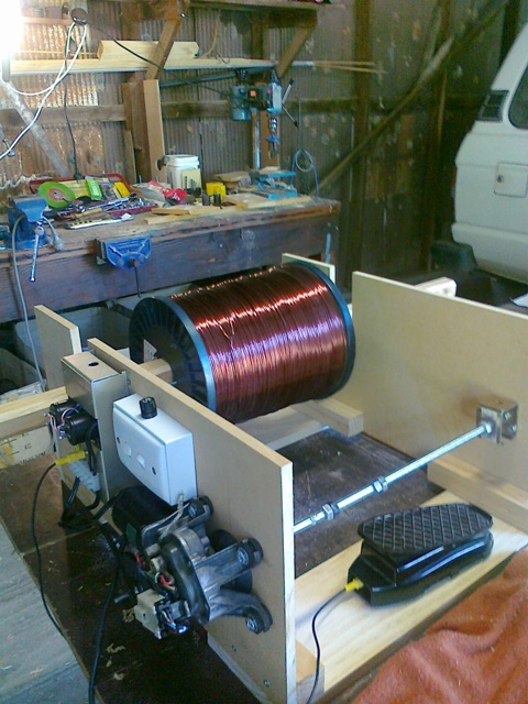

I soon found out 2mm is quite challenging to wind. So I designed and built a coil winder with enough torque to wind very tightly. (used a windscreen wiper motor from the wreckers and a home made pulse width controller to give a variable speed drive and re-wired the foot pedal from the sewing machine). The 20mH coils are both 19.95mH and about 0R9 after stripping off about 10 of the over-wind turns. Similarly the 2mH measured 2.04mH and 0R3. Weight is 5kg and 1.2kg. Measurement frequency 1kHz.

Great work on the speaker and on the coils! That may be the biggest crossover coil I've ever seen. 😱 Very glad to hear that you are enjoying the speakers.

I have used an ordinary 5mm iron coach bolt to hold the 20mH coil in place and I will try to find a non magnetic stainless or brass equivalent to finish off properly. While measuring I checked the impact of the iron bolt - it adds only 0.4mH to the 1kHz inductance.
However I do not know what effect it would have at the operating frequencies and currents, nor if there will be any saturation effects. Does anyone have experience in this area?
Quote- You may have the start of a small cottage business there -
I guess I am open to requests, there is enough copper left for 2 more pairs. The 36kg mother reel cost me over AU$550 and that was a clearance price for a part used reel.

Thanks, I used the Brooks approximation for minimum copper length which gives a square profile - equal turns and layers. It was very challenging to get a perfect lay like that and I suspect there is a vastly diminished return on the effort. What you see is the first coil. The bobbin for the next one was made 2 turns larger but for some reason I could only fit one then zero extra turns on alternate layers. With extra spaces between each turn the lay became uneven and the finish was nowhere near as professional. However the roughy only had 5 extra turns on it get the same inductance.
My understanding is that excess inter-winding distance in an air core only affects the net inductance and not frequency or current responses of the solenoid - is this true?

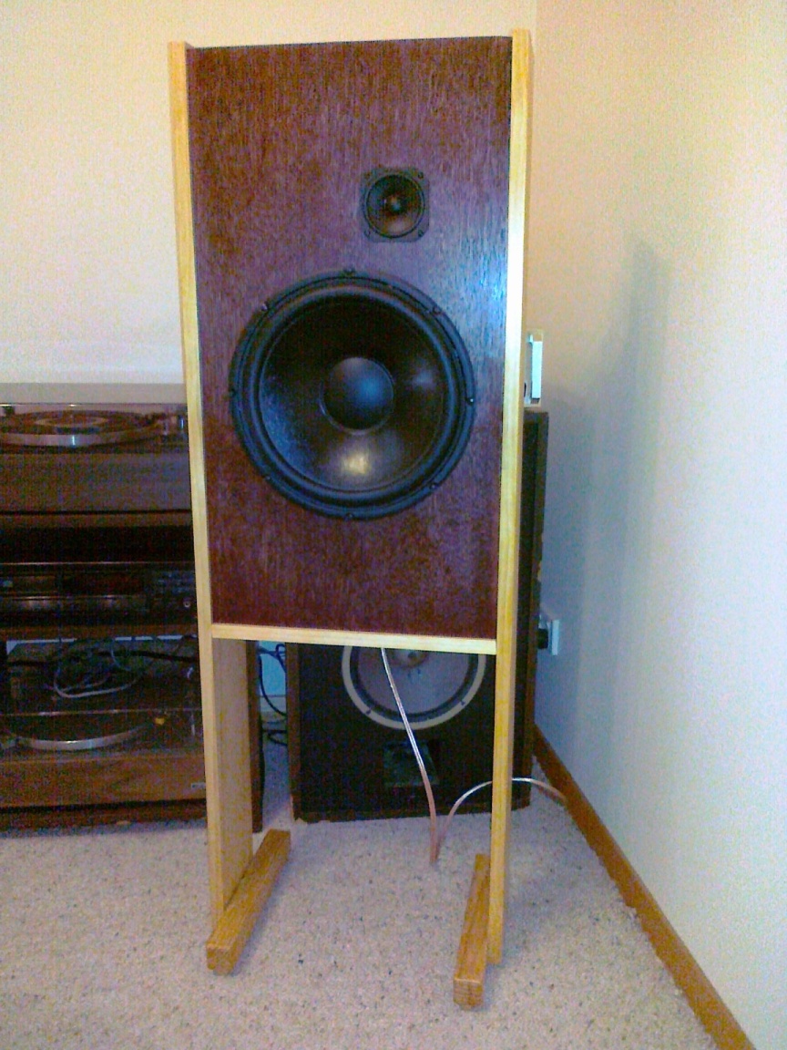

BTW, I really like what you did with the sides and legs. That's something I had discussed with John B a couple of years back, as so many people objected to having to put the Manzies on a stand. Building the stand into the sides is a great way to do it. :up:

My amp has the volume knob about 40% higher to get roughly the same volume out as the old bass reflex speakers. OBs do indeed eat watts.
20mH has 0R95 dcr (compared to 0R56 for the recommended ERSE) and the 2mH has 0R27 (compared to 0R7 for the ERSE). Believe this giving me more high end and less low end and this is becoming more apparent as the speakers age.
I am currently using 5u6 with 4R7 on the pad and 10R in the trap per your spec, but to re-balance the output for the higher 20mH dcR I am planning to increase C to 6u2 and the pad to 5R6. Maybe the trap could increase to 12R. But I will let the drivers settle more first.
The rear wall distance is really fascinating.
WAF says as close to the wall as possible leading to harshness and diminished bass. Sounds horrid.
But 48 inches into room and about 18 inches in from the side and the bass returns and the treble mellows. So we are at an impasse of sorts. And she doesn't yet know about the sewing machine. However I have my eye on a lovely little red ducatti to buy her as a peace offering (and no, she doesn't ride - te he he he)
The room itself is L shaped with large curtained windows on both long sides. The stereo is currently in the shorter/narrower arm of the "L". I am going to reverse the position to the larger half which is about 14x19 feet vs 9x13.
Finally I am using a cheap karaoke amp while I finish the 5 a side Leach amp that I am building and I am certain its freq response is not too flash. This is probably having a negative impact on my listening impressions now, so at the least I need to measure its response and only fiddle accordingly.

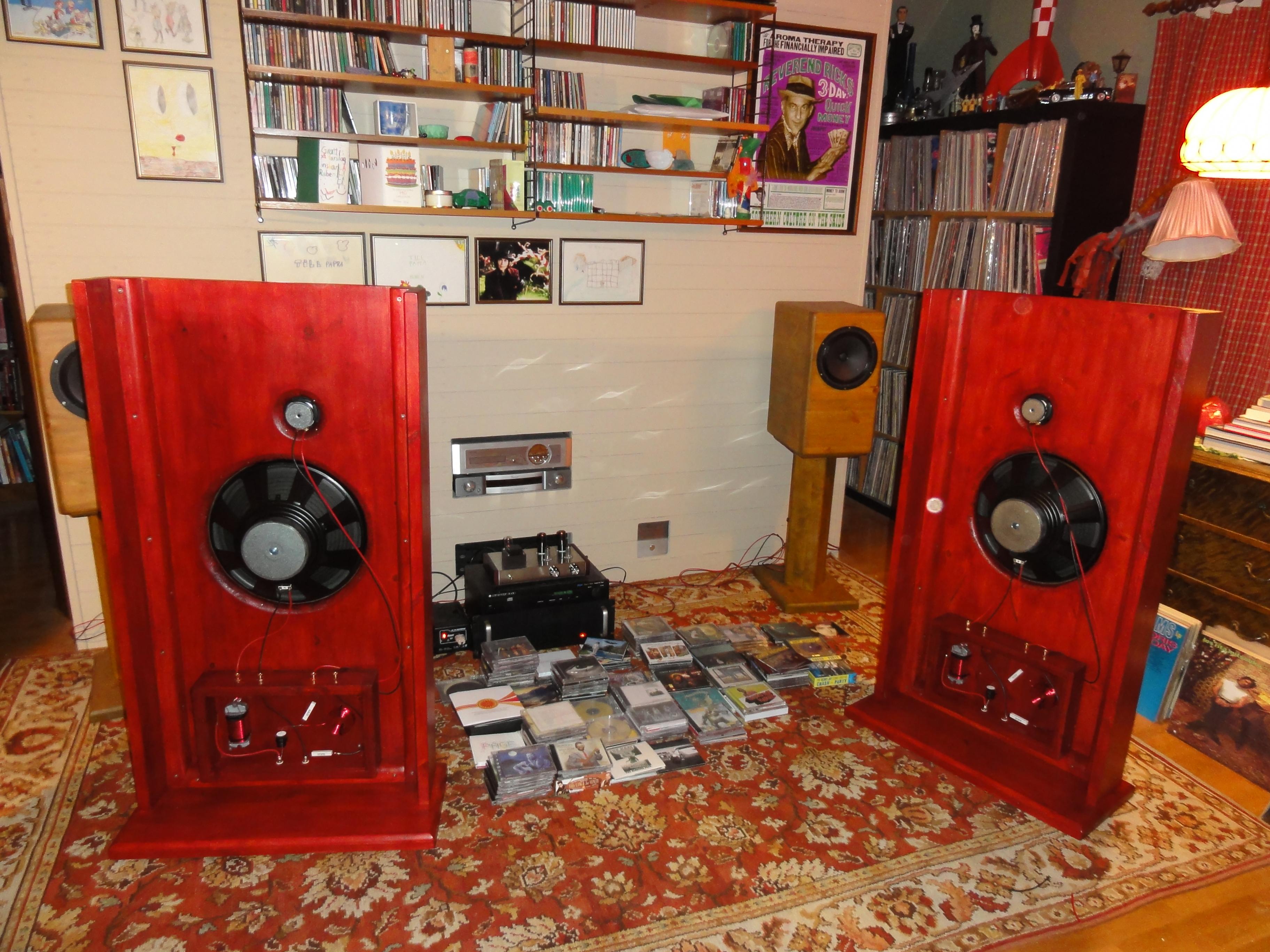

My new Manzanita Ultra build.
Hello John and fellow diy builders. I have had the great fun of building the Manzanita Ultra's the last couple of weeks. I hooked up the speakers to my tube pre-amp and B&K ST202+ power amp yesterday night. First impressions are very good, with a very impressive bass and homogenous overall sound. Very low and clean bass notes. This is only my first listening impressions with new drivers, no proper burn-in period done. Thank you so much John for sharing this exciting and elegant design with the diy community! \Hans in Holmsund, Sweden.
