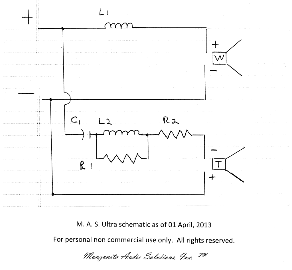

😉Hello all...
I am providing the current build info in two parts...
First is a Bill of Materials....
Second will be a separately posted schematic diagram...
BOM & schematic can be matched up to complete the build....
OK.... BOM.....
L1 Woofer 1st order low pass electrical inductor. 18-22 MH Iron core. 15-16 ga. Default part at the moment is PE P/N 266-960 (16 ga. 20 MH)
L2 H.F. trap inductor 2.75 MH air core Perfect Lay Solen. 14 Ga. (Madisound) Range can vary from 2.4 - 2.90 MH Also available from PE.
C1 H.F. 1st order electrical high pass capacitor. 6.0 MFD. Possible PE P/N 027-236. 5.5 - 6.5 MFD to suit. Higher cost caps of equal MFD value are available from numerous sources. Look for 200 Volt or higher Poly, film and foil, MKP or Oil construction.
R1 HF trap bypass resistor... 15.0 ohm, 5-10 watt low noise MILS. Range can vary from 12-25 ohms.
R2 H.F Pad...8.0 ohm, 5-10 watt low noise MILS. Range can vary from 7-9 ohms.
Woofer. GRS-15PF-8 15" woofer. PE P/N 292-415.
Mid-tweeter. Vifa TC9FD18-08. PE 264-1062. Also available at Madisound.
Current MAS Ultra Schematic
Please find the current MAS Ultra schematic. Enjoy!

I'm making a list of the parts. On your website, I see that there is also a MME Manzanita. Is the partlist and schematics of that one also available? And which one do you recommend for a first time builder who has a KT88 PP, but wants a 300B SE in the future.
