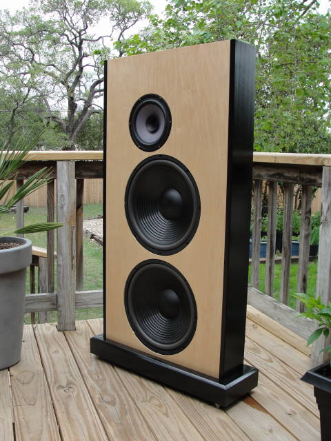

Also appearing in a limited engagement....
The second OB will be the Ultra Plus! I think it will be a popular item. Just shy of 90 dbw and flat to below 30 Hz. And the mid and upper end is handled by the excellent Seas FR22. Think you will enjoy this design... a lot!
That is sexy John. Love the black/natural contrast.

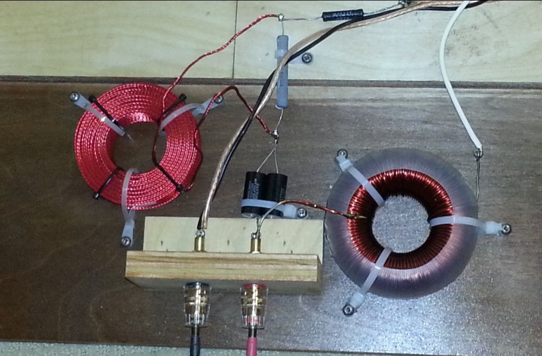

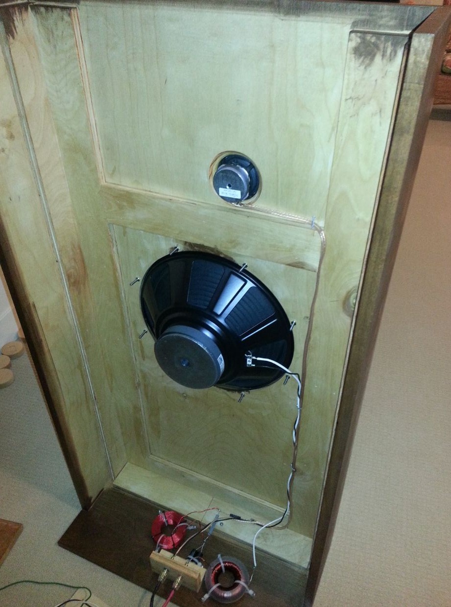

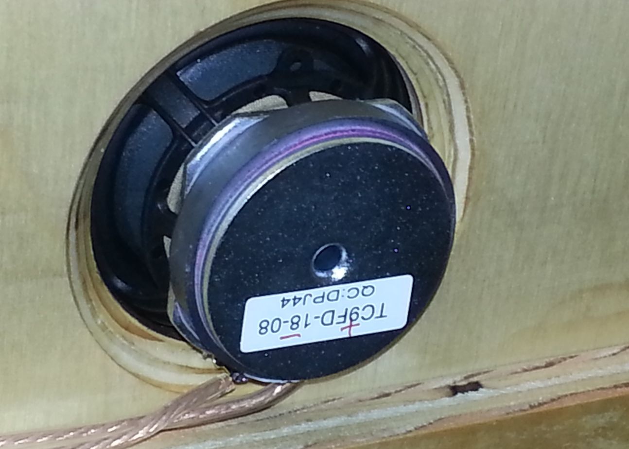

I finally have my Ultra finished today.
I have Jensen 18 mH for the woofer, n Solen 14 ga for the full range. Have them listen for about an hour now, sound promising and with lot of bass, punchy deep bass. Will give detail comment after some 300 hrs.

Very cool, let us know how it goes. You may need to adjust some crossover values a little, if you find it doesn't suit your room just right.

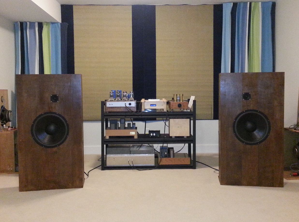

I finally built the Ultra this past weekend after having all the parts for well over a year - man I'm slow 😱
I was a bit disappointed with the GRS 15's drivers as the frames were bent/distorted. The packaging of the GRS's was poor to non-existent. I waited too long before I did a thorough inspection of the speakers. Parts Express wouldn't let me return them for an exchange - which was expected. I did send them pictures of the problem though.
Anyway, I mounted the GRS's and most of the frame distortion went away. I listened to these for a few hours and they sound fantastic. Nice solid bass and I love these little Vifa full rangers. Thanks to John and Pano for all their hard work.
Cool! Happy to hear that you got it finished. Bummer about the woofers. 🙁 I had that happen to me shipping a pair of Selenium 15s back from Hawaii. One was bent so badly it was ruined. I didn't notice until months later. Too late to claim the insurance.
Anyway. Glad you are up and running. Keep us up to date on the project.
