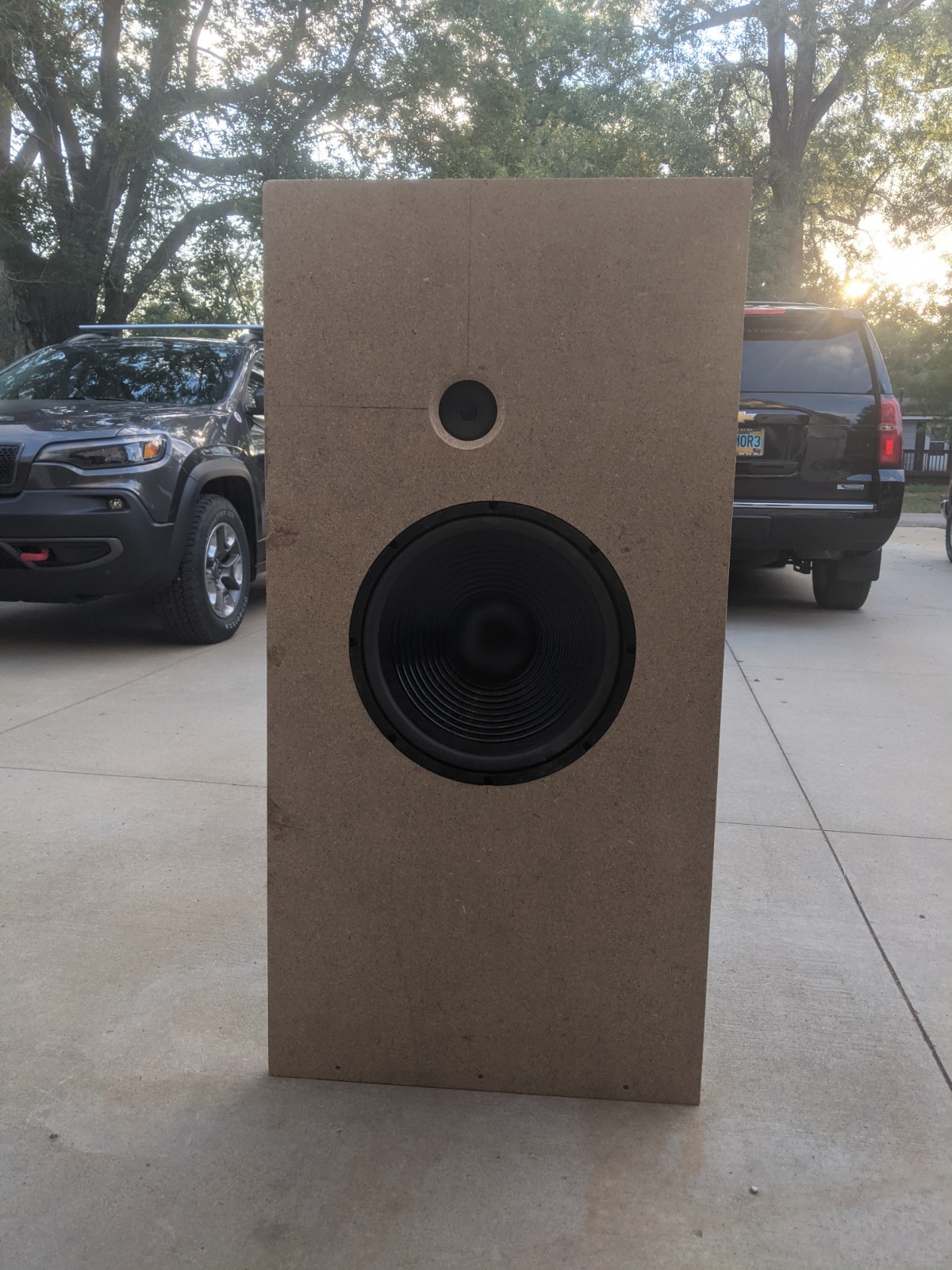

A little headway. Rear-mounted the TC 9. More tomorrow.
