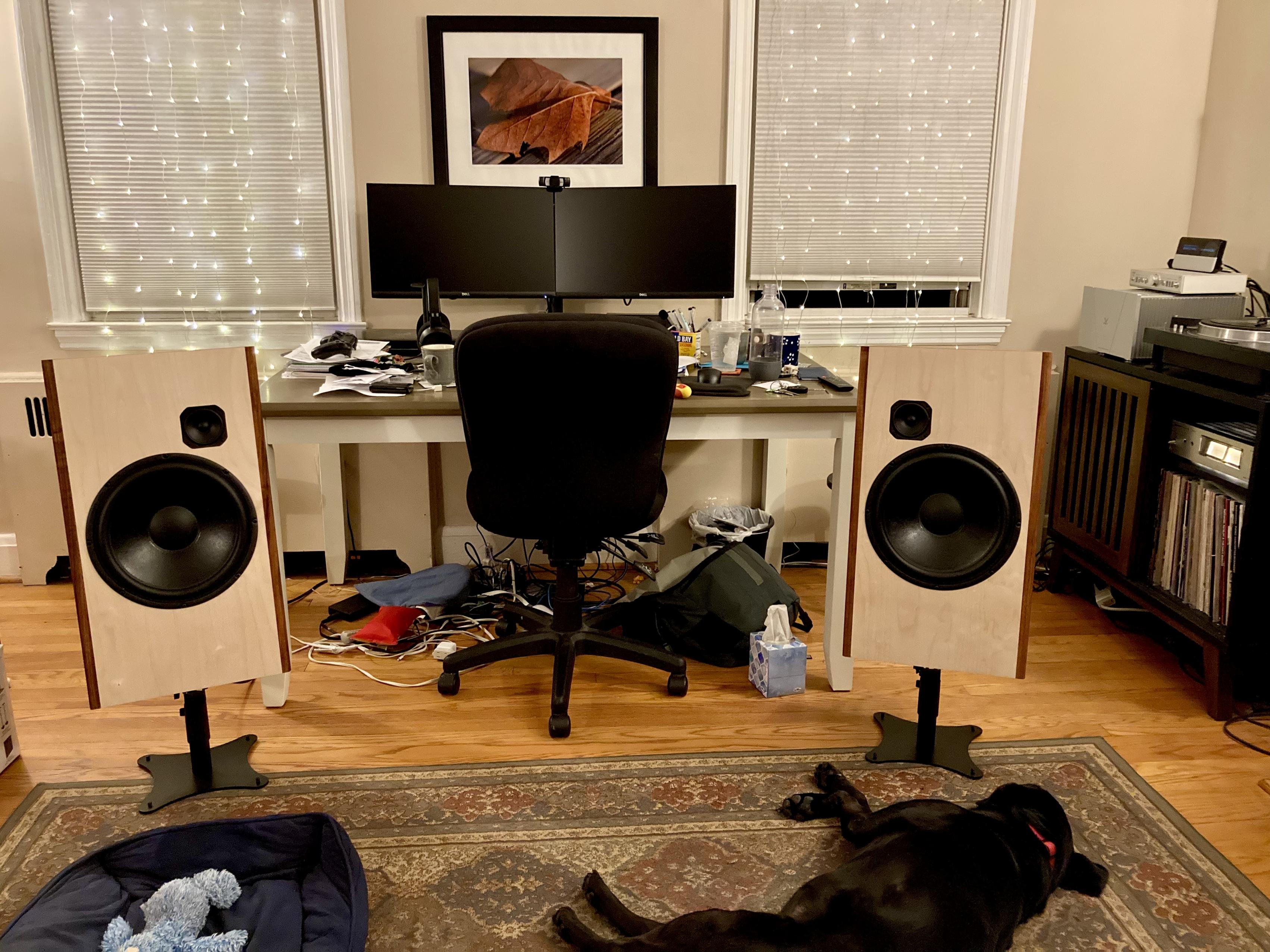

Excellent, These simple speakers will tell you the character of the amplifier behind them. Have fun!
My dog is enjoying the experimenting. Good girl. 🙂
I received my updated stands this evening. They allow for height and tilt adjustment, which is great. They’re pretty sturdy, but the connecting hardware doesn’t exactly instill confidence in maintaining square alignment. It takes a little extra futzing to get them set in the right spot.
For everything they offer, they are a good bargain, however. So I recommend them as good Manzanita stands.

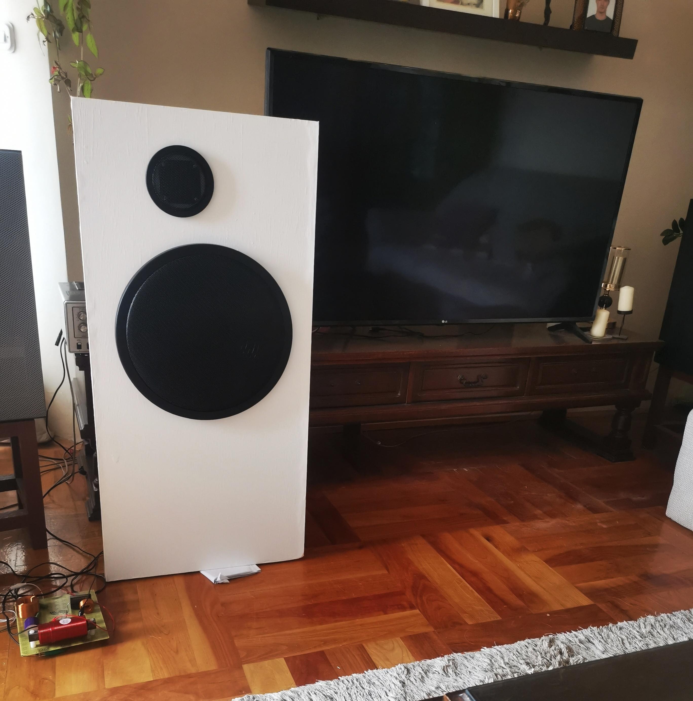

Finished the build of first speaker.. I deviated from original dimensions. Speaker are little bit smaller than regular ultra.. Today I will finish the second one and hear them in stereo. I borrowed some ideas from spatial audio sapphire aesthetics.. Initial impression is that it is a nice speaker, little bit on the mid-fi side.. It lacks fine detail, three dimensionality and bass extension compared to closed box speakers that I usually listen to. I hope they will open up once the drivers break in and aligator clips are replaced with speaker cable. Anyway, lots of fun with my first build. I will record demo with good mics and post it once it is finished.
Let us know how it goes when you get stereo. It is suggested to tweak the crossover to suit your room. Mostly the tweeter section of the crossover.
I tried stereo pair. Bass is really exciting, but I will need to work on crossover.
I went with recommended values, but TC9 to my ears just sounds too mellow.
There is no top end, everything above 8khz sounds plastic and dull, resulting in small and two dimensional soundstage. Crancking the treble on the amplifier doesnt seem to improve ability to reproduce detail. I will try to measure the response to see whats going on.

Let 'em cook for a bit. The TC9 takes a bit to settle in. The woofer might need a bit of time, too, but it was the tweeter that really seemed to change the most.
Properly settled in and pulled away from the wall (3 or 4 feet) they pretty much vanish sonically. They have a big sound stage that doesn't seem connected to the physical speakers at all.
After they have some time on them you may still want to tweak the crossover but the sound probably hasn't quite settled in yet.

I added 3R paralel to 8R attenuator and tc9 has come to life.. There is still some "air" missing. I will try to reduce the 15R on filter to 8R and see what will happen. Mine manzanitas are standing on the floor so low end might be too much for vifas in recommended configuration. Im starting to see why people love this design so much - preformer is in the room with you instead of polished 3D soundstage behind the speakers 🙂
