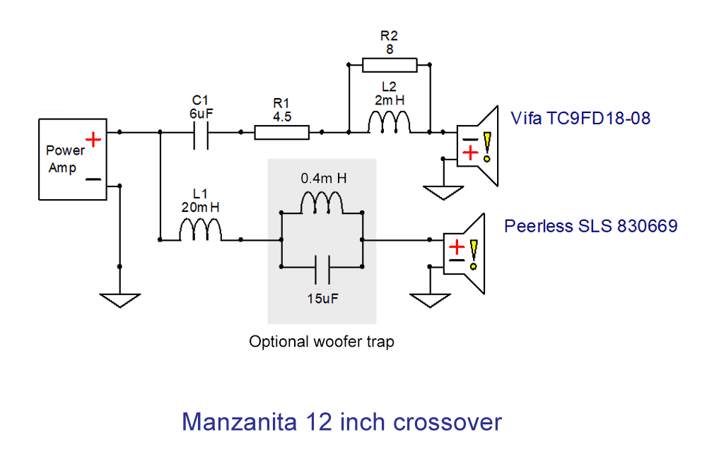

Here we have the simple and clever crossover that makes this OB speaker work. See below for the 12 and 15 inch versions. Actually, either crossover will work with either woofer, but the versions below have been tweaked for best performance with the different woofers. The big piece is the low pass inductor on the woofer. It can be 18-22mH, default 20mH. Use a 14 gauge iron core inductor. This is available from Erse, Madisound or Parts Express in the USA. This part is relatively expensive, but important to the design. Default part at the moment is Parts Express P/N 266-960 (16 ga. 20 MH)

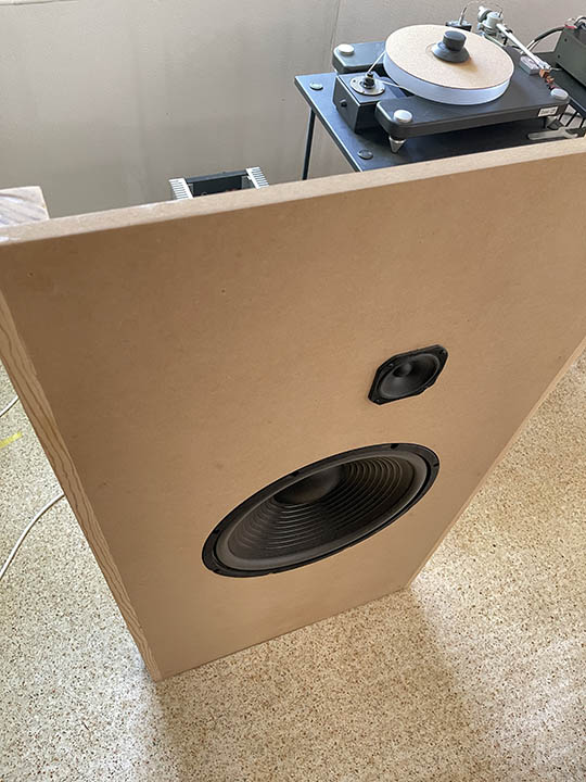

I thought I’d just keep this thread alive and let everyone know this design is still getting built.
I knocked together the 12” inch version from and old bed head I had laying around and was amazed by the open baffle experience 😱
The baffle is only particle board so the woofer really excites it and the thin panel the vifa is mounted in vibrates considerably so I’ve got a few improvements planned for the next build.

Yes, crossovers can be tough to learn at the beginning. But it helps if you think of passive crossovers as voltage dividers - frequency dependent voltage dividers. Resistors lower everything, capacitors block the lows, inductors (coils) block the highs. You can use these alone or in combination to achieve what you want.
Let's take a look at the tweeter section of the Manzanita crossover in the most basic way.
What does each part do?
Those are the very basics.
- The resistor R1 restricts the amount of current that can flow thru the Vifa. Lower current= lower sound level. This resistor lowers the level of all frequencies to bring the Vifa's output down to the level of the woofer. We are now level matched
- Capacitor C1 is the high pass filter. Being a cap, it's going to restrict the current flow of the low frequencies. Again, lower current = lower output. C1 turns the Vifa into a tweeter be not allowing current flow in the low frequencies.
- L2 and R2. They tame the rising response of the Vifa, which gets louder as the frequencies go up. L2 is an inductor so it blocks current flow at high frequencies, just as C1 blocks current flow at low frequencies. L1 alone would roll off all the top end of the Vifa, it would act as a low pass filter. That's were R2 comes in. R2 is a bypass of L1 letting some current flow at all frequencies. While L1 is blocking the highs, R2 is letting some go thru, which makes them work together as a high shelf, just tilting down the rising response of the Vifa and making it flat. Or sort of flat.
