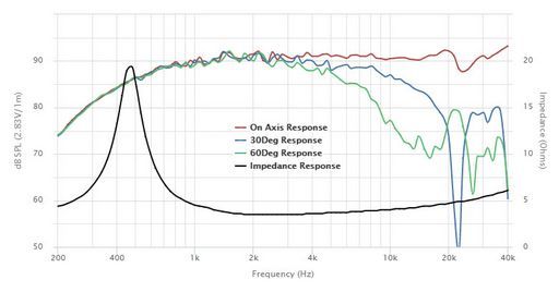

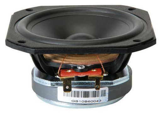

I have Peerless 830669s coming but at the moment it seems very difficult to source the TC9FDs for a reasonable price - at least in Australia. Is the Vifa TG9FD10-04 (pictured below, diagonally, with its response chart) something that I could use as a substitute for the TC9, without having to completely reinvent the wheel, even though it's nominally 4 ohms?

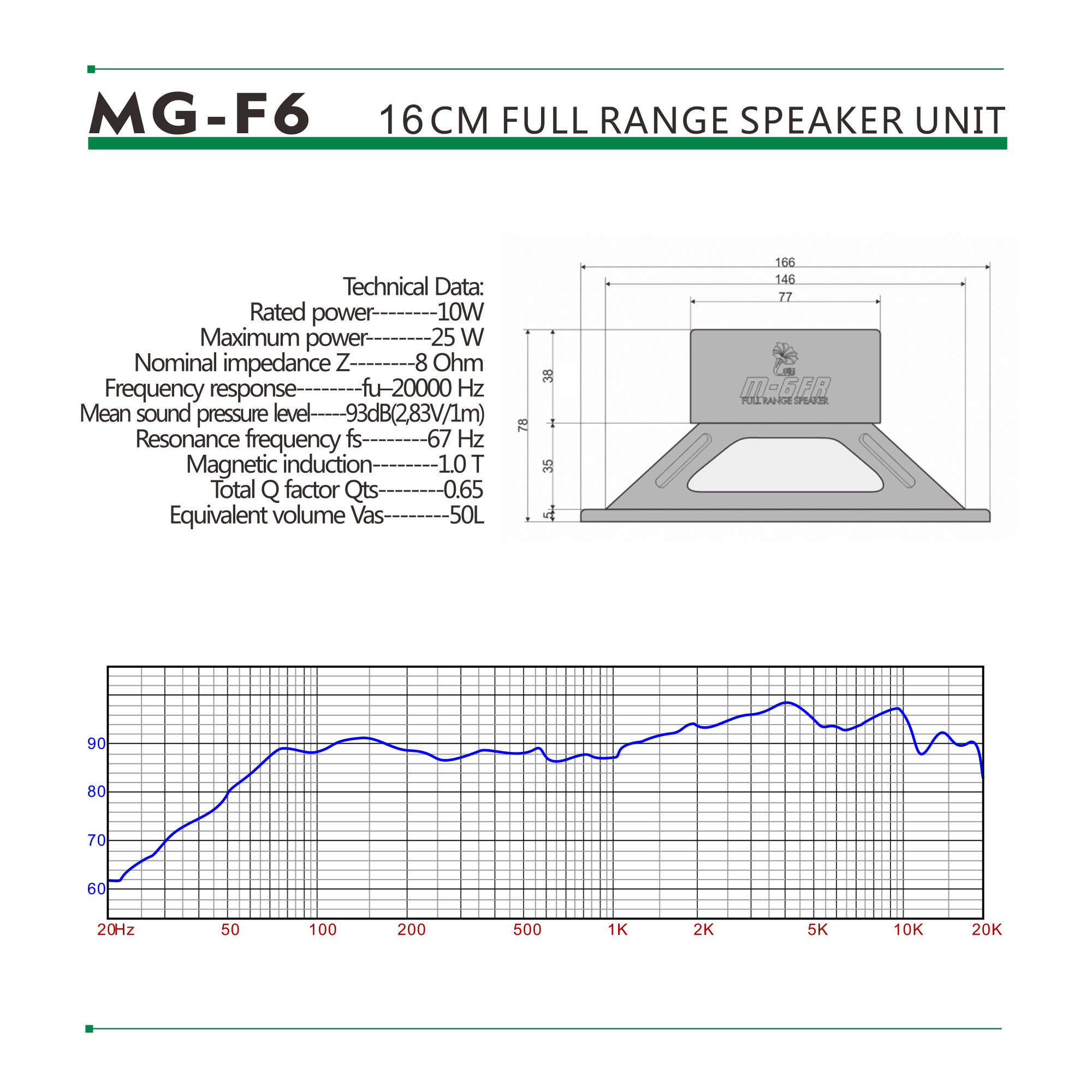

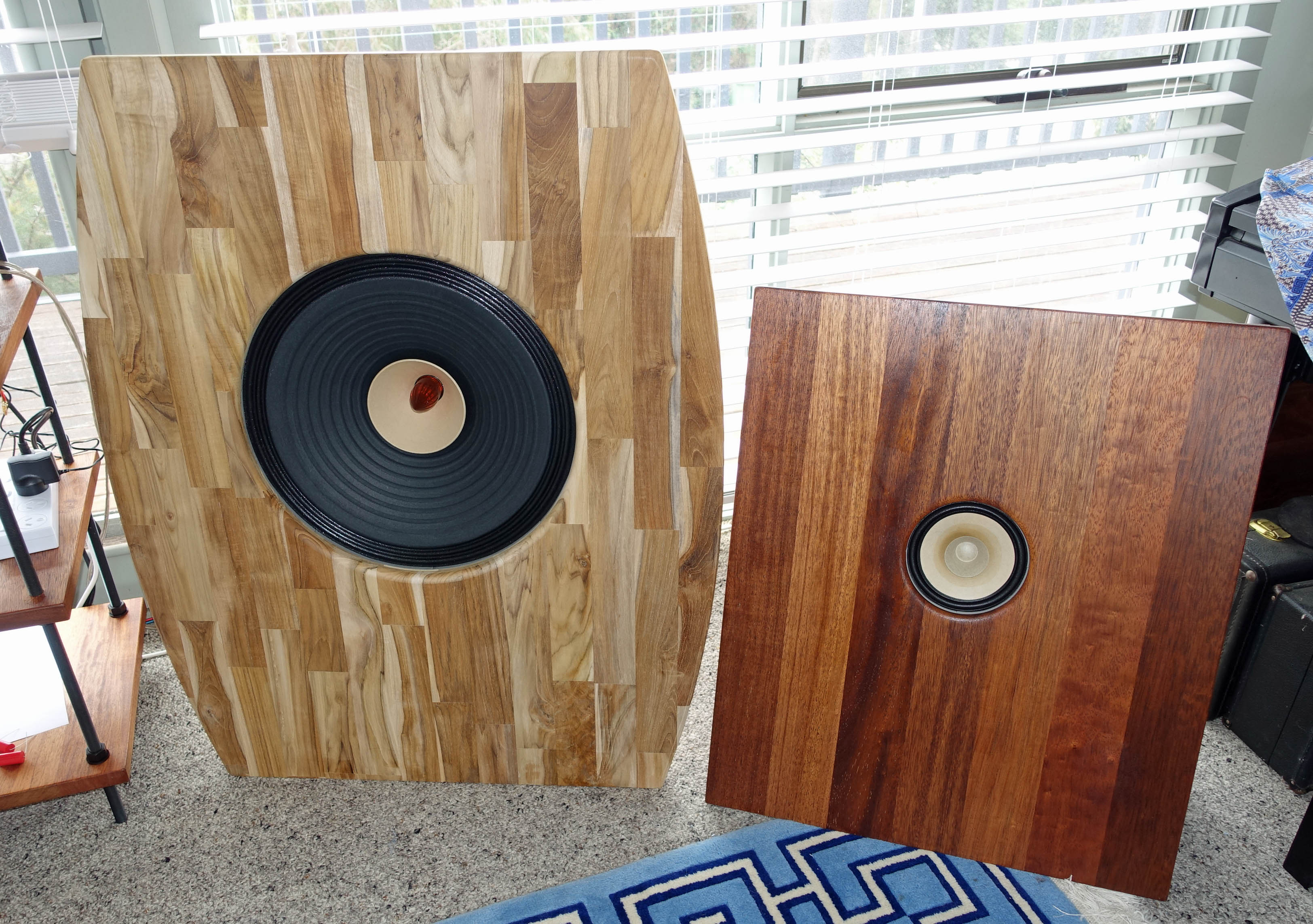

I have a DIY "Big Betsys" using the LiiAudio F-18 (which I like) but because that took a long time to ship, LiiAudio kindly sent me some discontinued F-6 drivers free of charge or shipping cost, which I placed in some nice solid baffles to practise my carpentry and for proof-of-concept. I happen to think they came out just magic. I now plan to use this timber for the Manzanitas and was wondering whether I could use these little FR drivers instead of the Vifa TC9s or TG9FD10-04s? How would I go about working out required changes to placement and the crossover? (apologies for noob question)
Is it OK to use this solid timber for the baffle - it's 26mm or 1" thick?

Those are some snazzy looking baffles! Yes you can use solid wood. Be sure to let the back side of the fullrange breath!
Yes, you can use other fullrange drivers, they will work. But of course you will have to tweak the crossover to suit the driver. The series resistor with controls the output level of mid/tweet will need adjusting (it often does anyway, to fit the room) to get a good level. If the impedance of the driver is not 8 ohms, that will also lead to a different resistor and a different high pass crossover cap. Lower impedance = larger value cap. The trap is almost certainly going to be different, too, as it's optimized for that specific Vifa.
That said, I've used many different fullrange drivers and two different tweeters in this configuration with success. But I have the benefit of measuring tools and a good working knowledge of crossovers. Those make it easy to quickly get good results.
Use what you can get, but be prepared to do crossover work.

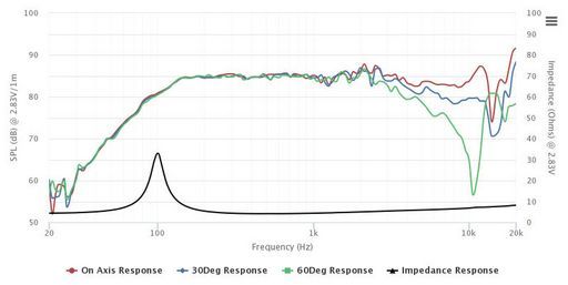

Scan Speak 10F/8424 is probably as good as it gets for a 3.5in full range. About 2dB more sensitive than TC9 so will need a little more padding.
10F/8414 is about $75 and probably almost as good.
Visaton B80 is also up there with 10F.

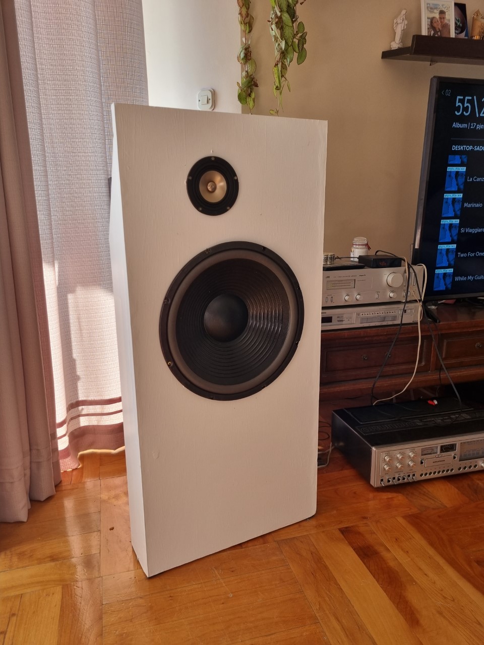

I've been experimenting with Markaudio Pluvia 7.2HD. I was not happy with tc9.. it was ok, linear, easy on ear but sounded little bit lifeless, lacked focus and detail. Im still lazy to measure the pluvias. So far I tuned the crossover by ear and by looking at simulation.. I disconected 4.7mh inductor because it was creating bump at 1khz, and changed 6.2uf to 11uf. These drivers dont sound as linear as vifas, but imaging, detail, focus is on another level.
how long have you been listening to tc9fd?I've been experimenting with Markaudio Pluvia 7.2HD. I was not happy with tc9.. it was ok, linear, easy on ear but sounded little bit lifeless, lacked focus and detail. Im still lazy to measure the pluvias. So far I tuned the crossover by ear and by looking at simulation.. I disconected 4.7mh inductor because it was creating bump at 1khz, and changed 6.2uf to 11uf. These drivers dont sound as linear as vifas, but imaging, detail, focus is on another level.
For about 2-3 months. They were playing pretty much non stop if you are reffering to break in. My manzanitas are connected to tv, media library and tuner.. there is always something going on 😄 dont get me wrong, its great sounding driver.. but pluvias are, at least to my ear, more musical and give out more information, despite slight coloration.
