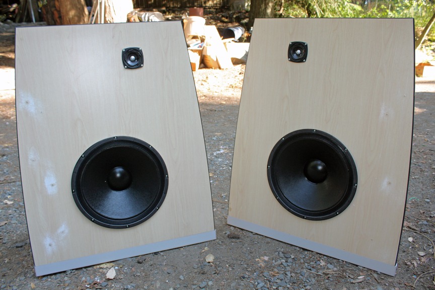

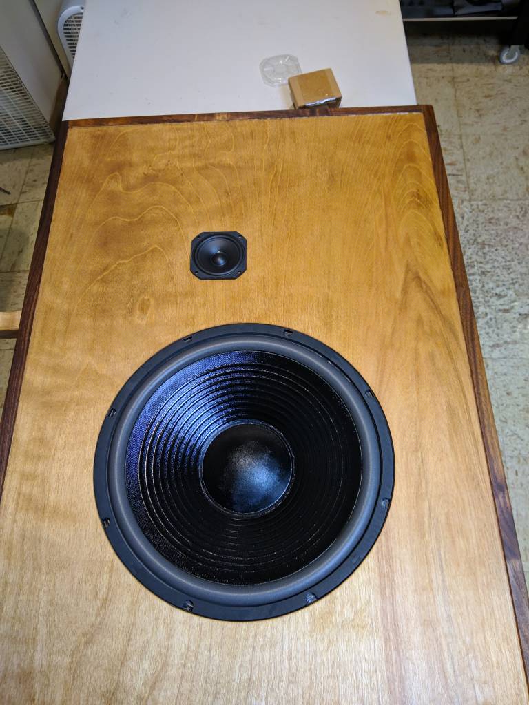

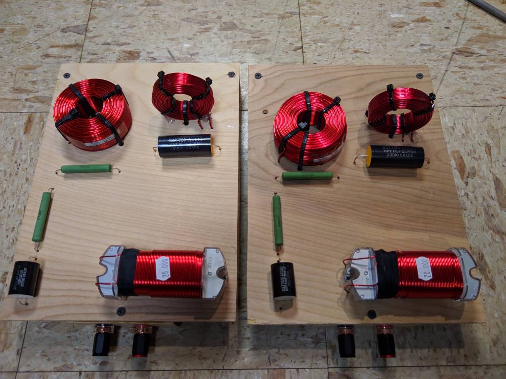

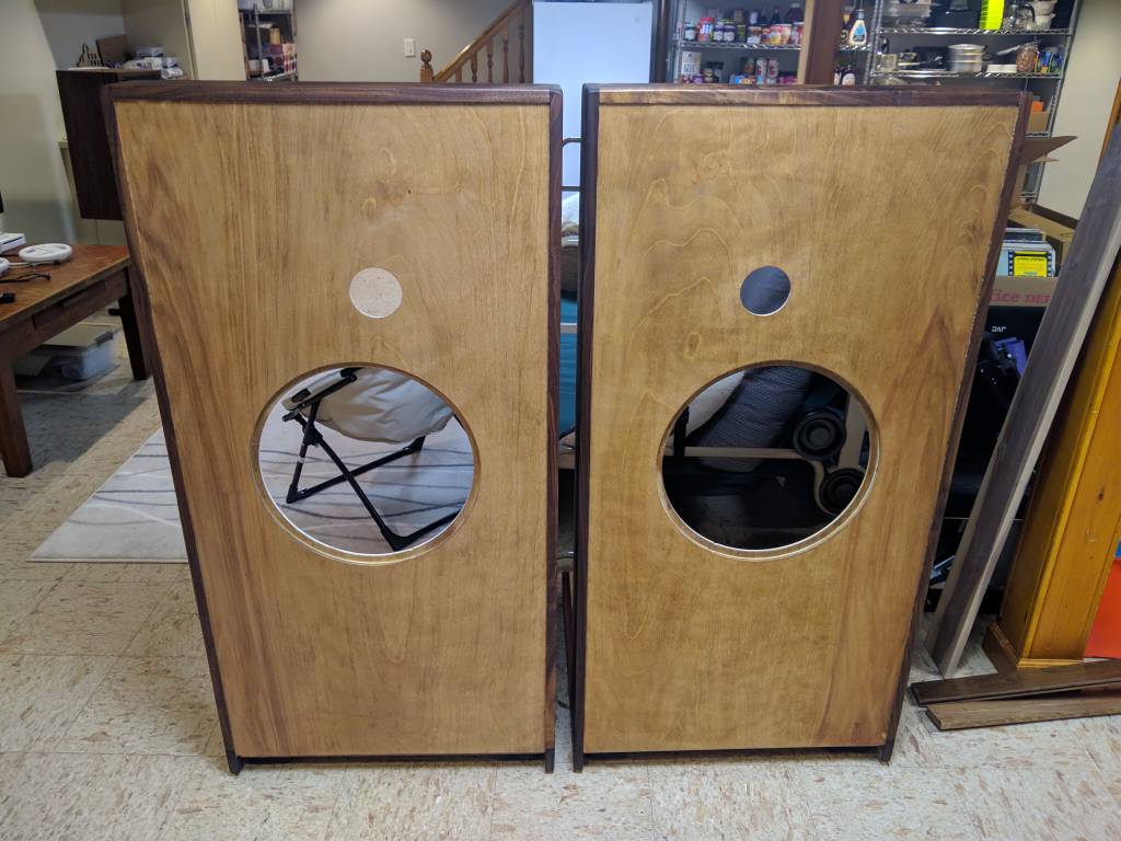

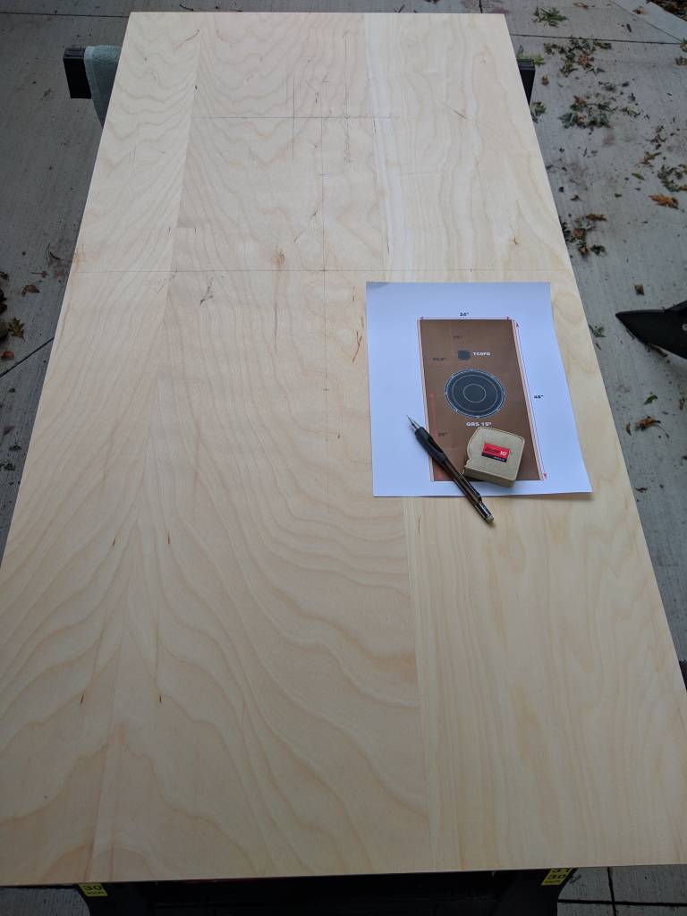

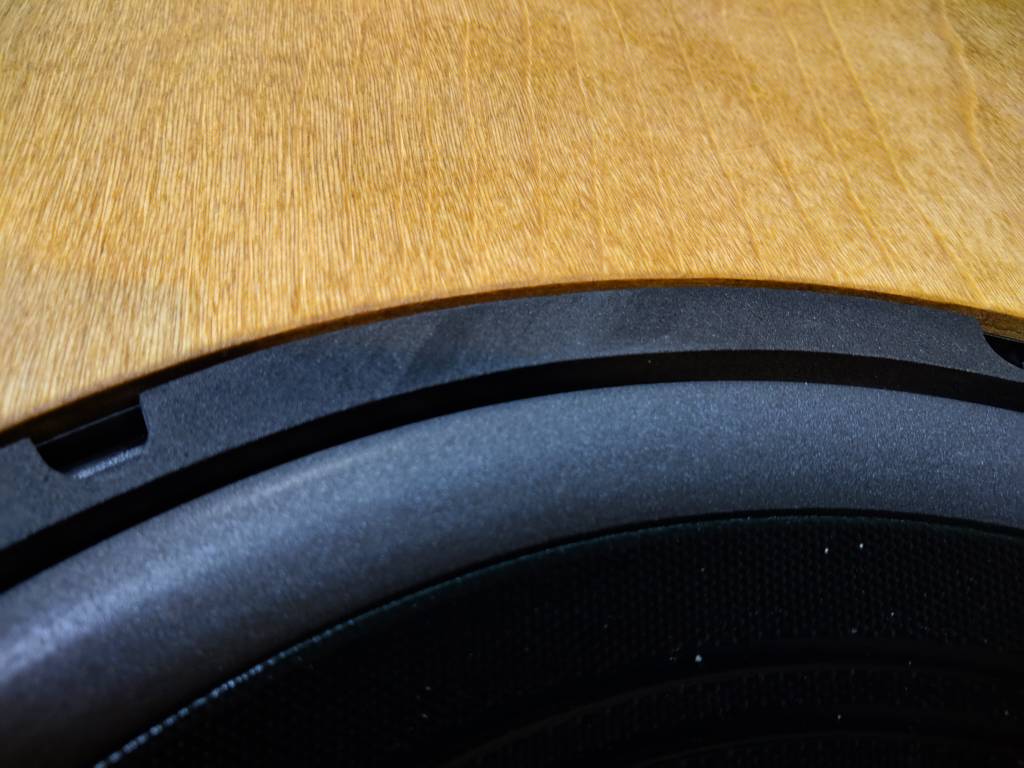

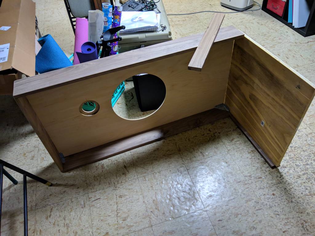

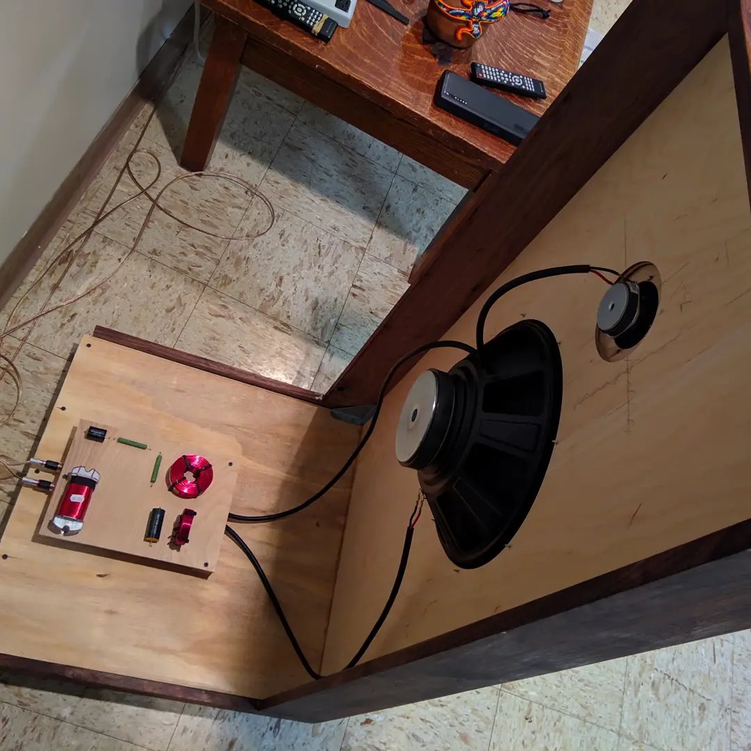

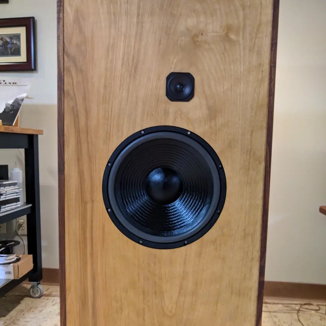

So, after lurking, reading, buying for, and finally building, I have my set of Vifa/GRS Ultras done. I still will probably play with the XOs a little, and maybe add deeper wings in the lower half, but they have exceeded my expectations!
I will also work in some resonance control, as I thing the baffles and even the woofer baskets ring... Have to work on placement, too.
Here are some pics for your enjoyment! Thanks to John, Pano, and all others that keep this thread alive!
Thanks for the pics! That a classic Manzanita build. Very clean and neat.
Let us know how you like them and how your crossover tweaking goes.
Thanks! I think my next thing is to flush mount those tweeters. I think I'm hearing some defraction, I guess I could try felt first, but flush would look better...Thanks for the pics! That a classic Manzanita build. Very clean and neat.
I'm also going to work on the room before any XO changes.
I'm addicted to the quality of bass! I had no idea...
