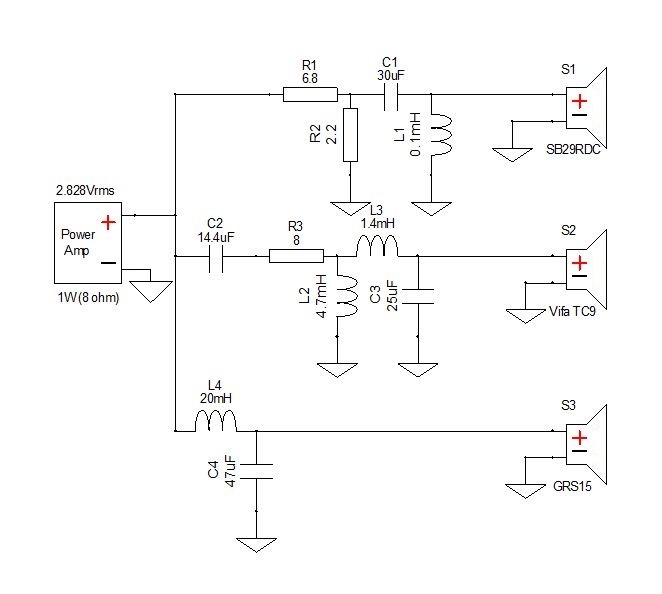

I wanted to share my new manzanita 3 way build..
I was taken by OB sound after I build manzanita ultra which was my first DIY build.
Although I enjoyed the sound there was part of me that wanted little bit more performance in the top end.
After playing with Mark Audio drivers (good presentation, but lot of coloration) I decided it was time to try a 3 way build.
I had pair of sb29rdc lying around so why not.. For most part I repurposed the manzanita crossover best I could, working around the few spare inductors, caps and resistors I had on my hands, hence the some weird choices.. Crossover points are around 300hz and 1800hz.
Letting the tc9 take care the midrange (instead of grs) completely transformed the sound signature.
Grs low end is still there, but midrange is much more dynamic and nuanced and speaker is sparkling with details.
Ambient feel of OB is still there, but now with wider soundstage and whole new dimension of imaging and detail.
Overall signature is silky smooth and gentle and works well with all genres, but for some reason I couldn't stop listening classical music..
Response was measured 1.5m from the speaker. <100hz bump flattens when you move speakers further from the rear wall.
btw vifa will get round plastic ring 😀
Thank you John and Pano for inspiration!

Corrcetion: c1 is 47uf and r4 is 10ohm

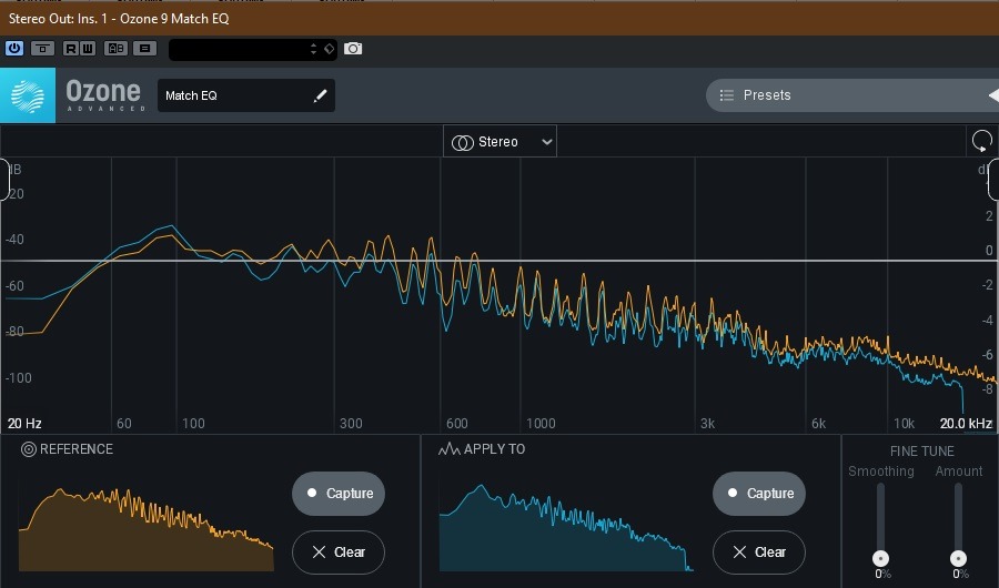

Turns out that classical music is speciality of this build.. symphonies, opera, grand piano, you name it 😀
Both vifa and sb29 are buttery smooth drivers and they do amazing job reproducing classical recordings.
First chance I have empty house I will record some heavy symphonic content.
At the mean time here is comparison of Kent Poon - One and Only Love I posted.
Orange is original recording, blue is room recording from 3m (10 feet) distance.
In room reproduction is almost identical to studio recording.
Also tweeter crossover has been updated to compensate for dipole 3db gain of bass and mid.

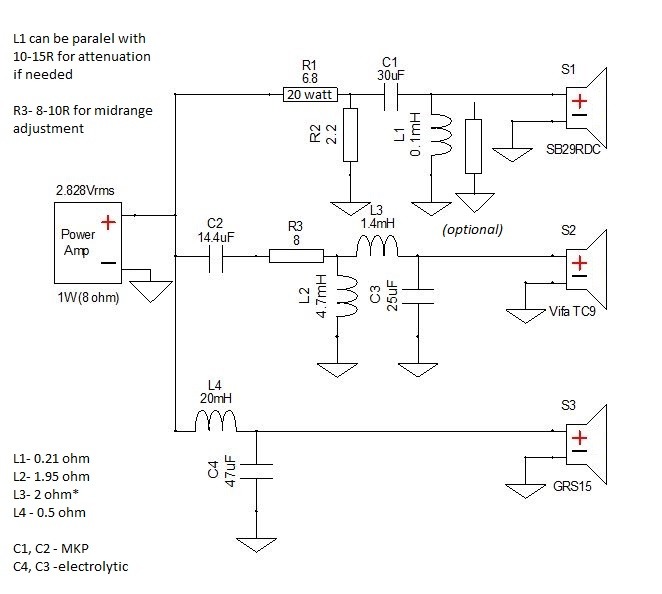

Hi Frane,
great result, I like it. I already collected the GRS15´s and the Vifa´s, but your build crosses my plans... as always here at DIYAudio 😀

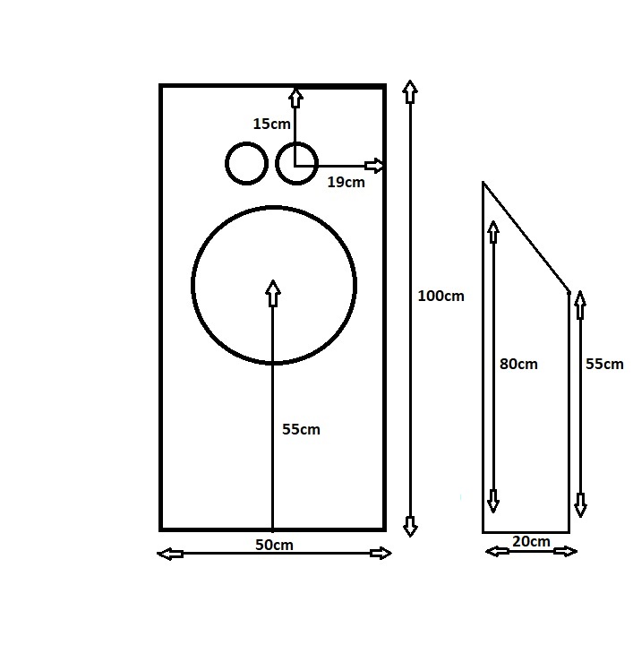

Could you please publish the size of the baffle and of the wings?
Many thanks!
Check previous page, there is drawing, impedance, phase etc. But use crossover from previous post.
If you are going to build this be sure to use 20watt 6.8 resistor. Tweeter level can be further adjusted with aditional resistor paralel to 0.1mh (previous page). You can buy 10R, 15R and see if you need it.. in my room it sounds best without attenuation (when speakers are 1m from the wall).. 1.5m from wall I like it better with 15R.. Also buy 8R and 10R for vifa ( midrange for your room), because I used 2ohm 1.4 inductor from old german speaker. Oh, and it is important to rout rear opening for tc9 otherwise it wont breathe back in the room, which is important for overall response. 47uf and 25uf can be bipolar elko, and the use MKP for the rest.
