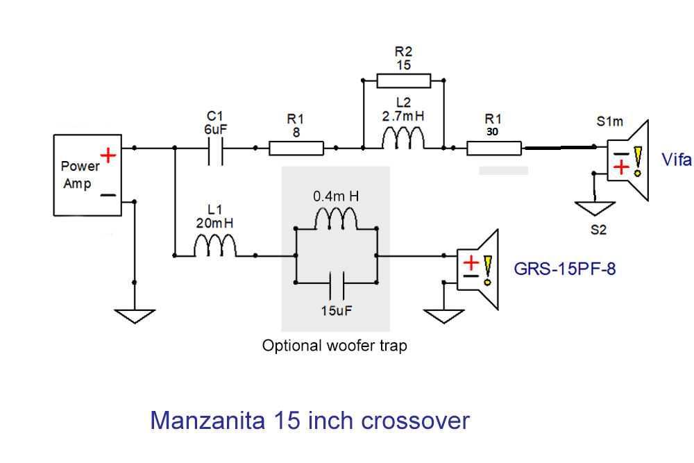

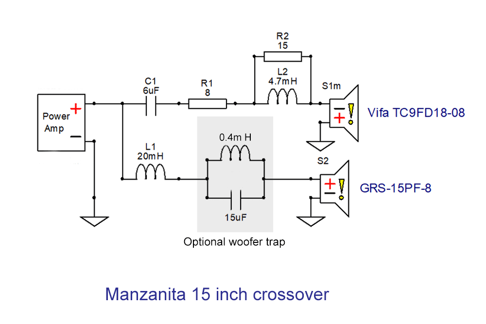

Folks I have come across a strange situation, I have found that the mids/high was a bit piercing for me when played at soft volume, but when played at high volume sounds great. So what I did I added some resistors, it sounds pretty good for me now at low volumes... However I have added a total of 30 ohms to the vifa tc9... Im wondering now if there is something wrong with my speakers...
Additional info: I have followed the recommended crossover with one exception, instead of the 4.7uF I have used 2.7uF instead.
Where are you using the 2.7uF cap? In series with the tweeter? Are you using the Vifa as your tweeter?
Sorry I made a typo, it is a 4.7mH inductor that was replaced with 2.7mH inductor, its in parallel with the 15ohm resistor , and I am using the vifa tc9https://www.diyaudio.com/community/attachments/15-inch-crossover-png.916244/Where are you using the 2.7uF cap? In series with the tweeter? Are you using the Vifa as your tweeter?
OK, that makes more sense. That inductor and resistor are used to shape the rising response of the Vifa and make it flatter. The resistor basically controls how much effect the inductor has, whereas the value of the inductor sets the frequency range of the correction. By using a smaller inductor you have moved up the frequency of correction. Using a higher value resistor makes the correction stronger.
I have not changed the 15ohm and the 8ohm resistors, that remains the same, after the 2.7mhinductor which is parallel with the 15ohm resistor, I have added 30 ohms.OK, that makes more sense. That inductor and resistor are used to shape the rising response of the Vifa and make it flatter. The resistor basically controls how much effect the inductor has, whereas the value of the inductor sets the frequency range of the correction. By using a smaller inductor you have moved up the frequency of correction. Using a higher value resistor makes the correction stronger.
