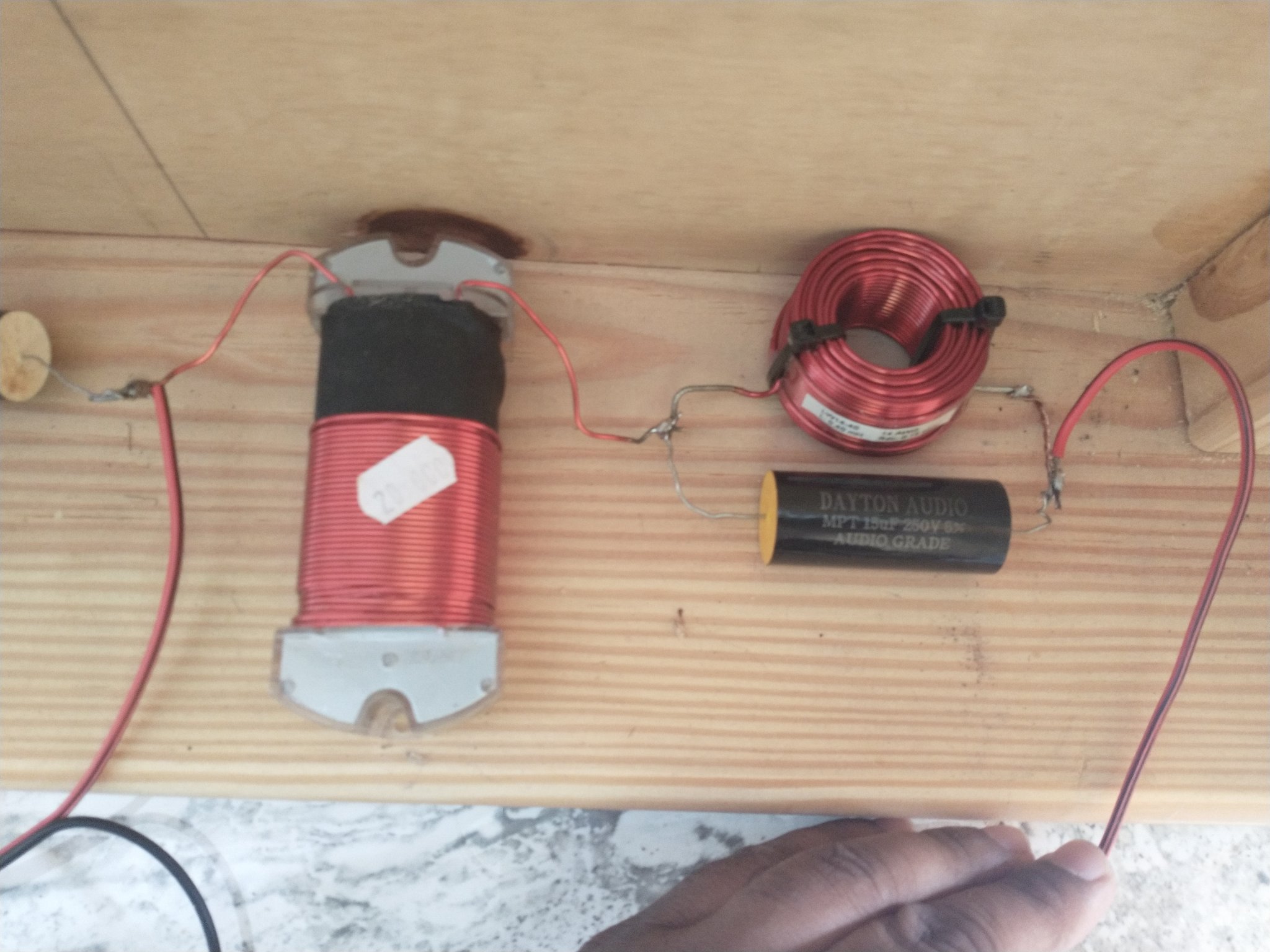

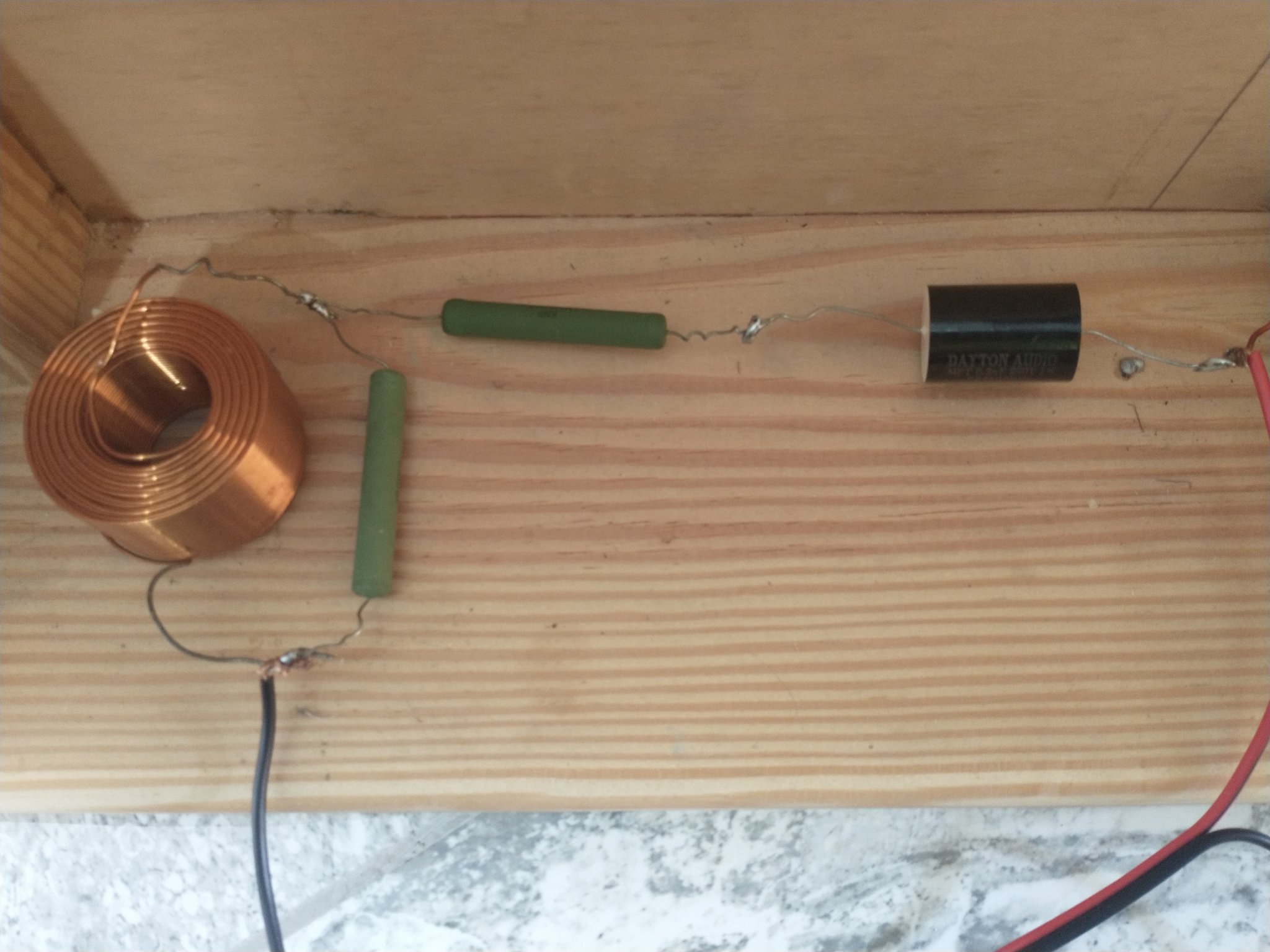

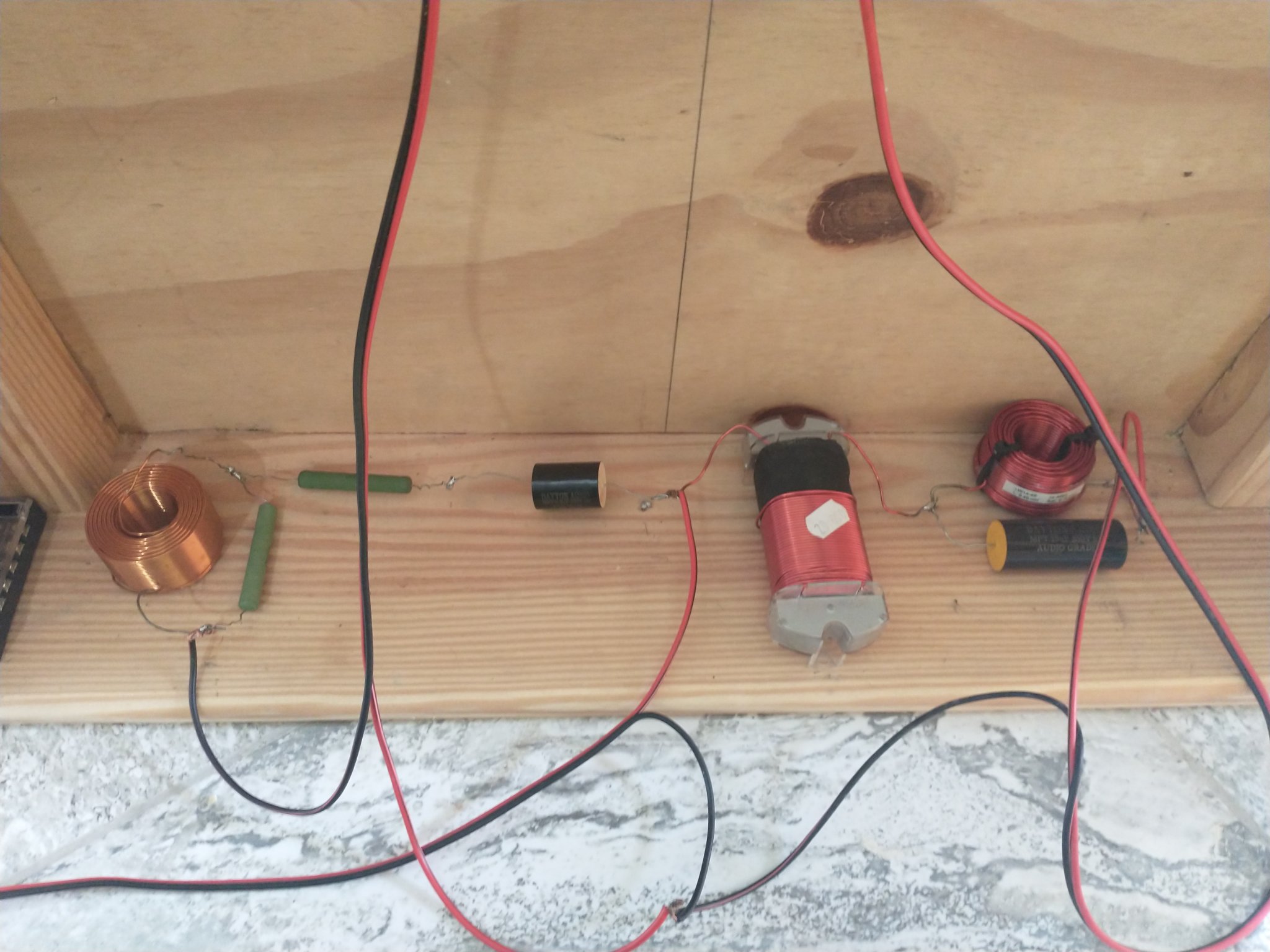

If you need 30 ohms there, something is very wrong. Can you draw out what you have - double check your wiring - so that we can see. Or if you can get a clear photo of your crossover layout, that might help.
I am listening again and it sounds better with the original setup... I think there is some other issue at play, I'm using a Harman kardon avr 335 which has some age, it could be that some caps need replacing.Oh, well that's radical! 🙂
Thanks for the photos, it looks very straightforward.
of course it's hard to know from here what the trouble might be, it could be your Vifa, or it could even be your room or the position of the speakers in the room. Open Baffle need to be well clear of the walls to sound their best.

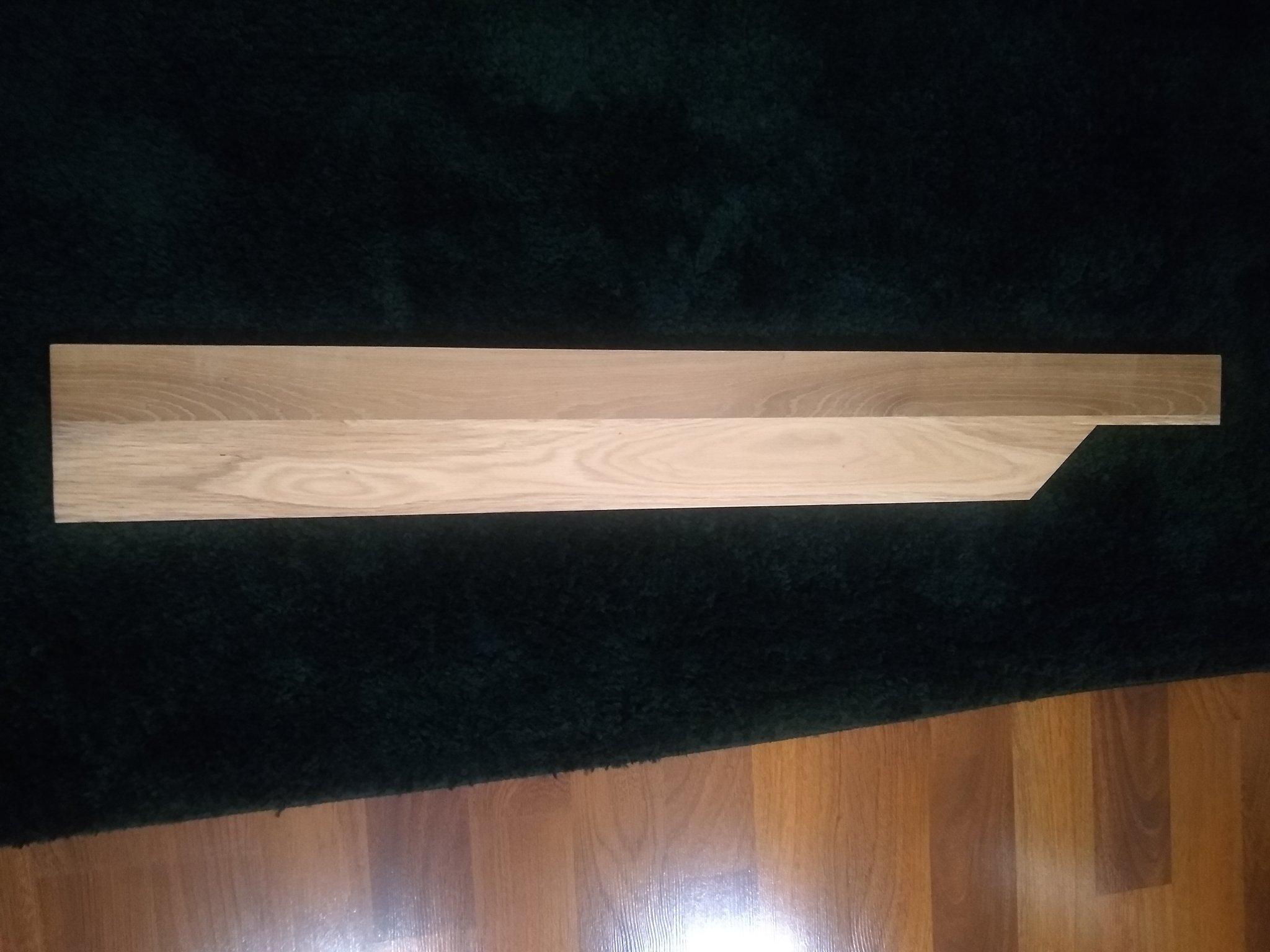

My wings are 5.9 inches wide. Front thickness is 0.75 inch. So the effective depth of the wings is 5.1 inches from the center of the Vifa. Then the depth decreases by more than half.
Are the wings too deep? I can still cut everything off - all elements are made of oak wood.
You should be OK at that depth.
The wings should be no more than 6 inches deep overall. This is not critical, but don't go too deep or cavity resonances will start to form.
