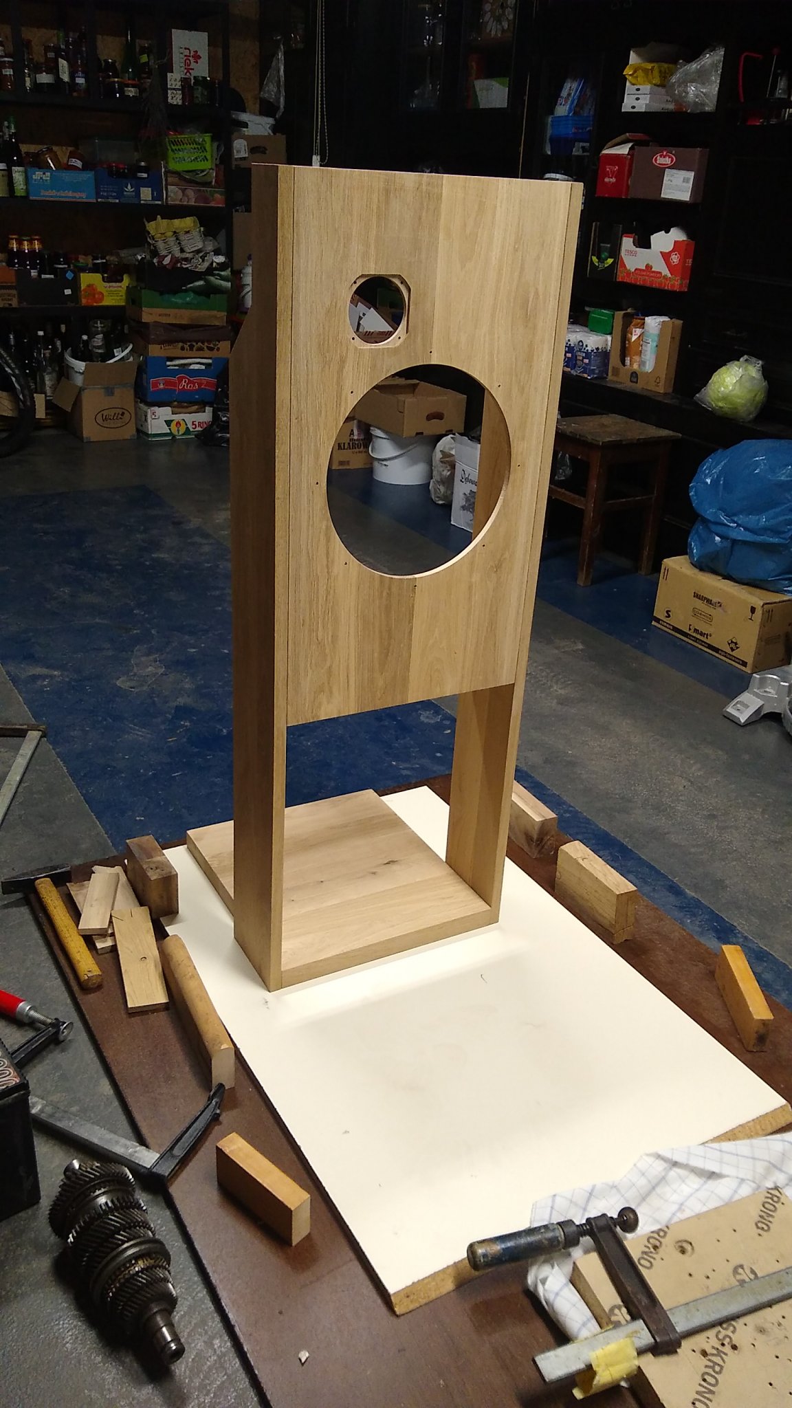

It has to do with floor bounce and baffle loading. Of course when I built the first one after John's - I asked the same question "Can't I just make it a floor standing speaker?" But John had tried it and knows it sounds more balanced with the gap between baffle and floor.
John will be able to explain this better, but he's offline for a little while. I'm sure he will chime in when he gets back.
https://www.rstaudio.de/en-gb/ripol-subwoofer-2/Good article on Ripol and disub designs
Would be great if John give some background information.It has to do with floor bounce and baffle loading. Of course when I built the first one after John's - I asked the same question "Can't I just make it a floor standing speaker?" But John had tried it and knows it sounds more balanced with the gap between baffle and floor.
I saw some designs where there was a slot / gap below or next to the woofer....maybe an openining of 1-2 inch is enough to make it sound right.
I was also thinking to move the full range to the middle, same distance to the woofer of course and open up one side next to the full range driver with same distance as the side to full range driver distance in the original design.
it's not a good idea ... if you want to copy the design, do it carefully and the result will be predictable 😃

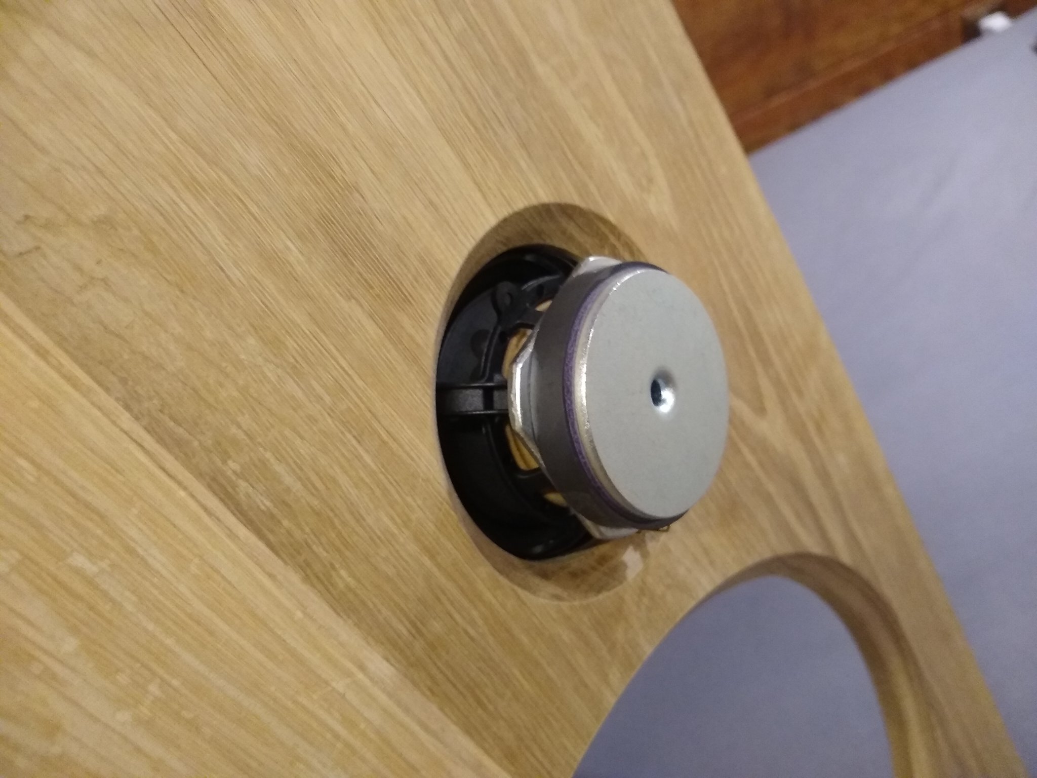

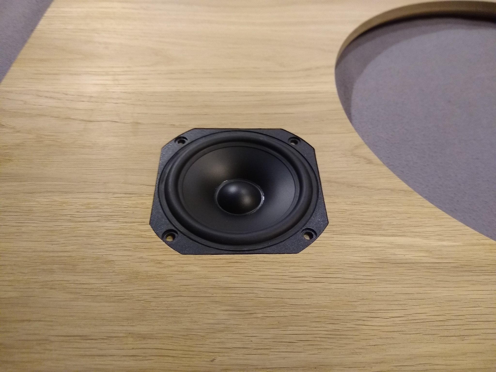

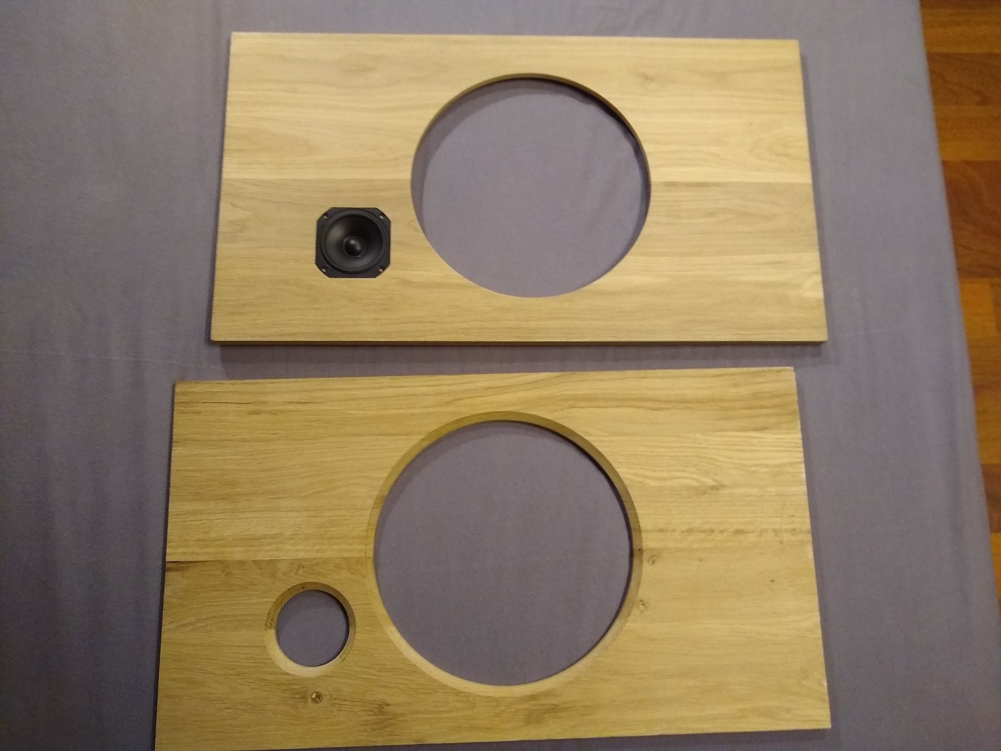

Below is the result of today's work:

Absolutely agree...but...
The fun of DIY is that you can make things the way you want it. You learn from commercial designs and other DIY designs trying to bring things together.
My questions are to the community not specific the designer. Of course the designers have a lot of knowledge and can give proper feedback. My questions are more related to the design I want (ascetic) related to the sound alteration they would bring. Maybe some have already experience in making a floorstanding baffle and took some measurements which can show the differences. Or know what influence a slot opening under the woofer will do.
So i dont need to reinvent the wheel here.
For me the outcome needs to be a floorstanding design. If it can not be closed then I need to think about a front cover grill.

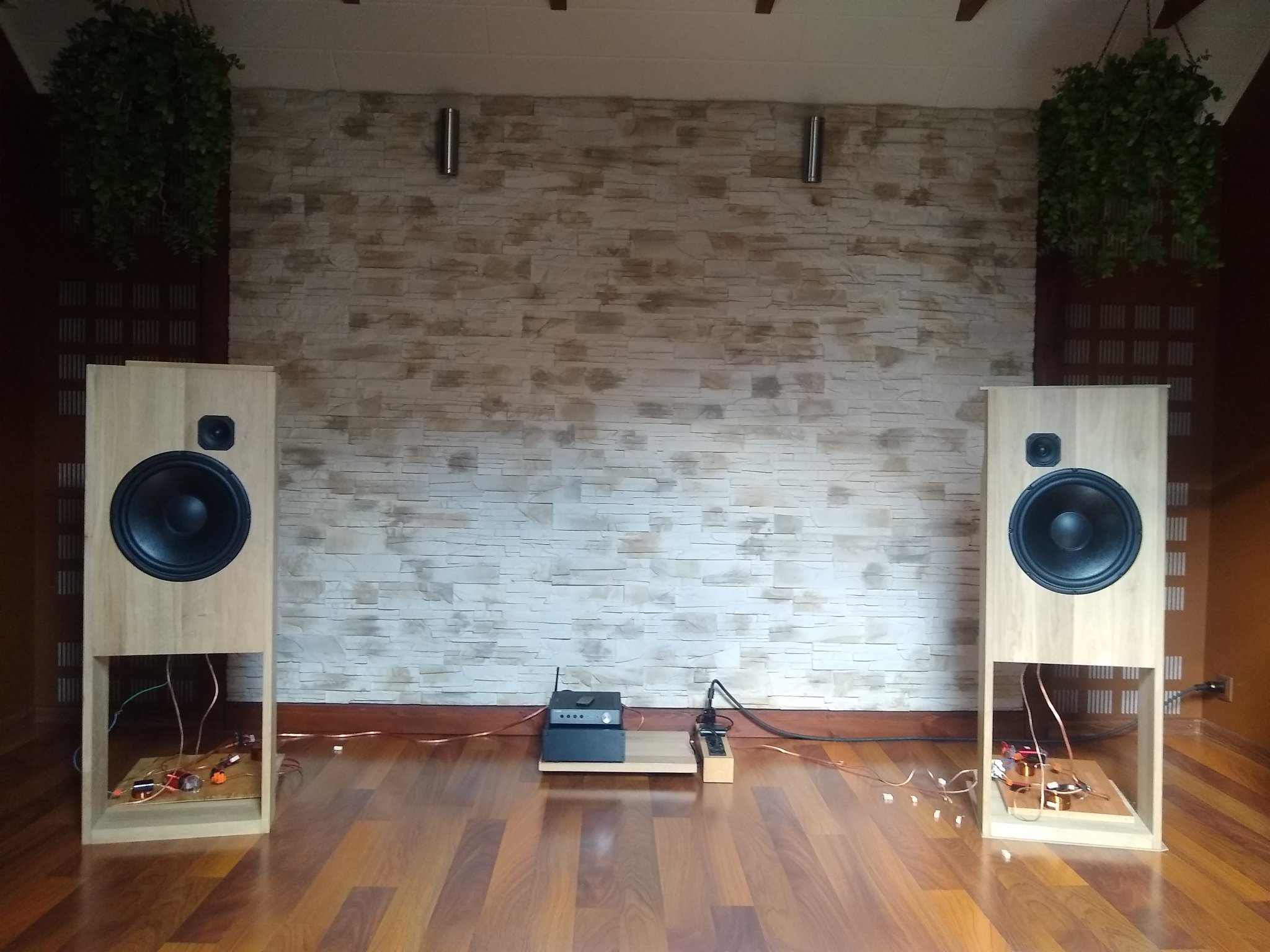

I'm starting tuning of the crossover...
The default value of R2 is 8ohm. Increasing to 12 or 15ohm decreases the amount of the highest tones? Hear it right?

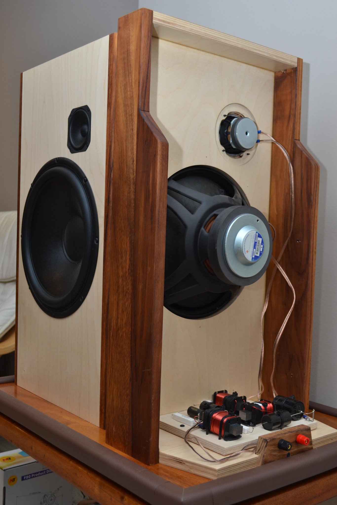

When playing, I also feel that the top of the board is shaking quite a lot. Is gluing the upper beam between the sashes recommended? This will increase the path length of the sound wave emitted through the back of the VIFA. It's about the solution from the photo from another user.
if it would effect the sound, you can always put a beam like in the picture you post but turn the beam 90degrees so that the big part stick to the back of the baffle.I'm starting tuning of the crossover...

Give the drivers and components some time to settle in a bit before making crossover changes. It'll save some aggravation.
You can different us a top bar - and it will make the baffle and wings more rigid. Make it asymmetrical if you can to avoid cavity resonances. An overall taper or a bump in the middle is the typical way to do it. Perhaps large holes in the flat side, as is done in aircraft struts?
