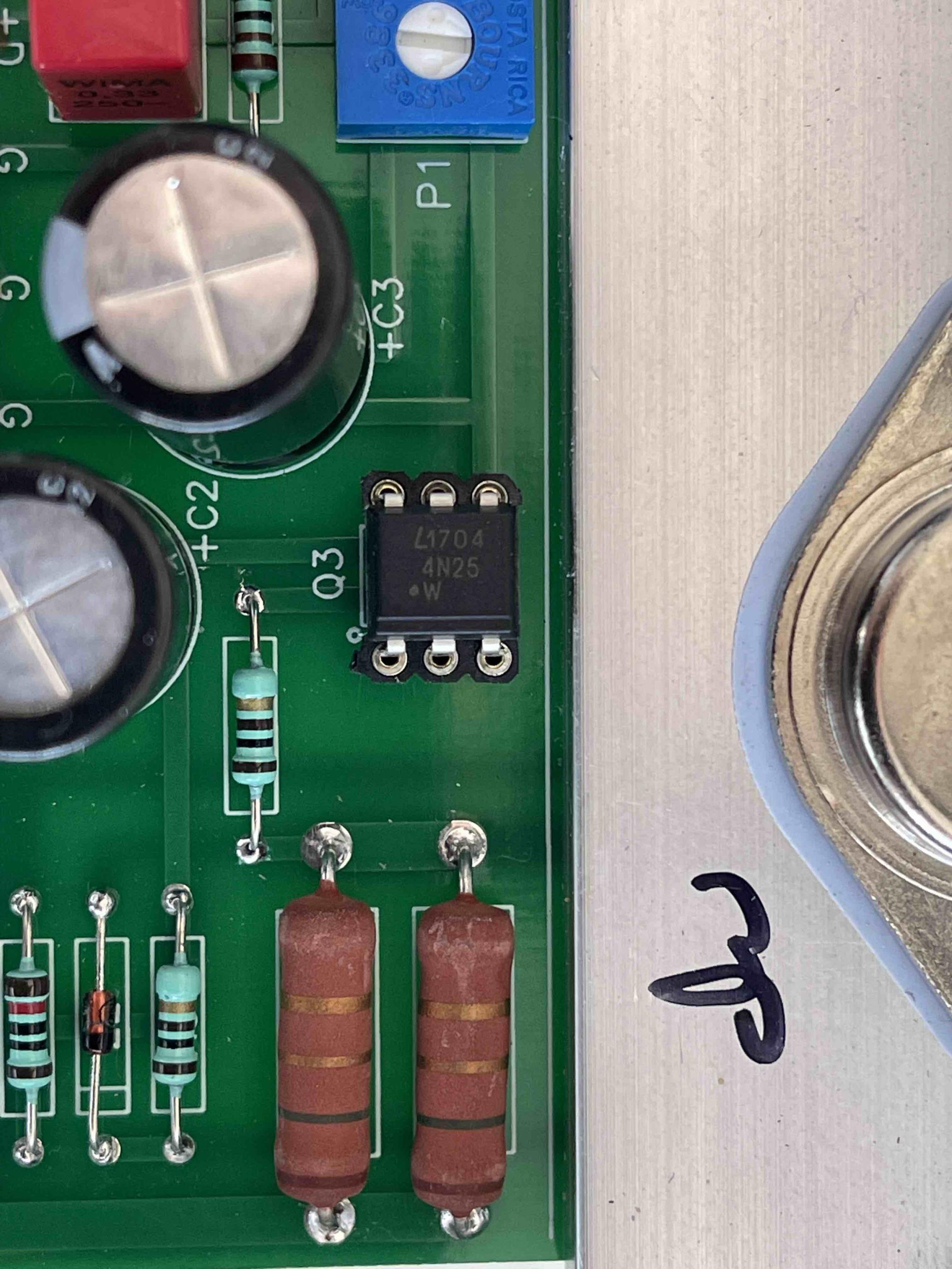

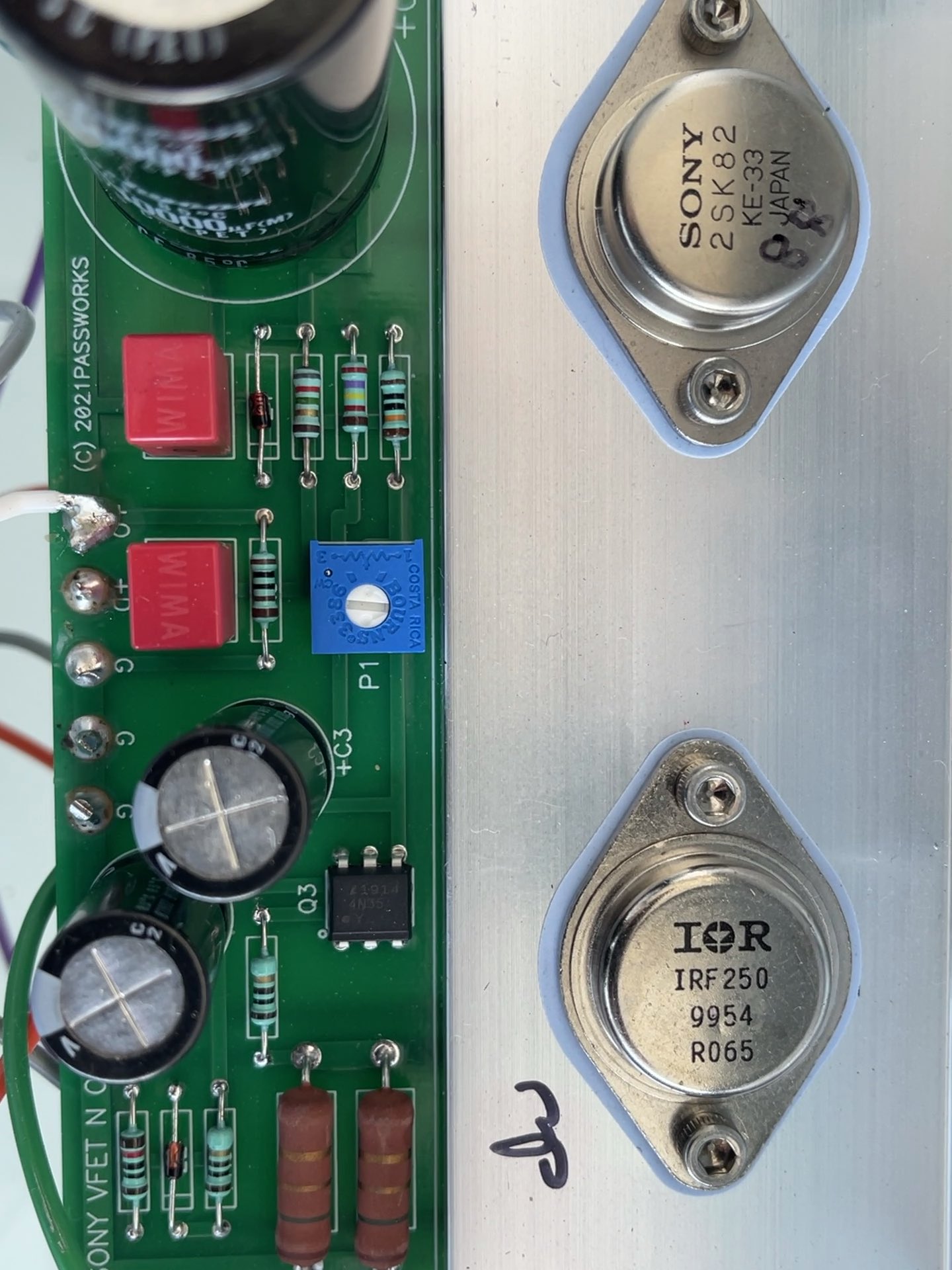

worth a try - replace 4N35, check resistors connected to it
if that isn't helping, remove mosfet and check it with simple matching jig
all in hope that VFet is ok, and fact that you can vary output node voltage is implying that, same as that biasing parts are OK

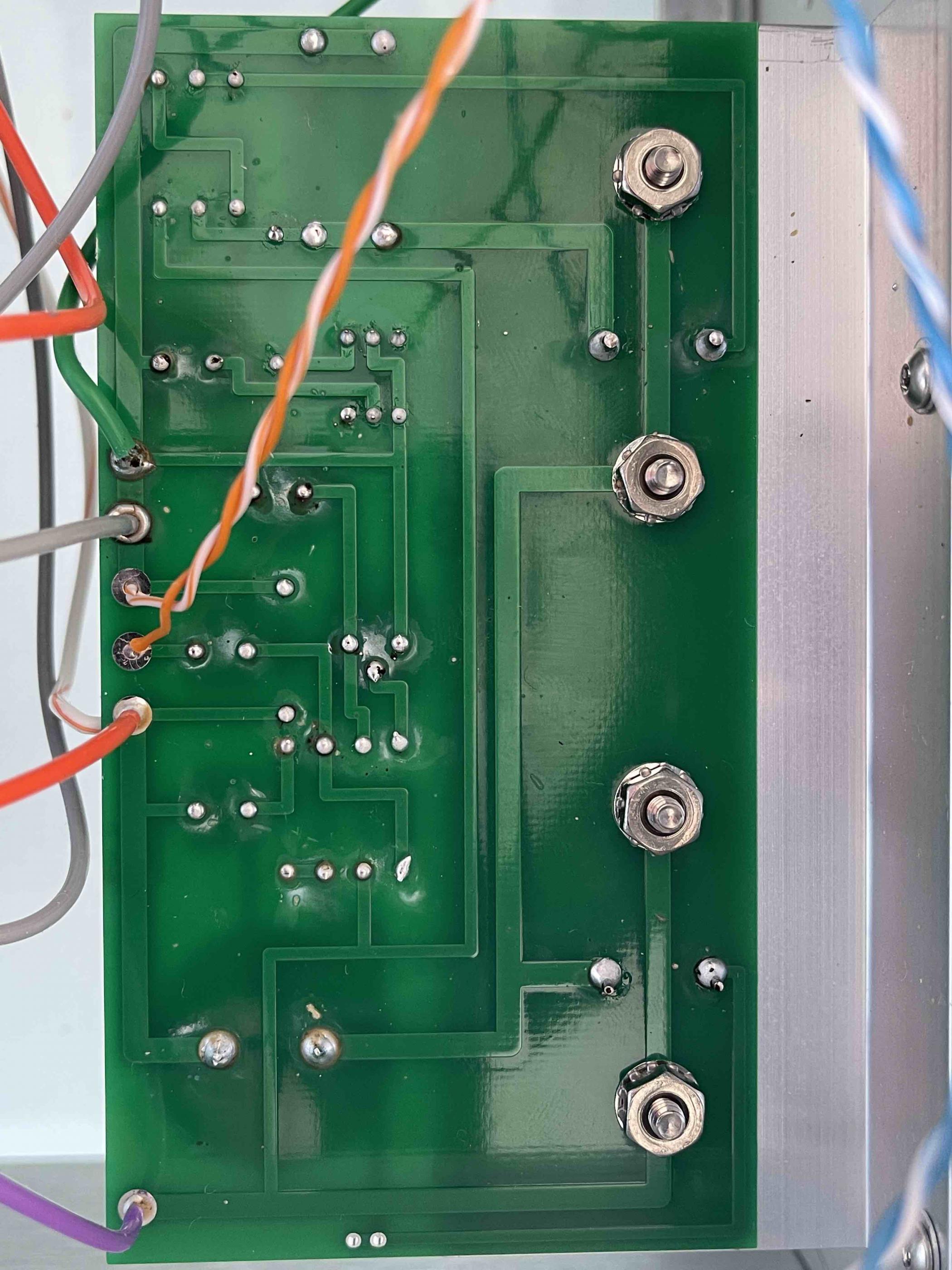

just to amuse us, post proper macro pic of Dodo channel pcb
Hi, I've replaced the optocoupler and socketed it. No change in measurements or performance. Next to change the MOSFET but they're hard to get so will take a few days.
pics
pics
mosfet - test it first
or place any of IRFP N channel you have around, just slab it somewhere on heatsink with any insulation pad and connect with wires to pads
IRFP150, IRFP 240 will do the job
edit: you can revisit some of these solder joints (trimpot)
especially gray wire from beneath looking fishy, even if from upper side it looks fine; certainly is just ugly but still functional ..... but avoiding ugly in soldering is good practice - leading to higher level of reliability
