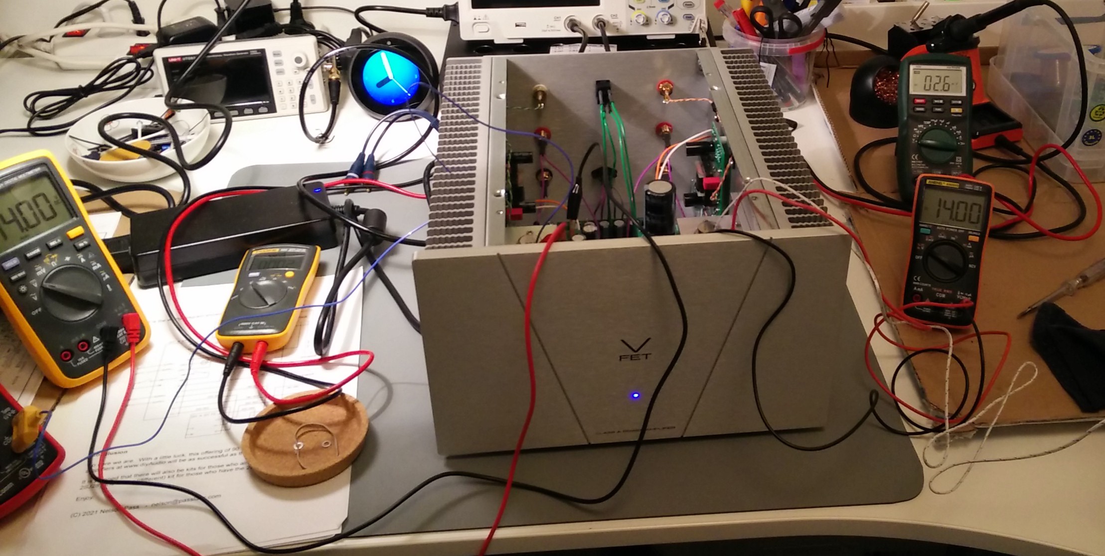

I'm so excited to get this amplifier together. My daughter and I are doing this as a daddy daughter project, it's her first kit and her first time soldering anything. We just got done stuffing and soldiering all the PCBs today after working on them little by little the past week. The next stage is assembling the case and mounting. What a cool project to be part of and I'm so thankful for Mr. Pass for bringing us this rare opportunity.
Since I know everyone here loves tinkering with things, I'm curious what little flourishes you guys have been adding to your own amps, if any. I'm building my just as it came to really enjoy what was designed first then we will see what ends up happening 🙂

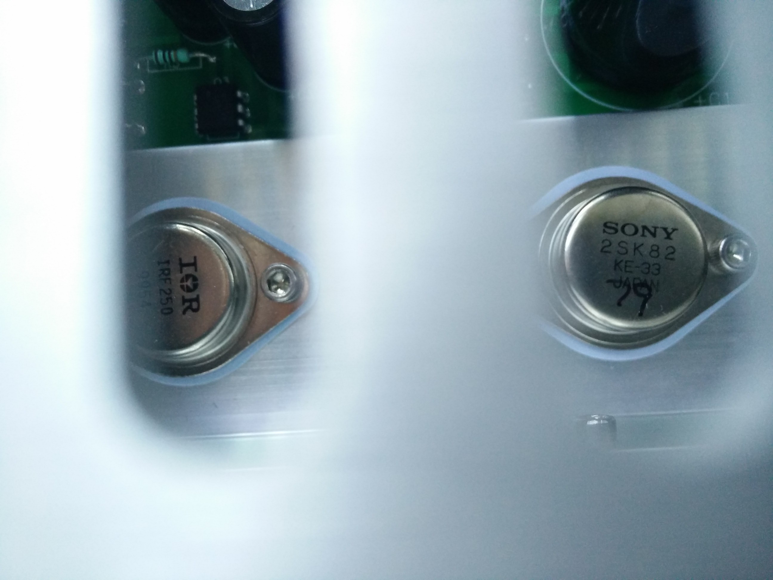

It is great to hear your daughter is involved in the build. My only advice is about the front panel. In the build guide for the P channel 6L6 installs it early in the build. I ignored this and left it for last. It was very difficult to get it installed last. My only change was to use a different socket head fastener to bolt the output stage to the heat sink. Allowed for a little more torque for better contact.

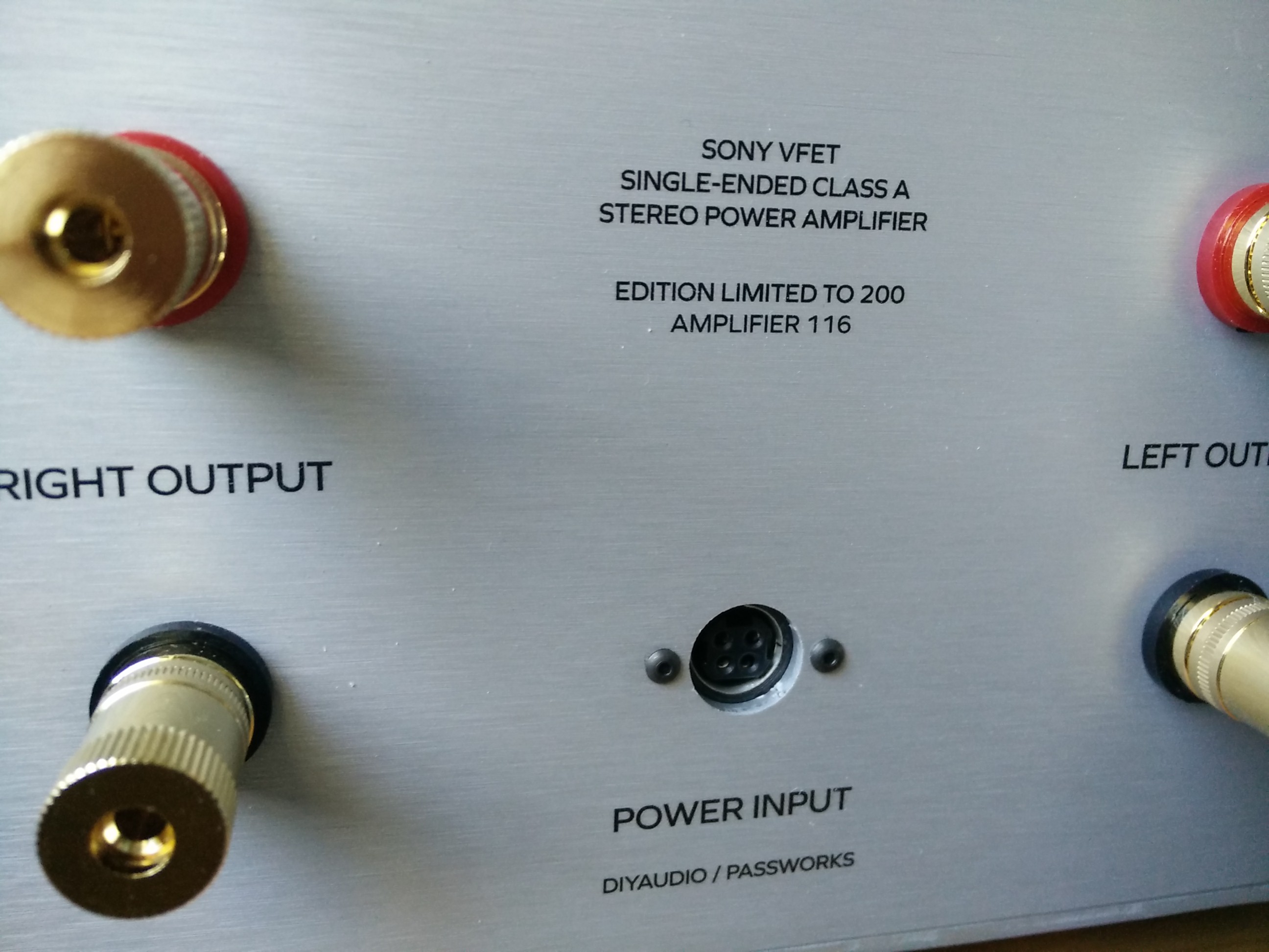

I am happy to report that #116 is alive! It was pure joy to put together such special kit. I feel so blessed 😱

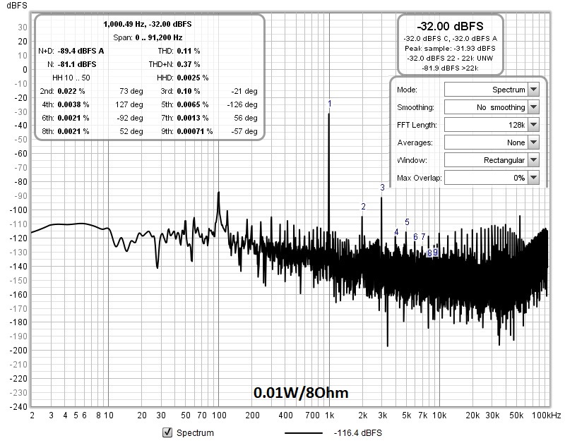

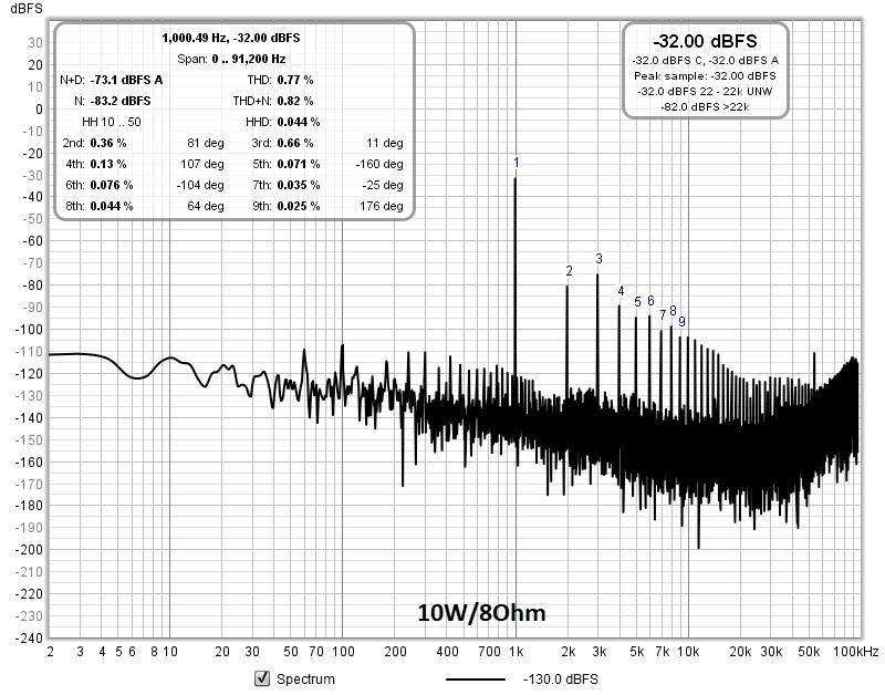

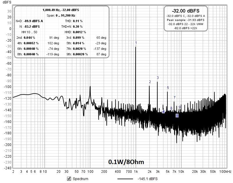

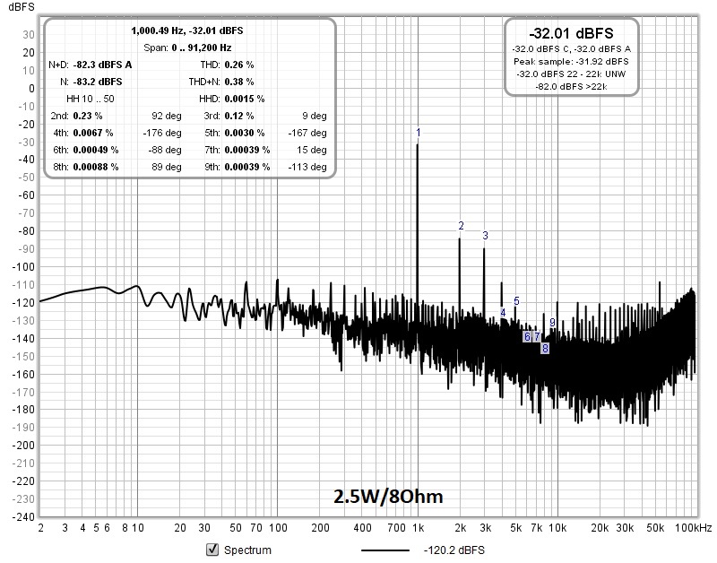

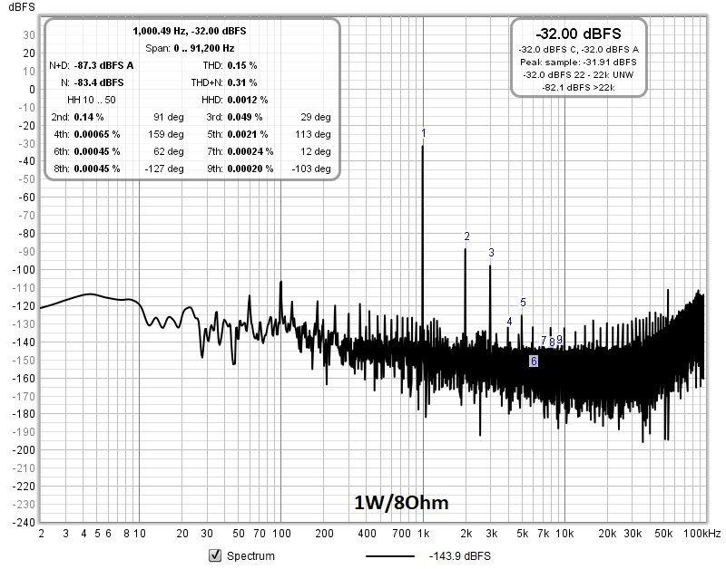

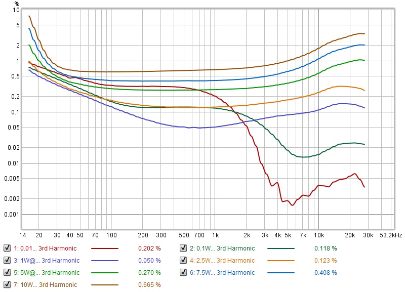

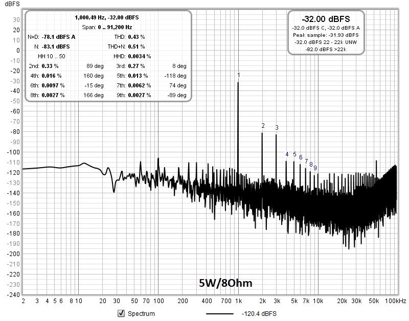

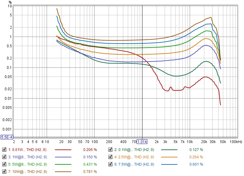

Some measurements showing the distortion profile of my build on 8 Ohm dummy load at discrete power levels ( 0.01W, 0.1W, 1W 2.5W, 5W, 7.5W, 10W)
