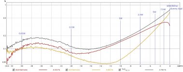

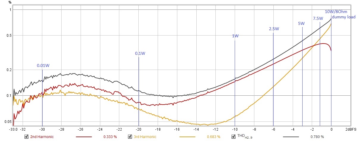

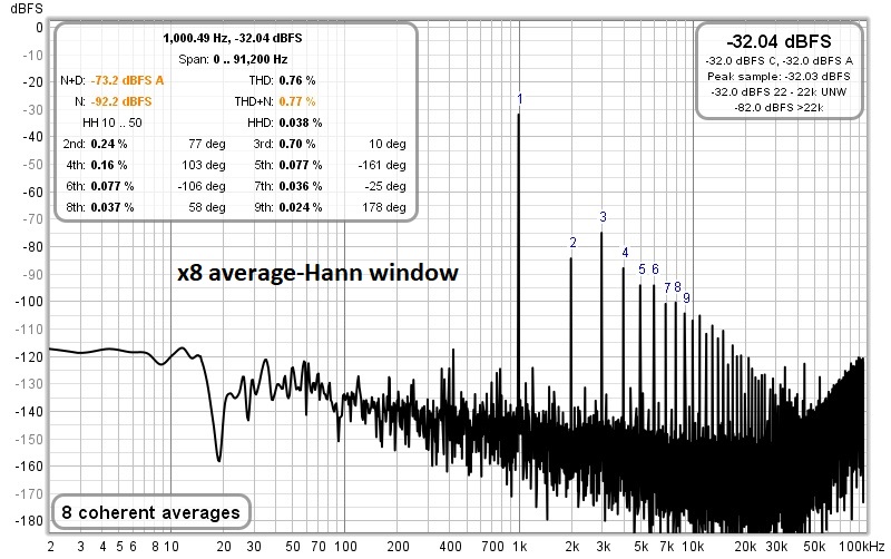

Some measurements showing the distortion profile of my build on 8 Ohm dummy load at discrete power levels ( 0.01W, 0.1W, 1W 2.5W, 5W, 7.5W, 10W)

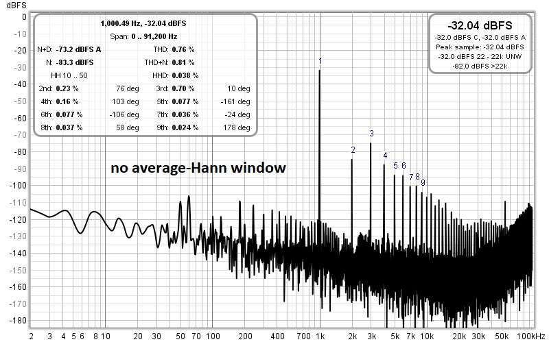

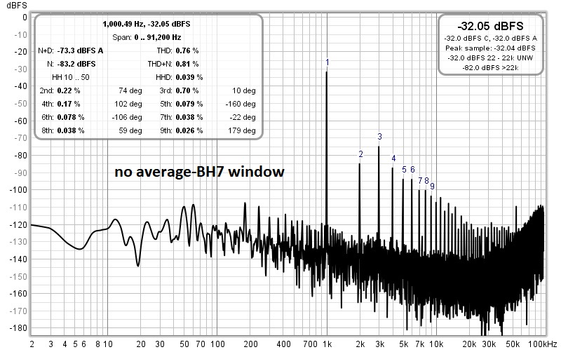

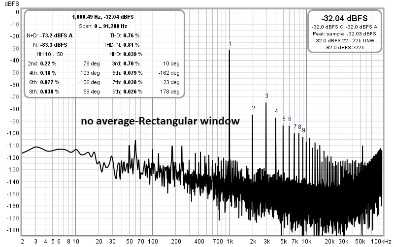

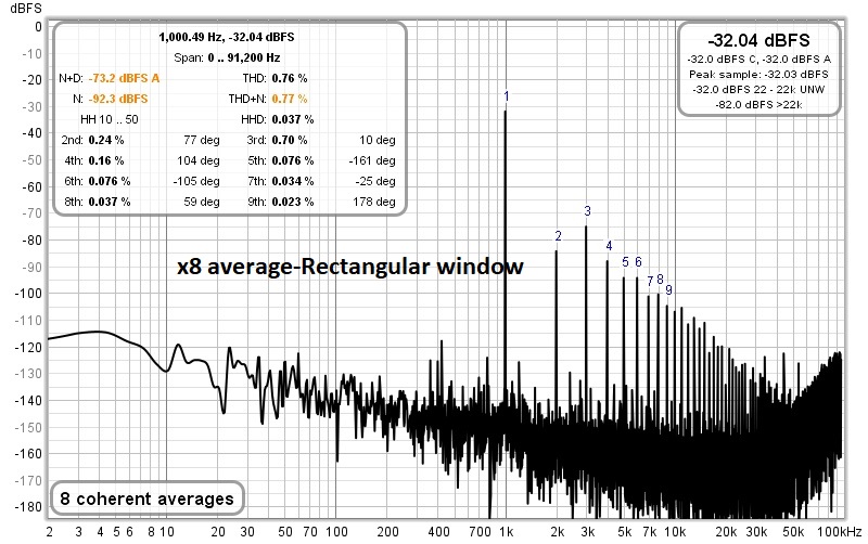

Hi JamesIn the interest of getting FFT measurements that are comparable to others, a Hamming or similar window could be applied, instead of Rectangular.
I don’t see any change in the looks of the FFT with windowing change. There is some improvement when applying averaging though, see attachments (all are 10W/8Ohm, 128k FFT length)
Distortion numbers remain the same in any case.

Nominal output (continuous) power is specified -at best- at 1% THD.10W/8ohm looks almost like a clipping amp?
At the 10W/8Ohm (nominal power for this amp) FFTs shown before, THD reads 0.76%, H2 0.22%, H3 0.7
Here is a -level increasing- distortion plot (REW RTA-stepped sine measurement, 0.1dB step, 997Hz signal, 256k FFT length, BH7 window, x2 average)
George
I am just wondering if anyone can explain which one could be the source of such 100 Hz peak with a SMPS PSU.
Full wave rectification of 50 Hz AC line in switching supply.

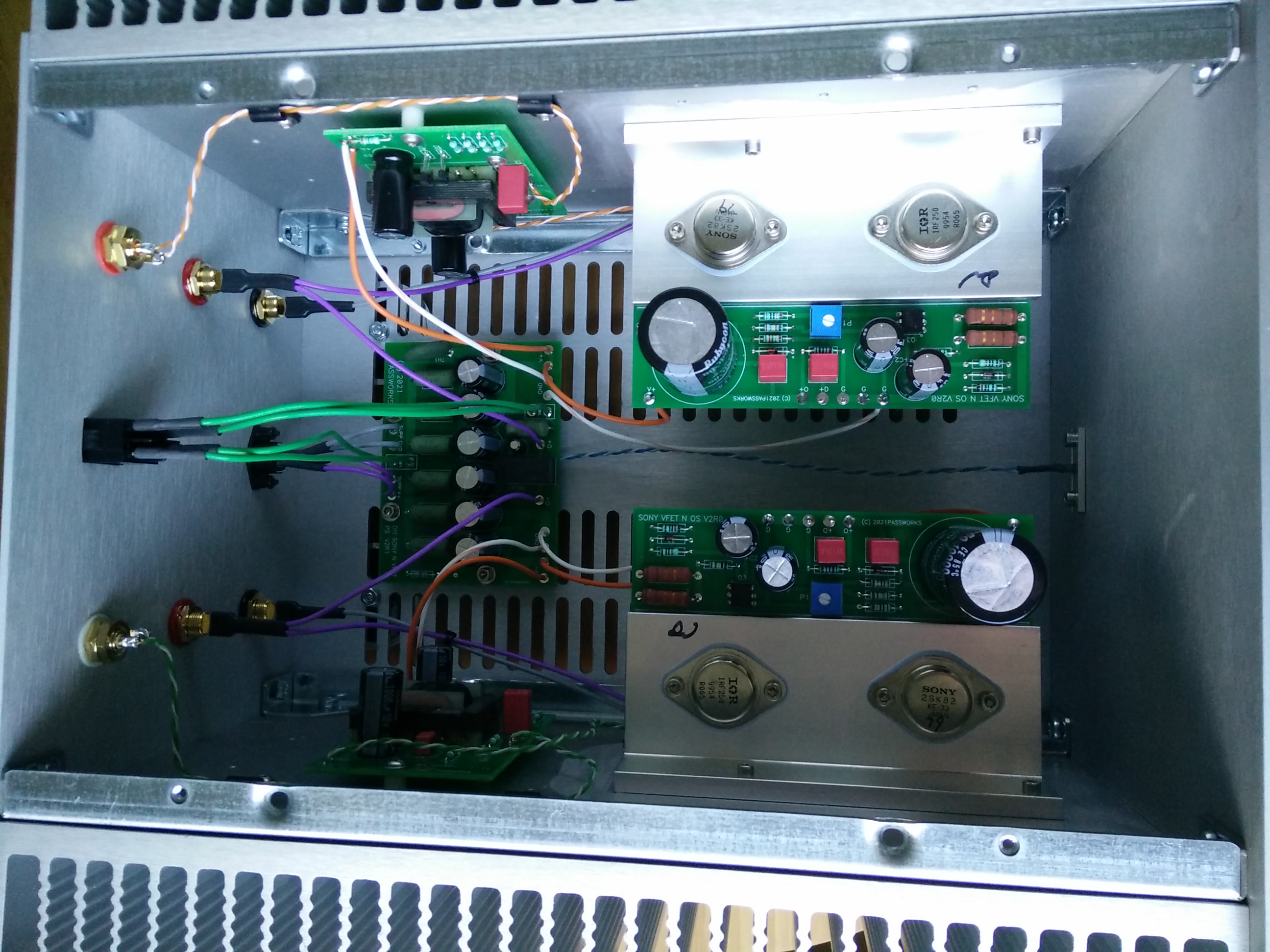

This is the dummy load I use.
For 8 Ohm, I parallel the two 16 Ohm sections.
Long continuous signal testing at 10W does not increase the temperature of the elements more than 2-3 degrees Celcius.
George
Hi George,
I have used these types of dummy loads and unfortunately, they add a lot of distortion. It’s something to do with all the inductance I think.
If you have some 3w metal thin film resistors, connect them as your dummy load at 2.83v (1W) and you will see a difference I believe.
