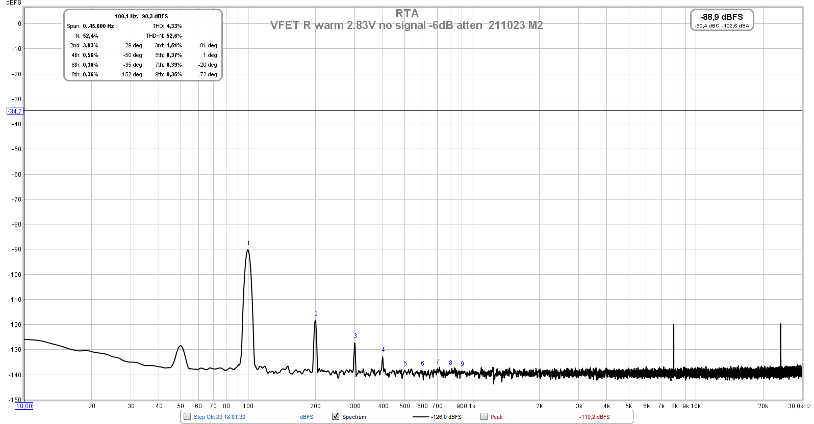

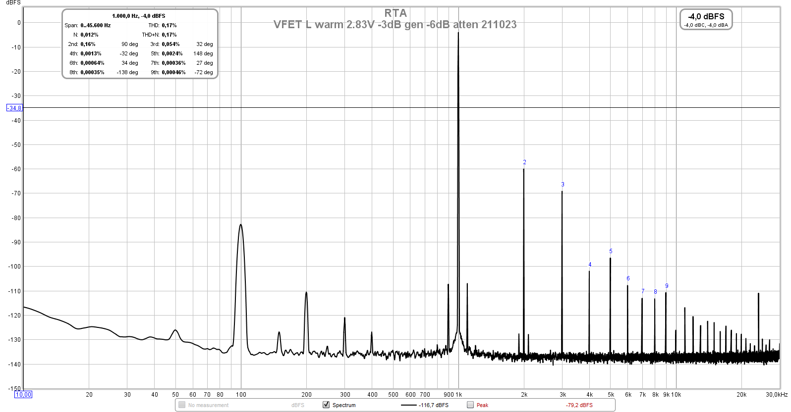

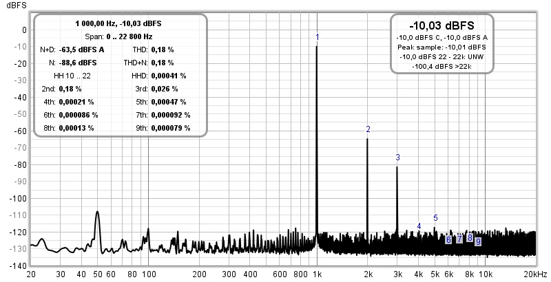

My measurements for the DIY Sony VFET N-Channel are very similar to yours, Peppe.
See below my REW measurements for 1W and 5W into 8 Ohms.
Nelson mentioned in his article that the N-Channel version is more susceptible to PSU ripple / noise than the first version (P-Channel), and that's why he put in the additional RC cell on the power supply filter. Well, we can see the effect of the higher susceptibility to PSU noise in our measurements 😀.
However, on my 100 dB/W sensitive speakers, I still only hear a faint hum from the amp,audible only within less than 30 cm of the speaker driver.
I will actually follow ClaudeG's example of adding a PO89ZB to each channel to see if this will do something not only to the HF noise, but to the 100 Hz ripple as well ... after all, each filter has about 900uF of capacity in it as well. Just waiting on my new run of filter PCBs with mounting holes to be delivered.
Best regards, Claas

Mains frequency in your country is 50Hz?
Correct.
And room lights (ikea dimmable led bulbs) off has no effect but good point. I had unplugged the desk lamp but left the room light on...
Thanks chede for the feedback. You confirmed it is not my measurements the problem. Nor it is the 100 Hz ripple (I can't hear it on my 90 dB speakers). 😎

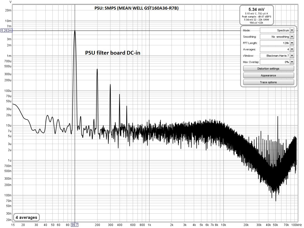

Some thinking on the N-VFET... A UNIT I DON'T OWN and I that's just "quickly" thinking out loud!
Looking quickly at the N-VFET schematic, and I mean quickly... hence I could be wrong...
My understanding is the filter provided by Papa is a first order filter with Fc roughly 50Hz, and that RC network has been doubled to provide, I guess (?), some channel separation as each RC seems to feed an OS board. Note that would be very different from my N-VFET.
The simplified theory says that filtering should be 9dB at 100Hz (-3dB and 6dB/octave filter) but we all know that it is too simplified as filters "need to get started" to get their slope coefficient. Make that a bit less, so not great.
What can be done to improve on the 100Hz filtering given the existing hardware?
One simple solution would be to connect the OS PS in such a way that both RC network feed a single PS line, forming effectively a RCRC filter network. Basicaly that would double the filtering while baring no real electrical risk as all is dimensioned for it. There are some negatives though:
- you double the voltage losses at the filter (2Rs), effectively losing up to 1.9V vs the original set up. Not sure this is an operational issue (?) unless seeking for absolute max power (which you shouldn't anyway wuth this unit IMHO), the bias may though need to be adjusted again
- you obviously lose the channel separation that was probably intended first hand (and wise Papa probably did it for a reason), meaning channel crosstalk could become a problem... but adding extra SMPS filters as I did may help on that regard
- you still don't get a great 100Hz filtering, but well, better than before obviously and the test is quickly performed to see the trend!

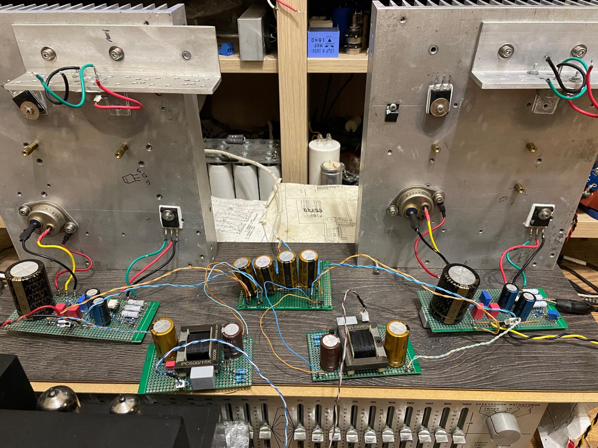

Something else to try...
Any one (or two) of the newer front end cards by Mark J. All have more extensive filtering of the power supply voltage. Two of them (Dreadnought & Marauder) go as far as regenerating a local supply using an on-board DC-DC converter to boost the supply voltage to 58V. These boards eliminate the Edcor transformer in favor of a higher gain circuit. The other two boards (Bulwark & Scourge) keep the Edcor as part of their gain structure, with the Bulwark allowing for more gain by adjusting a feedback resistor network. The Scourge is the simplest of the four to build, and I have been happy with the sound of mine as they are running in.
Any of these designs will noticeably improve stereo separation, and reduce any 100 Hz noise that is leaking from the kit SMPS brick. They each have variations in sonic character (small yet noticeable) and are fun to listen to.
It is also worth noting that all FE cards that use the Edcor have a Zobel network on the output which can be tweaked a little to improve the square wave response. I have used 330 pF polypropylene caps in place of the 220 pF ceramic with good results, and can recommend this mod to those willing to try it and see how it looks on the scope.

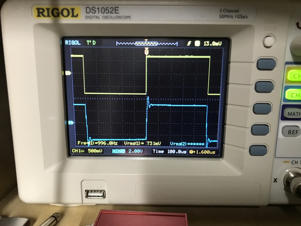

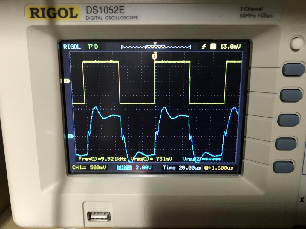

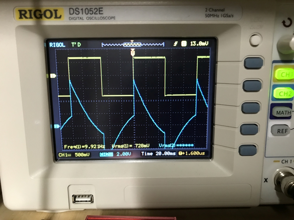

Chede, I was wondering if you are AC coupling your probes? I saw those slopes on the lower frequencies as well on the ACA while showcasing my new scope to my dad (who was an electronics engineer all his life).I'm also eager to try some of the new front end cards Mark Johnson has developed. As you can see below, the frequency response of the Sony DIY VFET has some "peculiarities" 😀…
Upon seeing those slopes he said: “it looks like you have a capacitor in the signal!”, I mentioned that this is what the AC coupling does and he mentioned that, even though we are measuring AC here, you don’t need it AC coupled to remove any DC, and it introduces those weird slopes on lower frequencies.
Maybe you are experiencing the same thing? It certainly removed those slopes once I DC coupled the scope probe.
If not, it may very well be the response at low frequencies, I haven’t yet connected my VFET to the scope.
Best,
Rafa.

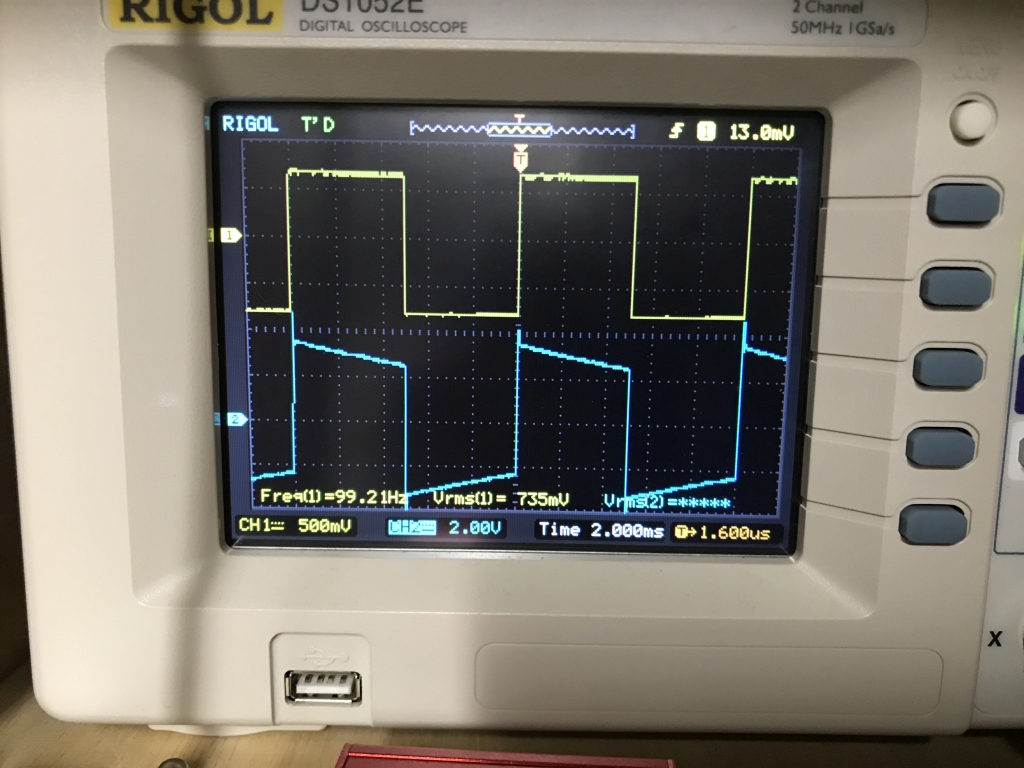

Hi Rafa, good point ! However, the channel on my scope is DC coupled.
I think what we're seeing here is just the bandwidth limiting of the whole VFET path (beginning to end). I get a lower -3 dB point of approx. 4.5 Hz, with a phase shift of 180 degrees.
In comparison, on my SissySIT with Cinemag transformers and only one coupling capacitor in the whole path, I get a lower -3dB point of approx. 2.7 Hz, with almost no phase shift.
Will try to separate out the contribution of the Front End resp. the Edcor to this, but have to wait on the PCBs I ordered, get parts, and build one of the alternative front-ends without transformer.
Regards, Claas
Regards, Claas

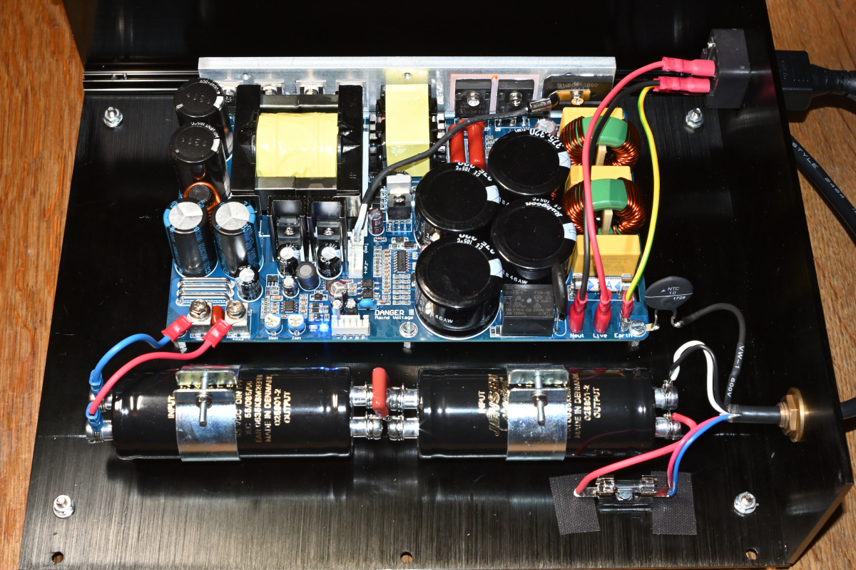

P channel here (so may be different)... standard brick SMPS that came with the kit... test performed before we tweaked the PS... on Klipsch LS that have advertised efficiency of 98dB/m/W (we all know it is a couple less due to the way Klipsch "measures" it) but still high efficiency
NO HUM OR NOISE WHATSOVER
and that is trying hard, ear directly on horn and volume way up (say 20dB over loud position with music), something I would never do in real life, neither the ear positioning nor the volume LOL
We thought Class D would be quiet... and it is usualy, especialy given all the tweaks we did on Gilles amp, it is nearly dead quiet... but well, my VFET is quieter!
If you hear a hum then IMHO there is defo something wrong womewhere. If it is measurement only and you hear nothing, then (I would say) one can't conclude atthat stage.
Claude

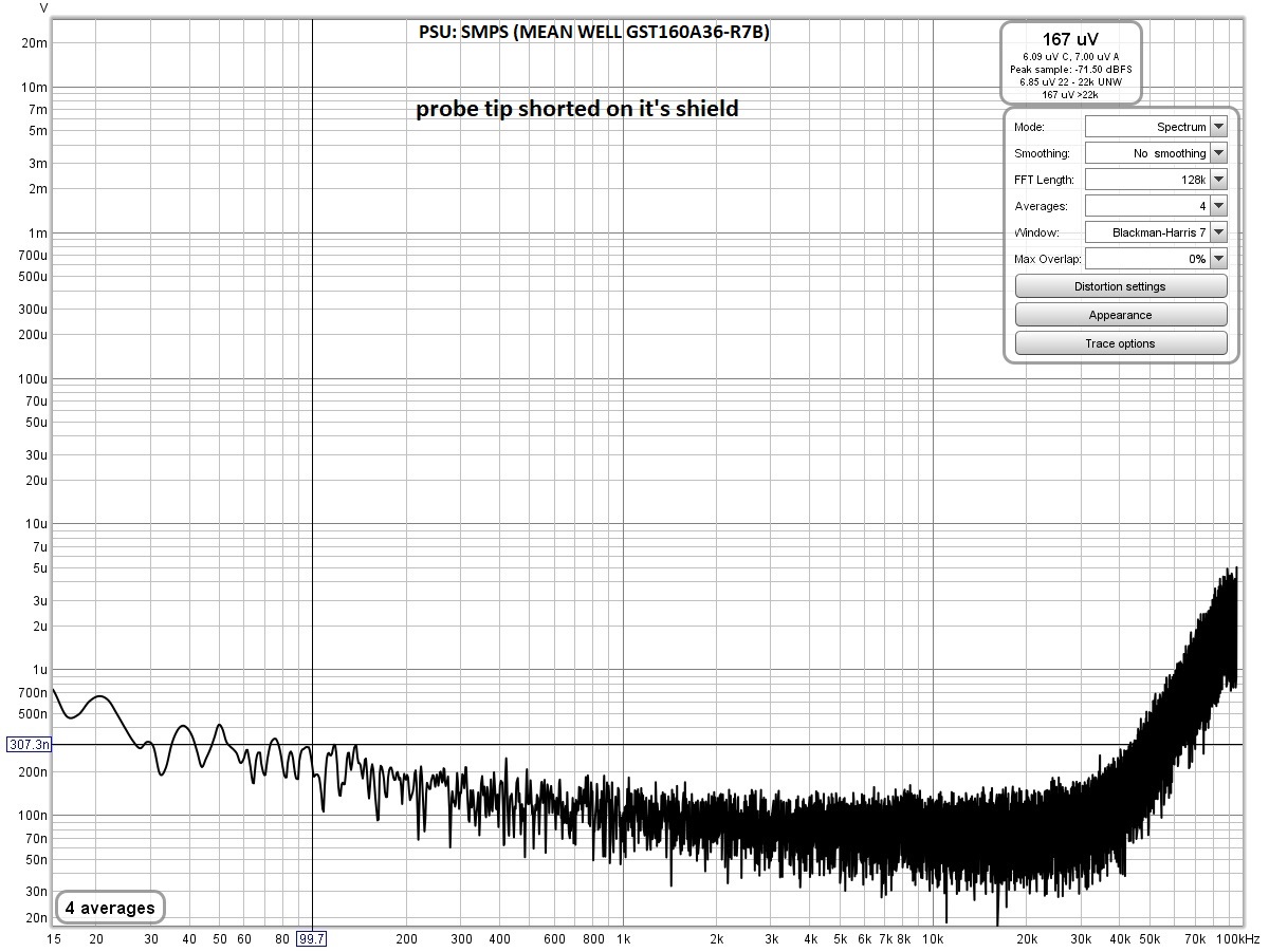

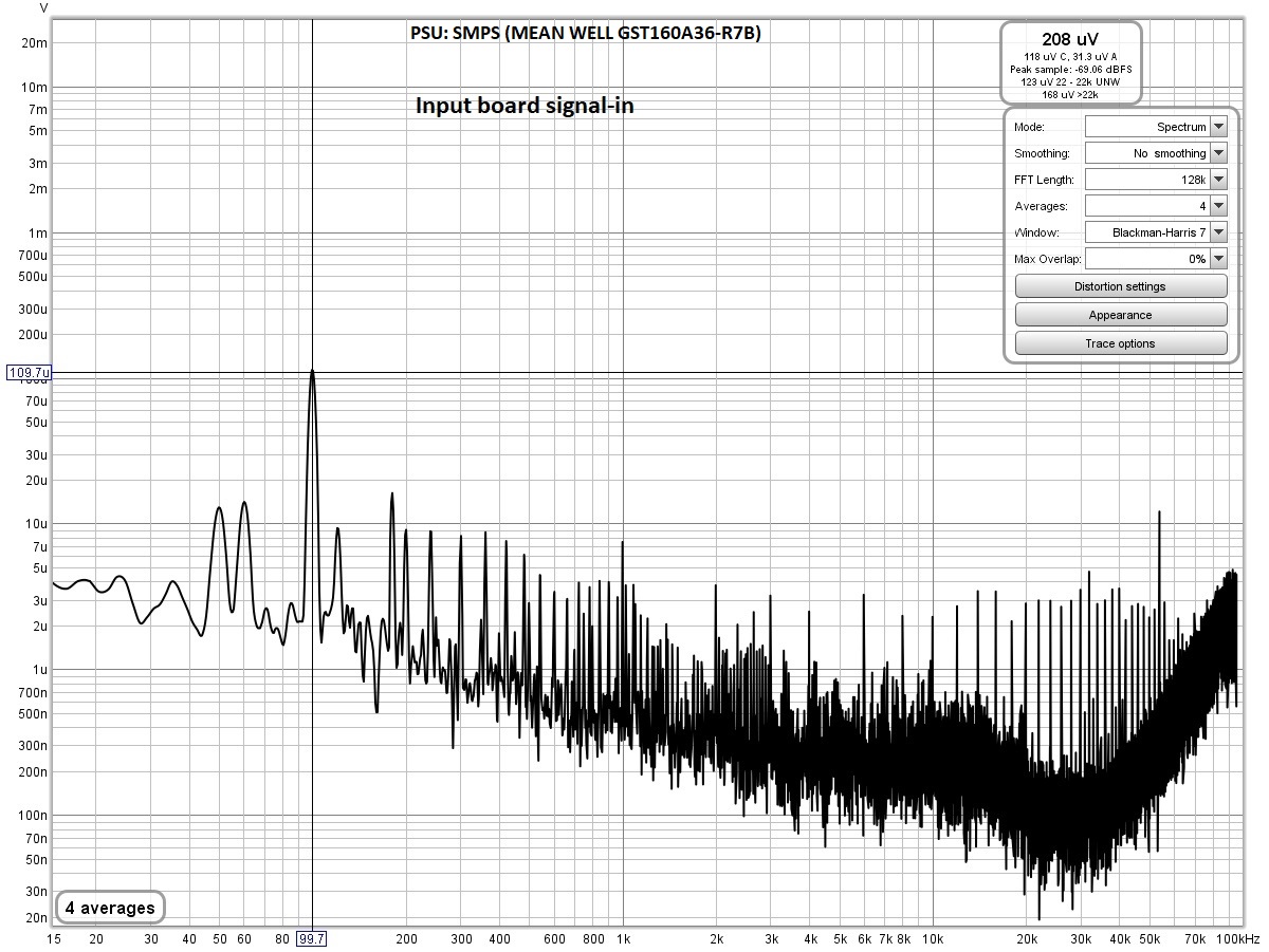

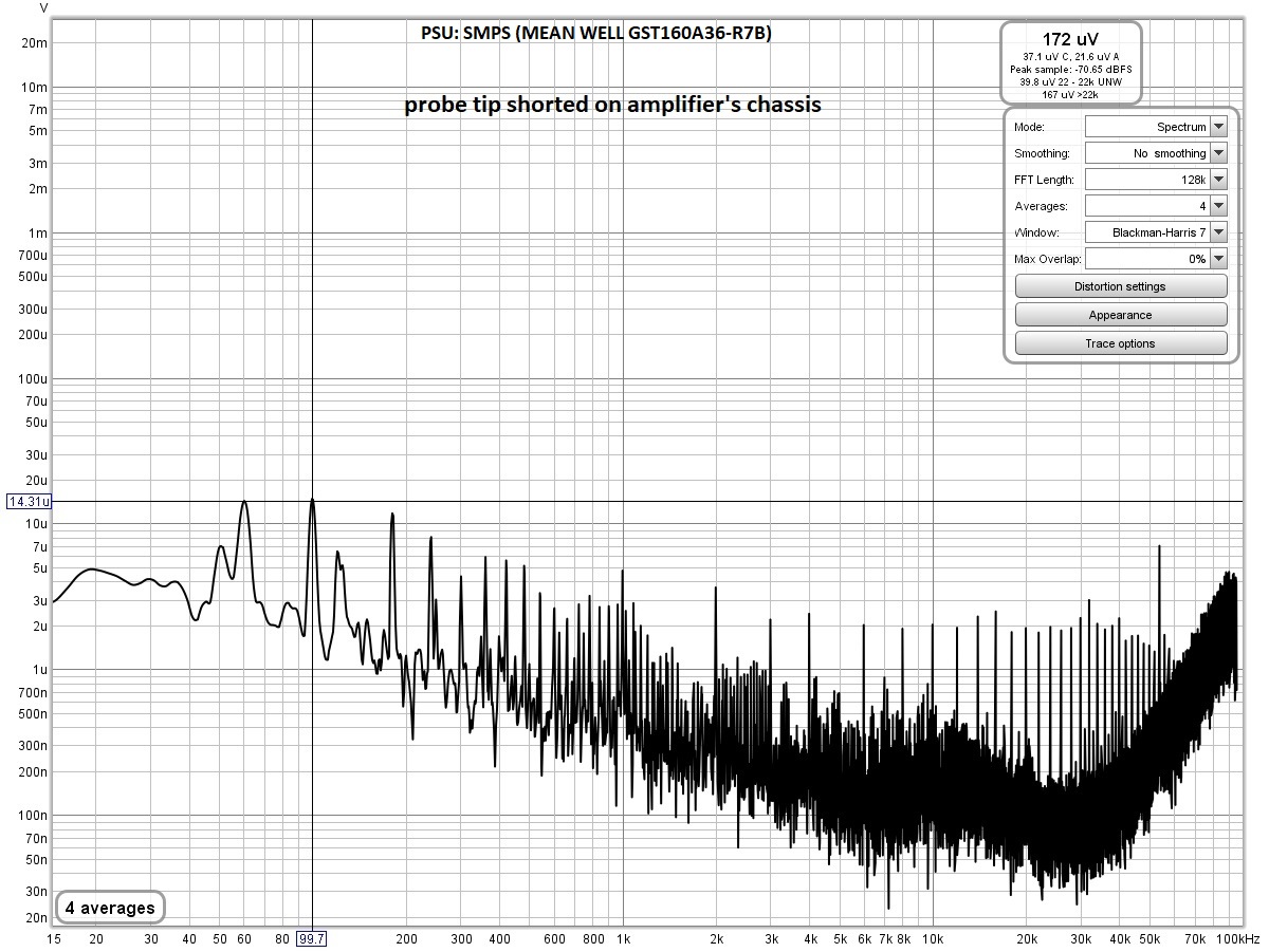

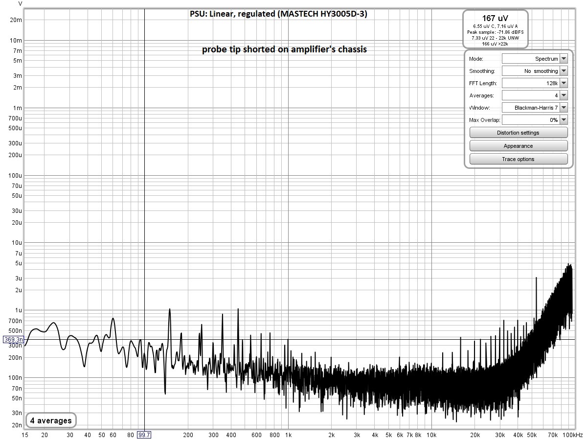

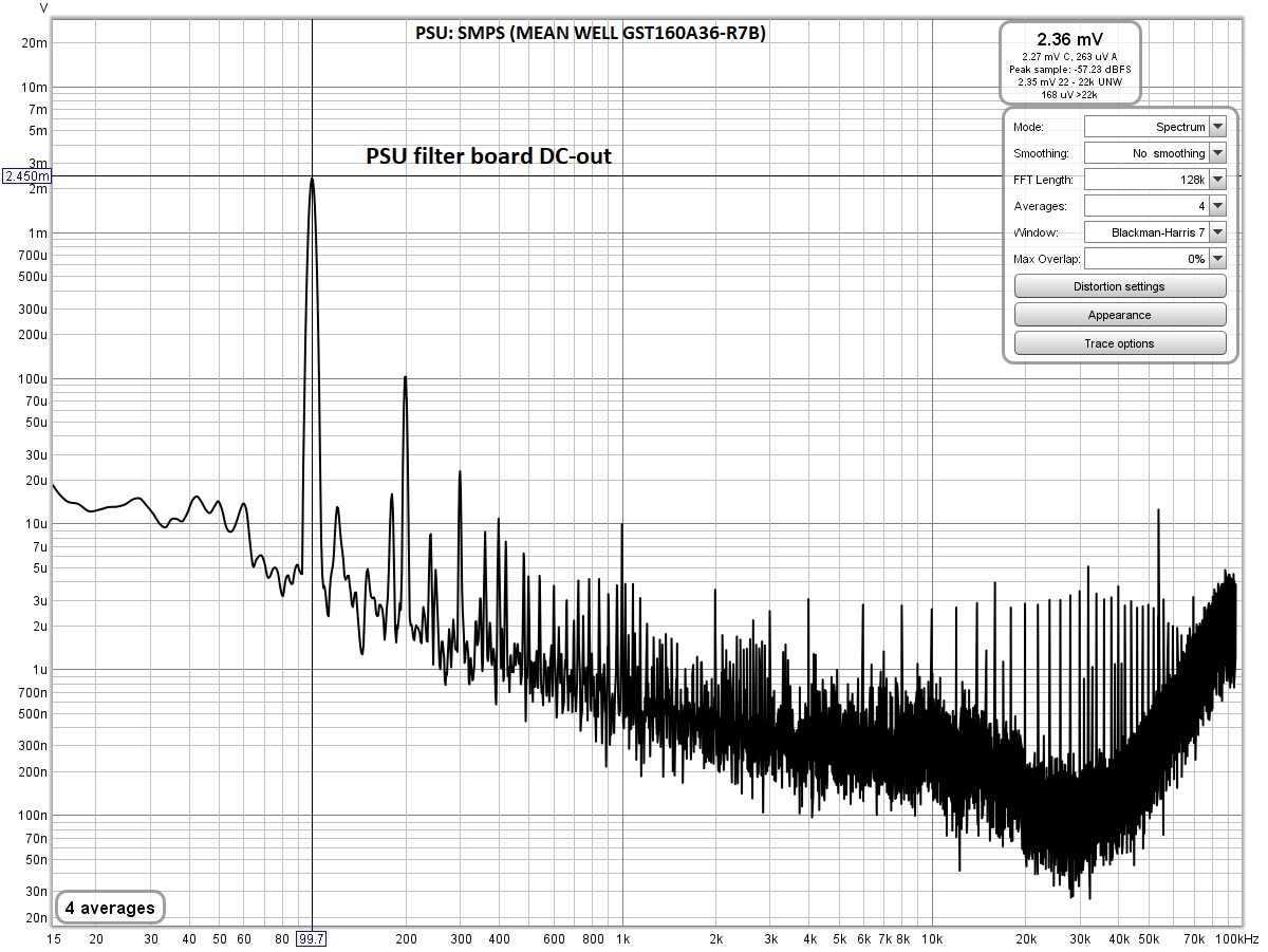

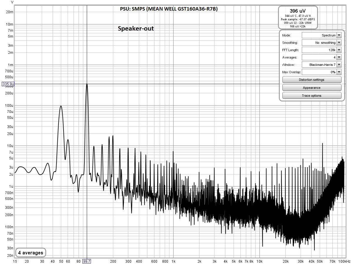

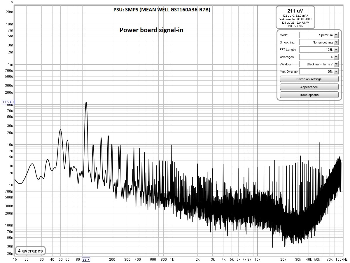

The 100Hz component at speaker-out is 0.34mVrms. I don’t think anyone can hear this.
It comes through conduction from the SMPS. There is no radiation inside the amplifier enclosure. (I shielded the input module placing it inside a steel enclosure with no effect).
I did some measurements (inputs shorted) along the DC lines and along the signal lines. The offender comes through conduction from the SMPS. There is no radiation inside the amplifier enclosure. (I shielded the input module placing it inside a steel enclosure with no effect).
George
George

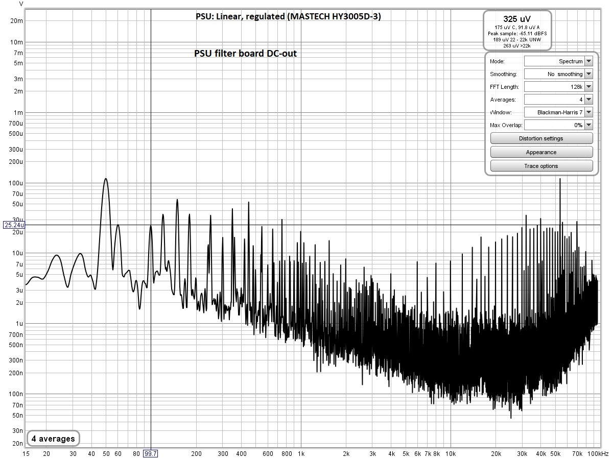

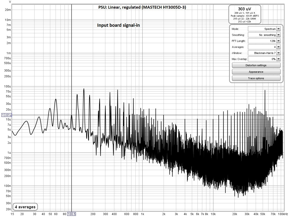

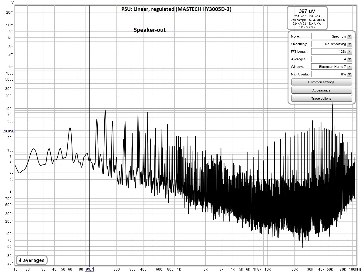

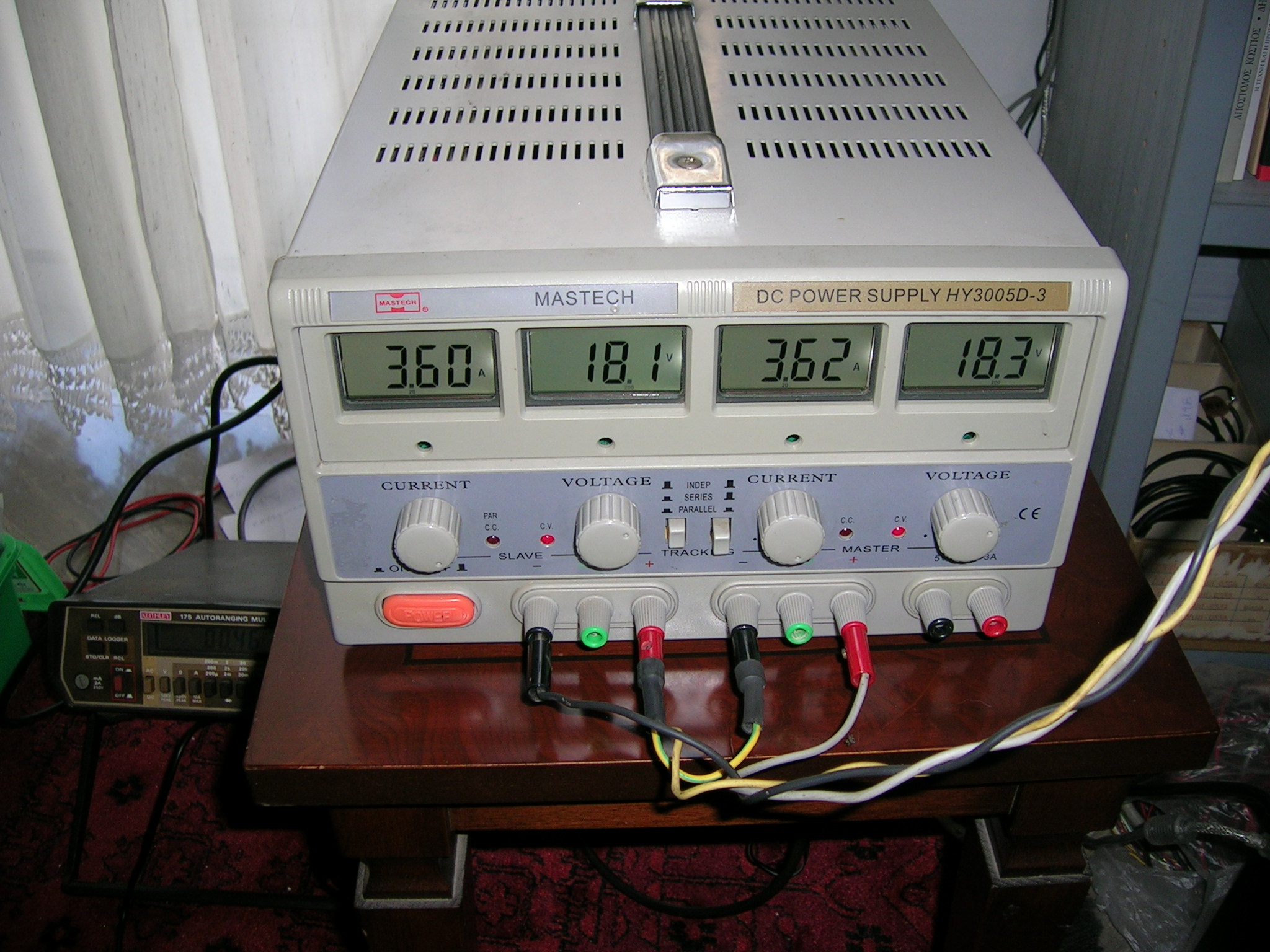

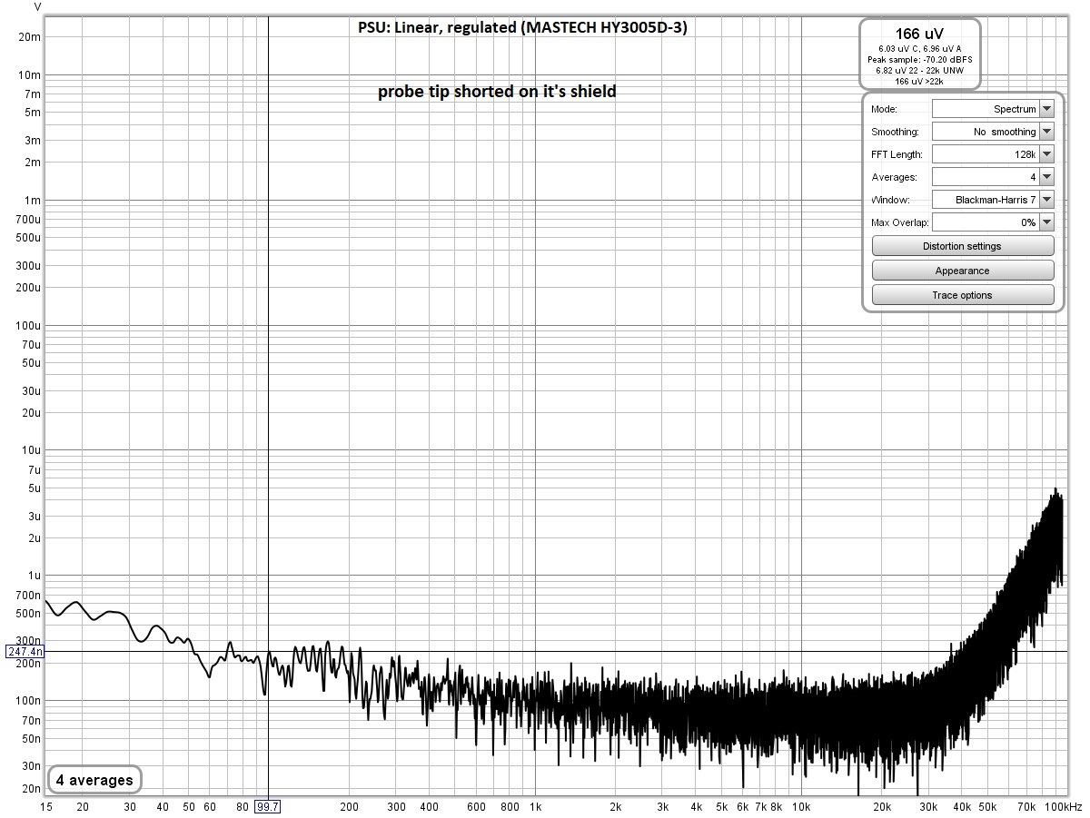

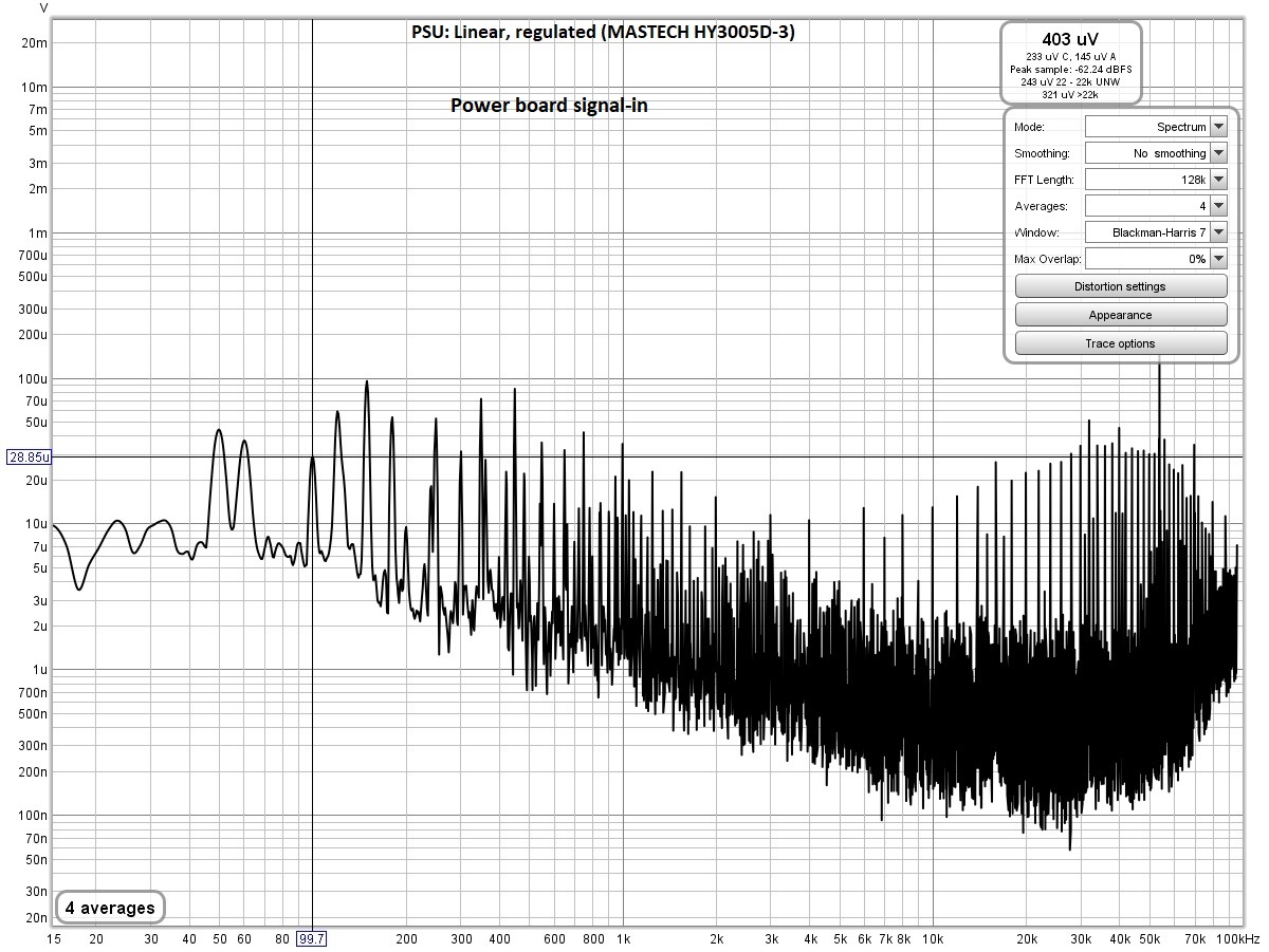

I measured at the same points, this time using a linear regulated PSU.
What is shown is with negative terminal grounded (when floating, there is a stronger 50Hz component)
I prefer the SMPS 🙂
George
I prefer the SMPS 🙂
George
