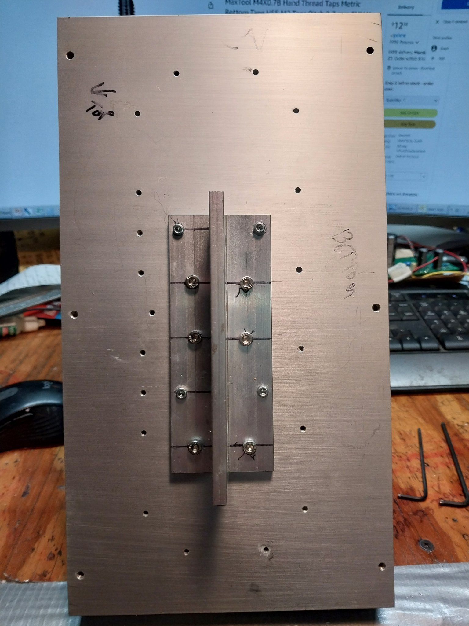

I still have to flatten the sink and T, I'm thinking about taking them to my buddies machine shop 5mins instead of lapping, Iget cramps in my hands these days. The holes aren't perfect, but no bad for eyeball. 😛 They should do the job of cranking that T to the sink. I haven't tapped them yet. I put a peice of tape on a small Allen, so I didn't go to deep. I didn't want to punch through it. I have done so on some higher wattage stuff to make sure, but this should be just fine. I also mounted them in the middle of the sink.
Reactions: Monk55
First one done. All holes line up, which is good as I drilled these by hand. Tapping went well, I only had through hole M4, but I had two, so I cut the tip of one off to make a bottom tap of it. That gave me a couple extra threads. I did make a couple dimples with the though tap. You can see them on the outside of the sink. No biggy, but will tak into account on the next P channel build.
Here's a pic of the first T done and test fit. I will fire up the press for the second one, as some of these were a bit off the perpendicular. :O
Is it a bit of overkill? Probably, I could have done with 2 less holes. At the time I was going to use the same size screws, but I went to an M4 which has more beef. I left the originals as sized and the inner holes are mine and M4.

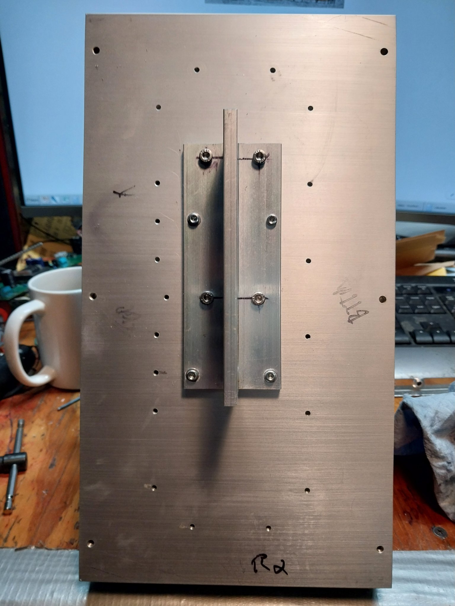

Anyway, I drilled the second one on the press and took a bit more care. I like this pattern and will use it on the second build. Next up leveling the sinks and Ts. I think I'm going to setup fences on either side of the area I need. I see no point in spending time on areas I'm not using.

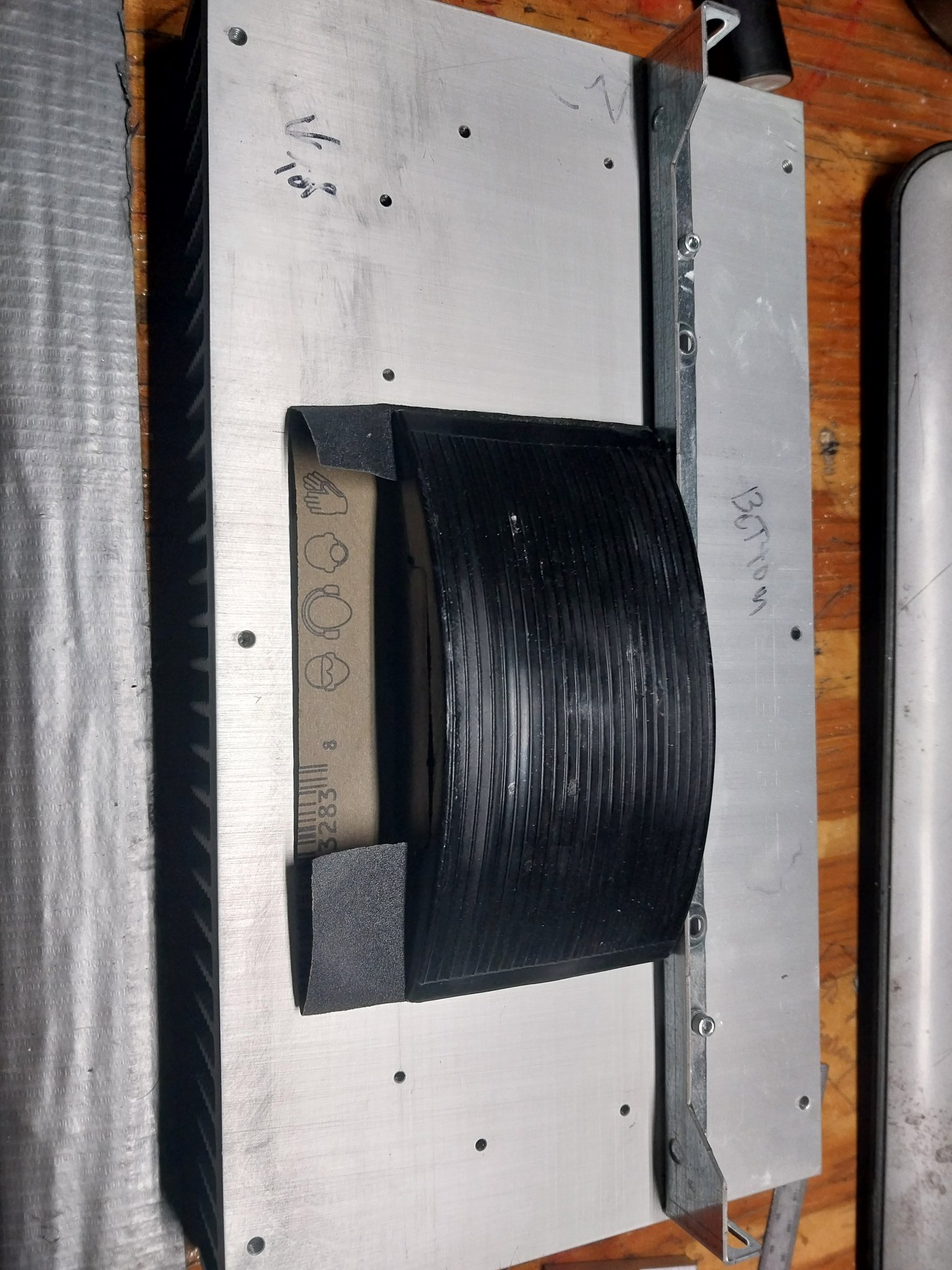

I decided to work on some lapping. I think I should have waited for the machine shop on Monday. 😛 I was rather shocked by just how bad the flatness turned out to be. I spent a couple hours on one sink and T. When I first set them together, I could rock the T like a teeter totter. It's no wonder some heat issues were found. I didn't get them perfect, but no more rocking and as much as I was willing to do. I still have the other side to do yet. The main thing is to get it close, so you don't have that thick layer of compound.
The T looks like they extruded it, but didn't come back and grind it flat. The worse part was right down the middle, it looked to be a good deal concave there.
