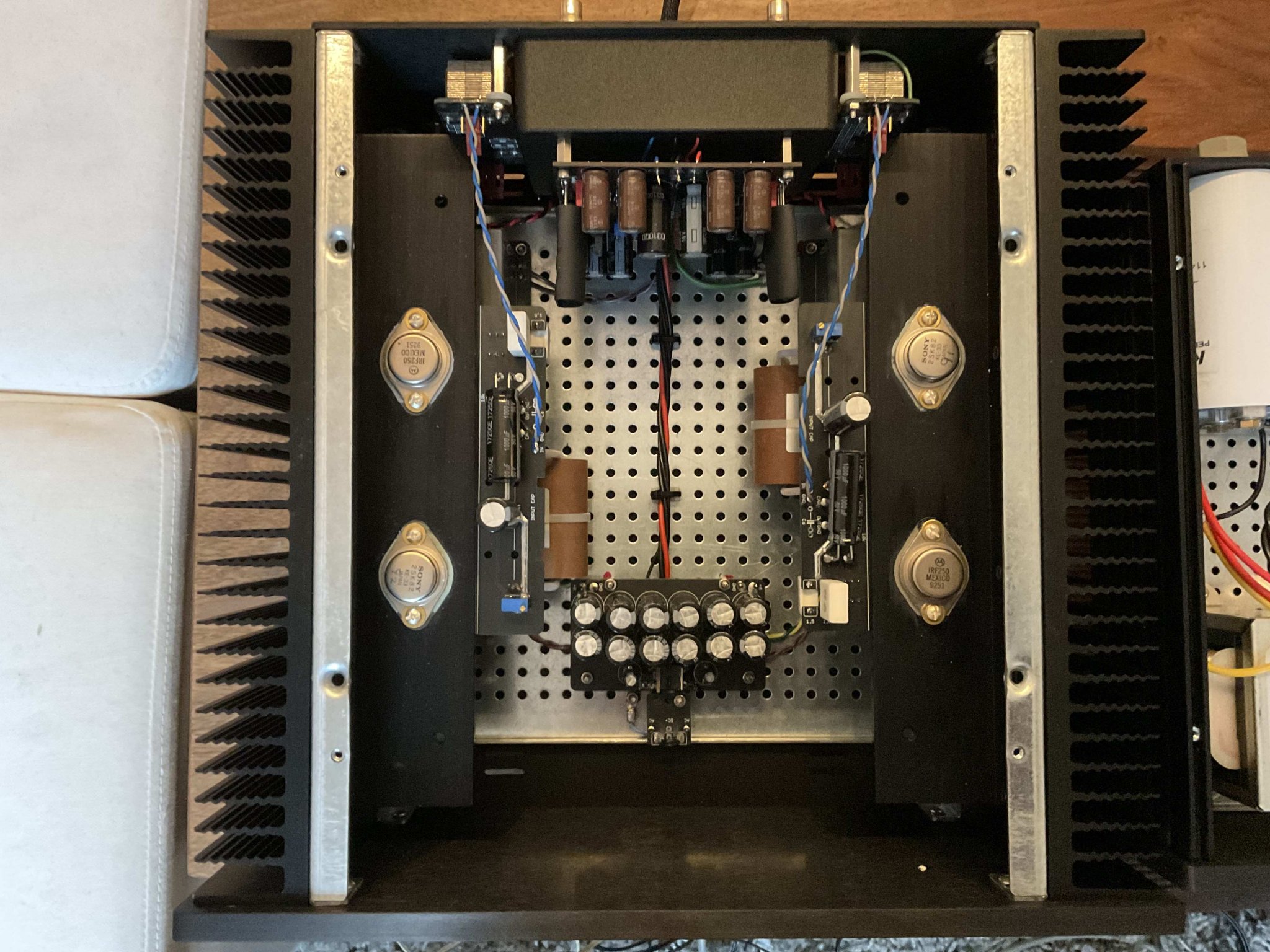

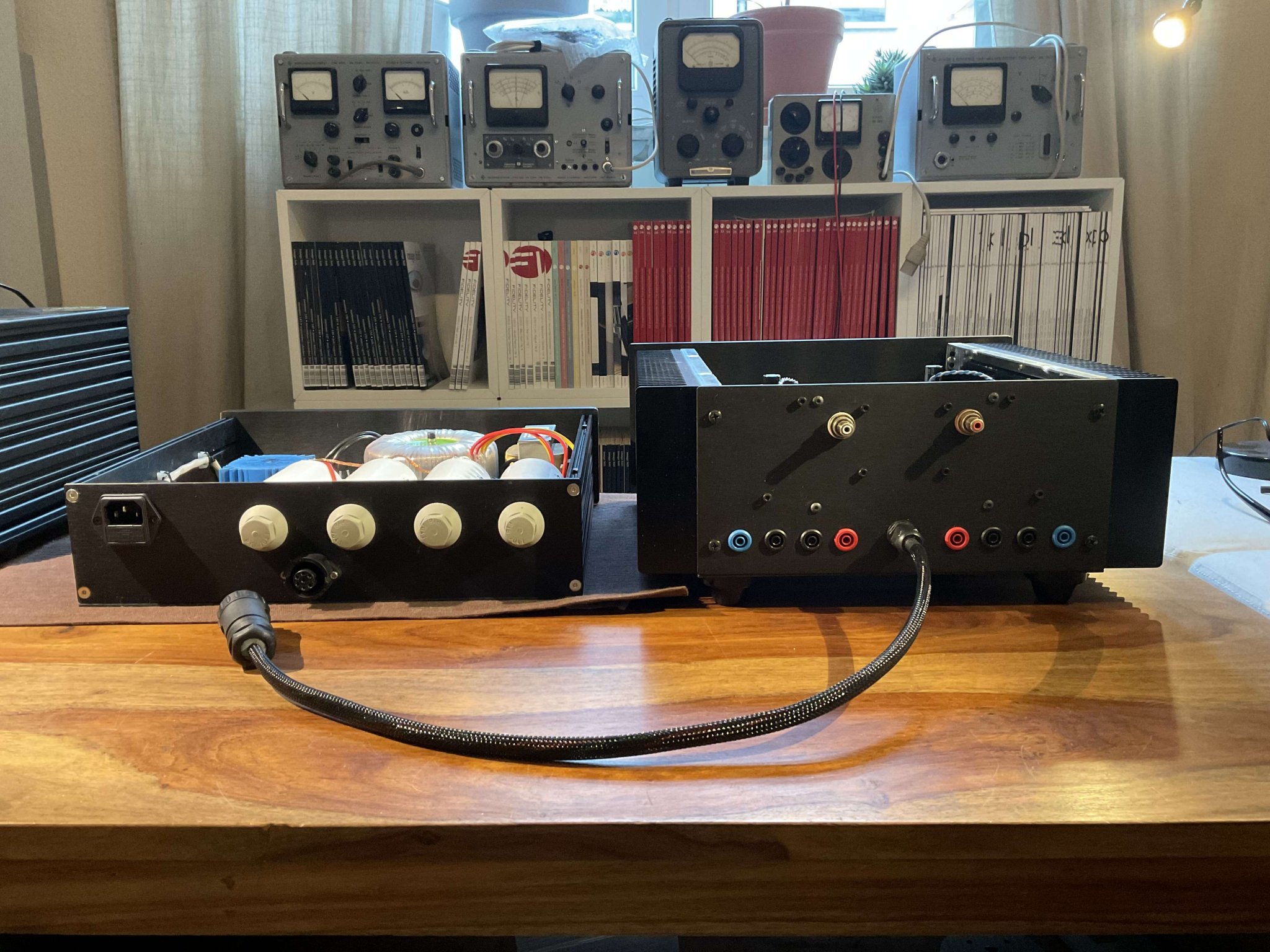

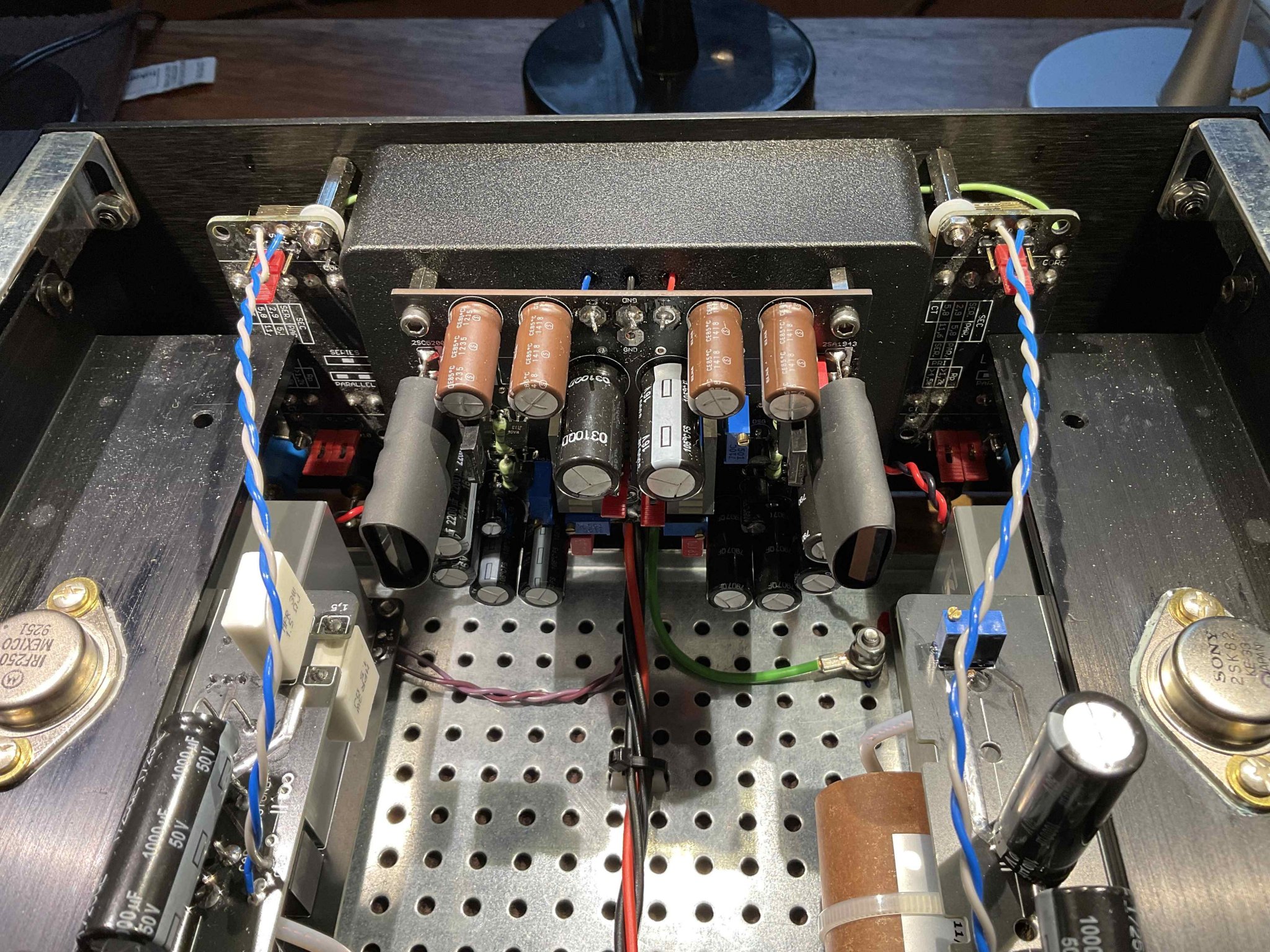

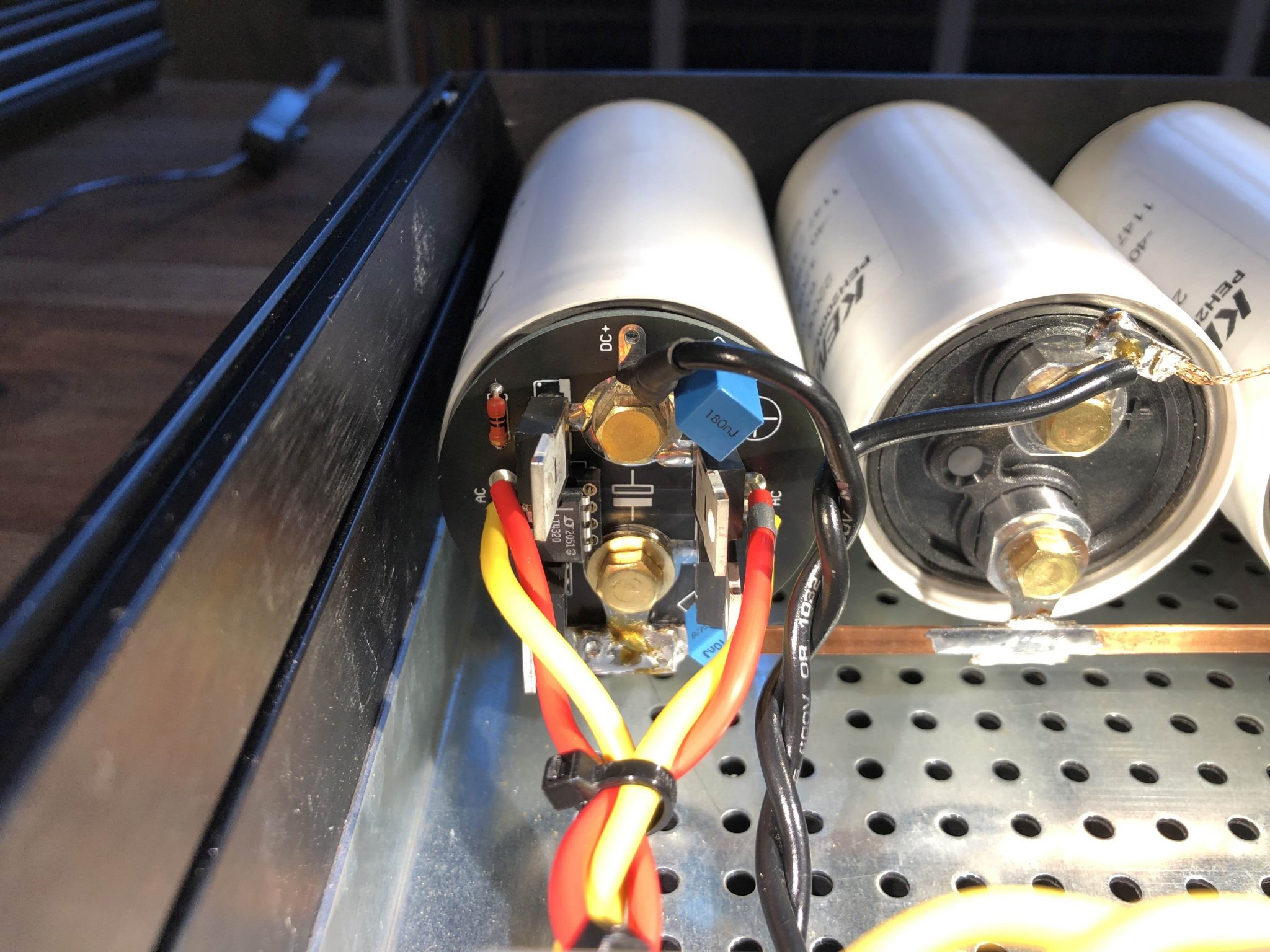

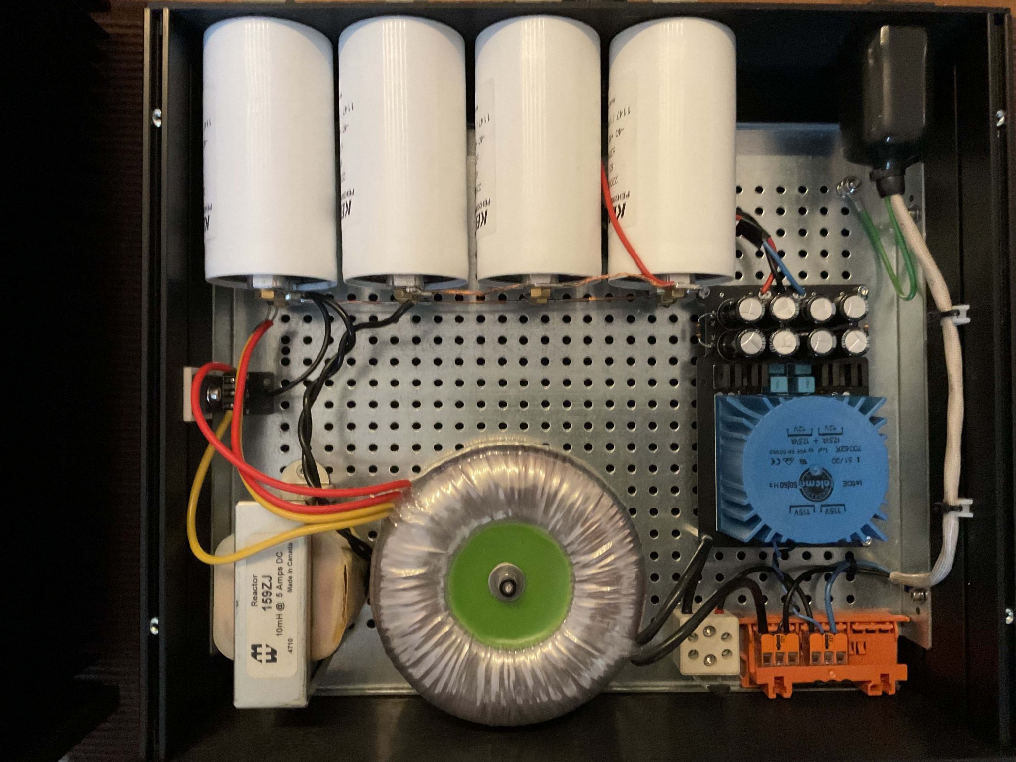

My attempt on VFet N
  • Frontend Dual DCB1 (1R Deg) - so no coupling caps at In- or Output
  • Interstage LL1930 1:11,6
  • no Zobel on secoundaries (raises Distortion)
  • ext. PS CLC 88mF 10mH VFet & Supply +/- 16V (due to space limitations)
  • 2x 6mF decoupling in amp chassis
  • bipolar L-Adapter for FE
  • 2 Outputs 4,7mF or 130uF DC-Link (tweeter/HP)

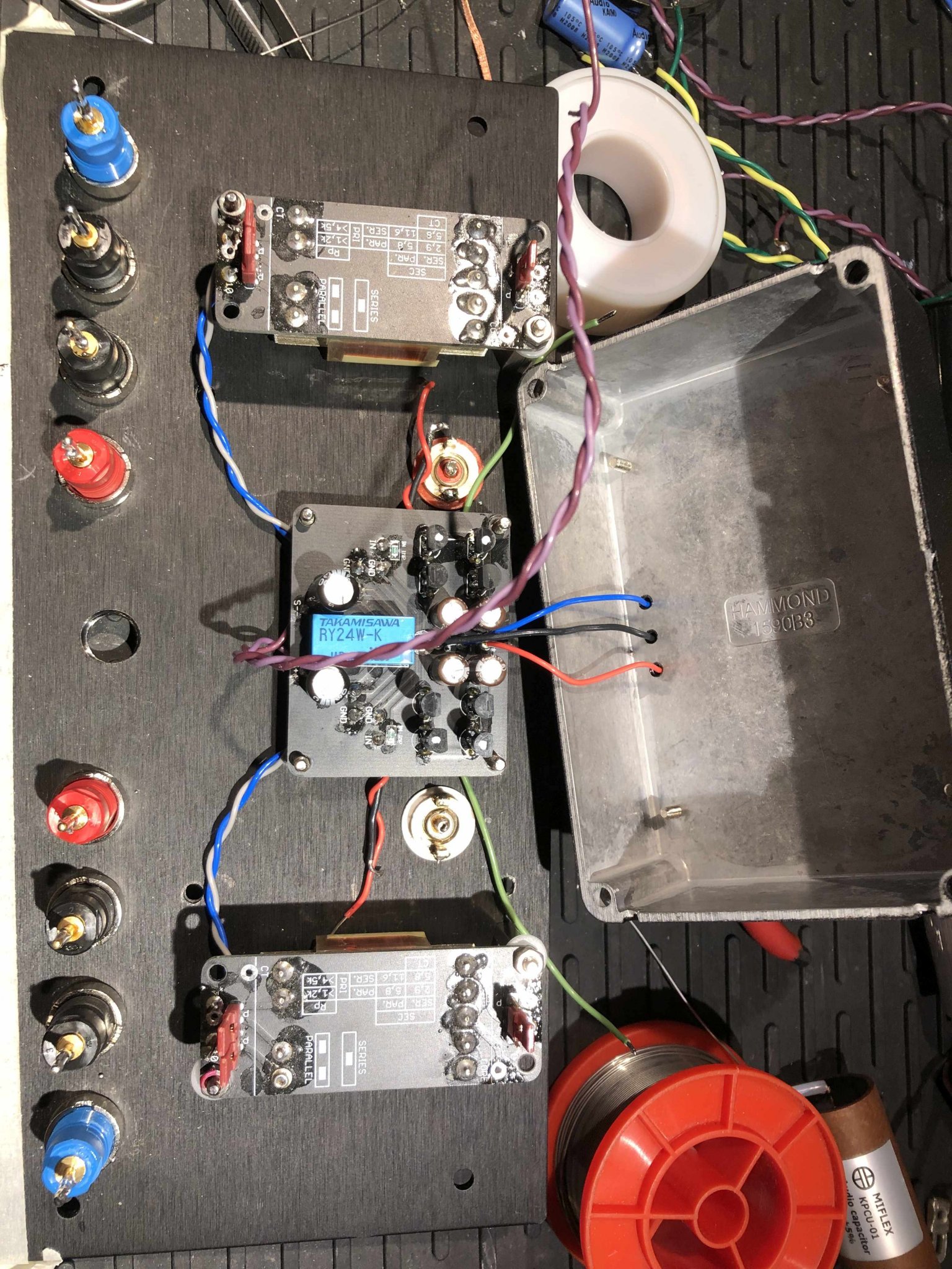

  • simple relay circuit based on IRF510 (DCB1 & Output caps)
  • Mini-Disspipante 120H x 300D

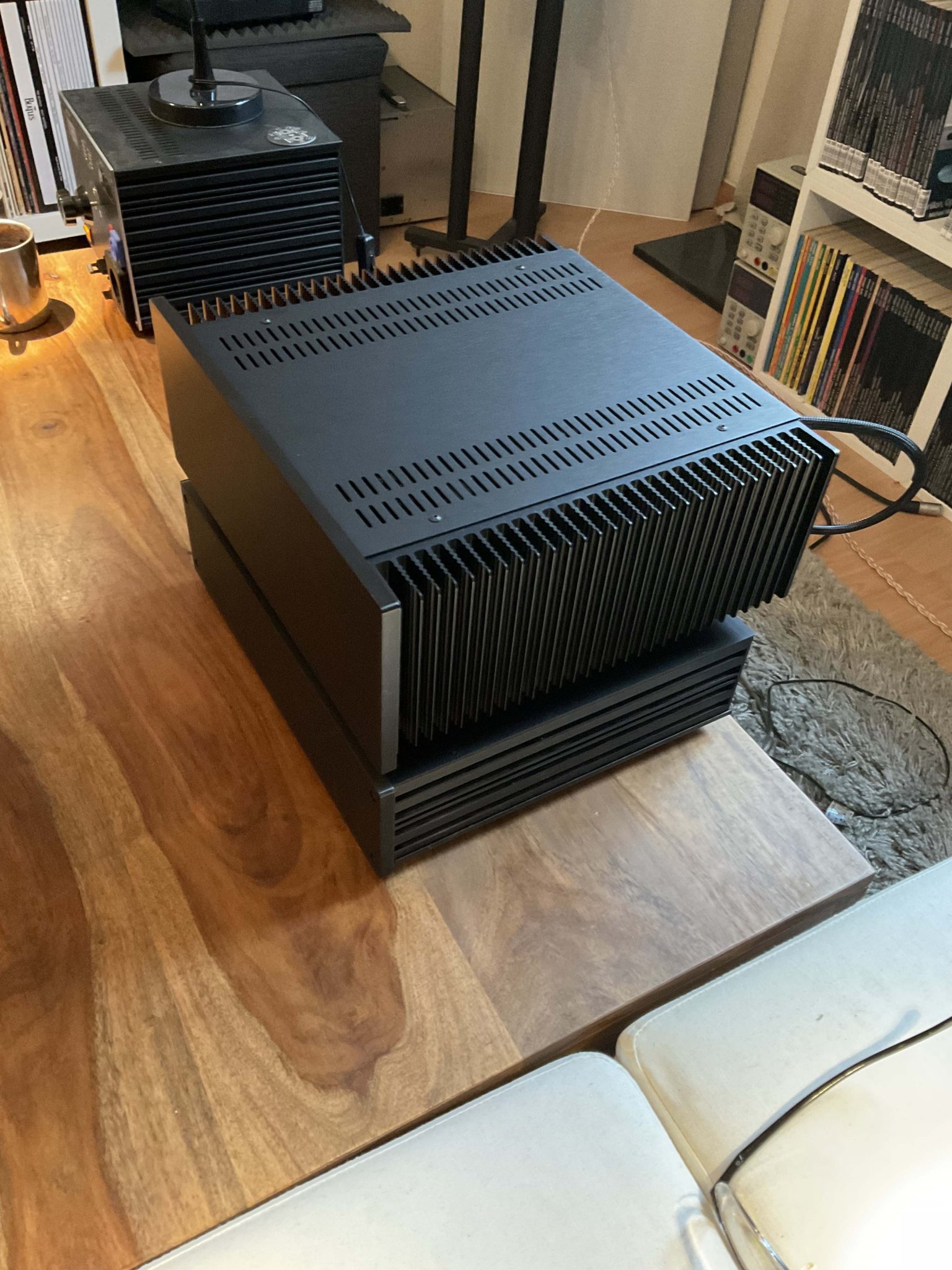

  • I used almost only parts that I have at home (except case & 250VA PT)
Some remarks:
Even with really good PC-Paste and the long T-Brackets from the PP-Vfet the 120H Case (0,4 C/W) is close to the limit. 26-28°C above room temperature (measured at the heatsink).
A 28V 250VA PT is also quite marginal. I get about 35,5VDC (236V in) at the VFet-PCBs in Fullwave CT-Configuration. A 30V PT would have been better. Maybe I can squezze out another 500mV with a LT4230 - PCBs arrived yesterday. Therefore the secondaries aren't twisted ;-)
As there is only one coupling cap (beside the output) upgrading from a plain Solen (which I used in the testbuild) to the Miflex 220nF was clearly a step up. In contrast to the Miflex-Upgrade which brings the most benefits in the Mid to Highs switching from a 6,8mF Panasonic HA (testbuild) to the 4,7mF Nichicon enhanced the Bass noticeable. Didn't test the 130uF path on speakers yet but with headphone it sounds really fine.
Verdict: this is a ridiculous good sounding amp - thanks Nelson! The only downside: I would like to have about 5 Watts more - maybe i find a semi-matched pair of sk180 some day.

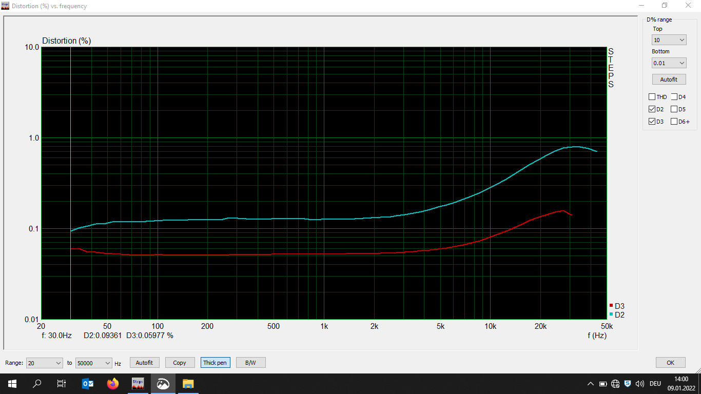

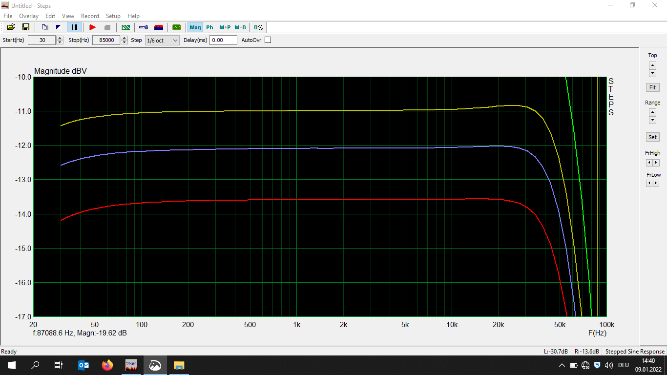

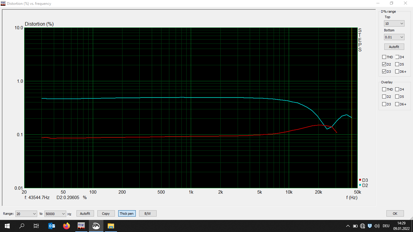

I'm not 100% sure about my distortion measurements cause I have not much experience with ARTA/STEPS but they are in the area of Nelsons measurements of the VFet P. The higher distortions in the upper region comes from the 1:11,6 connection. In 1:5,8 the distortions are higher in bass but lower in highs. Also you have to use an output resistor with the LL1930 to tame the heavy peak at 40-50kHz - I went for 10R but if I had one at home I would have used 22R. 33R is a tad too much -1dB at 20kHz.

Clearly a very meticulous build executed toward a specific vision. All I can offer are a couple ideas:
1) The heatsinks used in the store version of the VFET amp are the same size and hole pattern as the 4U x 300mm Deluxe chassis. Larger and capable of dissipating more energy.
2) A pair of 160VA power transformers, one for each channel, will exhibit less voltage drop and better regulation than a single 250VA. The 28V secondaries are enough for a CLC filter. A pair of 15V secondaries in series (total 30V) work well for a CapMx style supply such as the SLB.

Member Mark Johnson has written about the turn off thump:
https://www.diyaudio.com/community/...2-n-channel-build.375437/page-28#post-6789777
and designed a circuit to minimize it:
https://www.diyaudio.com/community/threads/diy-sony-vfet-pt-2-n-channel-build.375437/post-6776029
Builders of the circuit reported good results:
https://www.diyaudio.com/community/threads/diy-sony-vfet-pt-2-n-channel-build.375437/post-6783871
I’m currently using the DPDT circuit in the article instead of the single pole switch included in the kit, but have considerable turn on and turn off thumps on my insensitive speakers. I haven’t bothered to address them.
