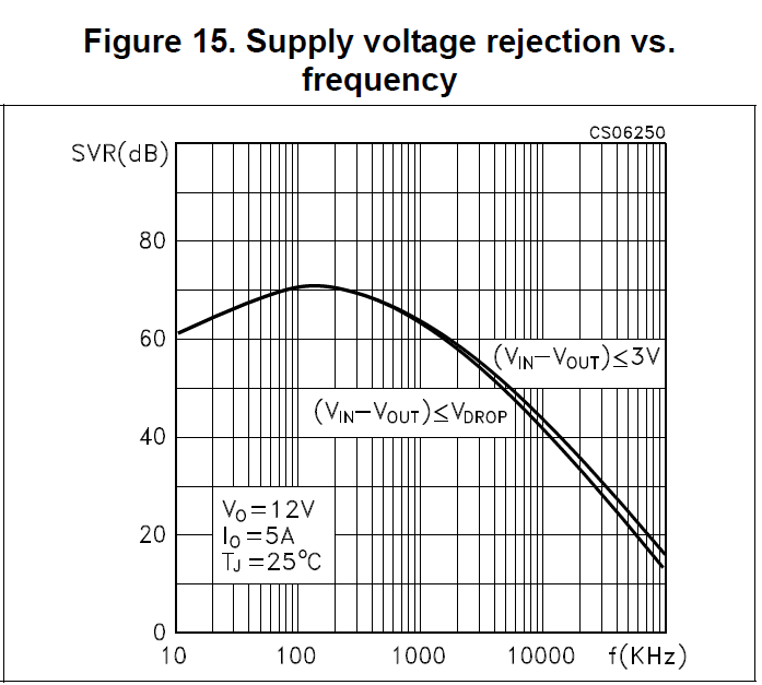

The spare-no-expense approach to reducing 100 Hz ripple, is probably (the Tuba filter) . It's a pair of 5 ampere voltage regulators, one for the Left channel and one for the Right channel. Datasheet claimed ripple reduction at 100 Hz is 3100x (70 dB).

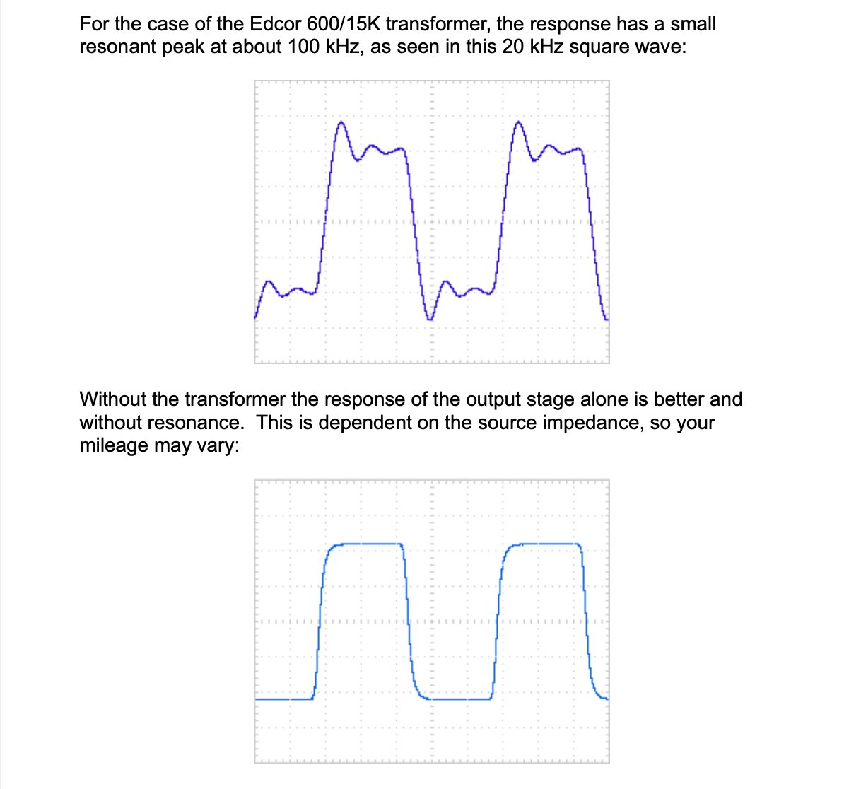

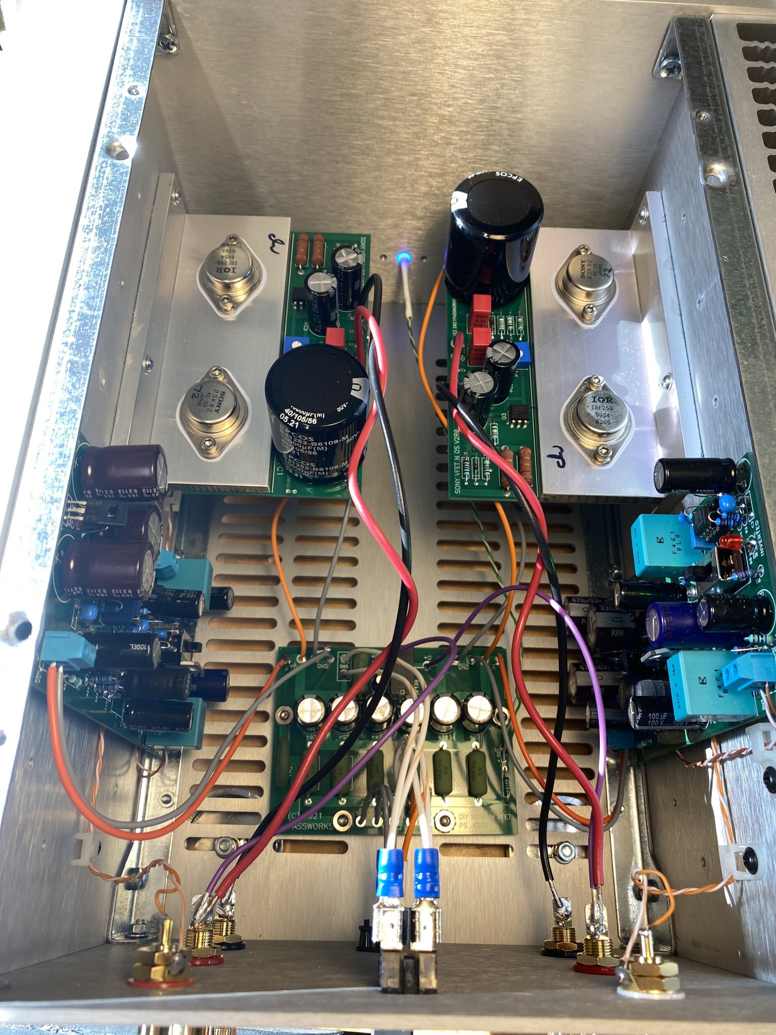

finally finished it. I went with Mark’s Marauder Front End, instead of the standard Edcor version.
Biased up at 14V and it’s looking good on the oscilloscope.

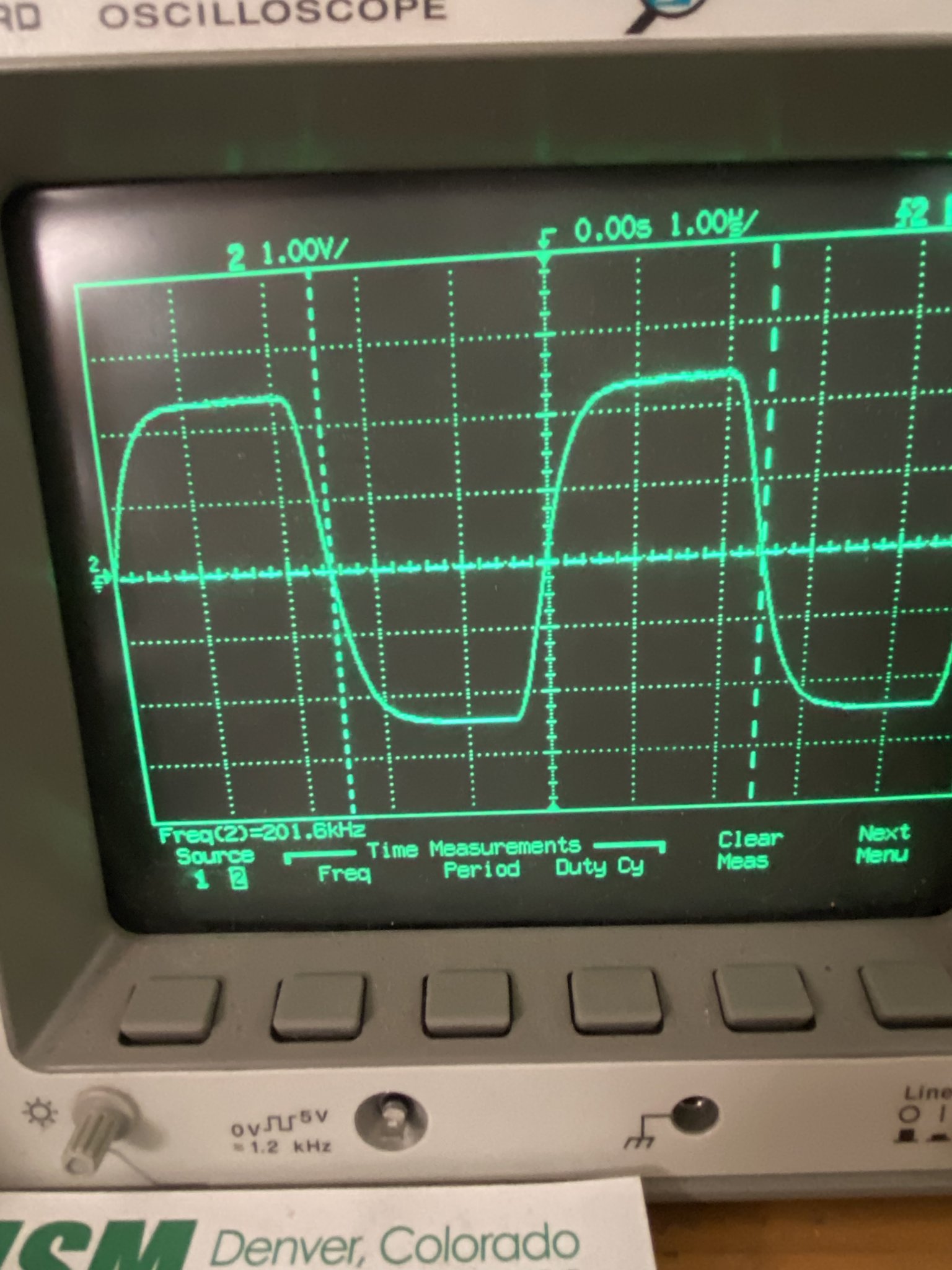

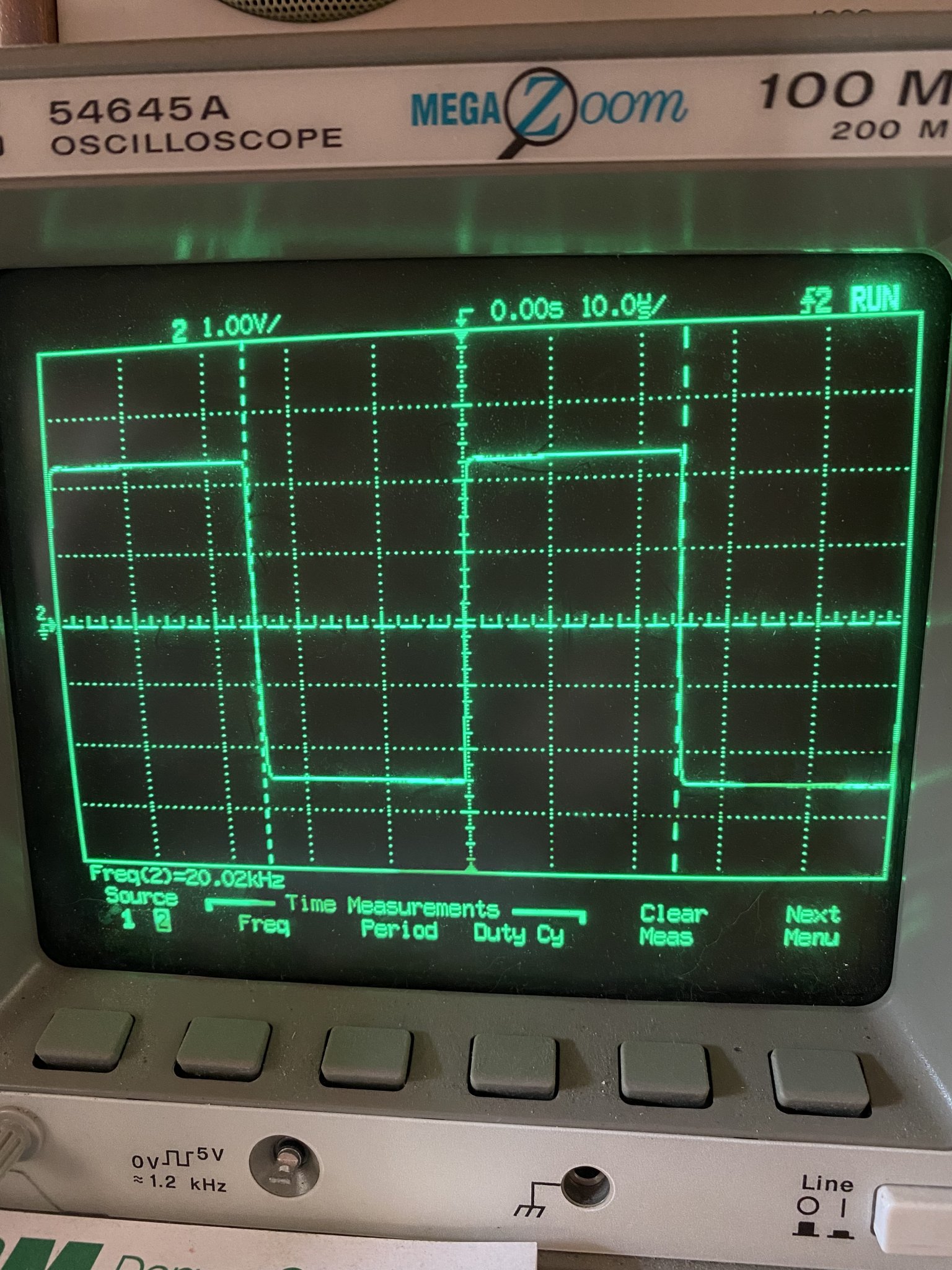

Check out these square waves at ~1W into a 8ohm load. 20kHz looks great. I don’t see the 100khz ring as Papa pointed out in his Part 1 article. Seems the Marauder front end is cleaner than the Edcor. Even 200khz looks pretty good.
Gotta hook it up to speakers next.
Thank you Nelson and DIY Audio!
