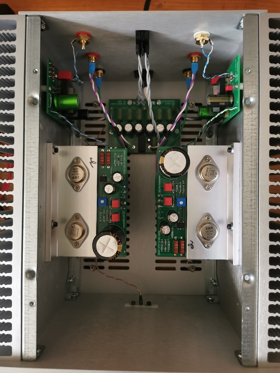

Number 137 finally completed. 🙂
I did listen some music and first impression is very positive.
My only concern is vfet temperature. After forty minutes of playing the right channel vfet have 74 degrees celsius (165 degrees Fahrenheit) and the left 72 degrees celsius (161 degrees Fahrenheit).
Is this normal? I'm not used to it for such a high temperatures.
Yes. Also, the bias was tested on these units before shipping. If you want to improve that a bit you can check the bolt tighness, put a thin layer of thermal grease between the bracket/sink and make sure there's good ventilation for the sinks.

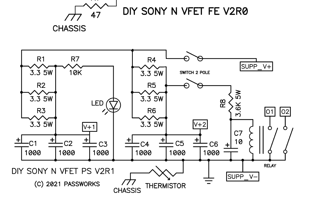

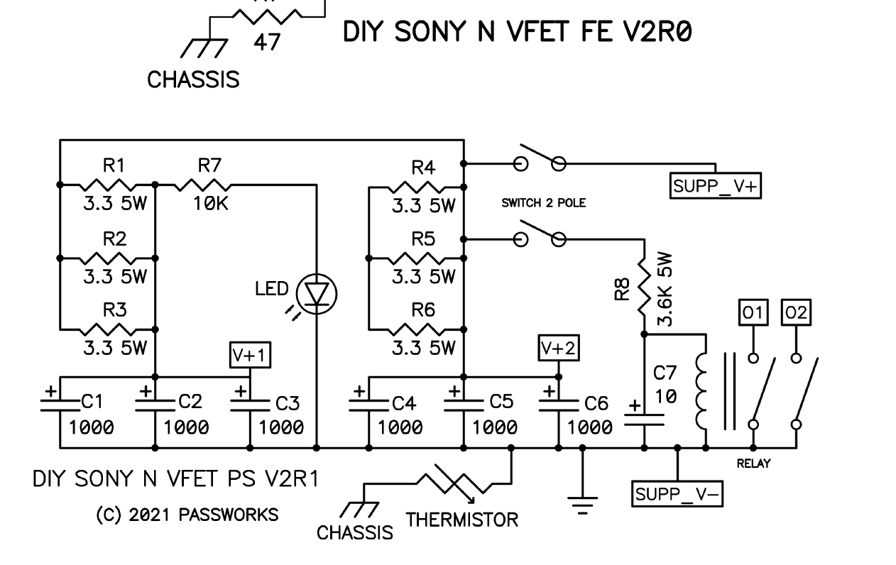

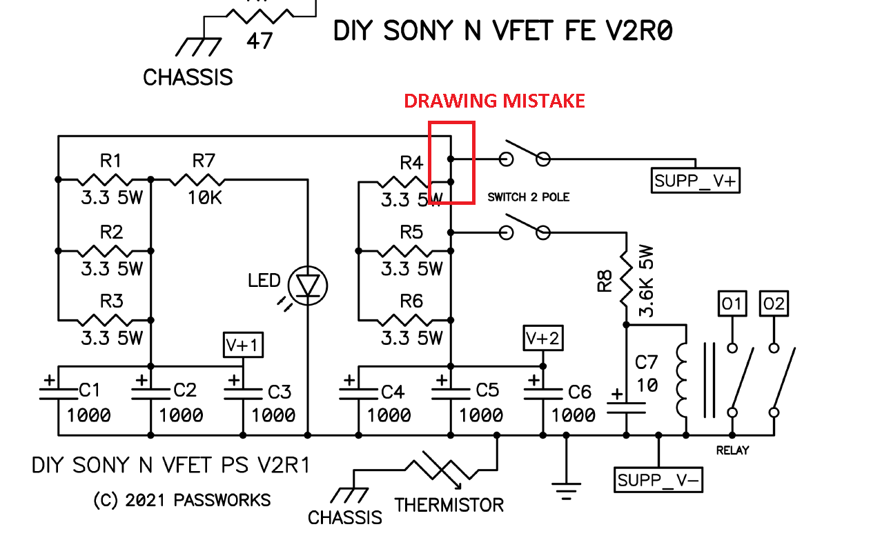

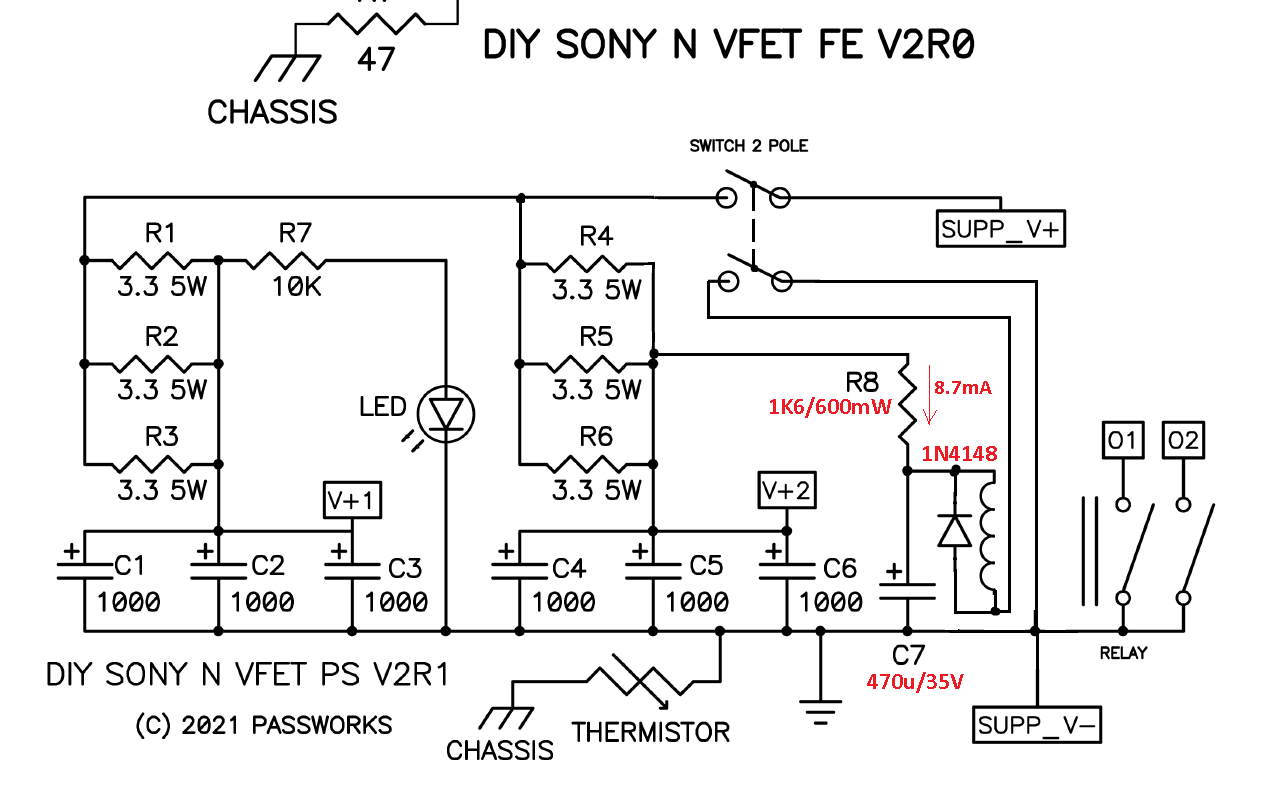

well, I'm always amused studying Papa's schematics, from any imaginable reason .... mistakes being one of them
original, drawing mistake marked, mistake fixed, simple remedy for better AntiBigBadaBoom at speaker out
Does that mean cut the yellow pcb trace I marked in blue?mistake fixed, simple remedy for better AntiBigBadaBoom at speaker out

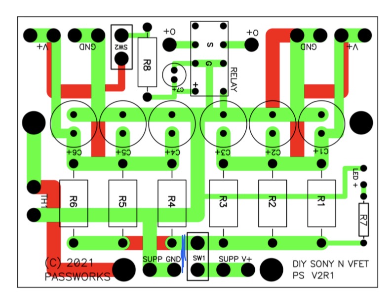

I'm in the process of assembling one Lottery amp for my dear Friend, way of paying back for valuable help he gave in some of my endeavors
Will post detailed pics, as soon I'm done, so it'll be clear how I did changes to delay circuit
In a week or so.
Silly ZM, regarding schm above - I forgot to say that - as far as I was able to see it - Pa's pcb is proper, it was just drawing mistake
No, you would cut the v+ to one of your output board.Does that mean cut the yellow pcb trace I marked in blue?
Yes, the power of suggestion was enough for me to see the schematic error on a perfectly fine pcb. Oh, and also I’m clueless. At least I asked before grabbing the Dremel.No, you would cut the v+ to one of your output board.

according to my nature, I made an upfront claim of making something better than it is presently
so, as myriad times before, it'll be either All Glory, or Major Public Humiliation
(dunno - will nearly a second of relay engagement delay during power On, with immediate release during Power Off - is going to be improvement; can do more than second, but hard to squeeze-in bigger cap, without using glue-it technique )

everything set, works as intended
can inform that edited delay circ is working flawlessly - no visible move of cone neither at power On nor power Off
only if you are powering it Off reluctantly, slowly operating the switch , there is movement of cone, but slow and gentle - and even that one is not audible
same behavior when leaving power switch ON, and doing power operation with mains cable of switcher - Nada during power On, gentle roll of cone with powering Off

and yes, really dunno how delay circ operated in original, didn't tried it at all; but I'm used to change Papathings just for sport - hard to make it better, easy to make it in different way
