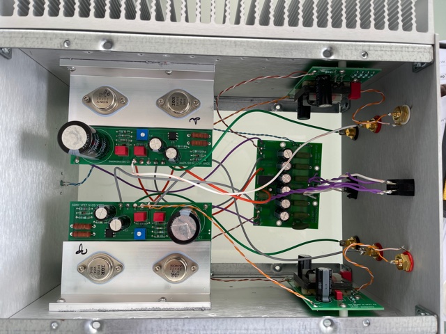

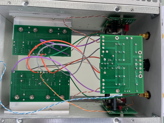

One channel dead
Thanks Franz. I have attached a couple of photos of the amplifier. I haven't spotted any wiring mistakes. I have made the following voltage measurements; Good Channel - MOSFET Drain 14v, V+ 33.9v, +0 0.035v, VFET case 33.96v, Z1 A 7.7v, Z1 C 14.0v, Z2 A 1.3v, Z2 C 6.00v. Bad Channel - MOSFET Drain 14v, V+ 35.88v, +0 0.024v, VFET case 35.88v, Z1 A 2.85v, Z1 C 13.44v, Z2 A 0.06v, Z2 C 2.89v.
I have tried a transistor tester on both mosfets and vfets (peak design) but don't get reliable readings.
Any thoughts re MOSFET or VFET would be greatly appreciated.
Neil Meredith
Neil Meredith

I've been building 172 but have hit a problem. Completed the build with care as per guide and Nelson's notes. Got a DPST switch in no problems. Checked wiring 3x. Powered up and tweaked bias to 14v and adjusted after warm up no problems. Heatsink and bracket temperatures felt right. Wonderful Eva Cassidy. Then from L channel fizzing sound and L channel goes quiet, just quiet distorted sound, other channel fine. Bias has changed to 17v possible to rebias to 14v though. Has the worst thing in the world happened and the VFet has died? Also no longer heat generated from L channel. Checked and rechecked wiring all seems good. Gentle advice would be very welcome.
Neil M
what is Iq now, measure voltage across R1 or R2
worth a try - replace 4N35, check resistors connected to it
if that isn't helping, remove mosfet and check it with simple matching jig
all in hope that VFet is ok, and fact that you can vary output node voltage is implying that, same as that biasing parts are OK
just to amuse us, post proper macro pic of Dodo channel pcb

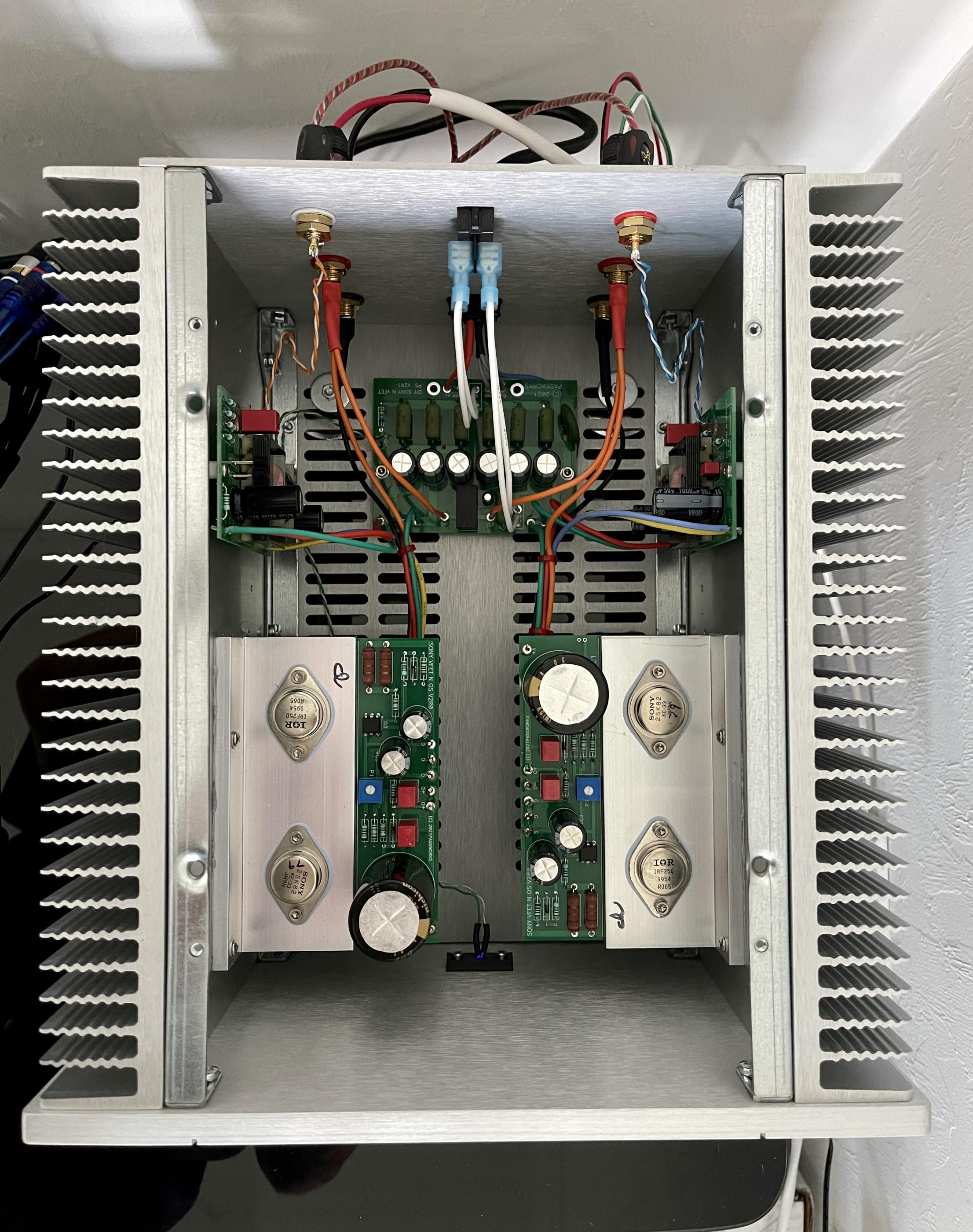

Number 82 is Running
Thank you Mr. Pass and everyone else involved in this amazing opportunity.
What a wonderful sounding amp! All of my Pass amps sound great,
love them all but this one is very special as in literally gives me goosebumps special.
Aside from that, I am speechless.
Thank you all again.
-Bill
-Bill
