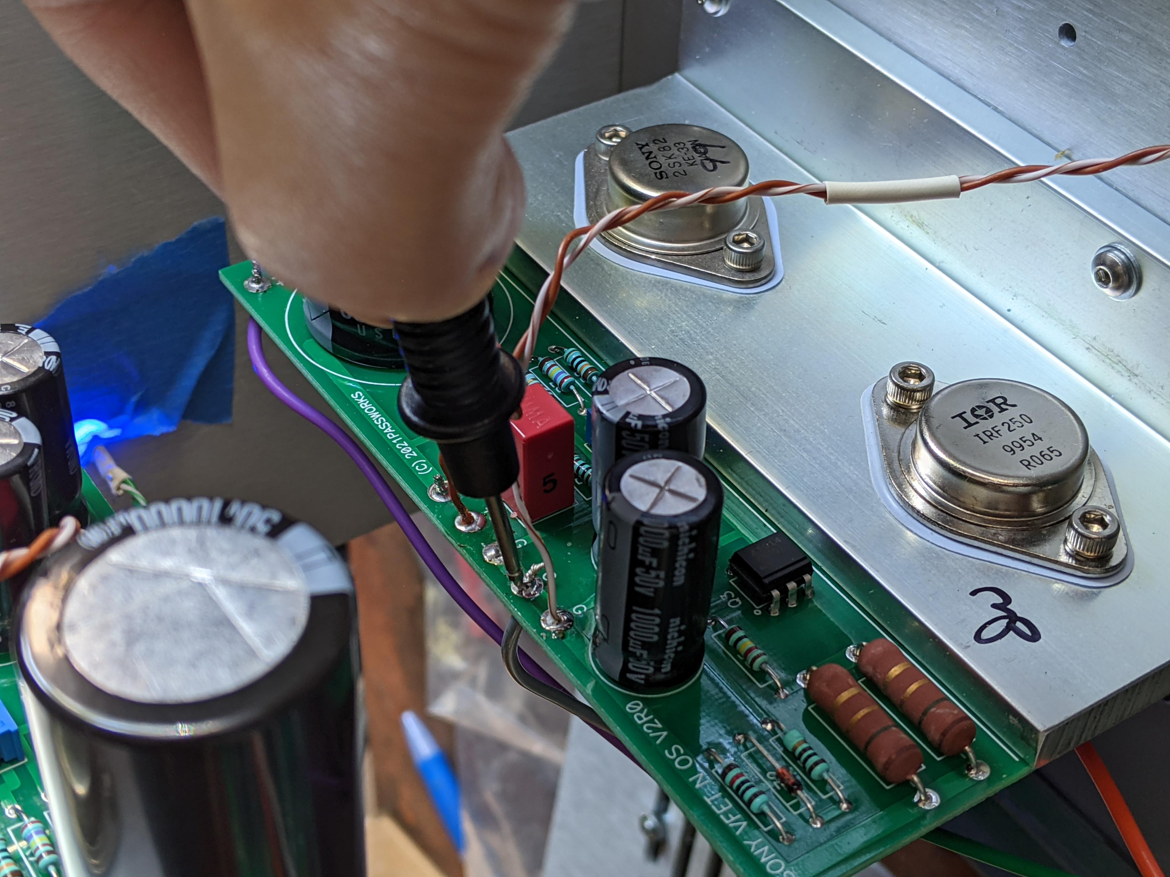

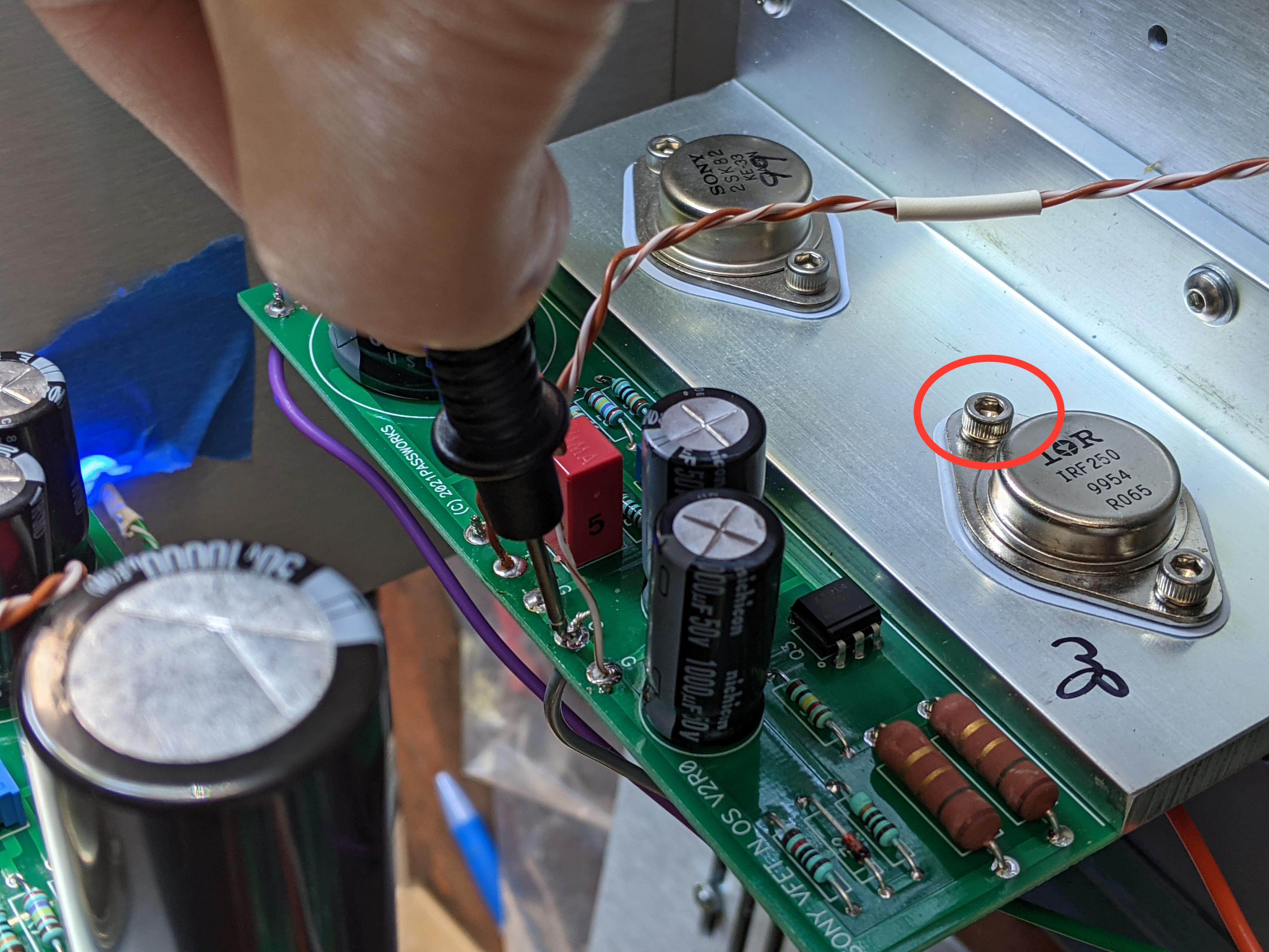

I'm getting the same reading of 1.3 at the anode where it was instructed to measure in the build guide. Adjusting the pot does not do anything. I will ask the obviously stupid question: where should I be measuring in order to achieve proper bias?
For the N-Channel Sony VFET amps, the bias voltage should be measured between the IRF250 and ground. I clipped leads to the screw head on the IRF250 and the ground wire on the output stage board.

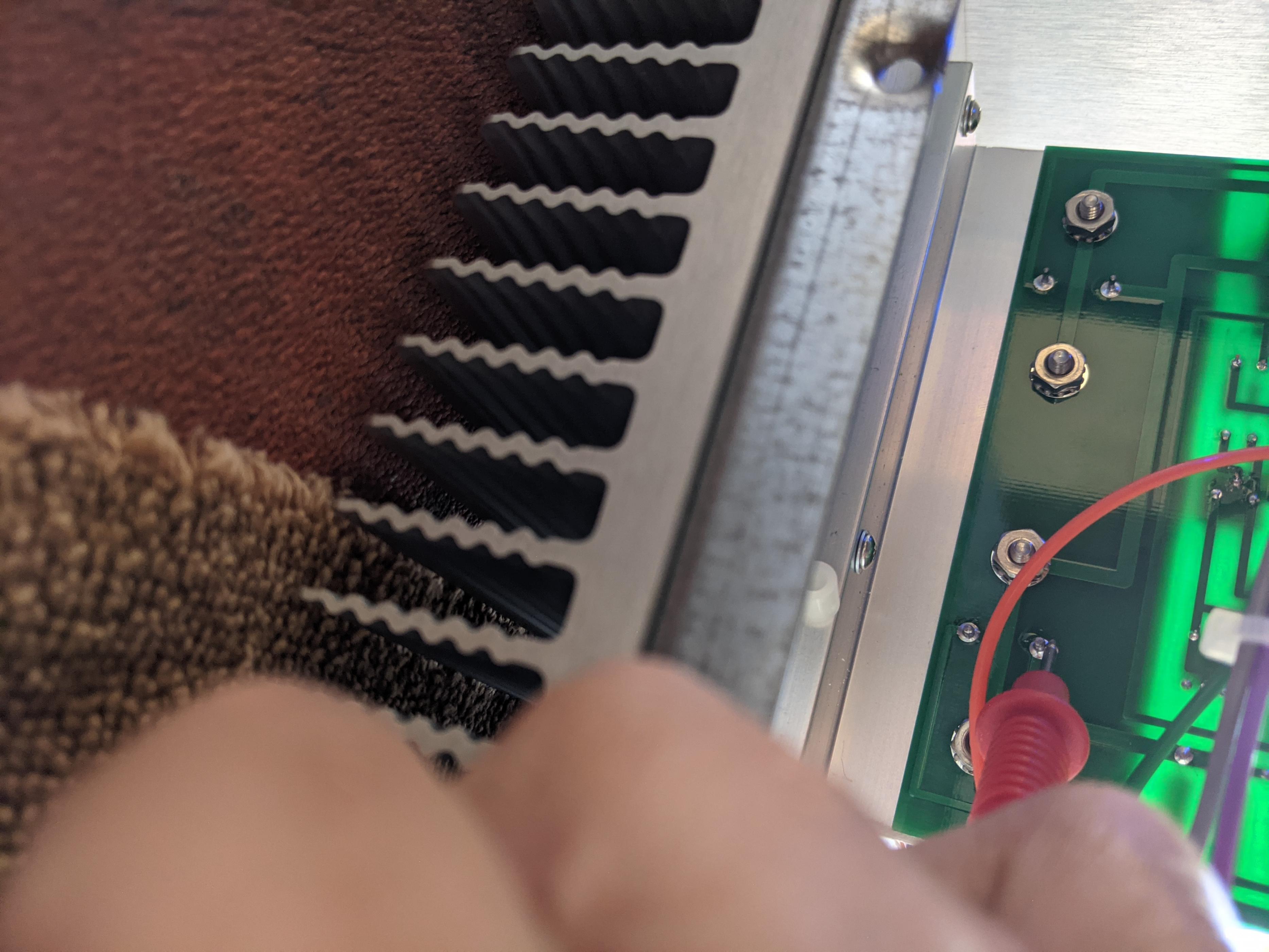

I checked from the IRF250 and ground, but I'm still getting 1.3? I've attached photos:
Measure from ground to the screw circled in this image.
