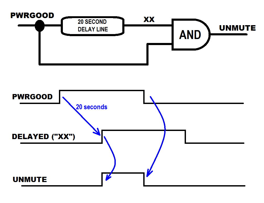

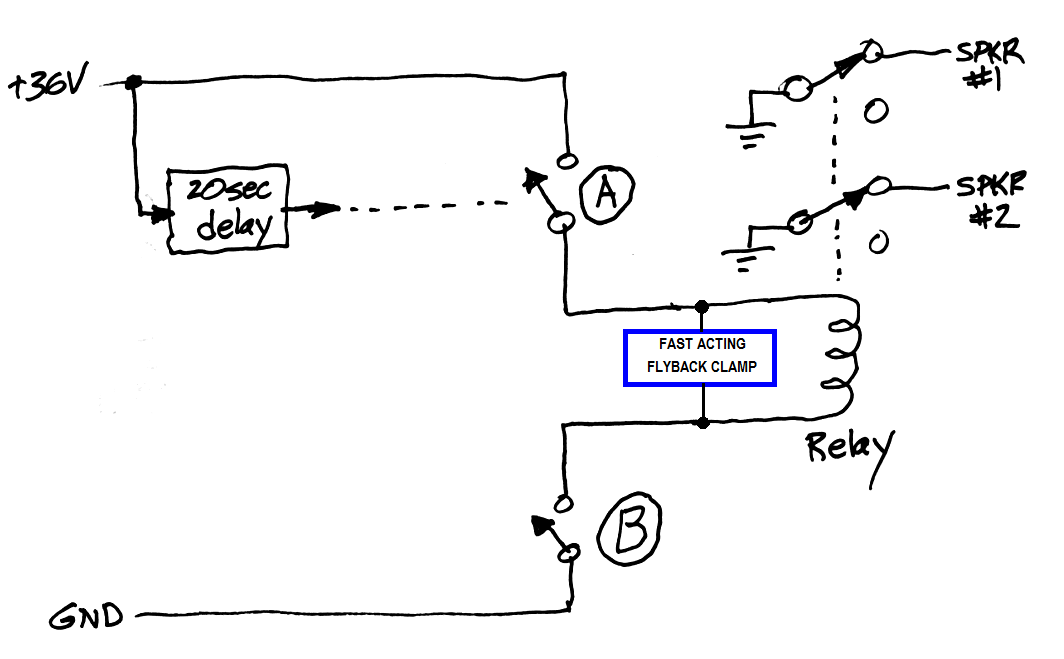

One simplistic design concept that mutes immediately at power-off, but does not un-mute until 20 seconds after power-on, is diagrammed below. It's a conceptual logic network (not a real circuit), whose timing diagram is beneath.
PWRGOOD is high when the +36V power rails within the amplifier, are at +36V. At all other times, PWRGOOD is low.
The PWRGOOD signal is sent through a 20 second delay line, whose (delayed) output is labeled XX.
PWRGOOD and XX are applied to a digital logic AND gate, which tells the muting relay to stop muting the speaker outputs. The AND gate creates a digital signal named UNMUTE.
At power-on, PWRGOOD goes high but XX remains low. Thus UNMUTE = AND(1,0) remains low. 20 seconds later, XX goes high. At that point UNMUTE = AND(1,1) and it goes high. The muting relay is engaged, the speaker terminals are no longer shorted to ground, and the amp starts playing music.
At power-off, PWRGOOD goes low but XX remains high. Thus UNMUTE = AND(0,1) and it goes low. The muting relay is released, the speaker terminals are shorted to ground, and the amp stops playing music.
A conceptual implementation is shown in figure 2. In this figure, the logical AND function is implemented by connecting two switches in series with the relay coil. The relay coil is engaged only if switch_A is closed AND switch_B is closed. {practical implementations are quite a bit messier than this drawing; what's shown here is only the basic idea, not the grubby reality}

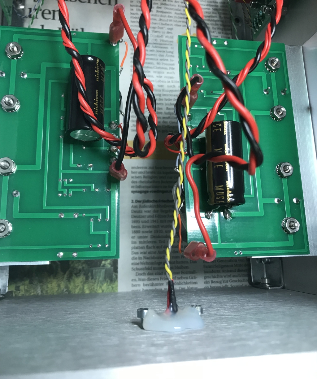

Bypassing C1 in output stage (output coupling cap)
Just wanted to talk about my experience with bypassing the output coupling cap on the VFET board, the big 10mF Rubycon, C1.
My initial listening impressions with just the standard 0.33uF WIMA MKP2 bypass cap have been here:
https://www.diyaudio.com/forums/pas...y-vfet-pt-2-channel-build-14.html#post6752665
After a few days, that impression still stood. However, I wanted to try bypassing C1, and when the Nichicon Muse ukz 1000uF 50V arrived, I soldered those below board to bypass C1. With 8R loudspeaker impedance, the -3dB frequency for the Nichicons alone would be 20Hz, so already active in the bass and no phase shift to contend with from 200Hz on.
Soo ... the first listening impressions were not very impressive. No real improvement, in fact I thought the music to be less engaging, and less transparent, slightly fuzzy even, compared to just the Rubycon. I thought that maybe two dissimilar caps operating in parallel could be blurring the impulse response because of differing ESR, resp. impedance.
So I was ready to take the Nichicon Muse ukz out again, but then also hoped that giving it some more time might change things, and couldn't make time for soldering either ...
And after about 5 days, the sound really did improve and started to become focused again, and after about a week, it seemed fully developed.
Clarity and 3D I think are even better than before, and my engagement with the music is there again.
The VFET N has developed to the point that even my F4, which I switched in for an evening, sounds a bit fuzzy in comparison, and that did surprise me ... 🙂
One more thing: I have the impression that the VFET N needs to be played a bit louder to fully develop its sound and bring the same engagement that I remember from my SissySIT at lower volumes already.
SissySIT is currently out of commission, in the chassis is the F4, the boards are pillaged to use parts for the SissySIT R.3.
Those boards are actually ready; just need to do some distortion measurements on the F4 before I dismantle that one and put the R.3 boards into that chassis. When the R.3 works, I can compare again ... 😀
Regards, Claas

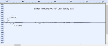

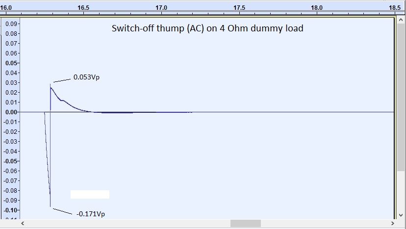

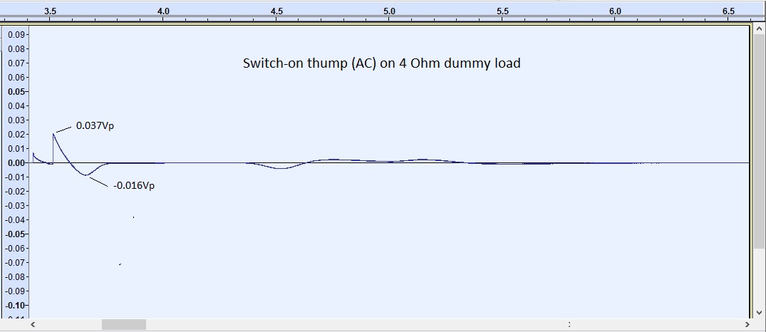

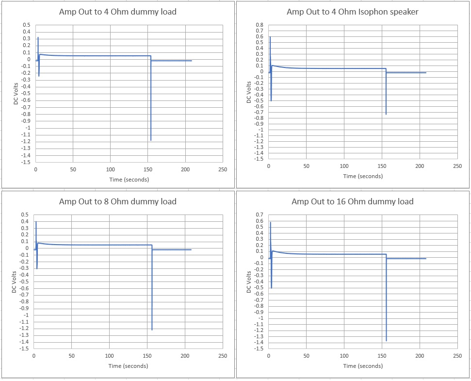

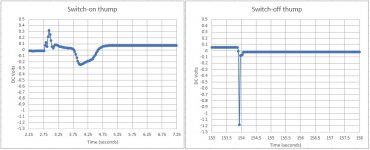

Switch on/off thump
This is what I measured on my build.
First and second attachments are through a soundcard (M-Audio Audiophile USB) 48kHz/24 bit
Third and forth are through a DC data acquisition module (DATAQ DI-148U) 240 samples/sec
When close listening with sensitive Isophon speakers (~ 94db sensitivity), switch on thump was barely detectable. Switch-off thump was noticeable but benign.
I don’t see a problem there.
George

Yes quite a few Nchannel VFET builders are perfectly happy with their amp as-is, and report either no thumps at all, or acceptably small thumps. But there are a few unlucky people who report big thumps that they find highly objectionable.
Here's a little thought experiment: what would be the effect upon the switch-off thump, if DIY Danielle's capacitor C7 happens to be 11.5 microfarads (15% above nominal) instead of 10 microfarads? Would her thump get louder? softer? unchanged?
(Everyone who hears thumps, reports that the switch-off thump is louder than the switch-on thump; which seems to match the voltage waveforms shown in post #551)

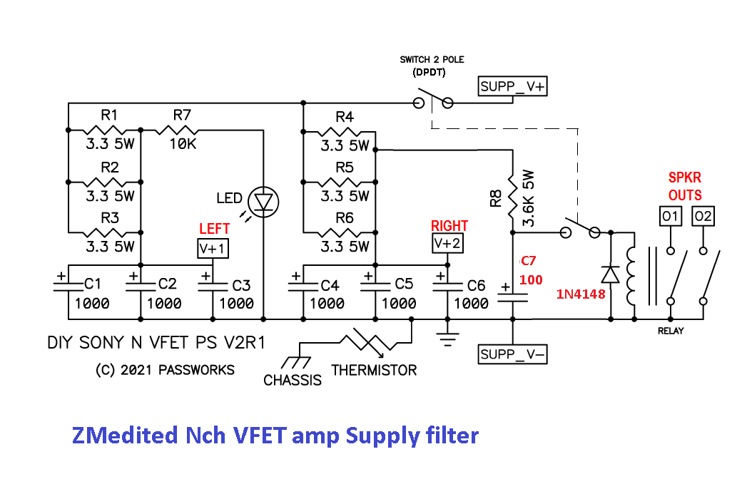

ZMedited Nch_VFET_supply_filter
oh boy
am I wrong, having an impression that suddenly obtaining DPDT switch is greater problem than >winning a Lottery, paying for Ultrarare Goods and actually building it < ......
anyway, nothing wrong with the kiss, boy ......
switch name - I'm always confused with throw and position
, so take DPDT just conditionally ........ two sections, simple ON-OFF - that coincides with my logic

Actually, I thought of that ... but in the form factor that fits in the cutout of the VFET chassis, I did only find DPST switches of adequate DC current rating.
The DPDT switches I found did not have a DC current rating I had been comfortable with.
So, I'm leaving it as it is with the DPST ... my turn-off thump is there but not too bothersome 😛

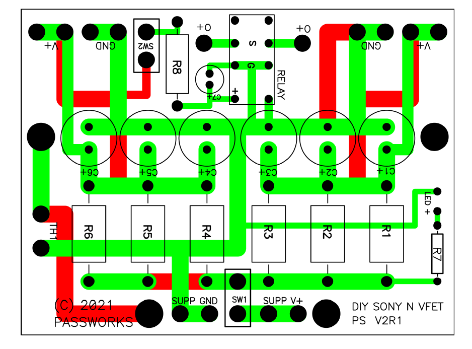

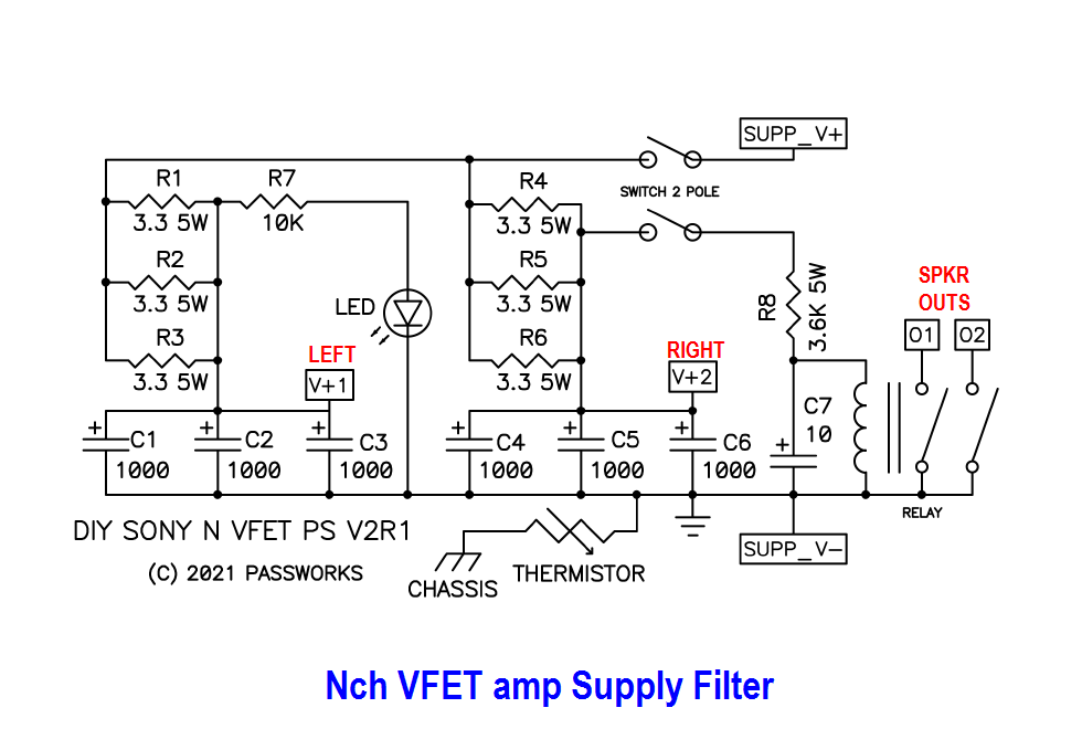

ZenMod, here's the existing PCB layout of the Nchannel VFET supply filter board that builders received. Maybe you can show the locations where your modifications in post #553 need to be made?
Perhaps such as: cut copper trace at location1, scrape away soldermask at location2, solder switch wires to location3 and location4, recommendations like those.
