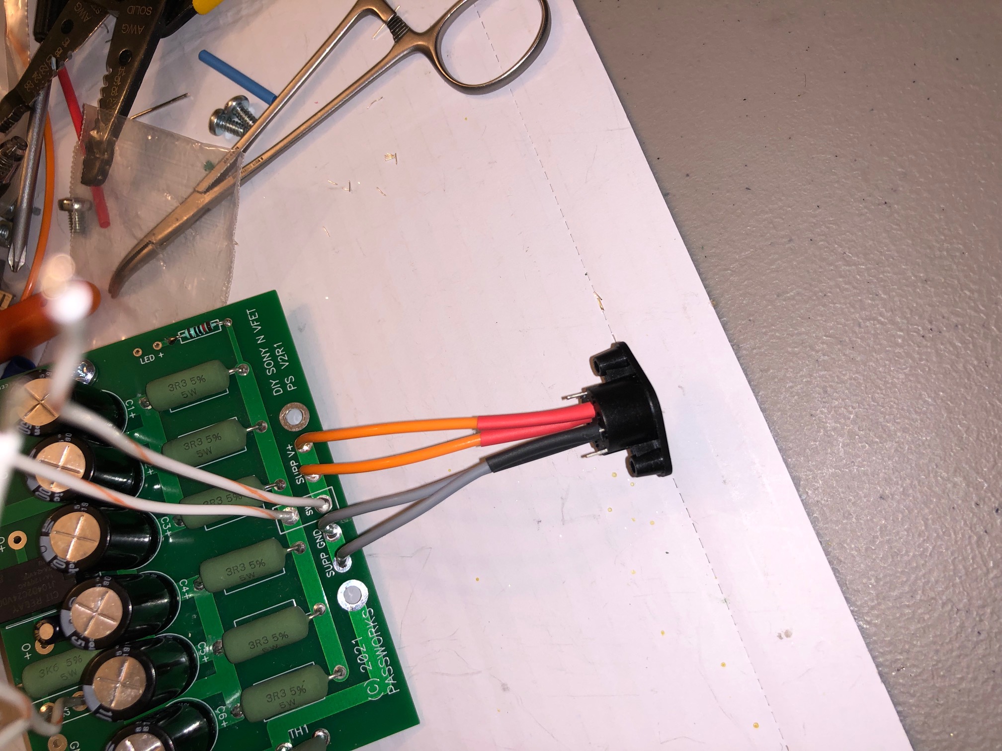

I think the colors and gauges are off, but otherwise it was correct for me. I ended up leaving the O+ connections to the PS board off, for a couple of reasons. If you wire them, I don't think they need to be 18 AWG. Without, there is only a single thump right at turn-on, not too objectionable.
I might try posting some suggestions for colors and wire lengths, but no promises if and when. Sorting that out took me the longest amount of time.
P.S. I'm referring to the wiring diagram by Nelson in the N-ch PDF, not in the build guide which was for the P-ch.
Ah yes!
Nelson's updated doc made it all clear!
As 6L6 put it in his guide, the wires colors aren't anything but colors 🙂
Now comes the tedious part, putting the whole together, making sense, a nice layout and more importantly, no goof!

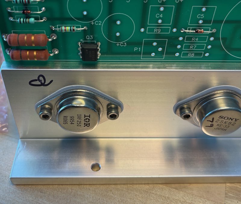

I noticed a dent in one of the IRF250's.
Does this look safe to use?
Thanks,
-BB

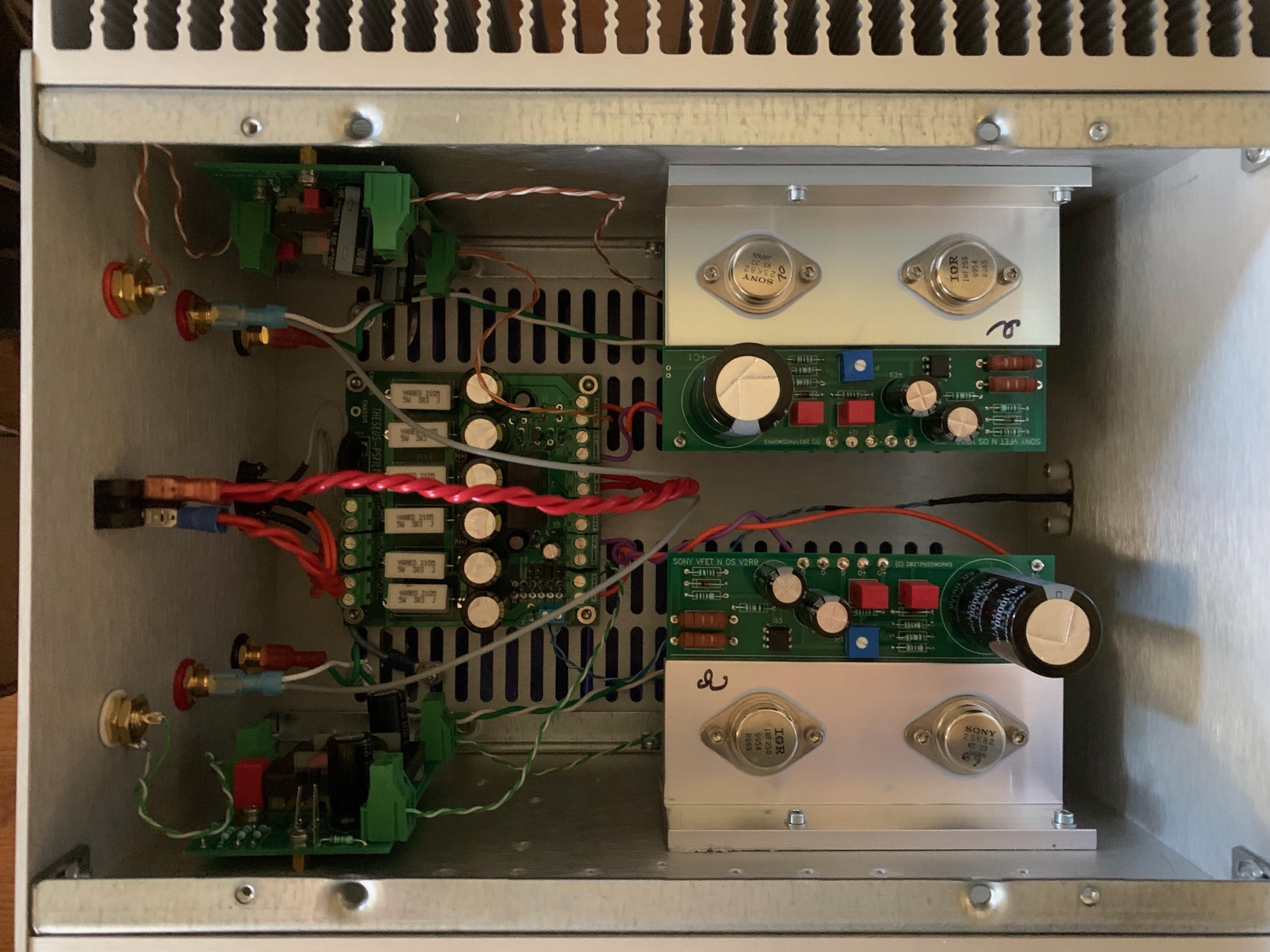

A Test and Review of the Theseus-PSFilter Board for Sony N-Channel VFET Amps
I finished the Sony N-Channel VFET amp a few weeks ago (#138). I like it very
much but one thing I noticed right away was that when turning the amp off, I
would get a fairly loud pop from the speakers. It wasn't really the typical
bass thump but had a very sharp attack, sort of like a higher pitched snare
drum hit. I haven't noticed any thumps or pops when turning the amp on.
Mark Johnson was kind enough to supply me with one of the Theseus-PSFilter
boards for testing to determine how it would affect the turn on and off
thumps/pops.
See post #461 for an introduction to the board.
On the board provided, the 10 sec. jumper (third quickest, I think) was
installed by default. I didn't change it. I was careful to not touch the high
impedance areas of the board at all during the installation.
In this case, the amp is connected to KEF Calinda speakers for which the specs
say they are only 83 dB/W at 1 M efficient. The preamp is a B1-K. The amp is
also plugged in via a wifi smart plug.
After installing the board and powering up the amp, I heard only the relay
click from my DAC. I heard nothing from the speakers. The sound output to the
speakers was muted, it could be heard very, very faintly, for about 12 or 13
seconds then, it unmutes and plays at normal volume. I can't remember if there
was sound at normal volume with the original board immediately after turning it
on. I think there was.
I tried turning off the amp after a few minutes and the pop I heard was greatly
reduced. It wasn't much more than a blip where with the original filter board,
it was loud percussive pop or rap. It was turned off via the wifi smart plug
that time.
After listening to the amp for about 12 - 15 minutes, a sharp pop occurred and
sound was muted for about 5 seconds and then came back on. It hasn't done that
again since. I don't know what caused that.
After letting the amp run for another 50 - 60 minutes, I tried some more power
ups and power downs. When powering up or down with the wifi smart plug, I don't
hear any thumps or pops at all on turn ons. On turn offs, I hear the faintest
of pops, not worth even thinking about. When powering up and down with the rear
switch, no pops are heard at all.
Thank you, Mark. Nice work!

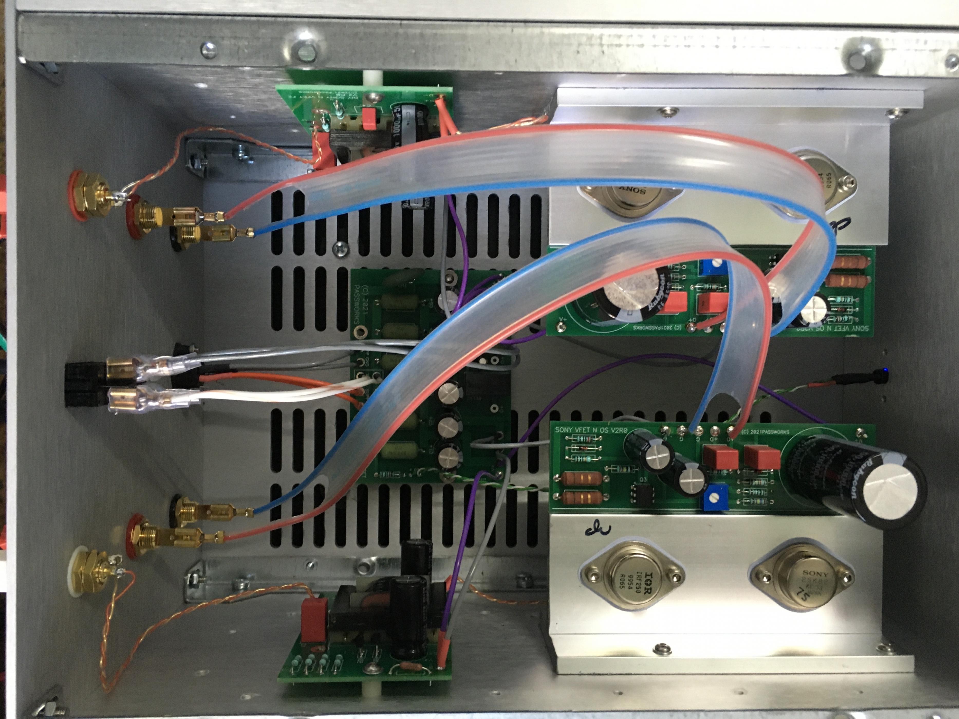

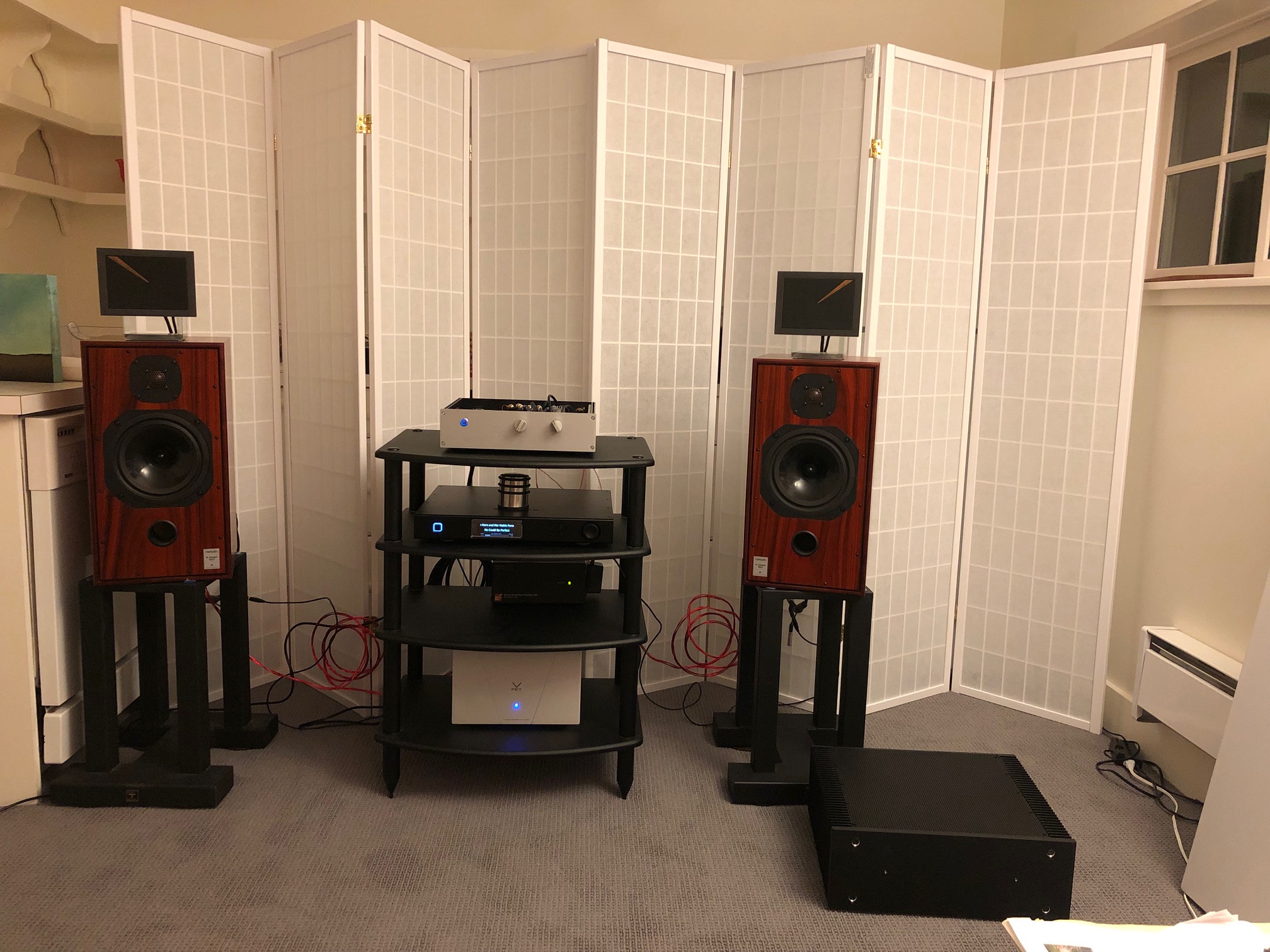

Proud to announce that #143 has been birthed after an uncomplicated labor.
Many thanks to Nelson Pass, Jason, 6L6, ZM and Mark Johnson. Your generosity with your time has been impressive. (as has many others).
The amp sounds great with a musicality and resolution that was surprising for 10 watts. Guess you really only need one really good one.

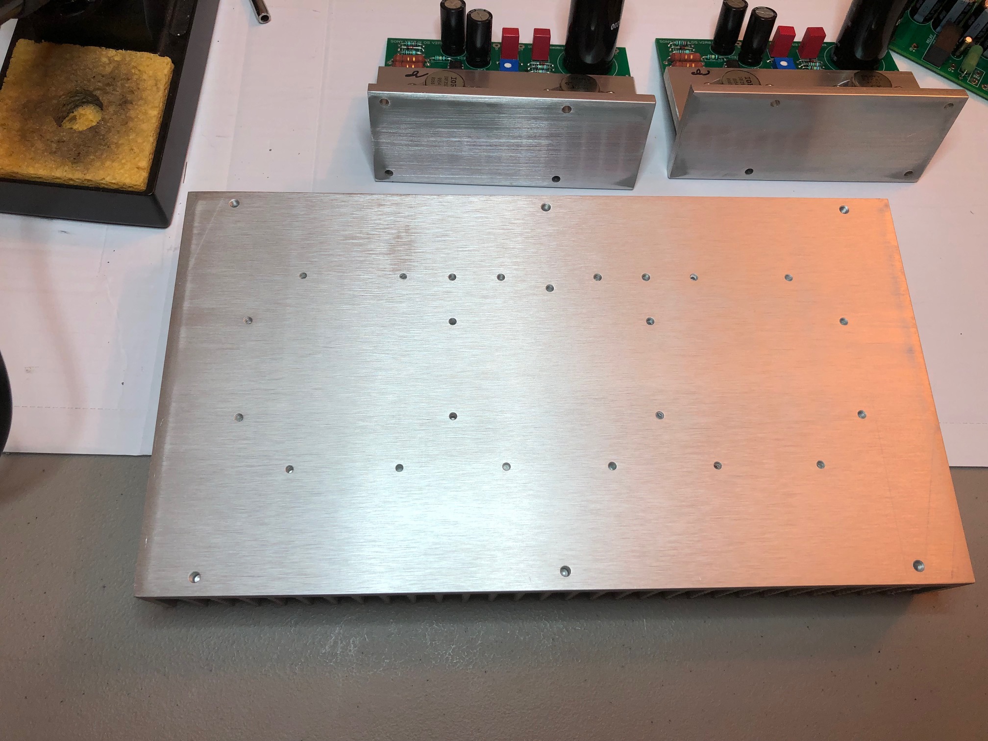

My heat sinks were generally flat but lapped them for good measure.

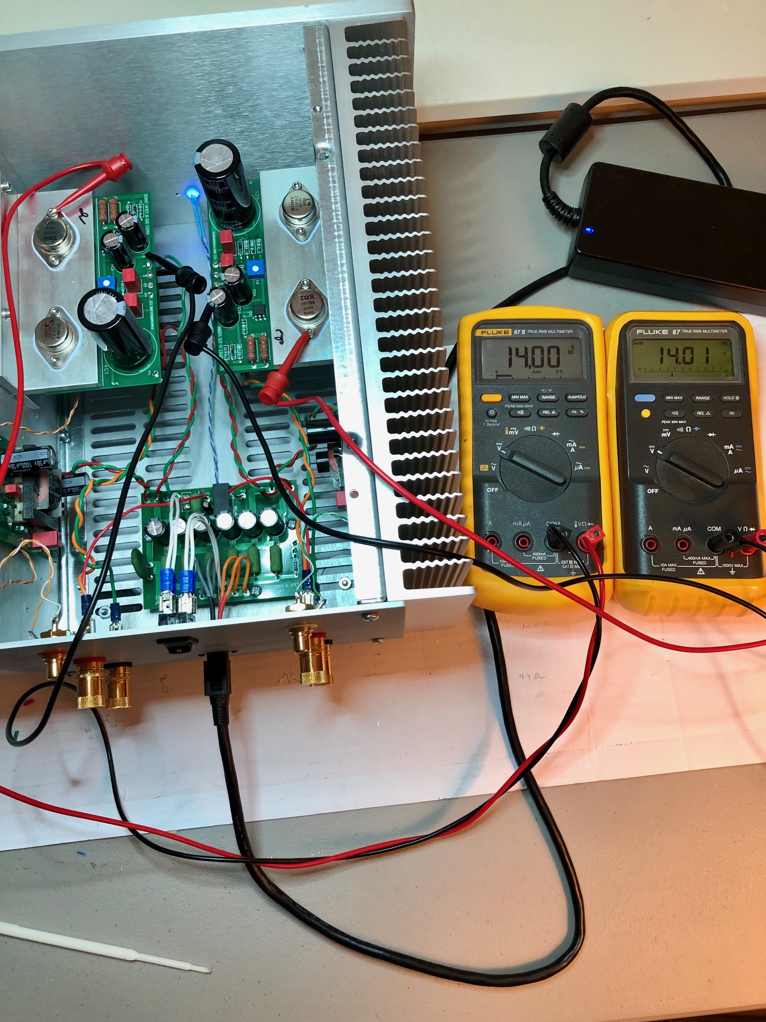

Had a few observations and questions about amp behavior as mine seems to differ from some already built.
1. Wasn't sure with SMPS if dim bulb tester was necessary. Tried it and learned that the bulb would glow and dim and glow and dim, but SMPS wouldn't operate. SMPS worked fine when dim bulb tester taken out. Should I assume that the protection circuitry in the SMPS might protect some uf us from letting out the precious "magic smoke" that makes all of this possible?

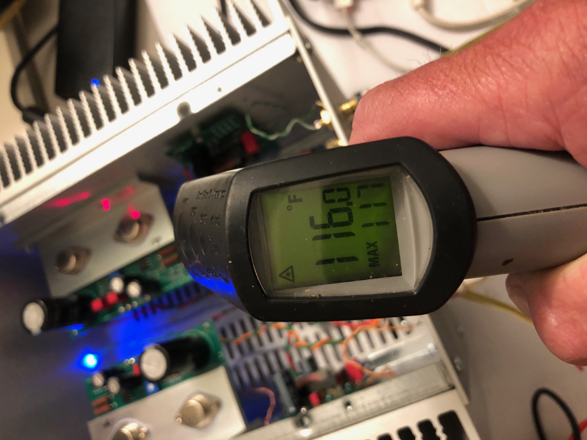

2. Set the bias from Case (drain) of IRF250 to 14V. Was surprised that my operating temp has been much cooler than others. After 10 hours heat sinks are only 120F- Blimey hotish. Could keep my hand on sink for 10 sec or more. Curious if better heat transfer or other reason for cooler operation.
