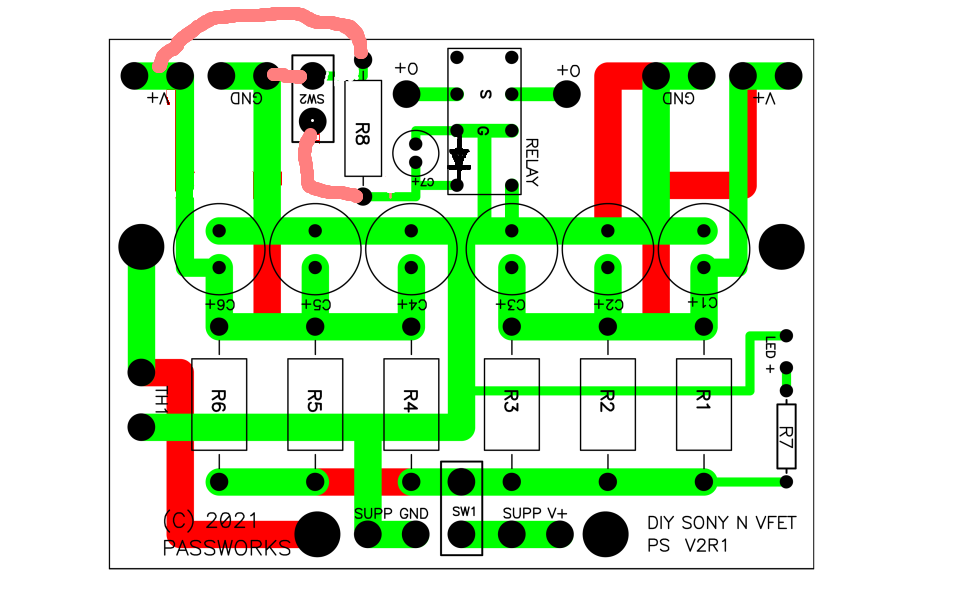

ZenMod, here's the existing PCB layout of the Nchannel VFET supply filter board that builders received. Maybe you can show the locations where your modifications in post #553 need to be made?
Perhaps such as: cut copper trace at location1, scrape away soldermask at location2, solder switch wires to location3 and location4, recommendations like those.
_
I can't, if Boyz are not having definitive solution for obtaining adequate dual section, simple ON-OFF switch
in case of Boyz having definitive consensus regarding switch, I'll be more than happy to make short and sweet tutorial
You leave the wima in place too ??
Yep, Wima MKP2 0.33uF is still there.

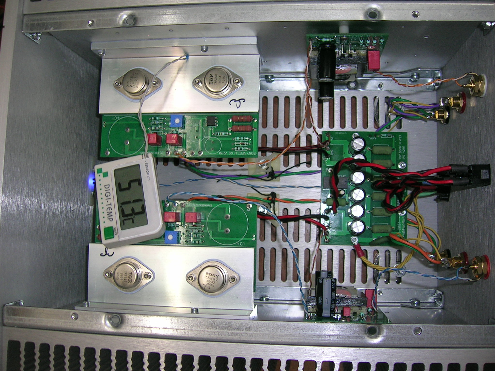

Number 131 is up and running. I managed to build it in record time, at least by my own standards. I left out the front and and am running it currently directly connected to my Yamaha streaming DAC as a power buffer. My loudspeakers are Avantgarde Acoustics DUOs with 104 dB sensitivity, which is why I usually have way too much gain in my system.
What I can say so far is that the amp sounds great, a little brighter than my ZEN V4 but without sounding harsh; the ZEN V4 in turn has more bass slam. The Sony may possibly have a little more resolution than my V4, but the differences overall are relatively small. Voices sound particularly captivating, maybe more so than with the ZEN, but again I am not sure yet.

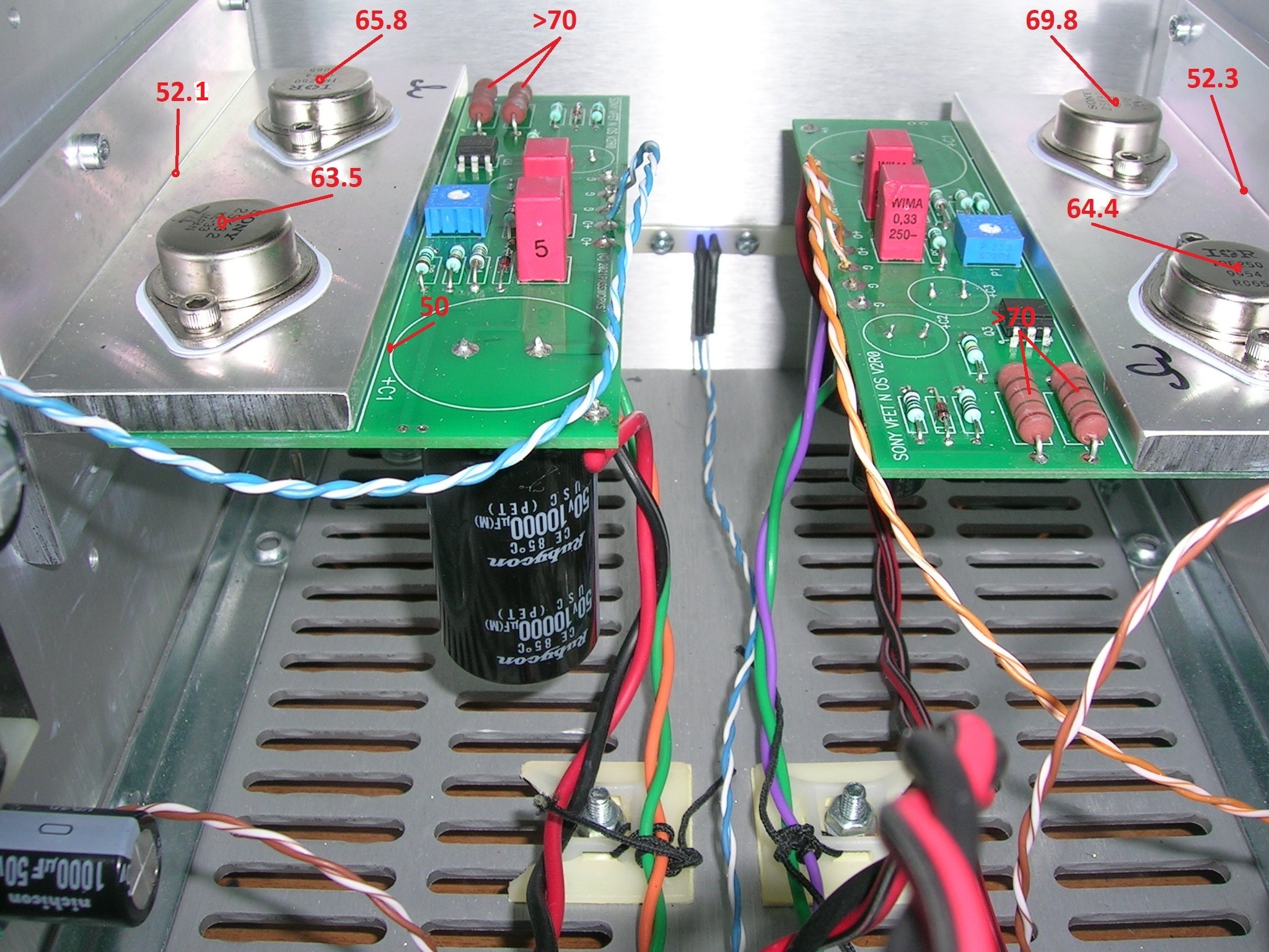

I noted that caps on filter psu are heating a lot ,maybe some hole under resistor is a good thing ,but I put a paper as shielding and work quite good....just try

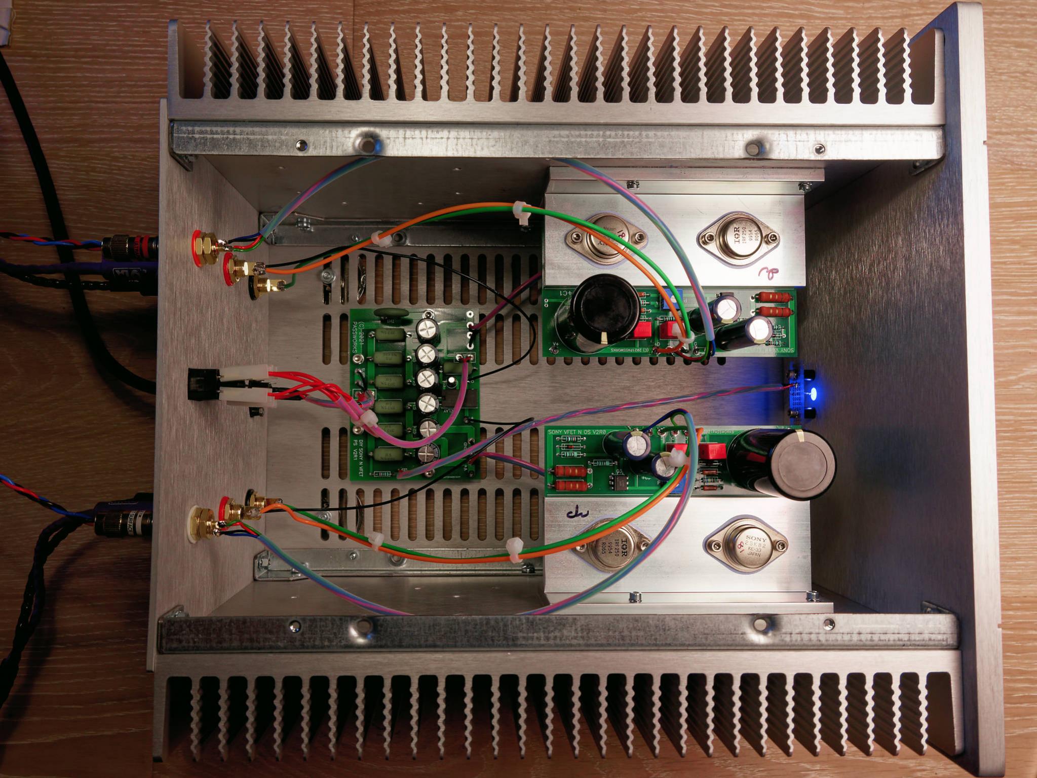

Hallo Martin,
how much hum can you hear on your Avantgardes ?
With my 100 dB/W Jericho Horns (Fostex 208 Sigma), I can hear a tiny bit of hum up to 20-30 cm away. My room is unusually quiet, however.
Regards, Claas
Regards, Claas
Hello Claas,
Remember that I do not have the front end, I can only turn the volume of my DAC up to 0 dB (and off course no music playing 😀 ), which would be about 10 dB above my usual listening level.
Then I cannot hear any hiss or hum whatsoever in the left channel, in the right channel and with the ears on the sub-woofer I can hear some very faint hum overtones or rectifier hash, but after unplugging the cables this is still there, so looks like the plate amp is producing this noise.
P.S.: I tried to minimise loop areas of the cables by placing each pair of leads as close together to each other as possible, keep the power supply, input and output cables as far away from each other as practical, and the input cables are star quad cables (taken from Sommer microphone cables and without the shield as that does not protect from magnetic poickup anyway). Also, I have no transformer that can pick up hum.

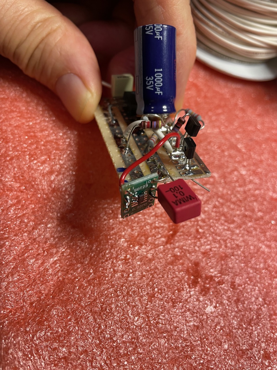

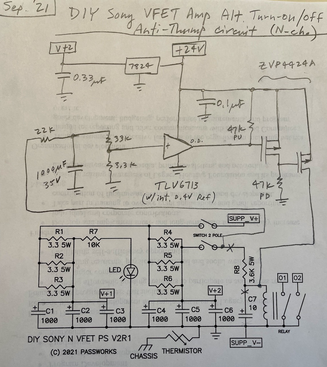

My take on the turn-on/off anti-thump circuit:
The turn-on thump for me is acceptable and I hear no turn-off thump, but I decided to redo that circuit anyway. Now there is a kludge glued tenuously to one OS board and its own wires. Maybe I should have at least put some blue LEDs on it!
But here it is, which separates the relay from the RC. I wanted to stick with the existing relay on the PS board, which meant driving it on its high side, since once side is grounded.
Turn-on delay is now about 3 seconds and the supply discharges quickly to de-energize the coil at turn-off.
More details on request.
