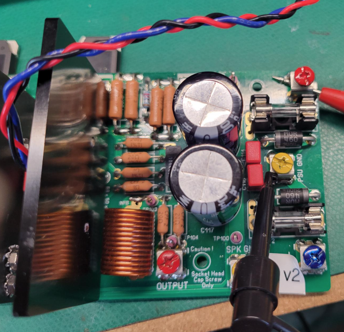

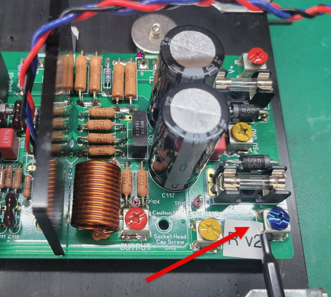

You don't say explicitly - but assume you mean it "beeps" when you test between middle pin and heatsink? If so, then you have an issue with the PNP's being isolated. First thing to check, is unattached to the heatsink, is there continuity to the GND, either input or power. Second would be to make sure the insulators aren't cracked or punctured.
I've tried several mica parts and get the same result: middle pins of PNP beep. I've ordered another supply, maybe they are a bad batch, but I doubt it since the short pattern is so defined: NPN only, middle pin only.
When testing for continuity I get from PSU gnd to V+ 1.719v, V- 0.452v, output 1.55v.
Spk gnd to output 1.555v, to V+ 1,650v, to V- 0.467v

did you removed J103? It was still populated on the previous post picture(s).
Also, measure these points in resistance mode on your DMM - that will tell you how close to a dead short (0.00) it is.

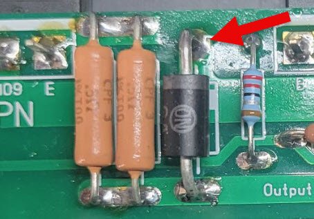

I removed J103. I'm not clear on what you want me to measure in the photo. Both 0.7r resistors are good. I discovered a short between the diode shown and the heat sink.
I also discovered a short between the PNP middle leg's and V-., but only that point, not V+,spk gnd, PSU gnd or output.

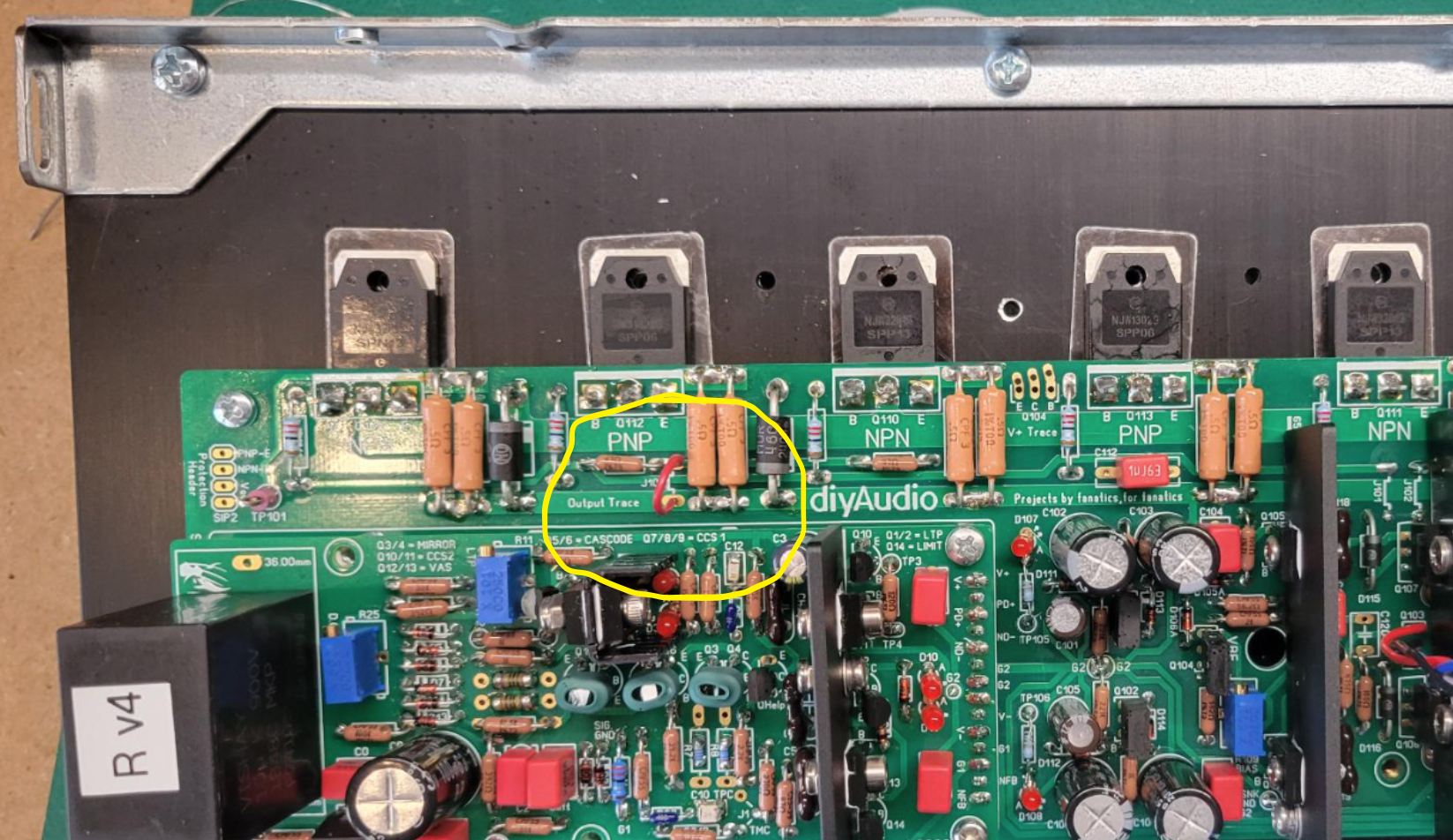

good morning from Crete,
today I applied voltage for the first time,everything seems to be correct except for a voltage that shows above (on one channel)
in the voltage between TP-105 (DMM -) and the positive power rail connection I have 4.8v
and in the TP-106 (DMM +) the negative sensor on the negative rail I have 1.5v.
with transistor C3503 / A1381
all other voltages are correctTP-1 (DMM +) and TP-2 (DMM -) .... 5.0 V
TP-3 (DMM +) and TP-4 (DMM -).... 610 mV
TP-100 (DMM +) and SPK GND (DMM -)....0.01mV
on R111A and R111B it is .......0.6V adjusting to 1.4v
what ? it is wrong .
thanks
