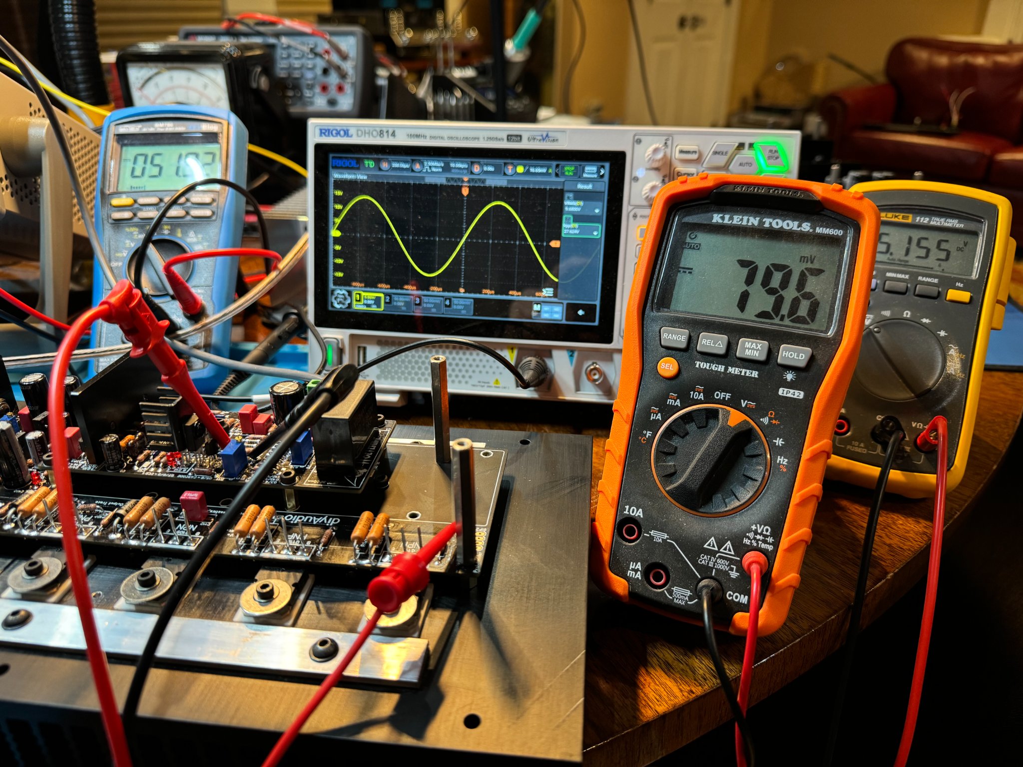

Tested the leads. Aok.
I powered up @30DCV 1A and biased to 44mV. All other measures on target.
Only question is, the POT orientation has seemed to change, e.g., yesterday I turned clockwise to maximum value, today its counterclockwise. Is there a scenario where this can happen? Haven't made any changes. I even have a Post it note "clockwise to maximum value." Today its the reverse. Last night I turned the pot many many times. Would that reverse things? Makes me nervous to return to full power.
You might need to check your carbon monoxide detectors 😛 That cannot happen from changing the voltage. You are either mixing the boards up (left right/up down etc) or mixing yourself up.

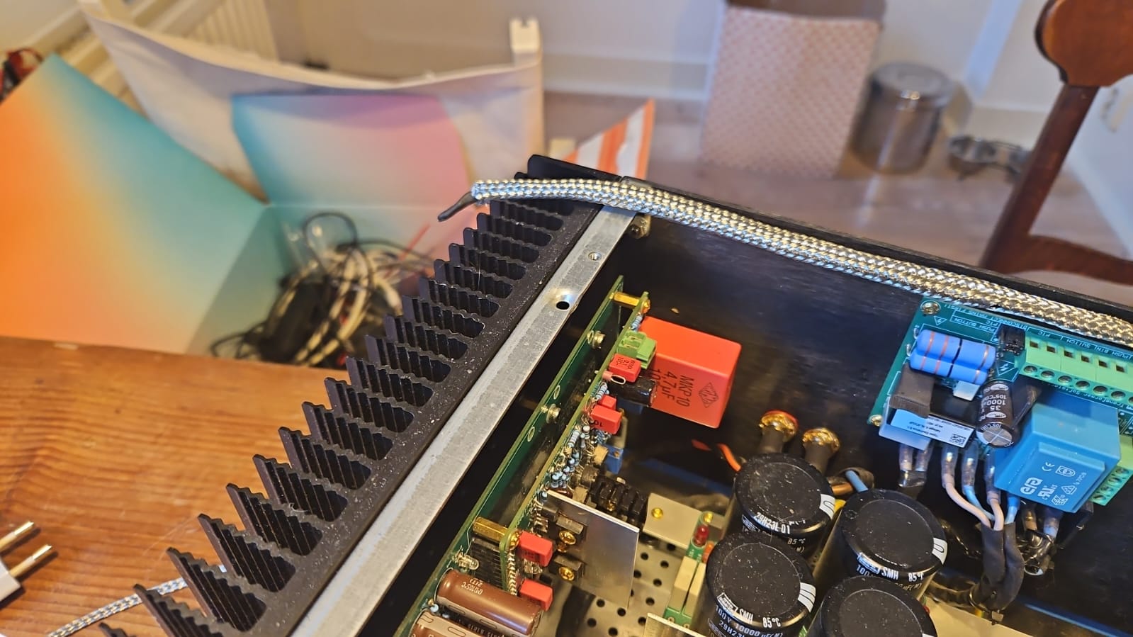

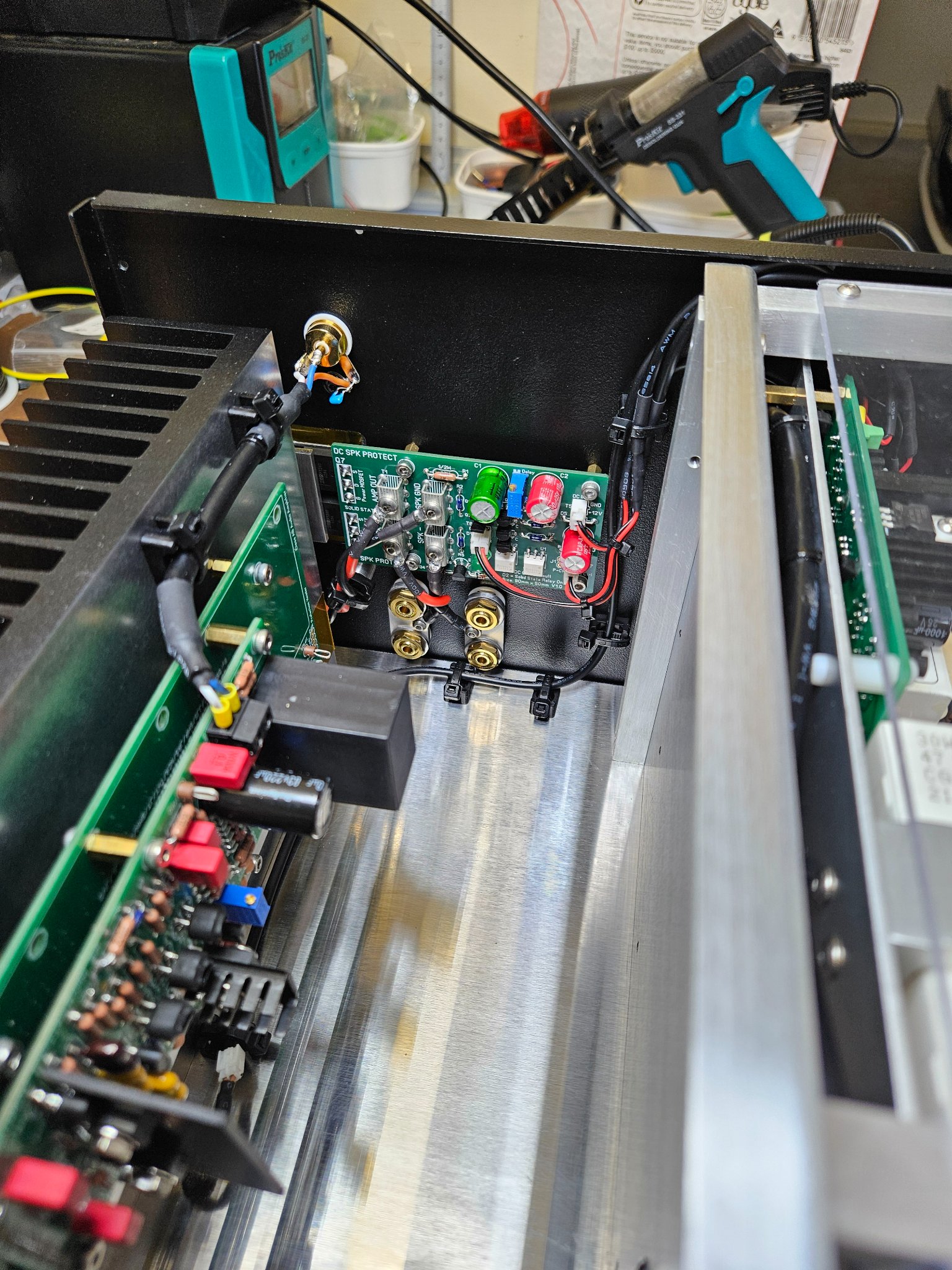

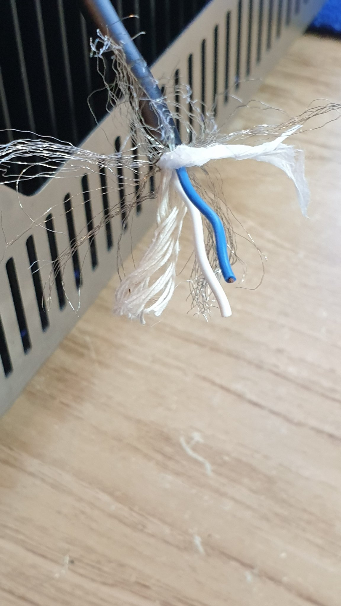

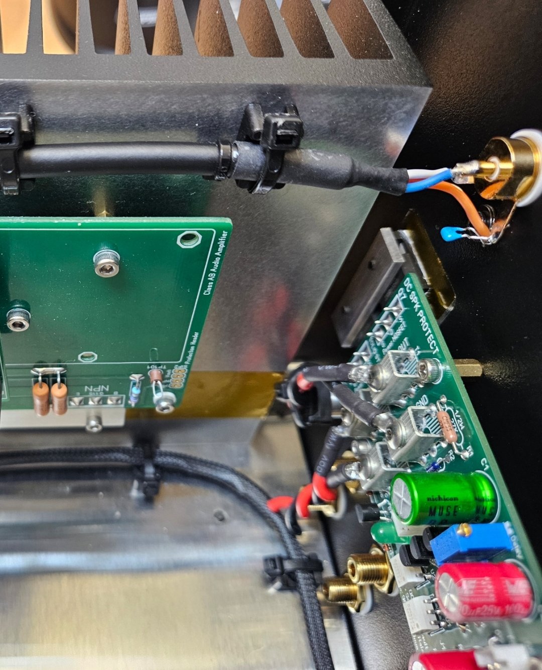

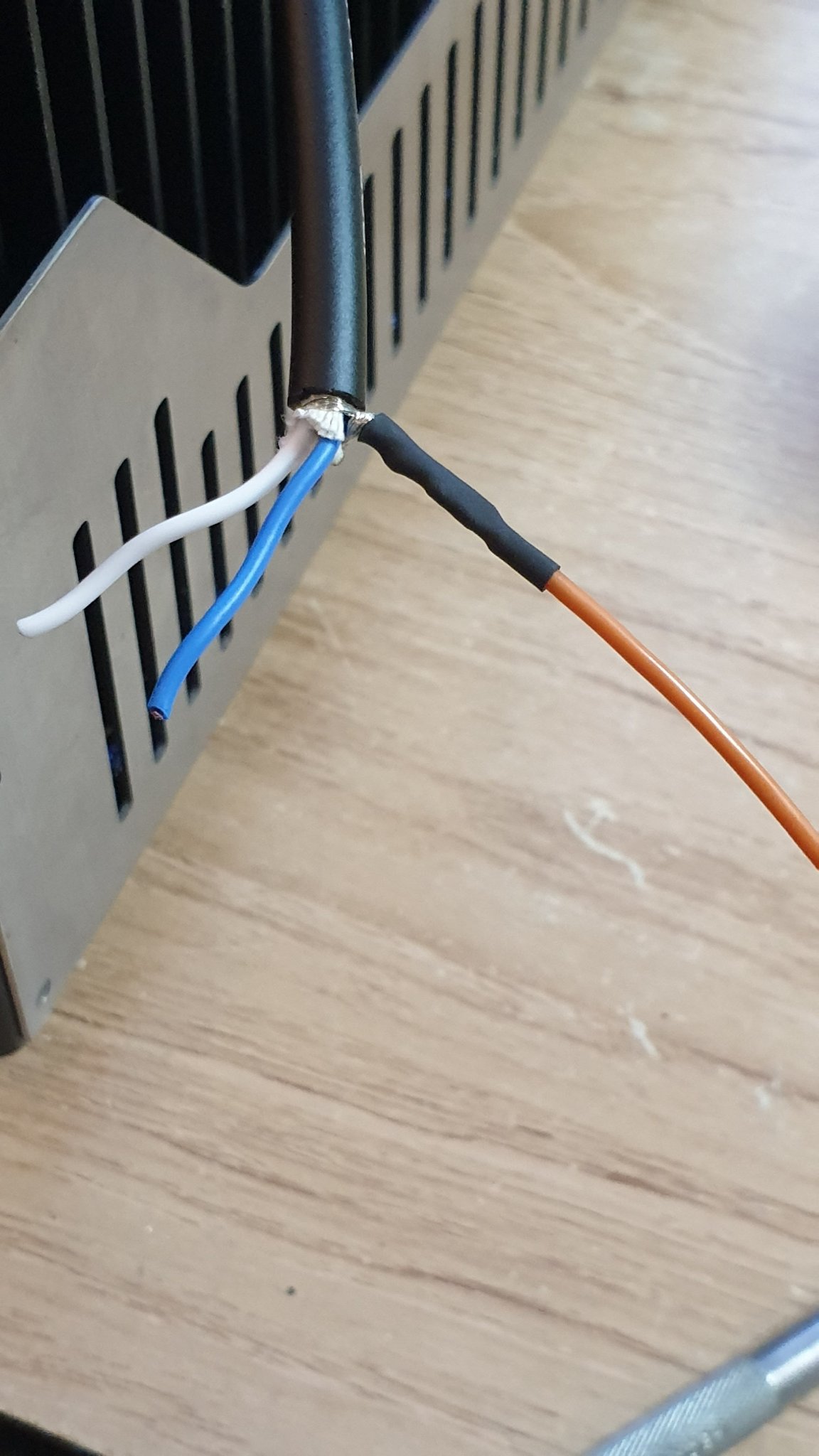

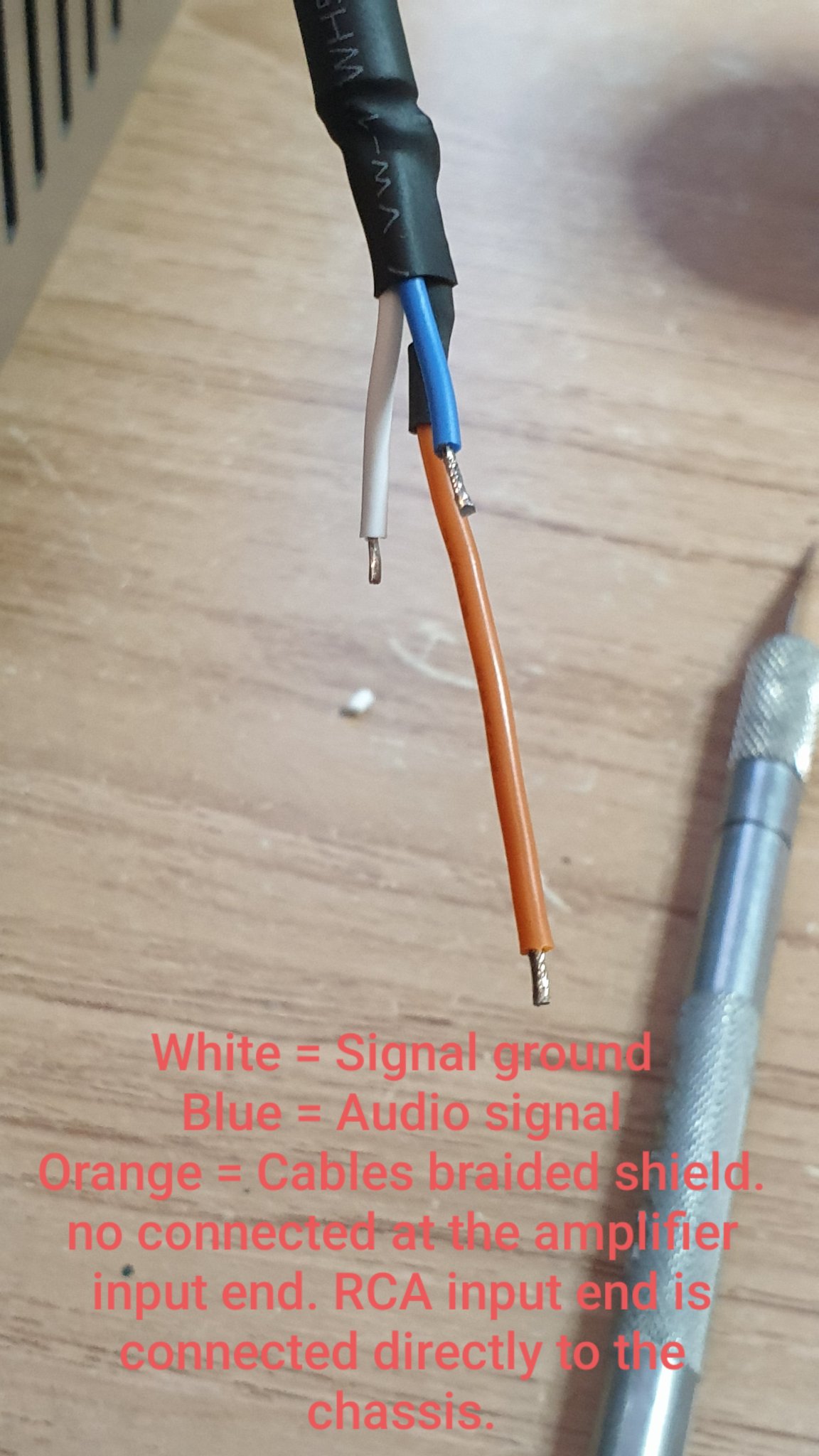

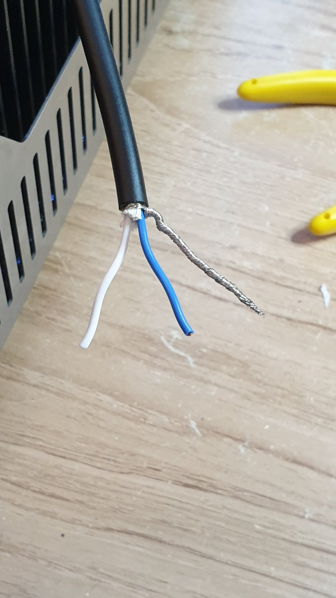

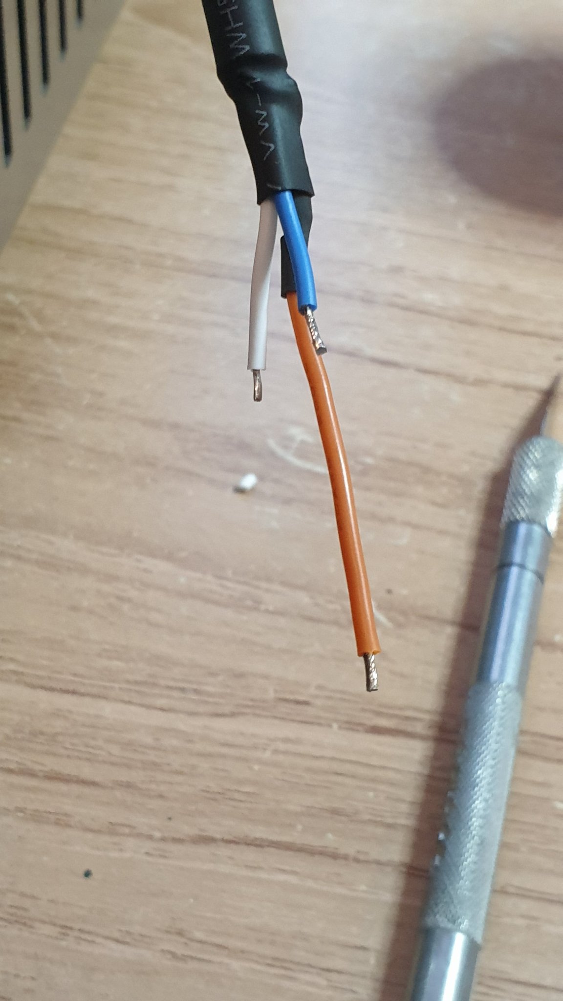

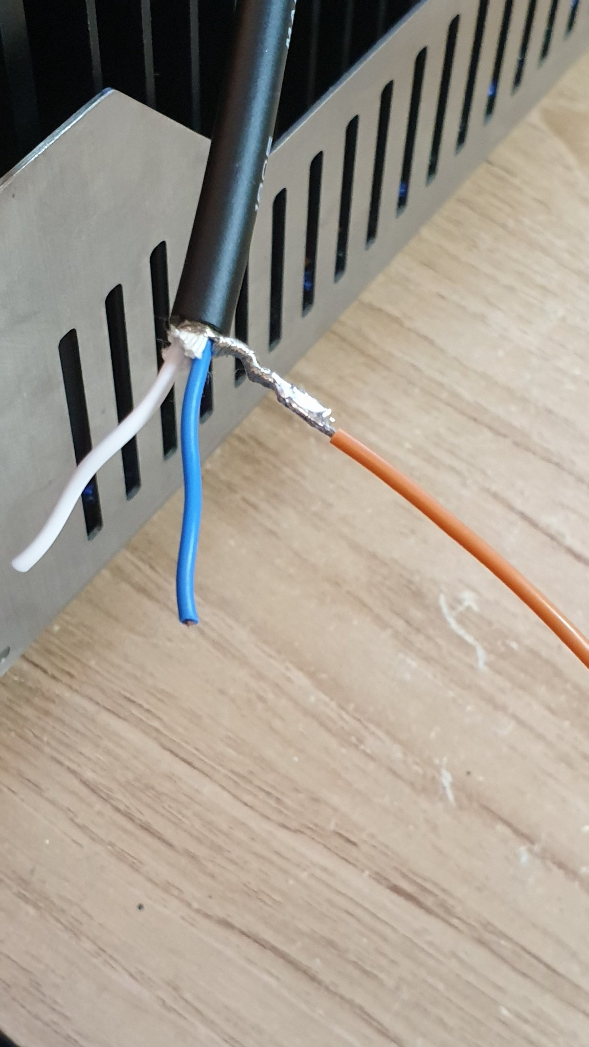

I know I've asked it before but I can't remeber or find the answer anymore🙂....One signal cable is running relatively close to the start current protector and when measuring the AC with the inputs shorted only this channel measures 0,12 mv which might be caused by the start current protector. My question is where do I connect the shield? On (-) of the signal or to the case itself?

I not 100% sure what your trying to do, but you can't have a braided shield that's touching the chassis.
The cabel you want to use is Canare L-2T2S
Please refer to my photos and notes on my build album.

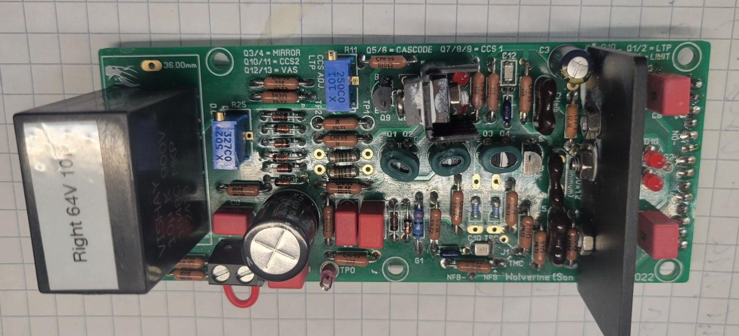

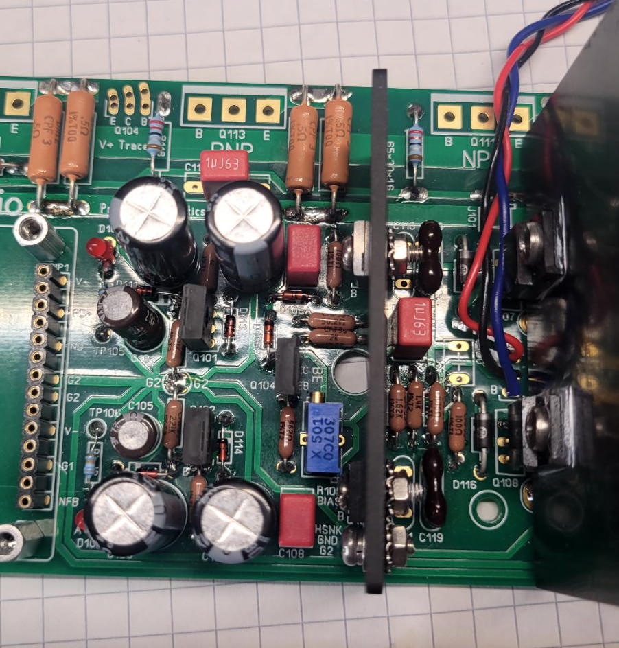

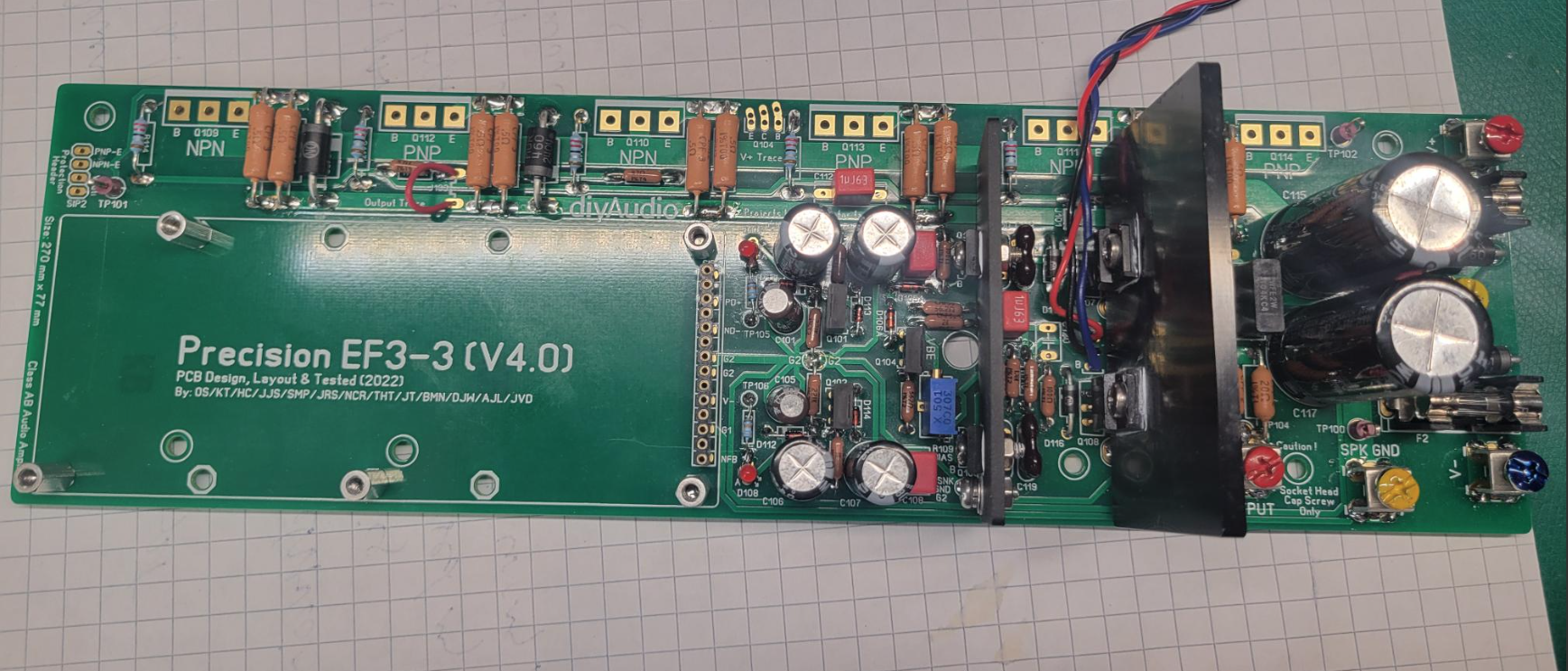

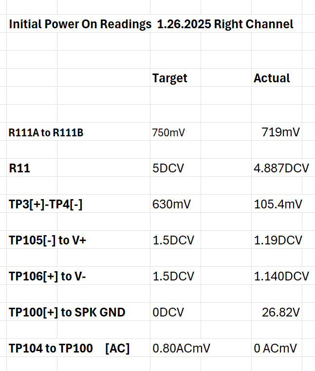

I have one channel working. I went back to my other channel. I tested it at 30DCV / .30A and all 6 Leds are on.
All readings are normal except for TP3/TP4 which should be north of 600mV but only shows 105.4mV. The other abnormality is I can't move R111A/R111B off of 719mV. I can't increase it or decrease it.
I have double checked all parts for correct placement and that they are functioning.
Something is amiss. Assume with all Leds working that indicates no issues with the transistors? Never say never but I am very careful to ensure correct deployment of each one.

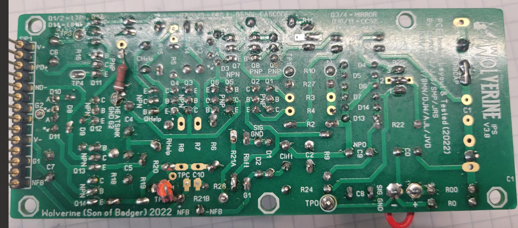

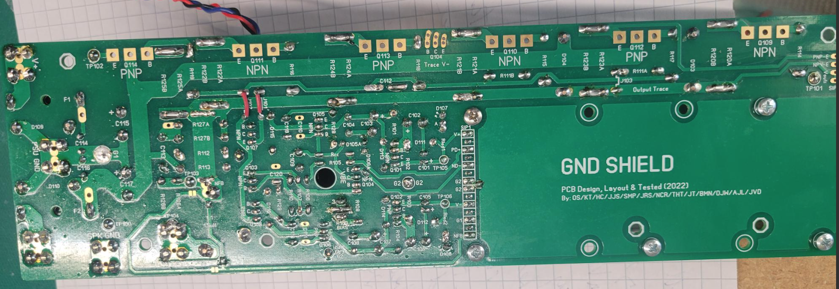

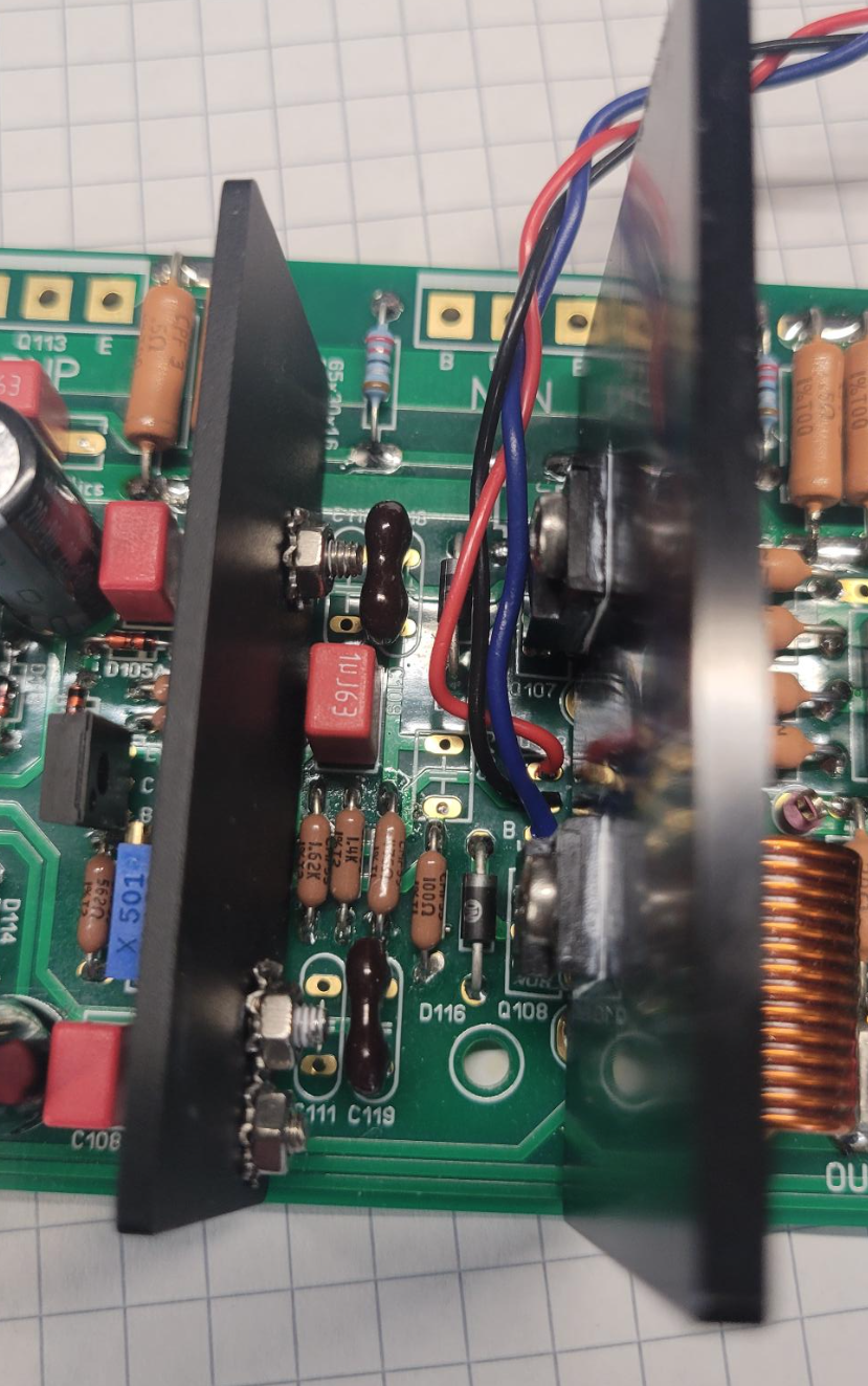

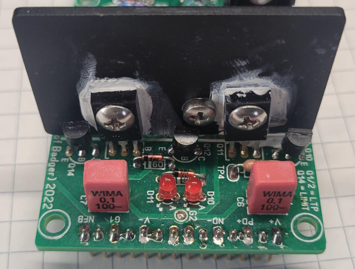

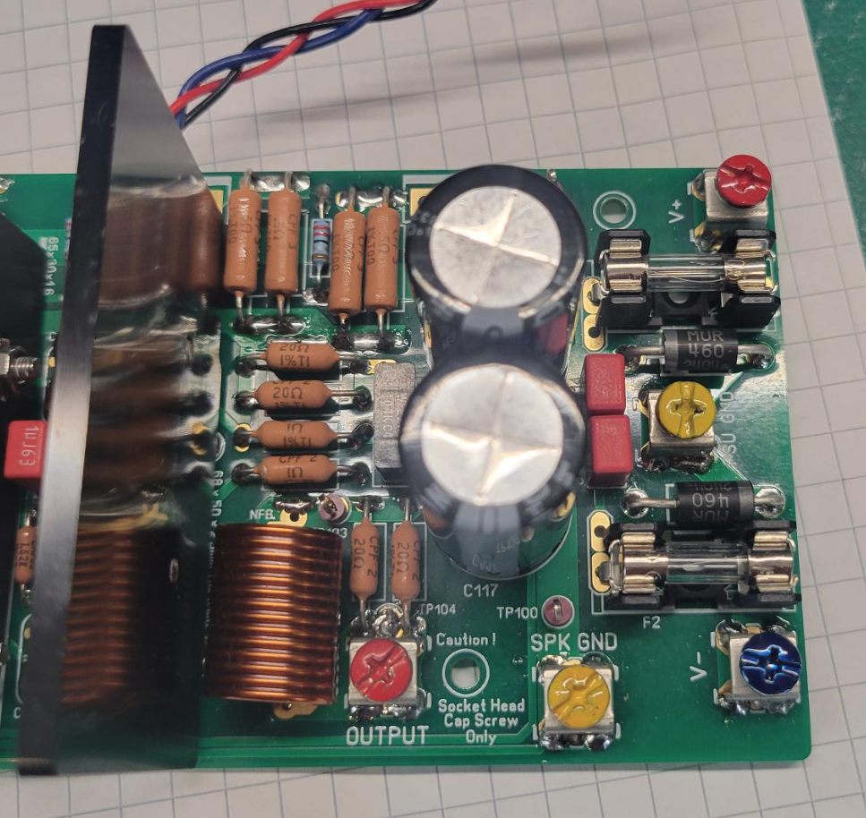

High res top down photos of the boards please, also 26V(DC?) on the output?? 😳
-26.82DCV is what the DMM showed. must have set the leds up wrong.
See photos and thanks.
clean this up - potential short between c10 and TPC

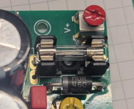

This V+ fuse gone? (thanks @stuartmp)
Remember when you are using a bench/lab power supply, it shows the voltages it is outputting, and also the CURRENT that is flowing through each rail. If one if those rails is at 30V but 0.00A , you have a blown fuse. If you have a short somewhere the bench supply voltage should tank to 0 or just above it and the current will be maxing out at what you've set it. (someone will correct me here, I dont use a bench supply but instead a Variac with DC ammeters on the rails of a spare small linear PS setup)
Either way - the speaker output should read 0VDC ideally, or +/- 100mV max so +0.1VDC or -0.1VDC max. The 100mV offset is trimmed back to 0.00 with r25 later. 26VDC means something very wrong.

Ok. Both fuses are working. Cleaned up - potential short between c10 and TPC. Speaker output is an issue. Got it. ThanksView attachment 1413721
