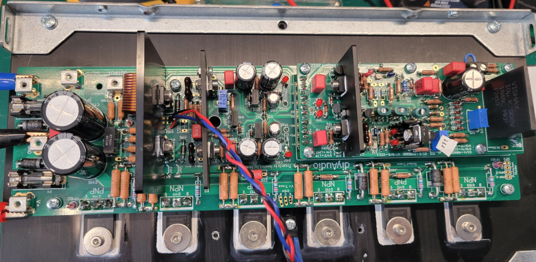

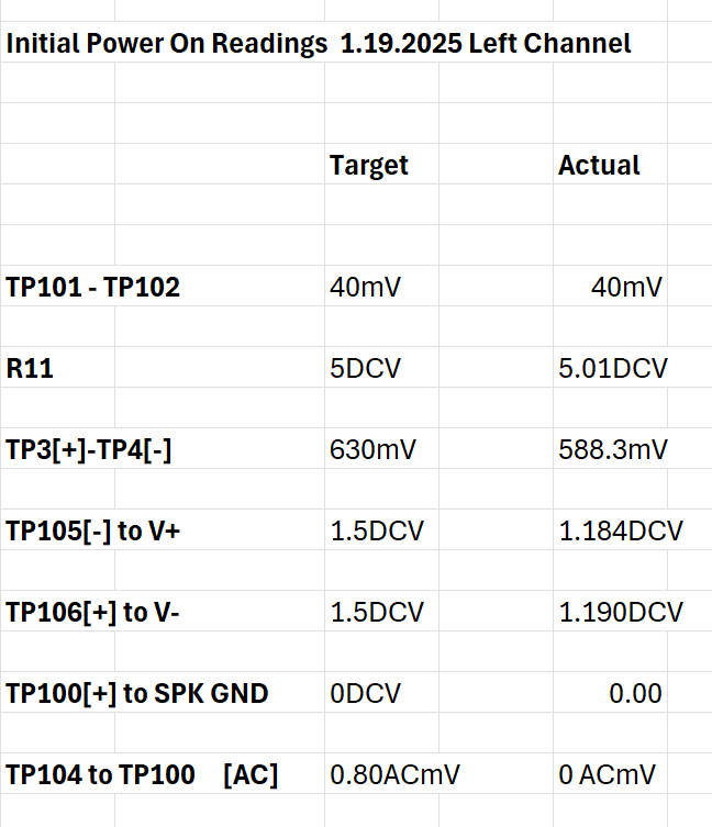

Been a good day. I have completed initial test with output transistors @ 30DCV / 1A. After 20 minutes bias held at 40mV.
I guess I'm ready for a full power test.
Thanks to all who have pushed me to this point.

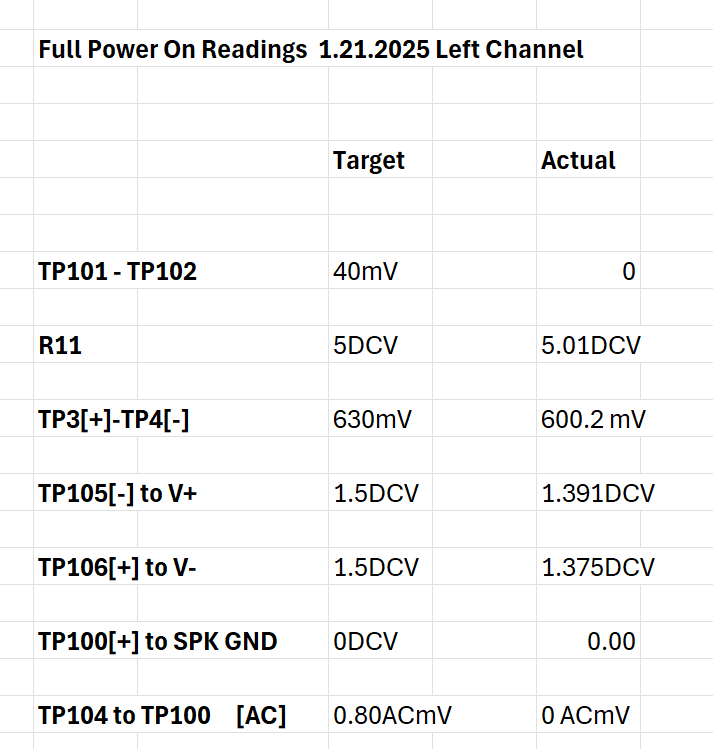

Full power test today. all LEDs working.
See measurements below, all on target except for biasing. After my 30DCV 1A test on Sunday, I dialed down R109 to the point where there was no reading, but not all the way down in preparation for today's test.
Today I dialed R109 up quite a ways and saw no reading on my DMM @ mV. I didn't dial it all the way and stopped to assess. I feel I turned it sufficiently to start to see a reading. I checked that the leads were in the correct place and good connection. I use my Fluke 87 for this measure. I didn't swap it out for a different DMM. I can try that. Or I can go back to the Rigol 30DCV /1A test where I achieved 40mV reading and see if I can duplicate it there.
Just don't want to blow anything at this point.
Appreciate all insights or suggestions.

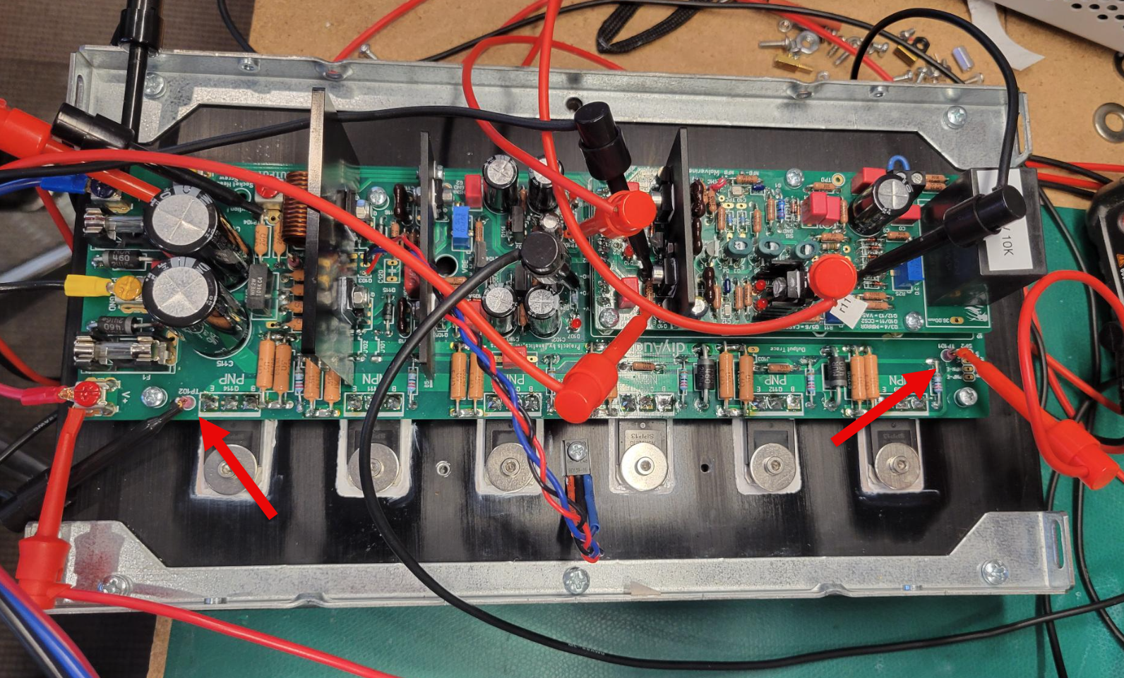

Show a picture of where you are measuring. That pot is a 20 turn pot. You may need to go further. When you get to the end of it's travel it will make a very faint clicking sound.
See leads on TP 101 and TP102.
Knowing that I had already turned the R109 pot to maximum value last night, I decided to turn the pot to the end or maximum value. But after 30 plus turns I gave up because I did not hear the faint clicking sound. This is weird.
I will replace it and return to testing with the Rigol at 30DCV 1A to ensure it is functioning before returning to full power.
Am I missing something?

You mentioned you removed R17. You're not being clear enough. Did you remove R17, or did you remove the temporary parallel resistor that is placed on R17 for low voltage testing.
For clarity
For 30V low voltage testing: You should have R17 installed (as BOM, matching the chosen rail voltage), and you should have a temporary parallel resistor installed on it.
For full rail voltage: you should just have R17 installed, and no parallel resistors.
Since you are getting good results at 30V, and no bias voltage at full rail voltage, I'm not sure if for full rail voltage testing you A) completely removed R17 in error, or you B) left the parallel resistor in accidentally. I cant see R17 in your picture above, but it may be obscured by the VAS heatsink
