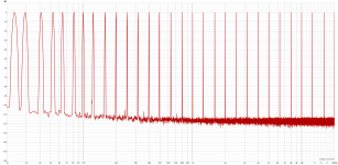

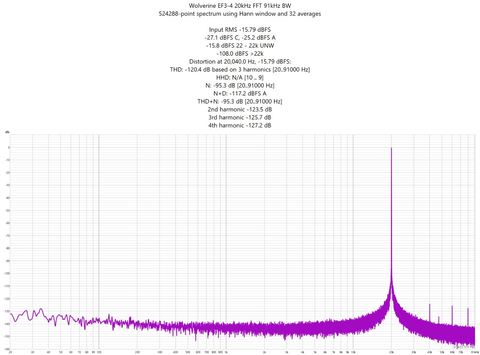

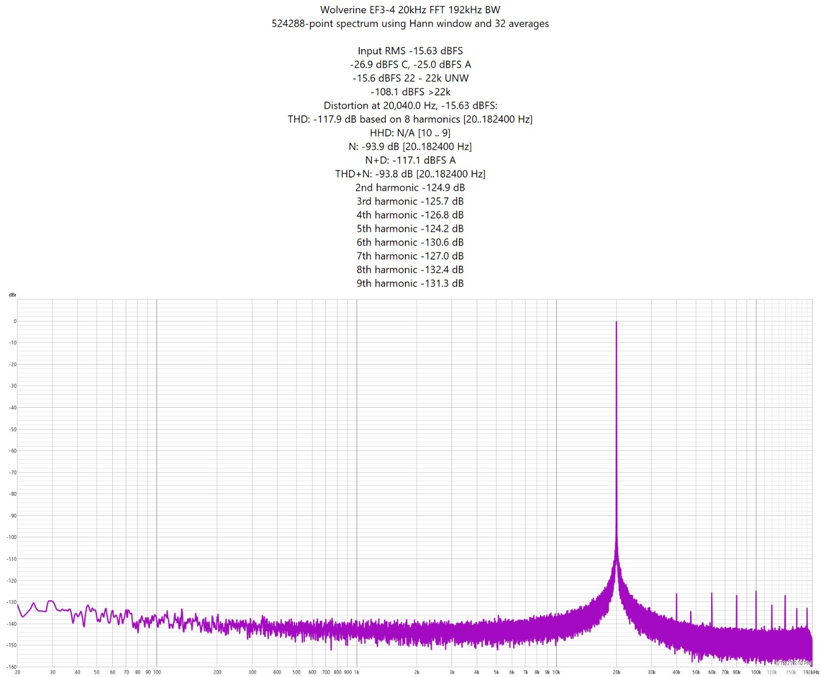

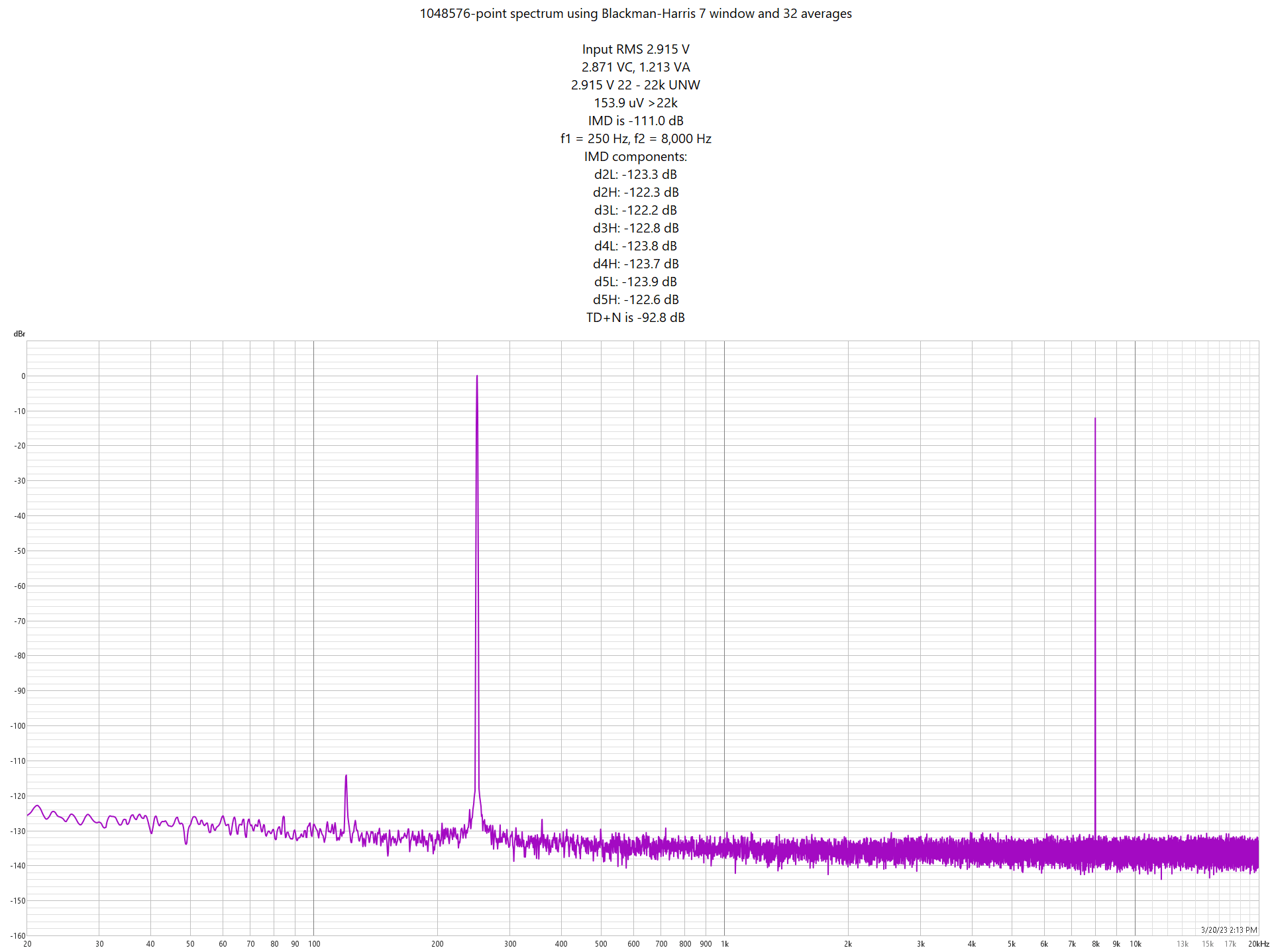

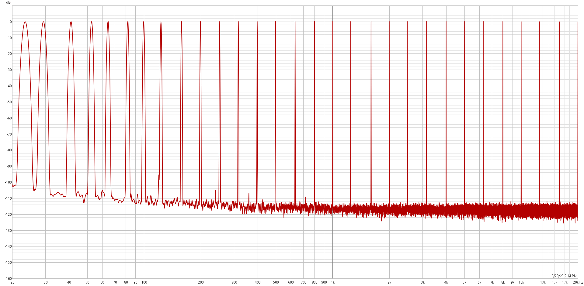

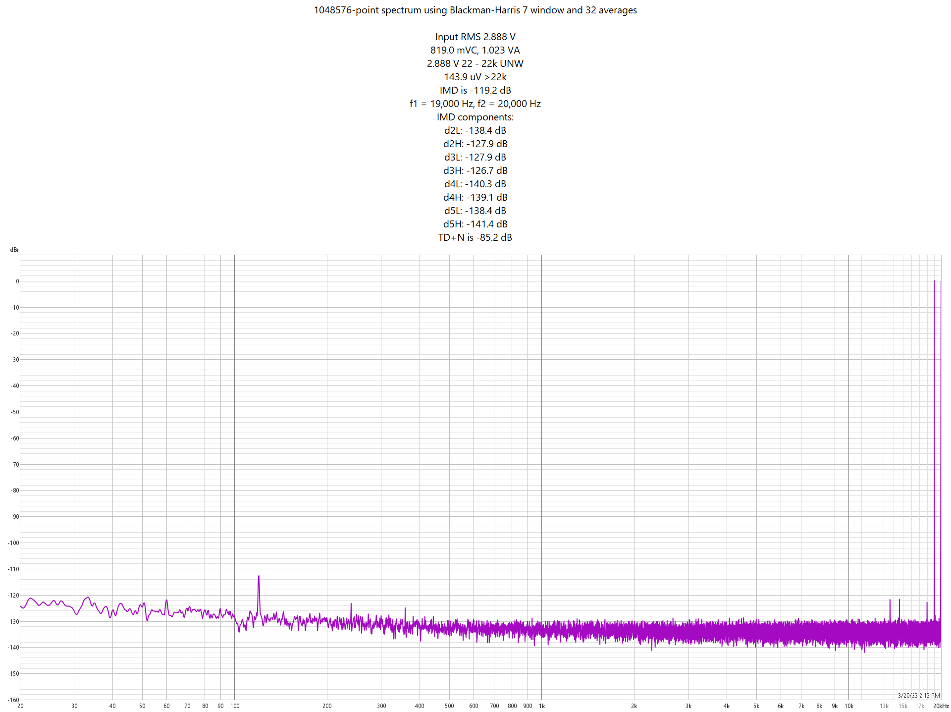

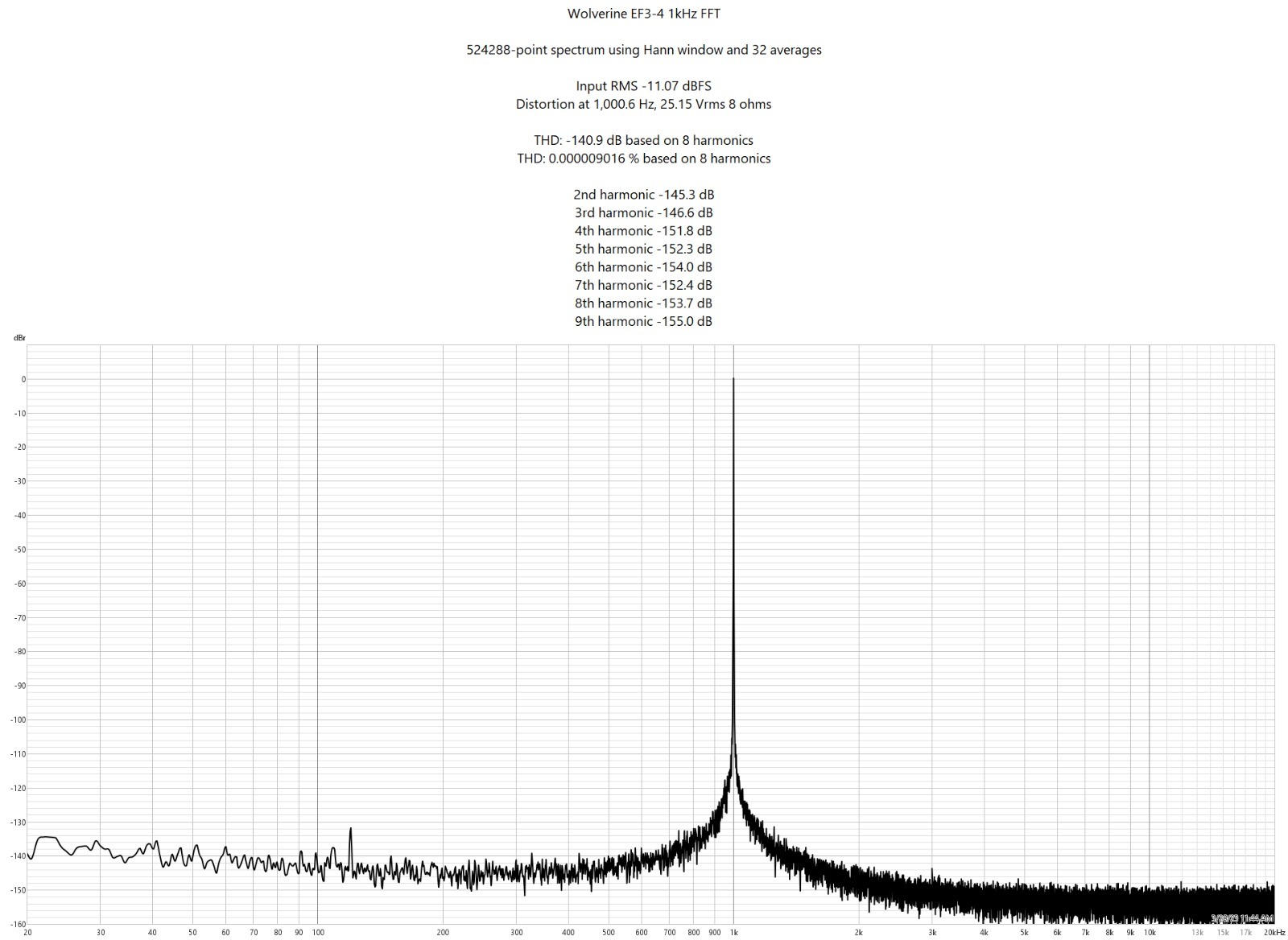

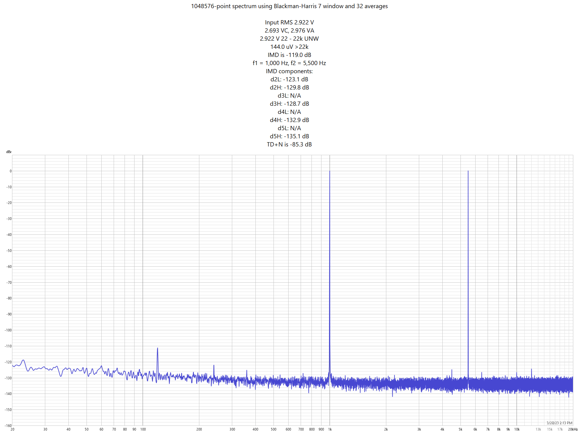

There is also a distortion sweep plot of the Wolverine below with the values listed for 1K, 10K and 20K.
A big thank you to Andy for taking this measurement for us. 🙏
17-3-23
we finally have 20k distortion measurements.
0.000095% THD 80 watts 8 ohm load.
Thanks again Andy for providing these amazing results
More test results can be found at the end of the build guide.

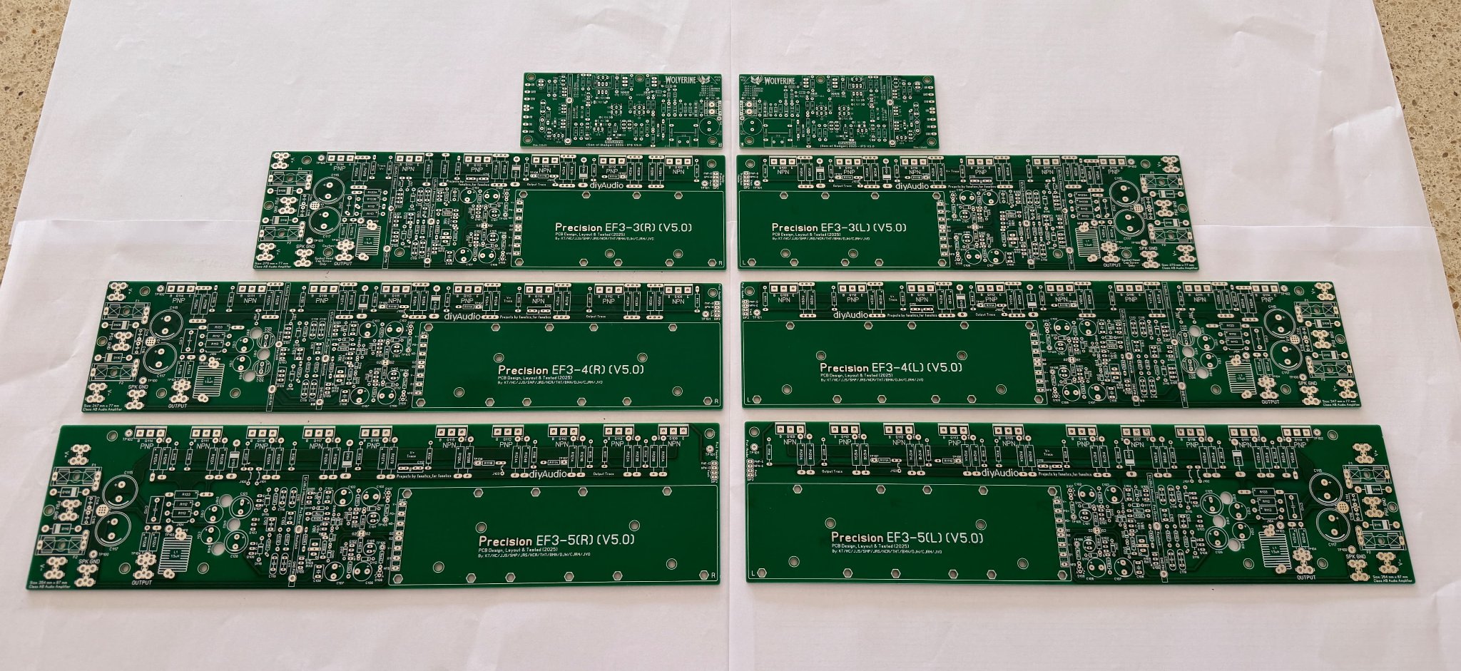

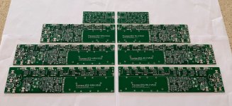

Announcing the Wolverine 5th Group Buy - Pre Order Open Now!
Register for the Wolverine 5th group buyAttachments

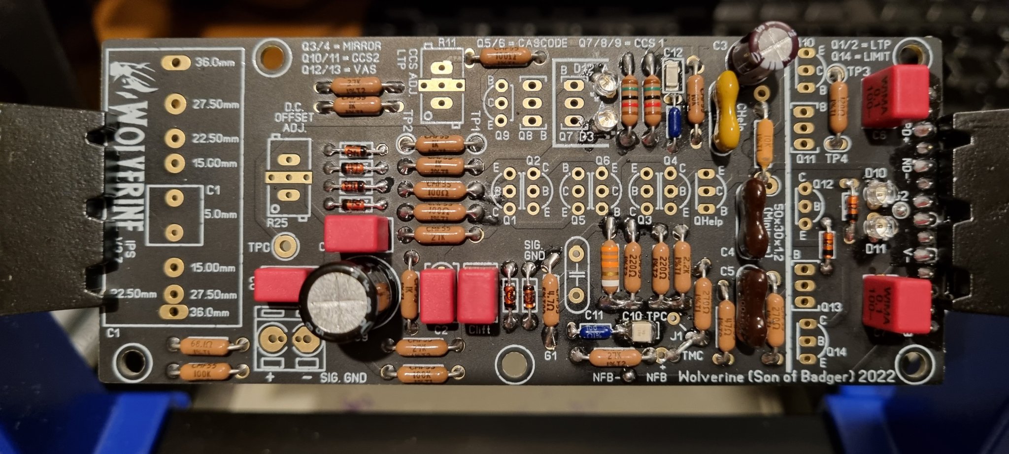

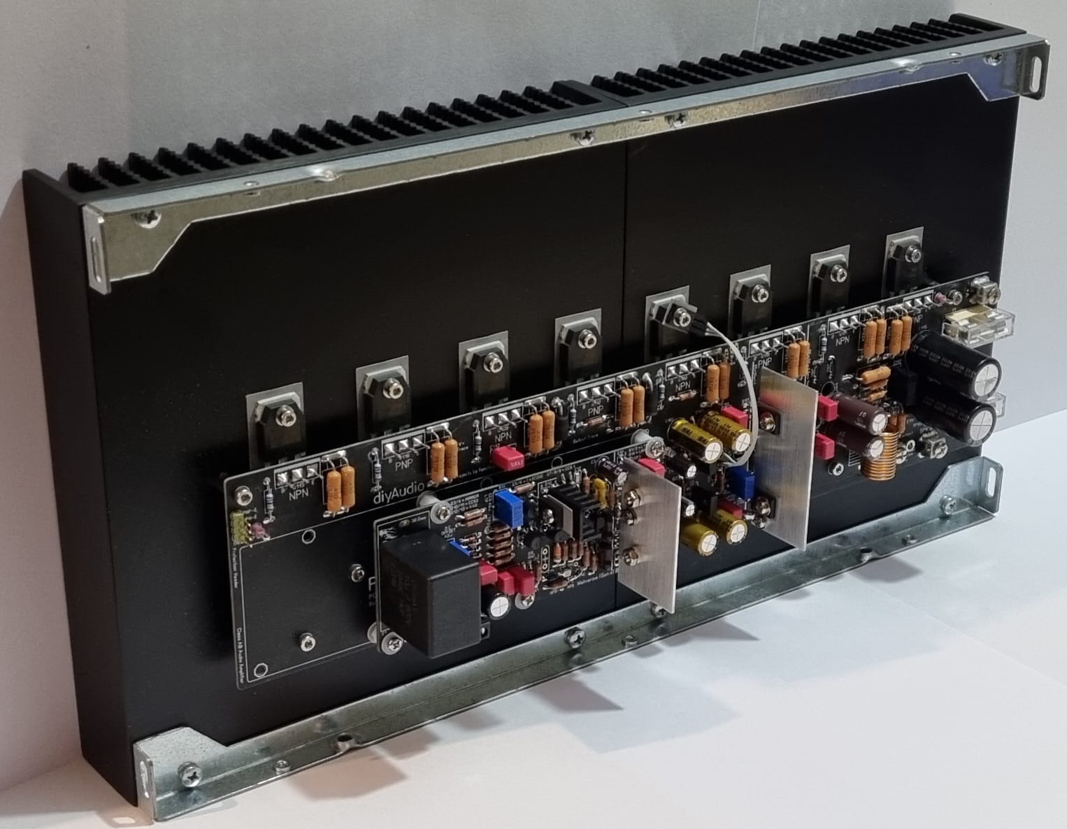

Here is the current state of my Wolverine build:
I hope everyone is going well with their builds
- Dan
- Dan
Very nice work Dan, looking forward to seeing yours progress,Here is the current state of my Wolverine build:
- Dan
And to assemble my own version also.
I'm going to do an extreme version, 2000VA 50 Vac transformer, and well oversized Heatsinks myself,
500mm X 200mm X 83mm per channel
Jeepers, what output transistors?
I have the MJL4281 MJL4302 pairs, 4 output pair board versionJeepers, what output transistors?

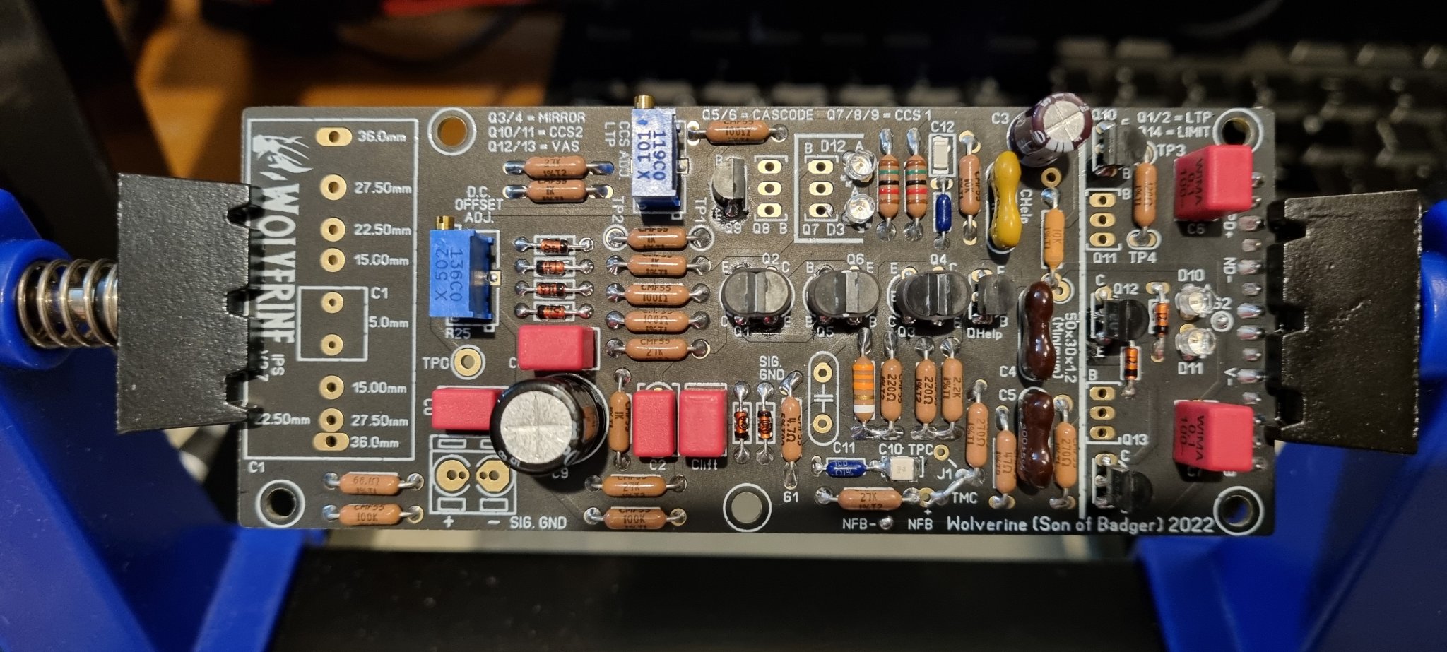

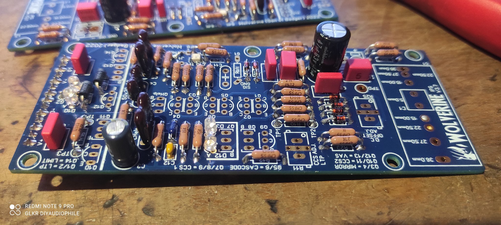

Tonights progress......
matched TO92 parts coupled with a tiny smear of heatsink paste and joined with heatshrink and installed....
Nice work so far,Tonights progress......
I'm not too far behind.
Nice choice with the Vishay dale's

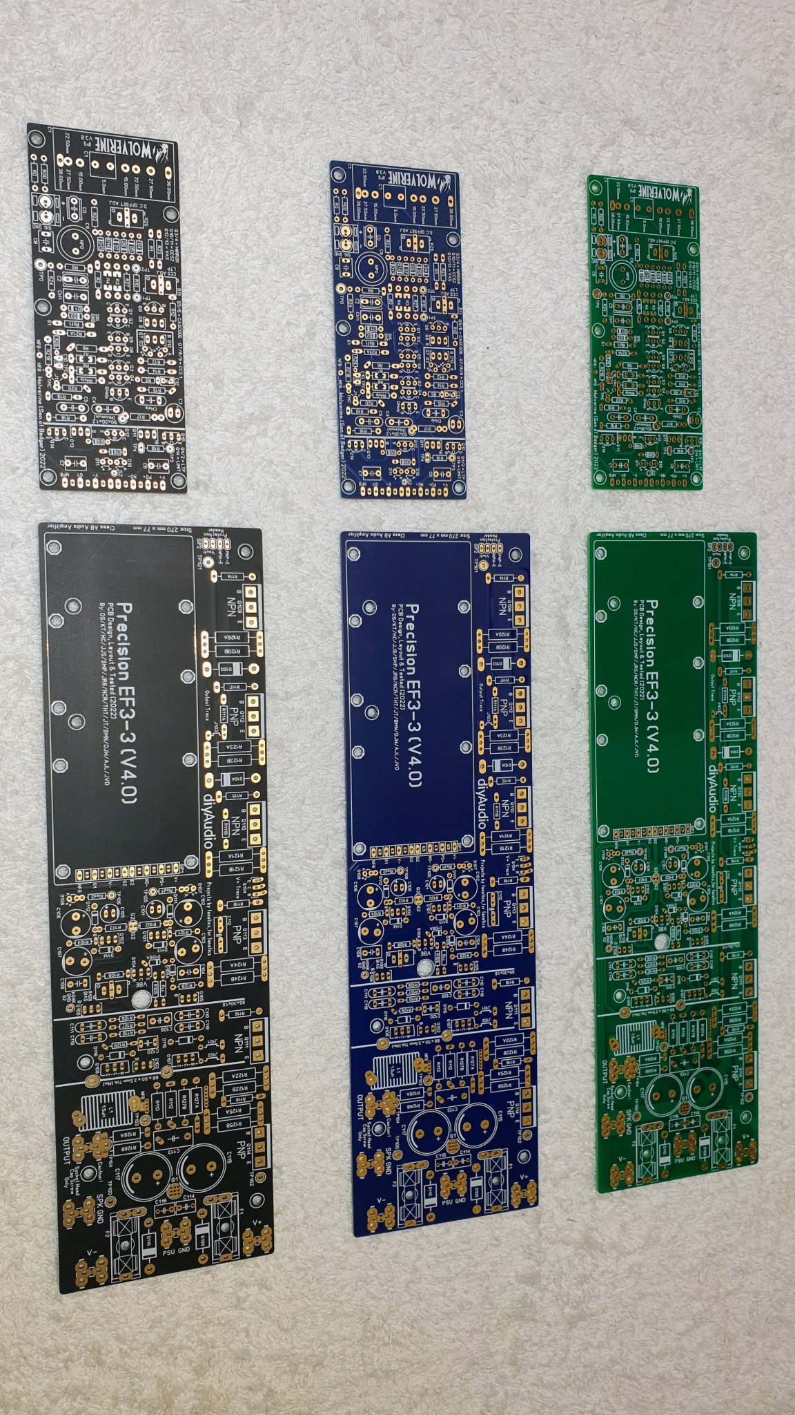

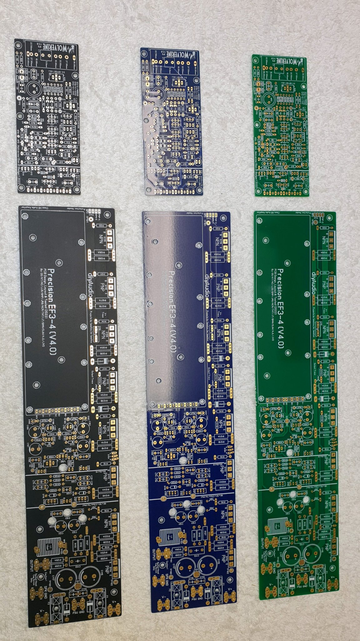

Hi Guy's
I just found a small error on the silkscreen on the underside of the PCB for the protection header.
This applies for to the EF3-3 & the EF3-4
Both pins are currently labeled 'NPN-E' the top pin should be 'PNP-E' as shown.
Once again this is just a small silkscreen error and has now been fixed.
