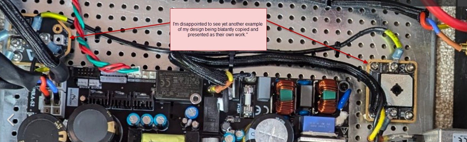

Hi guys, I am very close to being able to test my EF3-4 boards V. 4. My speaker protection board and my soft start board are built. I was watching Daniel's excellent YouTube videos for the 100th time, and I remembered that cool, little T ground lift board he used. I realize you can fly wire that thing, but that little pcb keeps everything tidy. Is there a source in North America where I can buy that pcb. My understanding is that it lifts the audio ground just slightly above chassis ground while leaving chassis ground intact. Let me know if I'm thinking about this correctly.

I want to bring to your attention an important issue regarding the PCB boards that have been recently circulated. I'm talking about my T-GND and Ground lift boards. It has come to my notice that these boards were copied without my permission or consultation.
As a community, it is vital that we respect each other’s work and adhere to the principles of collaboration and intellectual property. Unauthorized copying undermines the effort that goes into creating and sharing designs, and it’s essential that we all uphold these standards to foster a positive and respectful environment.
I have boards available if anyone would like them. Just send me a PM
Your boards were not copied, they were improved on and not even the same. Copying would be implying that I took your boards and made exact ones, which I did not, even the layouts are different.
