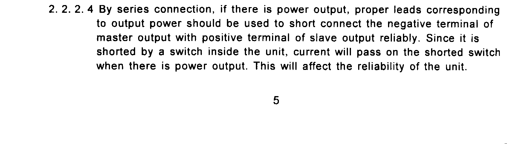

And even now you still don't understand why that message of you was so wrong. RTFM you said. Yes let's just do that, practice what you preach. Read The ******* Manual. I give you a pointer to the most relevant part below.
Note that on this unit the master is at RHS as pointed out in the manual page 2 - 4.

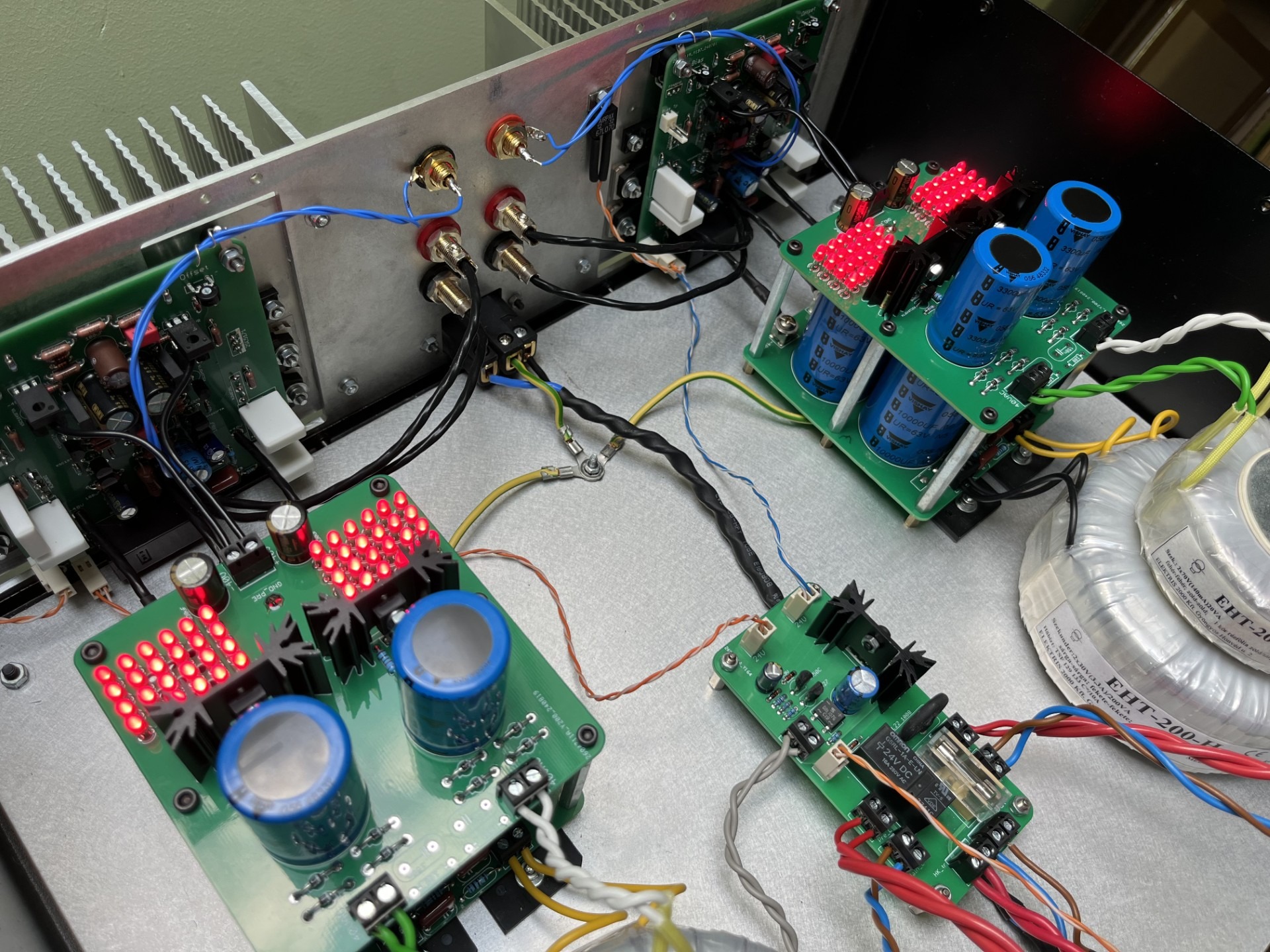

Can I ask what function does this board provide? see attached photo.
thanks

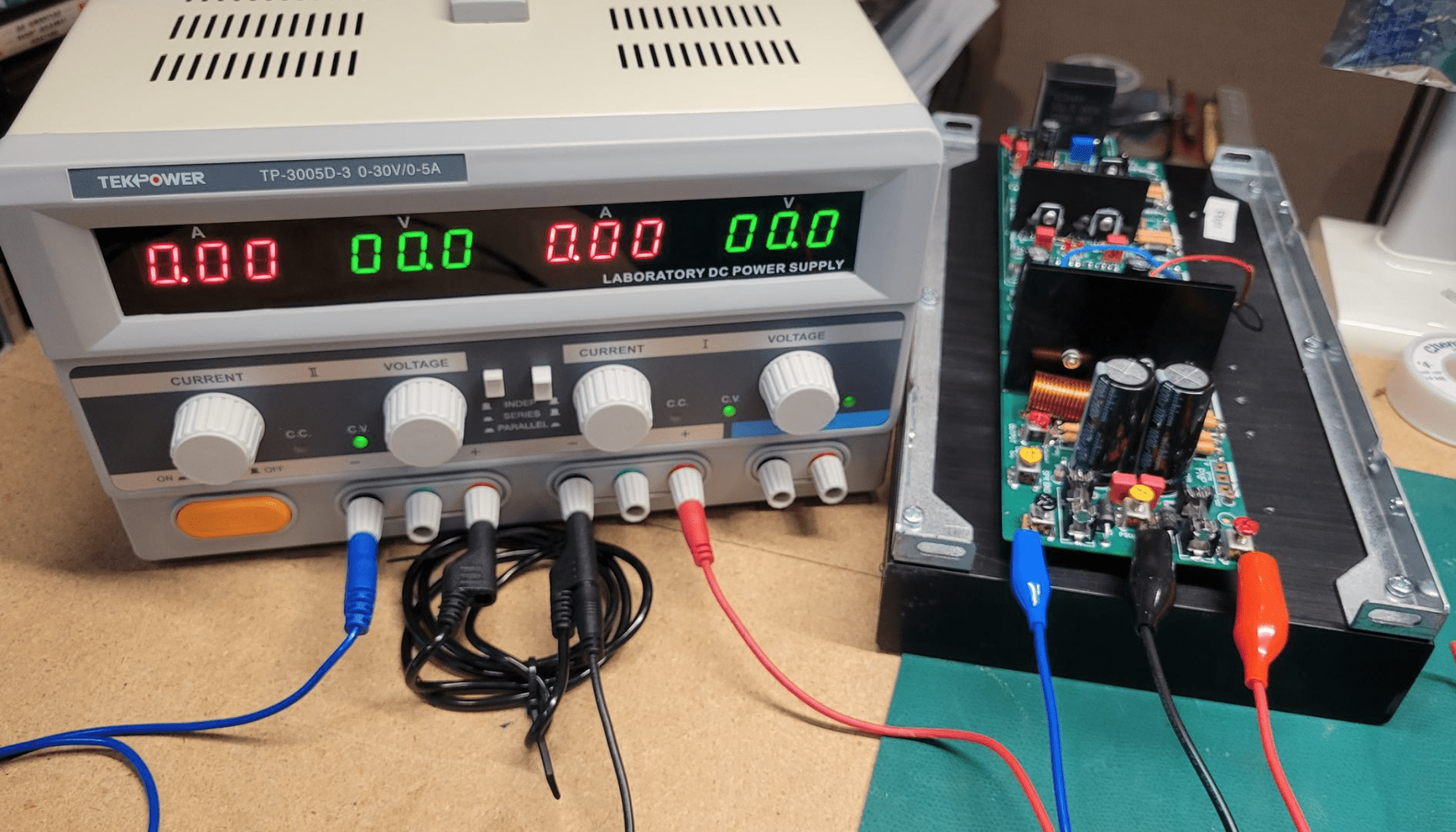

I don't have Photoshop at hand on this PC, hope the draft drawing is sufficient. Notice the markings at the PCB terminals too.
With this wiring, setting the supply at independent should work.
Usually it also works in series mode, but I have no experience with this particular model.
Parallel will not work.
Notice ground on the PSU is not necessary the same same as ground on amp, here it's not.
Check everything with DMM before connecting.

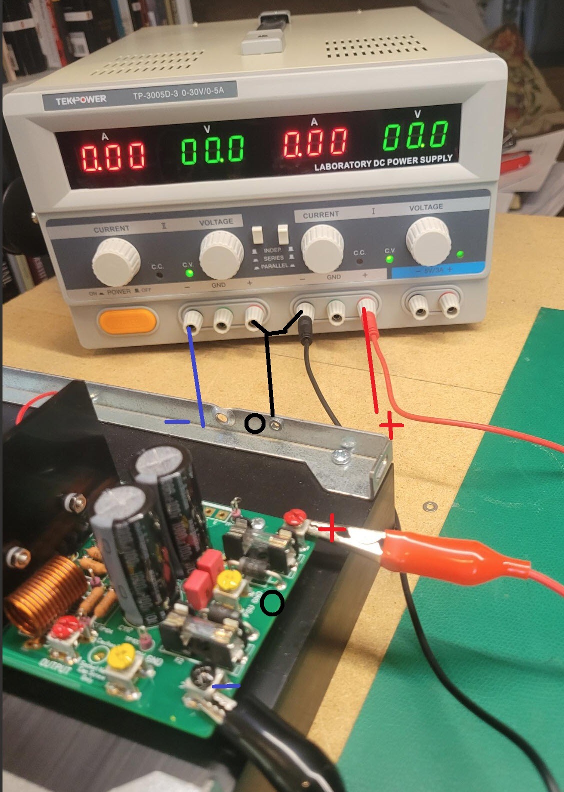

Finally got the right cables to wire this up for initial testing. The supply is set for series.

That should work just fine.
Make sure current limits are set the same, limit set for a bit above your expected bias current, like 20% or more. That is to limit damage due to a malfunction and give you a chance to get the bias current set properly. Once it is running in a stable way, you can increase current limits and connect a load to test at low power (1 watt is industry standard). Don't expect proper performance at lower supply voltages than it is designed to run at. 30 V may not be enough to allow normal operation delivering some current.
Keep in mind, my comments are general ones for all amplifiers. I haven't built this one, or seen one for test.

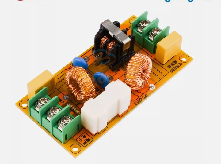

I have not used any SMPS's. In fact , I filter (below) my high-fi , gotta fight that horrible SMPS "hash" - ALL toroids for me.
Bad enough I have the horrible PC SMPS's on my systems. I even link to my amps optically. NO electrical connections between
digital and analog.
I have a good DAC , but the 15V supply for it shows as 50mV of nasty spikes. Got to build myself a nice linear regulator to power
it. What is the use of selling a -115db/.0005% DAC just to include a 5$ cheap China SMPS to power it ??

Very true OS.
SMPS is a module they buy (= job done), it is cheaper to ship and cheaper to buy.
The average person doesn't consider these things and may never notice, so they sell it.

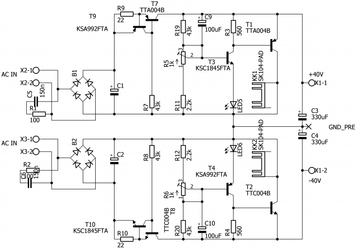

Hi sajti,
Shunt isn't the only way to get to a clean supply. Dissipating power is always a bad thing as well.
I find a combination of shunt and pass works the best. Like the best of both worlds. It's also a great way to isolate sections from each other.
I'm going to start with a simple LM317 (pass) , I'm actually running my DAC from the +/- 12V supply of my amp now , much quieter.
As far as isolation , I am listening to SPDIF optical now. Never USB (and that dirty PC ground).
I'll look for a reasonable shunt to run after a 317.
How would you do that ? Pass regulate to one voltage (317) , then shunt away a few more volts to get to the target ?
Edit - ??? https://tangentsoft.com/elec/opamp-linreg.html
