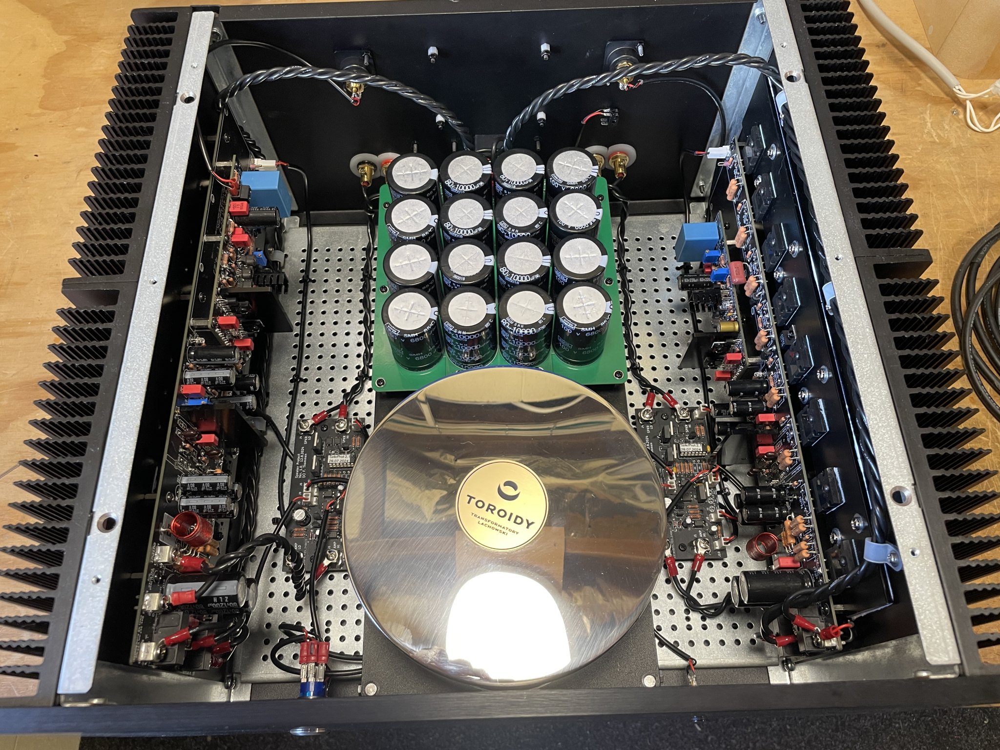

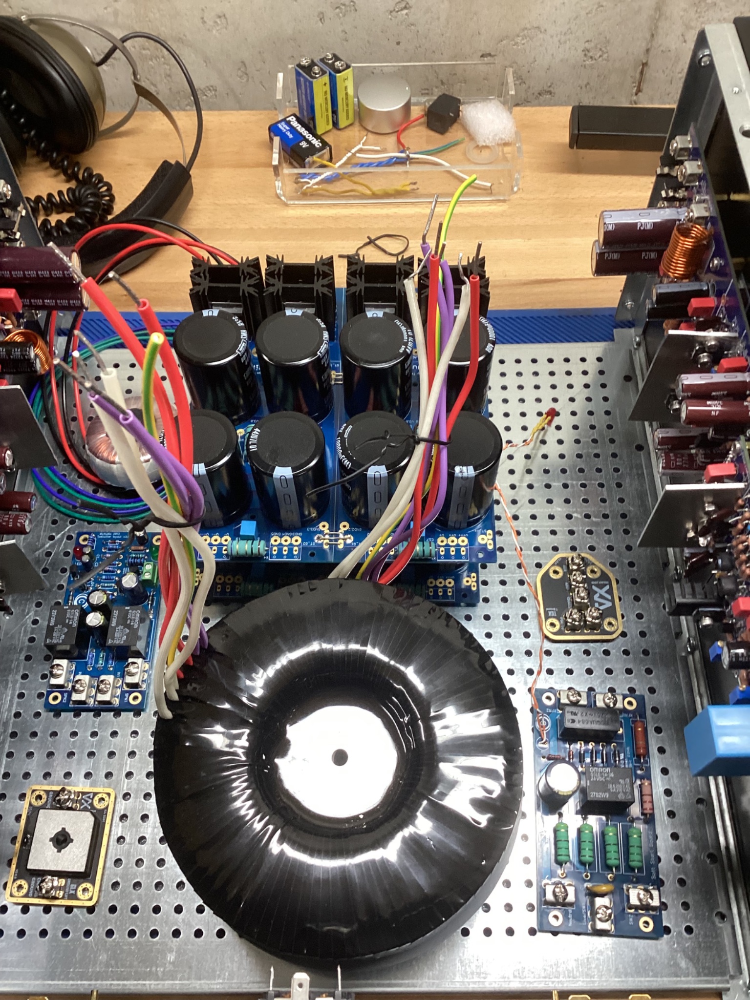

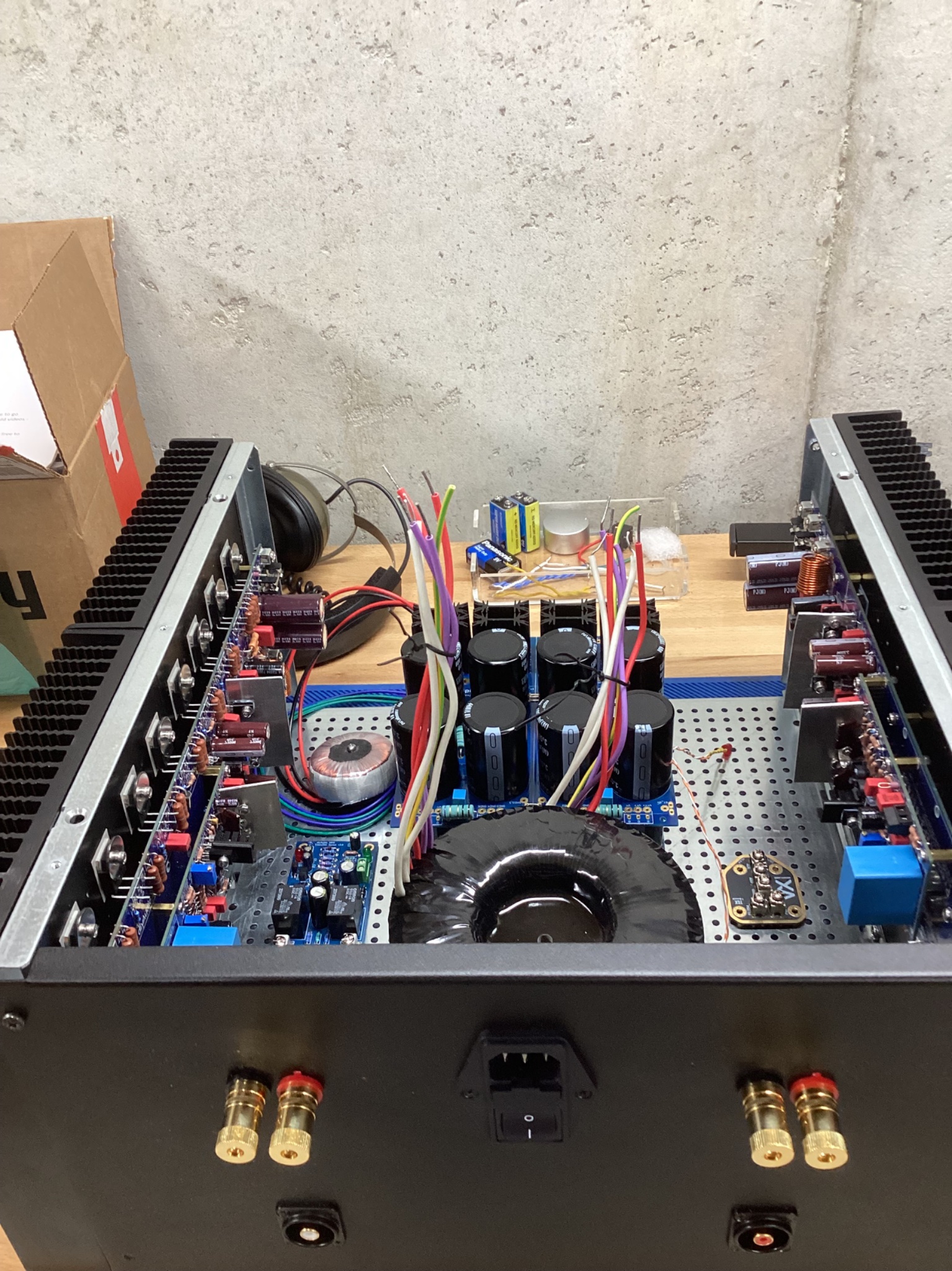

Dummy place everything into your chassis and put up a pic and we can pitch ideas, from my experience keeping the transformers, and especially the rectifiers, away from the IPS boards gives a way lower noise floor. Transformers will couple a little 50-60hz into the input stage, but the rectifier diodes are the worst for spraying the noise floor with 120hz and harmonics. This noise does not come through the power rail wiring but is instead capacitively coupled by proximity. I like your idea of having the rectifiers above the transformer, so long as they are at the front of the chassis and the IPS boards are at the back. There will be no magnetic field issue with this so long as you don't inadvertently close a mechanical loop through the center of a transformer.

Ok, I'm currently re-reading the wiring document that talks about loop area. I built the chassis when I got it from ModuShop, and then tore it apart to mount the power boards. I'll just mock up one channel for placement. I was told I could use just one SS Board and Ground Lift for both channels, so that's all I've built. Let me know if there's a problem with this.
