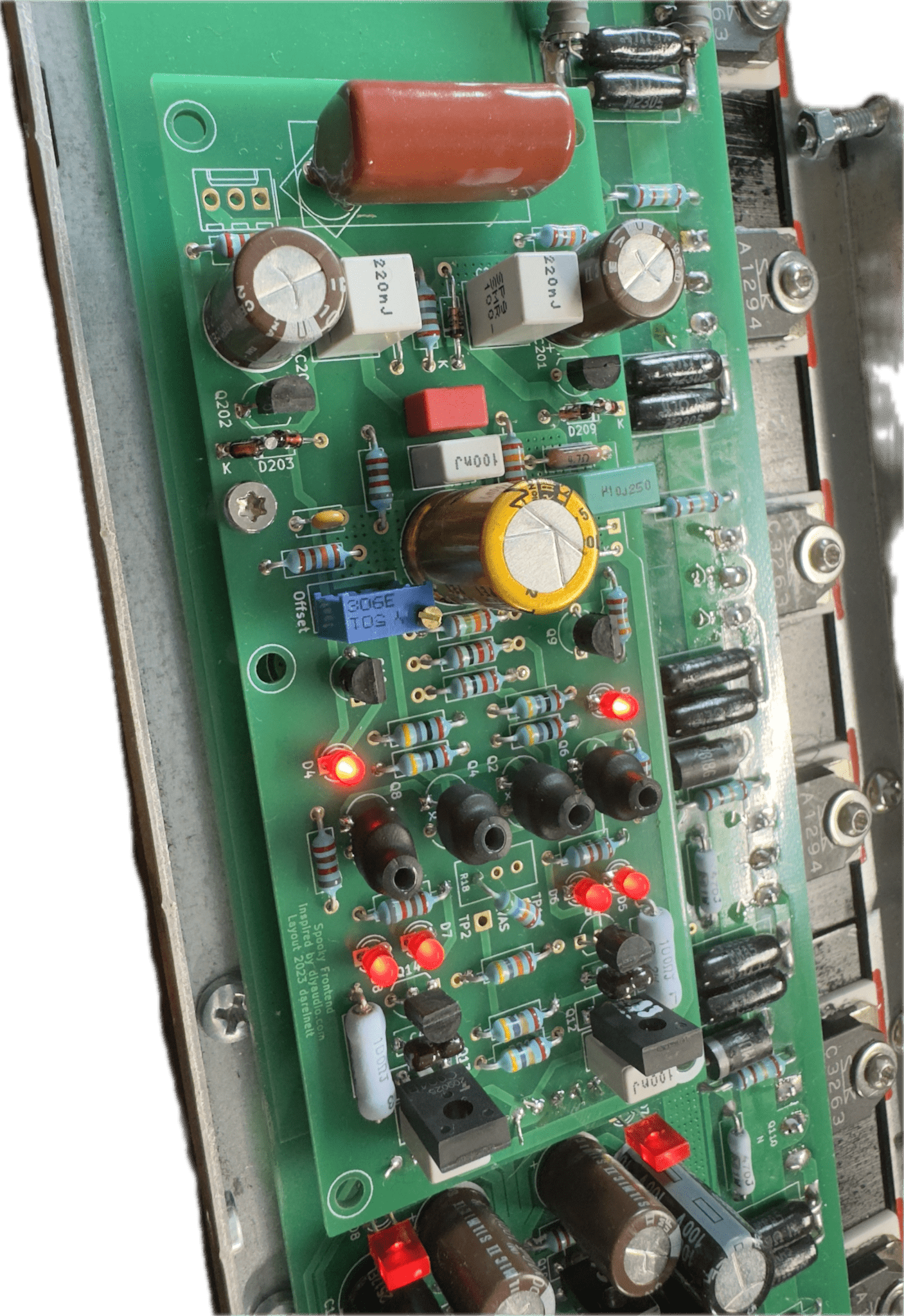

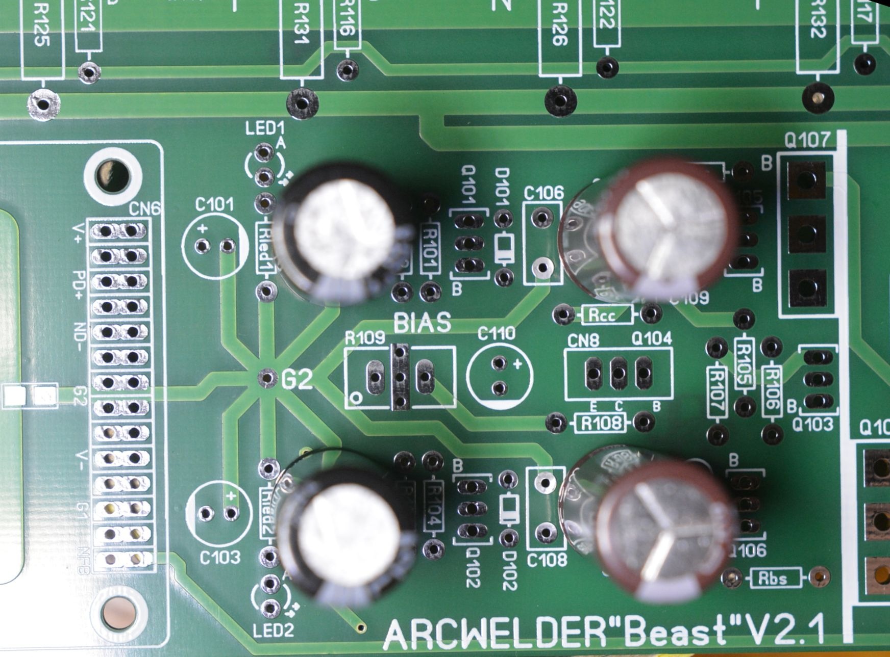

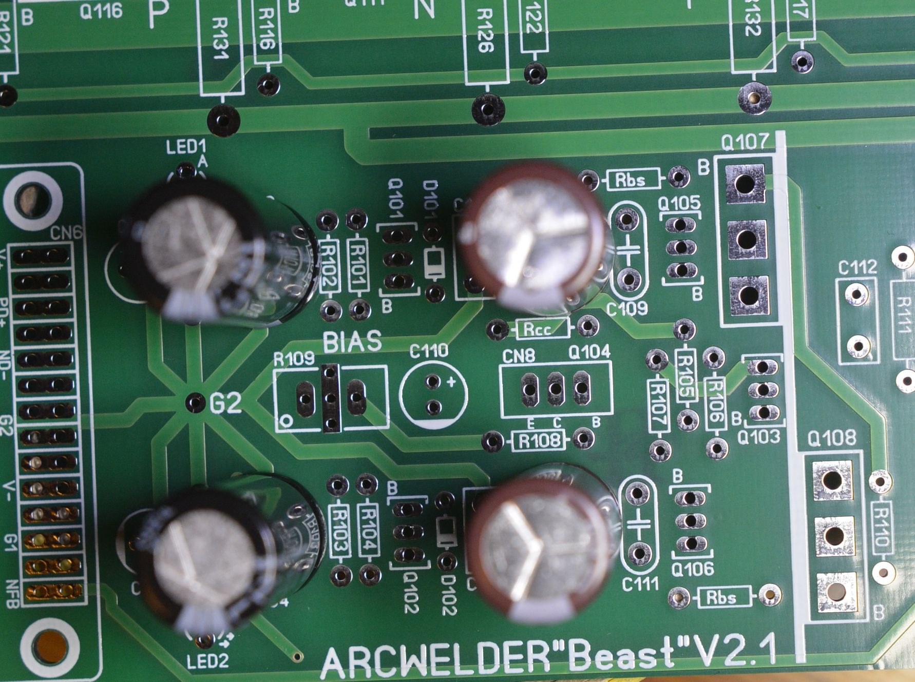

hi, i have a question about placing resistors and diodes around C102-3, C106-7 caps
i have a lot of 270uF 12.5mm dia caps for that positions, but if i'll use them, there is not enough space for R101/4, D111/112, D113/114, D105a/106a and maybe R102/103. I plan to mount those elements at the bottom side of the board.
Board will be mounted perpendicular to the heatsink. boards ef3-3 and ef3-4
are there any caveats that should taken into account?
(The following for EF3-4 group buy 4)
You need to buy 10mm parts for C123, 124, 125 and 126 anyway (as 12.5mm will ABSOLUTELY not fit here) so I wouldn't. By using a physically wider part at C102, 103, 106 and 107 you create the risk of shorting a component to a filled solder pad and parts being unnecessarily lifted from the board and wobbly. You also don't need exotics here, if that's you're angle.
You can do what you're suggesting, but I'm recommending you don't and just get all 10mm parts so you can complete C102, 103, 106, 107, 123, 124, 125 and 126 competently.
I have completed a set of EF3-4 and tested them in the perpendicular arrangement (using driver auxiliary heatsink and remote mounting of Q103) so feel free to ask any more questions. Remember in this arrangement to use the EF3-3 parts for R105, 106, 107 and Rcc.

what's the latest build guide? mine is v41 not covering v4GB rev.
i simply have more than 100 dia.12.5mm 220uF and 270uF caps from different vendors ... and scratching my head where to use them 🙂
but understood that using them with Wolverine might produce more issues than needed
was thinking about using Kapton tape for isolation, but will use 10mm dia for safety 🙂
probably will have to consult Q103 location (probably on main hatsing between q110 and q112, but that question will come up ...much much later)
but hey, checked tha 12.5dia "might (almost)" fit ARCWELDER ops, so not everything is lost 🙂
thanks!
